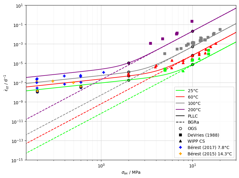

Power Law Linear Creep
This benchmark shows the increased creep rate of salt rock at lower deviatoric stress. A two component power law (which we call Power Law Linear Creep, or short PLLC) provides an easy way to capture the power law behaviour (dislocation creep) and the linear behaviour (pressure solution creep). For more details have a look at (Zill et al., 2022).

Experimental data
A nice overview for the strain rates of salt for different temperatures and differential stresses can be found in (Li et al., 2021).
Parameters
This set of parameters gives a good fit with the experimental data. The grain size is a bit larger than the usual grain size of roughly 1 cm.

Simulation and plot
The experimental data is compared against the model results (analytically and numerically)

markers = {"WIPP": "^", "DeVries": "s", "Berest": "P"}
with Path("reference_data.json").open() as ref_data_file:
    ref_data: dict[str, list[float]] = json.load(ref_data_file)
    for key, data in ref_data.items():
        temp = key.rsplit(" ", 1)[-1]
        stresses, eps_dot = np.array(data).T
        marker = markers[key.split(" ", 1)[0]]
        ax.loglog(stresses, eps_dot, marker, c=Exps[float(temp)])
ax.plot([], [], c="k", ls="None", marker="s", label="DeVries (1988)")
ax.plot([], [], c="k", ls="None", marker="^", label="WIPP CS")
ax.plot([], [], c="b", ls="None", marker="P", label="Bérest (2017) 7.8°C")
ax.plot([], [], c="orange", ls="None", marker="P", label="Bérest (2015) 14.3°C")
ax.legend()
_ = fig.tight_layout()
