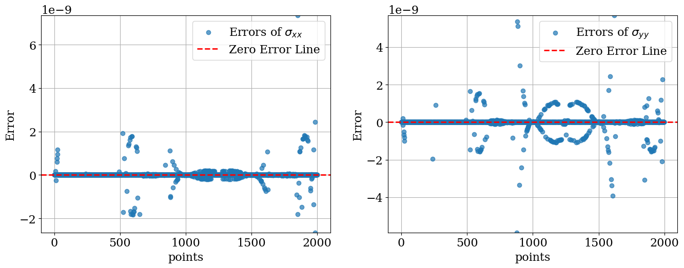

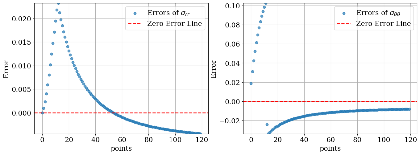

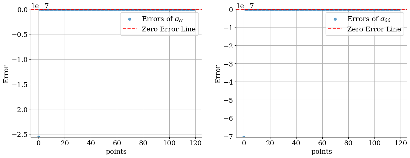

Error Analysis Function
def ErrorAnalysis(refFile, calFile, input1, input2, labelx, labely, tol):… (click to toggle)
    _fig, ax = plt.subplots(nrows=1, ncols=2, figsize=(16, 5.5))
    file_path1 = refFolder_name / refFile
    file_path2 = calFolder_name / calFile
    df1 = pd.read_csv(file_path1)
    df2 = pd.read_csv(file_path2)
    # Check if the columns are the same in both DataFrames
    if not df1.columns.equals(df2.columns):
        msg = "Columns in the CSV files are not the same."
        raise ValueError(msg)
    # Check if the shape of the DataFrames is the same
    if df1.shape != df2.shape:
        msg = "Shapes of the CSV files are not the same."
    errors0 = df1[input1] - df2[input1]
    errors1 = df1[input2] - df2[input2]
    # Calculate mean absolute error (MAE)
    mae0 = abs(errors0).mean()
    mae1 = abs(errors1).mean()
    mean_error = np.mean([mae0, mae1])
    if abs(mae0) > 0.0:
        ax[0].set_ylim([errors0.min(), errors0.max()])
    ax[0].scatter(range(len(errors0)), errors0, alpha=0.7, label=labelx)
    ax[0].axhline(y=0, color="red", linestyle="--", label="Zero Error Line")
    if abs(mae1) > 0.0:
        ax[1].set_ylim([errors1.min(), errors1.max()])
    ax[1].scatter(range(len(errors1)), errors1, alpha=0.7, label=labely)
    ax[1].axhline(y=0, color="red", linestyle="--", label="Zero Error Line")
    # Customize the plot
    ax[0].set_xlabel("points")
    ax[0].set_ylabel("Error")
    ax[0].grid("both")
    ax[0].legend()
    ax[1].set_xlabel("points")
    ax[1].set_ylabel("Error")
    ax[1].grid("both")
    ax[1].legend()
    tolerance = tol
    # Check if the error exceeds the threshold
    if mean_error > tolerance:
        msg = (
            f"Error exceeds the threshold. Stopping the code. Mean Error: {mean_error}"
    print("Continue with the rest of the code.", "Mean Error:", mean_error)

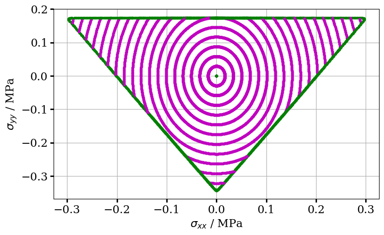

dataEx1 = {"sigma0": [], "sigma1": []}
calFile = "calculated_piplane_data_Ex1.csv"
piResults_set1 = {}… (click to toggle)
piResults_set1 = {}
material_set = {}
fig, ax = plt.subplots(figsize=(8, 5))
ax.set_adjustable("datalim")
ax.set_aspect("auto", "box")
material_set = {
    "sigma_ci": 110.0,
    "sigma_cg": 110.0,
    "Ei": 3.85e4,
    "nu": 0.2,
    "m_i": 2.0,
    "Df": 0.0,
    "gsi": 80.0,
    "lodeT": 29.0,
    "em": 5e-3,
    "delta_tol": 1e-6,

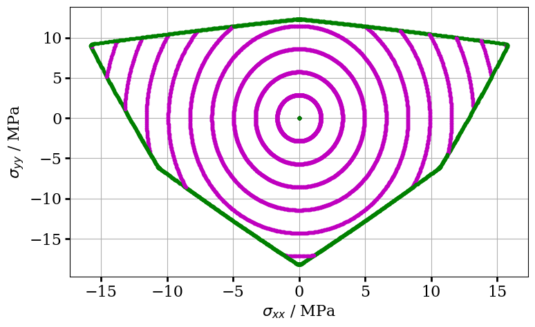

divisions = 1000
for theta in [
    pi * (-1.0 + 2.0 * float(i) / (float(divisions) - 1.0)) for i in range(divisions)
    piResults_set1 = run_pi_plane(theta, material_set, dataEx1, calFile)
    ax.plot(piResults_set1["sigma_elx"], piResults_set1["sigma_ely"], "m.")
    ax.plot(piResults_set1["sigma_plx"], piResults_set1["sigma_ply"], "g.")

ErrorAnalysis(
    "reference_piplane_data_Ex1.csv",
    "calculated_piplane_data_Ex1.csv",
    "sigma0",
    "sigma1",
    r"Errors of $\sigma_{xx}$",
    r"Errors of $\sigma_{yy}$",
    tol=1e-6,
Continue with the rest of the code. Mean Error: 1.6822704379315857e-10
dataEx2 = {"sigma0": [], "sigma1": []}
calFile = "calculated_piplane_data_Ex2.csv"
piResults_set2 = {}… (click to toggle)
piResults_set2 = {}
material_set = {}
material_set = {
    "sigma_ci": 30.0,
    "sigma_cg": 30.0,
    "Ei": 1.071e4,
    "nu": 0.2,
    "m_i": 15.0,
    "Df": 0.0,
    "gsi": 65.0,
    "lodeT": 29.0,
    "em": 2e-4,
    "delta_tol": 1e-6,
divisions = 1000
for theta in [
    piResults_set2 = run_pi_plane(theta, material_set, dataEx2, calFile)
    ax.plot(piResults_set2["sigma_elx"], piResults_set2["sigma_ely"], "m.")
    ax.plot(piResults_set2["sigma_plx"], piResults_set2["sigma_ply"], "g.")
ax.set_xlabel("$\\sigma_{xx}$ / MPa")
ax.set_ylabel("$\\sigma_{yy}$ / MPa")
ax.grid("both")
ax.tick_params(width=2, length=5)
ax.xaxis.set_minor_locator(MultipleLocator(5))
ax.yaxis.set_minor_locator(MultipleLocator(5))
ax.tick_params(which="minor", width=2, length=3, color="k")

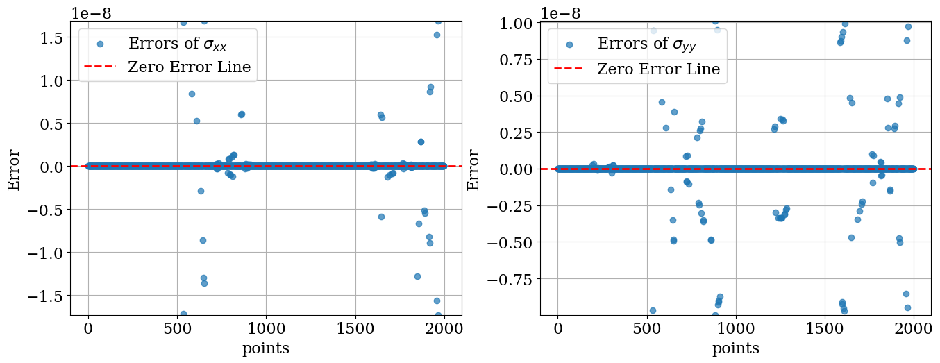

ErrorAnalysis(… (click to toggle)
ErrorAnalysis(
    "reference_piplane_data_Ex2.csv",
    "calculated_piplane_data_Ex2.csv",
    "sigma0",
    "sigma1",
    tol=1e-6,
Continue with the rest of the code. Mean Error: 7.706991456365086e-11
The yield function is approached along different stress paths within the $\pi$-plane. This shows that yield is correctly detected, and the stress state is correctly pulled back onto the yield surface.

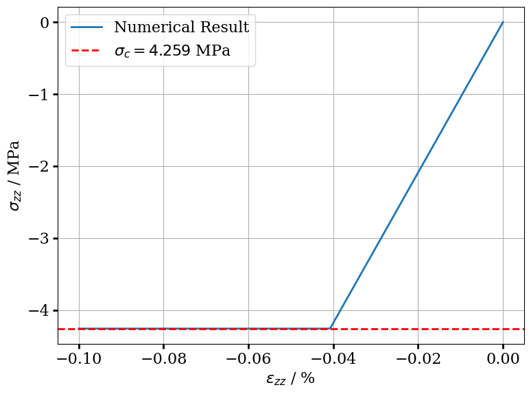

The validity of the Hoek-Brown model implemented in MFront is confirmed by the conduct of compressive and hydrostatic loading tests, which aim to ascertain the analytically derived compressive strength ($\sigma_c$) and tensile strength ($\sigma_t$).
Numerical Evaluation of Compressive and Hydrostatic Loading Tests
def runTest(material_set, data, calFile):… (click to toggle)
    m_b = material_set["m_i"] * np.exp(
        (material_set["gsi"] - 100.0) / (28.0 - 14.0 * material_set["Df"])
    sF = np.exp((material_set["gsi"] - 100.0) / (9 - 3.0 * material_set["Df"]))
    alphF = (1.0 / 2.0) + (1.0 / 6.0) * (
        np.exp(-material_set["gsi"] / 15.0) - np.exp(-20.0 / 3.0)

Compressive Loading Test
dataEx3 = {"epsilon2": [], "sigma2": []}
calFile = "calculated_CLT_data_Ex3.csv"
results_set1 = {}… (click to toggle)
results_set1 = {}
material_set = {}
fig, ax = plt.subplots(figsize=(8, 6))
material_set = {
    "sigma_ci": 30.0,
    "sigma_cg": 30.0,
    "Ei": 1.071e4,
    "nu": 0.2,
    "m_i": 15.0,
    "Df": 0.0,
    "gsi": 65.0,
    "lodeT": 29.0,
    "em": -1e-3,
    "delta_tol": 1e-6,
    "Test": "Compressive Loading Test",
flgt = 1
results_set1 = runTest(material_set, dataEx3, calFile)
ax.plot(
    results_set1["eps_zz"] * 100.0,
    results_set1["sig_zz"],
    label="Numerical Result",
ax.set_xlabel("$\\epsilon_{zz}$ / % ")
ax.set_ylabel("$\\sigma_{zz}$ / MPa")
ax.grid("both")
ax.axhline(
    y=-sigma_c, color="r", linestyle="--", label=f"$\\sigma_c = {sigma_c:2.3f}$ MPa"
ax.legend()
<matplotlib.legend.Legend at 0x7f6a32296a50>

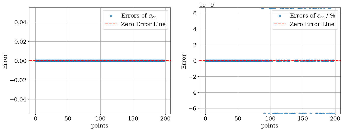

ErrorAnalysis(
    "reference_CLT_data_Ex3.csv",
    "calculated_CLT_data_Ex3.csv",
    "epsilon2",
    "sigma2",
    r"Errors of $\sigma_{zz}$",
    r"Errors of $\epsilon_{zz}$ / %",
    tol=1e-6,
Continue with the rest of the code. Mean Error: 1.0083562117619269e-09

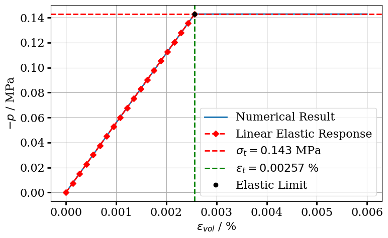

dataEx4 = {"epsvol": [], "p": []}
calFile = "calculated_HLT_data_Ex4.csv"
results_set2 = {}… (click to toggle)
results_set2 = {}
material_set = {}
material_set = {
    "sigma_ci": 30.0,
    "sigma_cg": 30.0,
    "Ei": 1.071e4,
    "nu": 0.2,
    "m_i": 15.0,
    "Df": 0.0,
    "gsi": 65.0,
    "lodeT": 29.0,
    "em": 2e-5,
    "delta_tol": 1e-6,
    "Test": "Hydrostatic Loading Test",
results_set2 = runTest(material_set, dataEx4, calFile)
bulkModulus = BulkModulus(results_set2, material_set)
p = pressure(results_set2)
ax.plot(
    (results_set2["eps_xx"] + results_set2["eps_yy"] + results_set2["eps_zz"]) * 100,
    -p,
epst = elasticLimit(sigma_t, bulkModulus)
analytical_solution(epst, sigma_t, bulkModulus)
ax.axhline(
    y=sigma_t, color="r", linestyle="--", label=f"$\\sigma_t = {sigma_t:2.3f}$ MPa"
ax.axvline(
    x=epst,
    color="g",
    linestyle="--",
    label=f"$\\epsilon_t = {epst:2.5f}$ %",
ax.plot(epst, sigma_t, "ko", label="Elastic Limit")
ax.set_xlabel("$\\epsilon_{vol}$ / %")
ax.set_ylabel("$-p$ / MPa")
ax.grid("both")
ax.legend()
<matplotlib.legend.Legend at 0x7f6a31df0590>

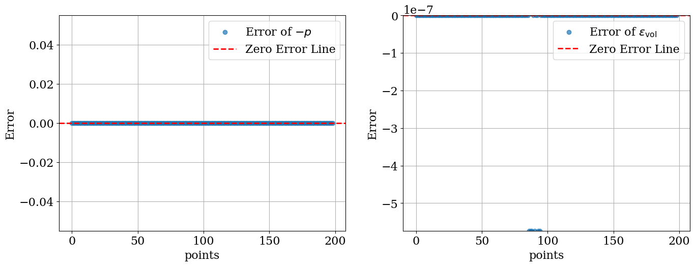

ErrorAnalysis(
    "reference_HLT_data_Ex4.csv",
    "calculated_HLT_data_Ex4.csv",
    "epsvol",
    "p",
    "Error of $-p$",
    "Error of $\\epsilon_{\\text{vol}}$",
    tol=1e-6,
Continue with the rest of the code. Mean Error: 8.648036520496276e-09

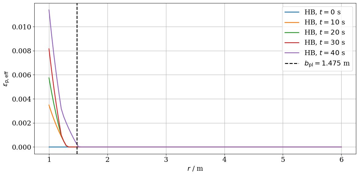

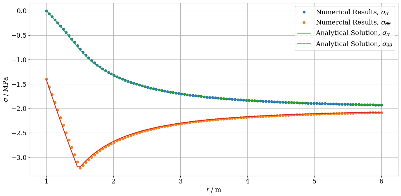

Elastoplastic Response of a Circular Hole to Cyclic Loading
In this example, the Hoek-Brown model implemented based on the $C_2$ continuous approach is applied to a circular hole under cyclic loading and compare the results in terms of the radial and tangential stresses with the analytical solutions. The analytical solution for this problem is provided by the work of Carranza-Torres and Fairhurst [15]. We consider a cylindrical hole with a radius of $r$, which is subjected to an in-situ uniform stress field of $\sigma_0$, and an internal pressure of $p_i$. The scaled far-field stresses, $S_0$, and scaled internal pressure, $P_0$, are determined by the following two equations, respectively
$$ S_0 = \frac{\sigma_0}{m_b \sigma_0} + \frac{s}{m_b ^ 2}, \quad \text{and} \quad P_i = \frac{P_0}{m_b \sigma_0} + \frac{s}{m_b ^ 2}. \tag{12} $$
The elastic limit of rock mass is determined by the scaled far-field stress ($S_0$) and the corresponding scaled (dimensionless) critical internal pressure ($P^{\text{cr}}_i$) is calculated as
$$ P_{i}^{\text{cr}} = \frac{1}{16} \left(1 - \sqrt{1 + 16 S_0} \right)^2. \tag{13} $$
Then, the critical internal pressure, $p^{\text{cr}}_i$ , is given by
$$ p_{i}^{\text{cr}} = \left( P_{i}^{\text{cr}} - \frac{s}{m_{b} ^ {2}} \right) m_b \sigma_{\text{ci}}. \tag{14} $$
The plastic region grows equally around the hole. The failure zone reaches to
$$ b_{\text{pl}} = b \exp \left( 2 \sqrt{P_{i}^{\text{cr}}} - \sqrt{P_i} \right). \tag{15} $$
In the plastic region where $r < b_{\text{pl}}$, the solutions for the radial and the tangential stresses are calculated as follows, respectively
$$ \sigma_r(r) = \left( S_r (r) - \frac{s}{m_b ^2} \right) m_b \sigma_{\text{ci}}, \quad \text{and} \quad \sigma_{\theta}(r) = \left( S_{\theta} (r) - \frac{s}{m_b ^2} \right) m_b \sigma_{\text{ci}}, \tag{16} $$
where $S_r$ and $S_{\theta}$ are correspondingly given by
$$ S_r(r) = \left( \sqrt{P_{i}^{\text{cr}}} + \frac{1}{2} \ln \left( \frac{r}{b_{\text{pl}}} \right) \right)^2, \quad \text{and} \quad S_{\theta}(\theta) = \sqrt{S_{r}(r)} + S_r(r). \tag{17} $$
The solutions for the radial and the tangential stresses in the elastic region are calculated by
$$ \sigma_r(r) = \sigma_0 - (\sigma_0 - p_{i}^{\text{cr}}) \left( \frac{b_{\text{pl}}}{r} \right)^2, \quad \text{and} \quad \sigma_{\theta}(r) = \sigma_0 + (\sigma_0 - p_{i}^{\text{cr}}) \left( \frac{b_{\text{pl}}}{r} \right)^2. \tag{18} $$
model_hb = ot.Project(… (click to toggle)
    input_file="load_test_hb_nonassociated.prj",
    output_file=out_dir / "load_test_hb_nonassociated.prj",
model_hb.write_input()
model_hb.run_model(logfile=str(out_dir / "out.txt"), args=f"-o {out_dir} -m .")
 ogs -o /var/lib/gitlab-runner/builds/t1_R7hwLX/1/ogs/build/release-all/Tests/Data/Mechanics/HoekBrown/HoekBrownYieldCriterion -m . /var/lib/gitlab-runner/builds/t1_R7hwLX/1/ogs/build/release-all/Tests/Data/Mechanics/HoekBrown/HoekBrownYieldCriterion/load_test_hb_nonassociated.prj
['ogs', '-o', '/var/lib/gitlab-runner/builds/t1_R7hwLX/1/ogs/build/release-all/Tests/Data/Mechanics/HoekBrown/HoekBrownYieldCriterion', '-m', '.', '/var/lib/gitlab-runner/builds/t1_R7hwLX/1/ogs/build/release-all/Tests/Data/Mechanics/HoekBrown/HoekBrownYieldCriterion/load_test_hb_nonassociated.prj']
pvd_hb = vtuIO.PVDIO(f"{out_dir}/load_test_hb.pvd", dim=2)
b = 1000.0… (click to toggle)

fig, ax = plt.subplots(figsize=(12, 6))… (click to toggle)
for i in [0, 10, 20, 30, 40]:
    ax.plot(
        np.array(raxis).T[0] / 1000,
        pvd_hb.read_set_data(i, "EquivalentPlasticStrain", pointsetarray=raxis),
        label=f"HB, $t = {i}$ s",
        ls="-",
ax.axvline(
    x=analytResults_set["pl_range"],
    color="black",
    linestyle="--",
    label="$b_{{\\text{{pl}}}} = {:2.3f}$ m".format(analytResults_set["pl_range"]),
ax.set_xlabel("$r$ / m")
ax.set_ylabel("$\\epsilon_\\mathrm{p,eff}$")
ax.legend()
ax.grid("both")
fig, ax = plt.subplots(figsize=(14, 7))… (click to toggle)
radData = np.array(raxis).T[0] / 1000
calData_stress_rr = pvd_hb.read_set_data(i, "sigma", pointsetarray=raxis).T[0]
calData_stress_tt = pvd_hb.read_set_data(i, "sigma", pointsetarray=raxis).T[2]
pd.DataFrame(
    {"rad": radData, "sigma_rr": calData_stress_rr, "sigma_tt": calData_stress_tt}
).to_csv(calFolder_name / "calculated_data_Ex5.csv", index=False)
ax.plot(
    pvd_hb.read_set_data(i, "sigma", pointsetarray=raxis).T[0],
    label="Numerical Results, $\\sigma_{rr}$",
    ls="none",
    marker="o",
ax.plot(
    pvd_hb.read_set_data(i, "sigma", pointsetarray=raxis).T[2],
    label="Numercial Results, $\\sigma_{\\theta\\theta}$",
    ls="none",
    marker="o",
ax.plot(
    analytResults_set["radius"][1:],
    analytResults_set["sig_rr"][1:] * -1.0,
    label="Analytical Solution, $\\sigma_{rr}$",
ax.plot(
    analytResults_set["sig_tt"][1:] * -1.0,
    label="Analytical Solution, $\\sigma_{\\theta\\theta}$",
ax.set_ylabel("$\\sigma$ / MPa")
ax.legend()
ax.grid("both")

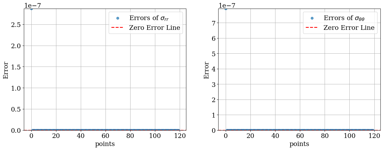

ErrorAnalysis(
    "reference_data_Ex5.csv",
    "sigma_rr",
    "sigma_tt",
    r"Errors of $\sigma_{rr}$",
    "Errors of $\\sigma_{\\theta \\theta}$",
    tol=1e-6,
Continue with the rest of the code. Mean Error: 4.49470093047308e-09

ErrorAnalysis(
    "analytical_data_Ex5.csv",
    "sigma_rr",
    "sigma_tt",
    tol=5e-1,
Continue with the rest of the code. Mean Error: 0.012070187784180824
