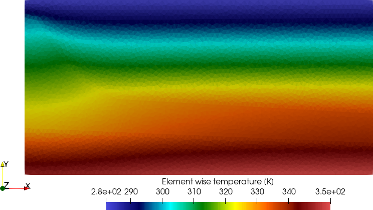

The reference temperature is shown in the following figure:

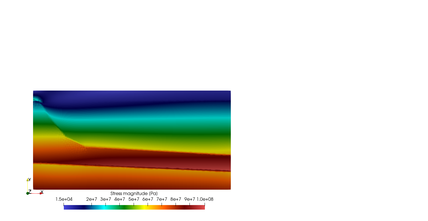

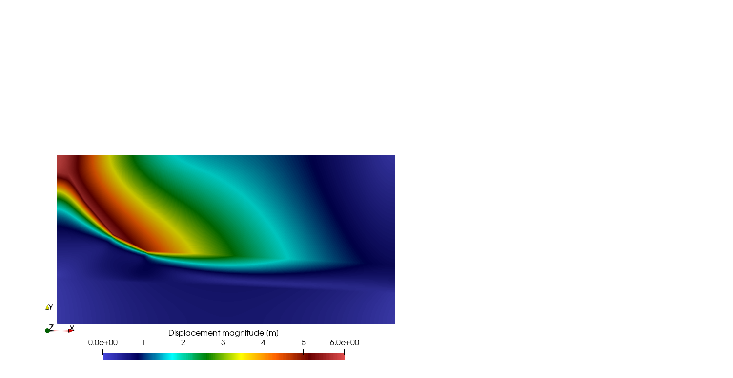

The following two figures shown the results of stress magnitude and displacement magnitude at the last time step:
