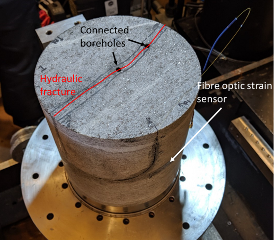

The GREAT cell is designed to reproduce subsurface conditions in the laboratory down to a depth of 3.5 km, simulating both geomechanical stress and geothermal reservoir conditions on 200 mm diameter rock samples that contain fracture networks. This enables validation of numerical predictions under realistic conditions.
The GREAT cell represents a major advancement in experimental geomechanics technology. It uniquely:
  • Generates a truly poly-axial rotating stress field
  • Facilitates fluid flow through the rock samples
  • Employs state-of-the-art fibre-optic strain sensing for high-resolution circumferential strain measurements
  • Records fluid pressure and strain at thousands of data points per hour
This facility enhances understanding of fracture propagation and its effect on fluid flow—key factors in geo-energy applications involving fluid storage or extraction in the subsurface.

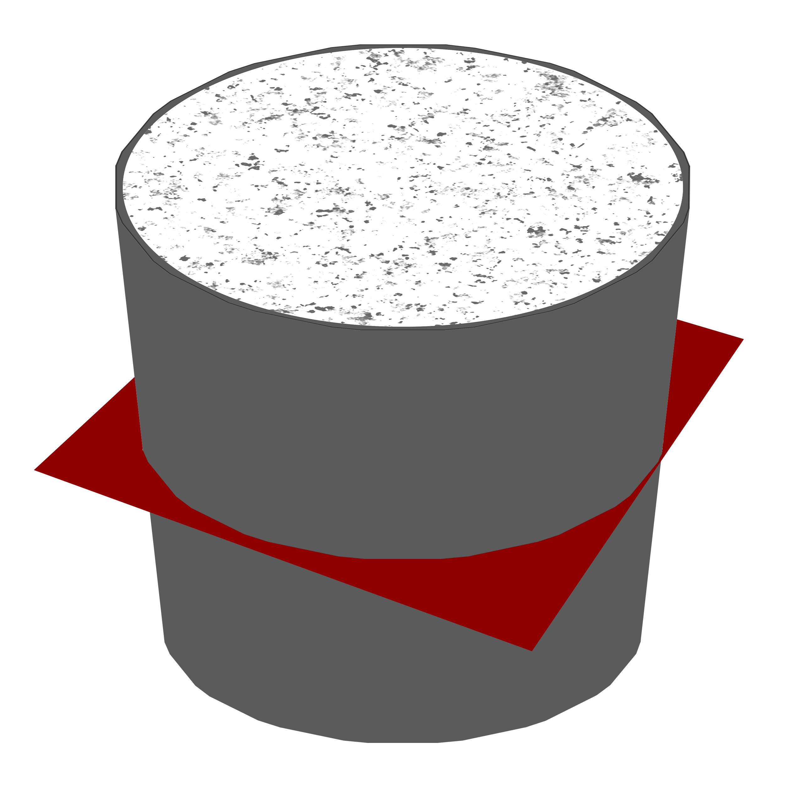

Typical rock sample
(a) Typical rock sample
Schematic cross-section
(b) Simplification for GREAT cell benchmarking
Figure: (a) Typical rock sample and (b) its simplified 3D schematic used for GREAT cell benchmarks. The cross-section (b) aligns with the 2D simulations discussed earlier.

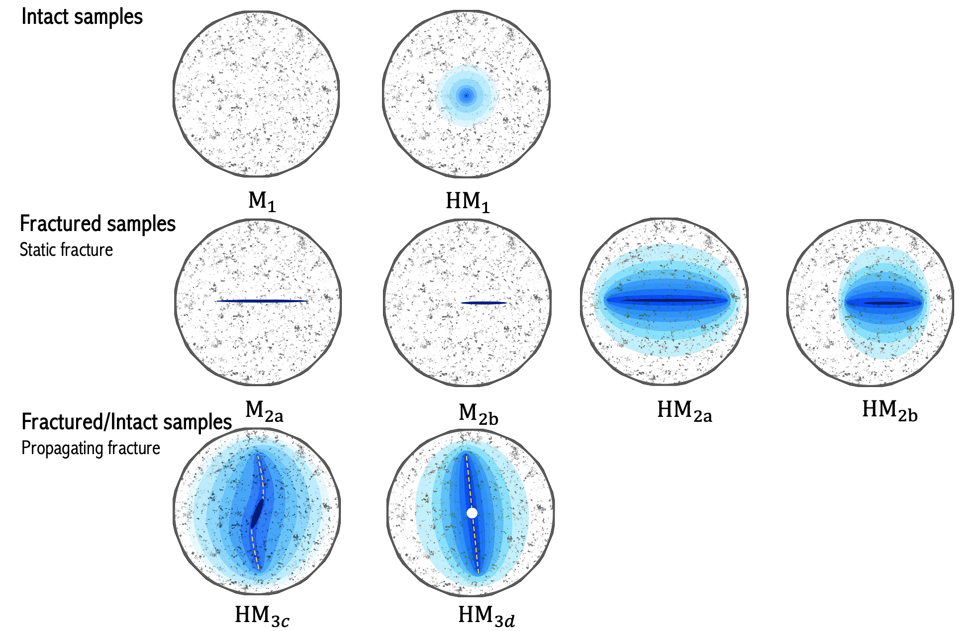

Benchmarking Strategy
A comprehensive benchmarking exercise is performed to establish the models’ capabilities and required settings, such as the required discretization for comparable accuracy. The exercise benchmarks are simplified versions of the GREAT cell experiments, focusing on general features like fracture patterns, rotating boundary conditions, and coupled processes.
These benchmark exercises are conducted in 2D (plane strain), representing a horizontal section through the middle of the rock samples tested in the GREAT cell (see Figure 1). This 2D plane-strain approach allows the main characteristics of hydro-mechanical (HM) fracture mechanics to be studied efficiently. The benchmarking concept involves a stepwise increase in complexity, including both mechanical (M) and hydro-mechanical (HM) approaches.
We distinguish two main types of benchmarks: intact and fractured rock tests (see Figure 2). In the first type, an intact rock sample is subjected to rotating external stress conditions ($\texttt{M}_1$) and fluid is injected from a central borehole ($\texttt{HM}_1$):
  • $\texttt{M}_1$: Intact rock sample under rotating boundary conditions.
  • $\texttt{HM}_1$: Intact rock sample with fluid injection.
For the fractured rock samples, two subtypes are also considered: static and propagating fractures. Static fractures are studied as full ($\texttt{M}_{2a}$, $\texttt{HM}_{2a}$) and half-fractured ($\texttt{M}_{2b}$, $\texttt{HM}_{2b}$) versions to have a symmetric and non-symmetric case. Again, mechanical and hydro-mechanical versions are studied, the latter with fluid injection into the rock fracture:
  • $\texttt{M}_{2a}$: Fully fractured sample.
  • $\texttt{M}_{2b}$: Half-fractured sample.
  • $\texttt{HM}_{2a}$: Fully fractured sample with inflow-outflow.
  • $\texttt{HM}_{2b}$: Half-fractured sample with inflow-outflow.
Finally, fracture propagation conditions are studied by injecting fluid into a pre-existing fracture ($\texttt{HM}_{3c}$) and by initiating a fracture from a borehole ($\texttt{HM}_{3d}$):
  • $\texttt{HM}_{3c}$: Propagation of pre-existing fracture by fluid injection.
  • $\texttt{HM}_{3d}$: Fracture nucleation from borehole by fluid injection.

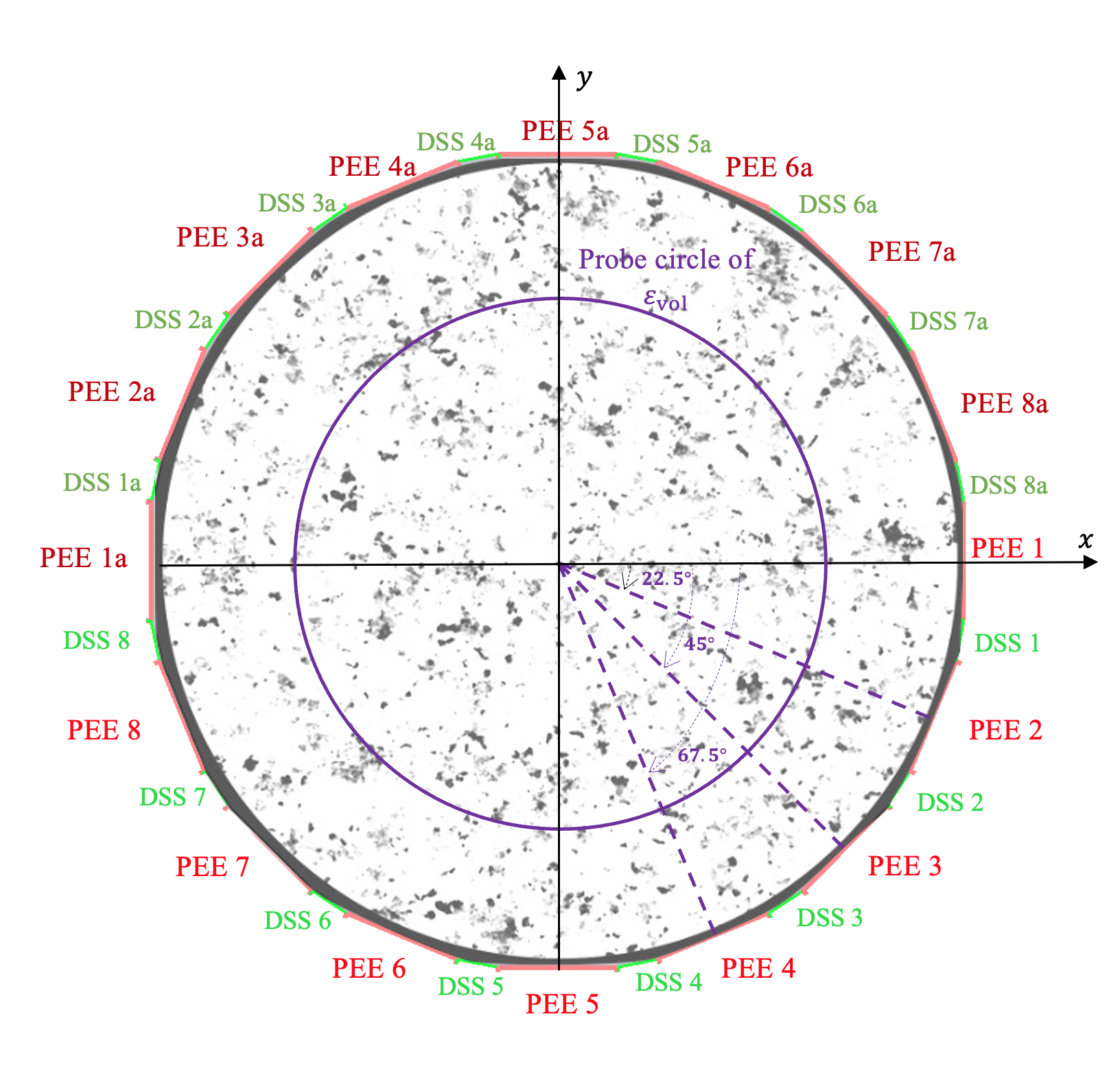

GREAT benchmarks definition
Figure 1:
Three sample types of GREAT cell benchmarks: intact, fractured (static), and propagating. Rotating boundary conditions are applied.
Schematic loading 2D UFZ
Figure 2:
Geometry and location of PEEs and DSSs. Fracture aligned with PEE1/1a direction.

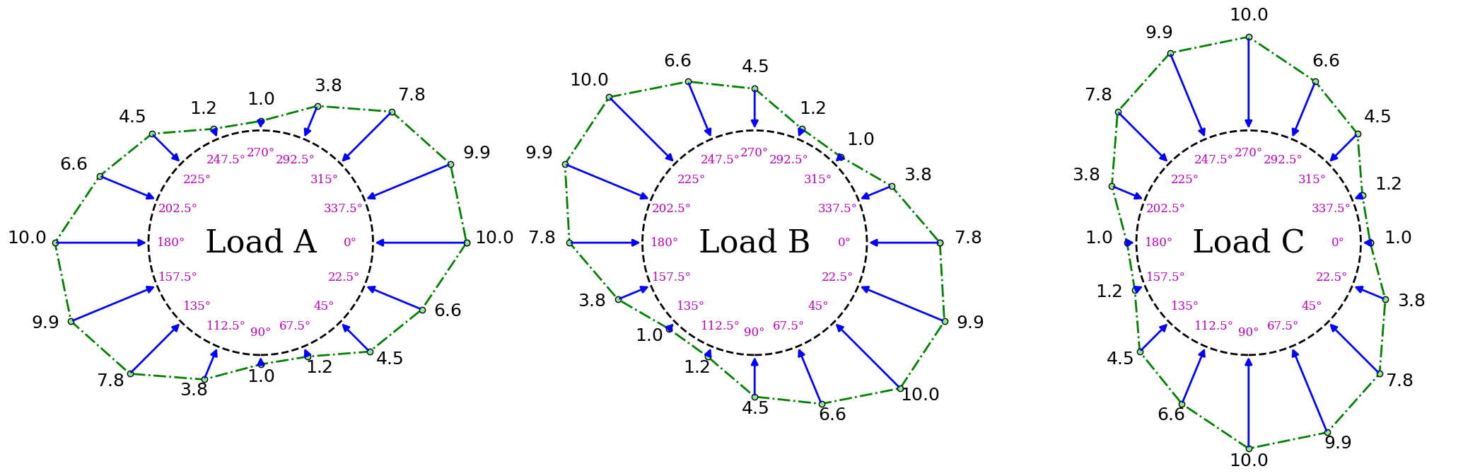

Loads
Table 2: Load Conditions
A 0° 10.0 6.64 4.46 1.17 1.0 3.82 7.80 9.95
E 22.5° 9.95 10.0 6.64 4.46 1.17 1.0 3.82 7.80
B 45.0° 7.80 9.95 10.0 6.64 4.46 1.17 1.0 3.82
C 90° 1.0 3.82 7.80 9.95 10.0 6.64 4.46 1.17
Schematic loading conditions

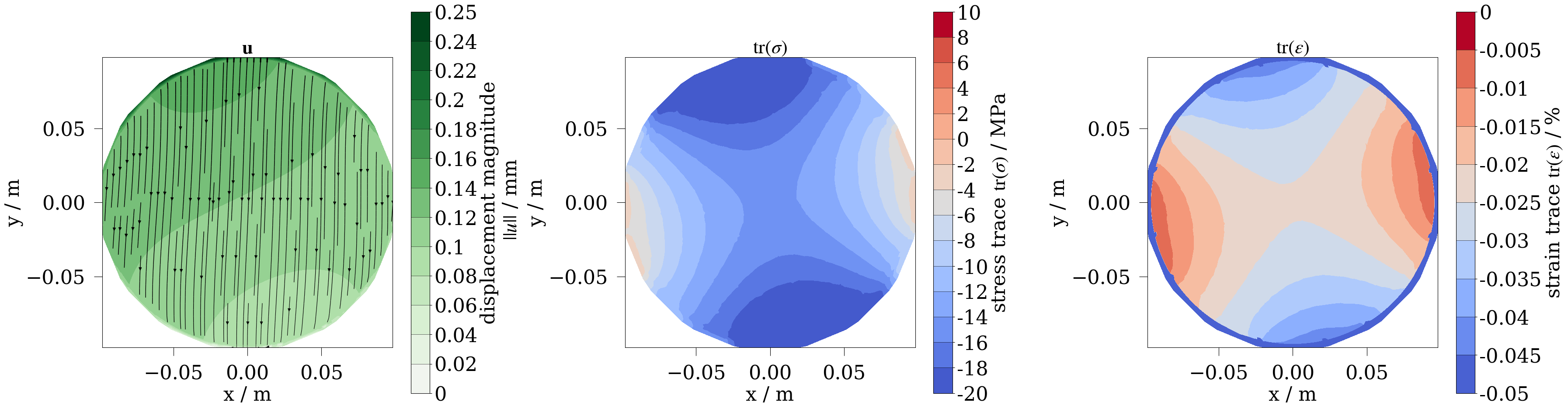

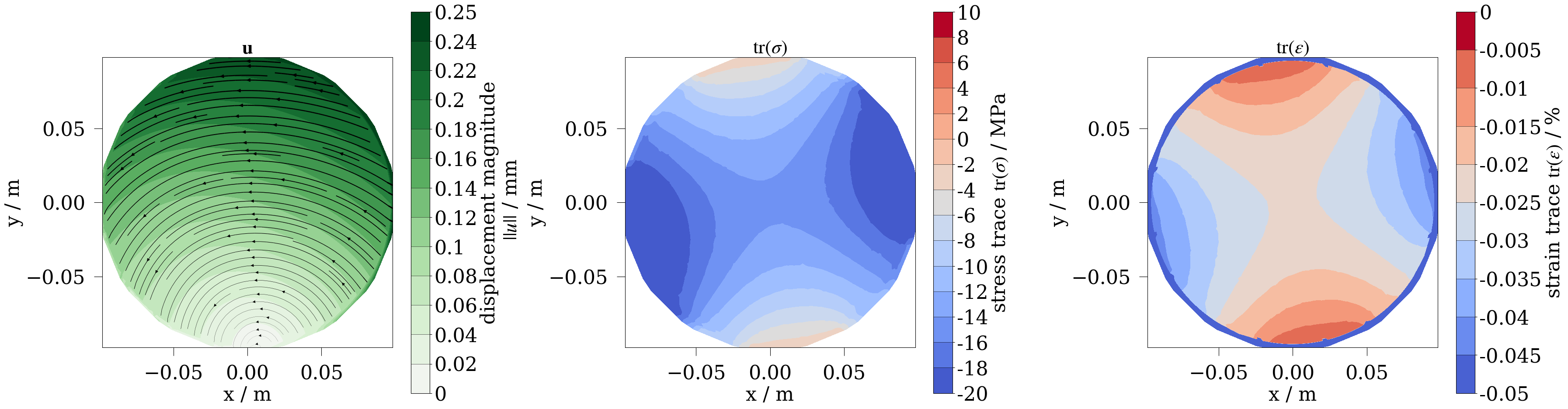

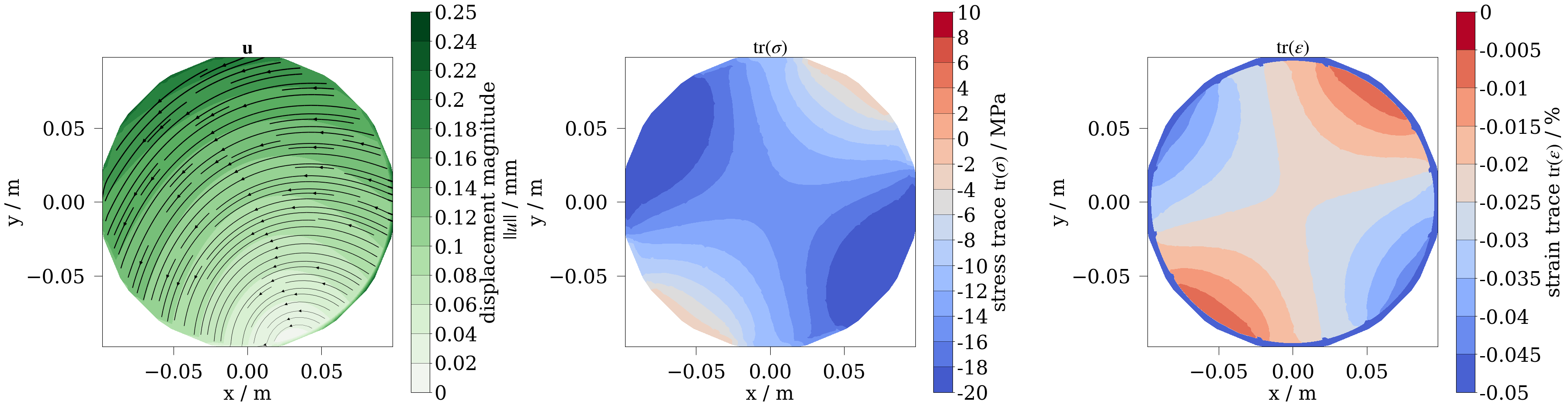

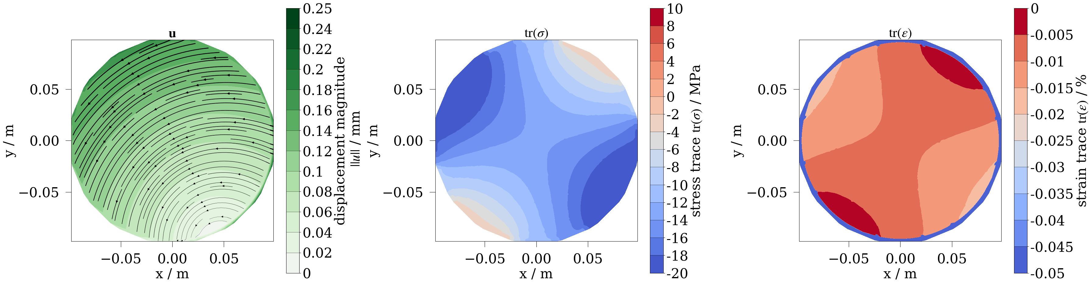

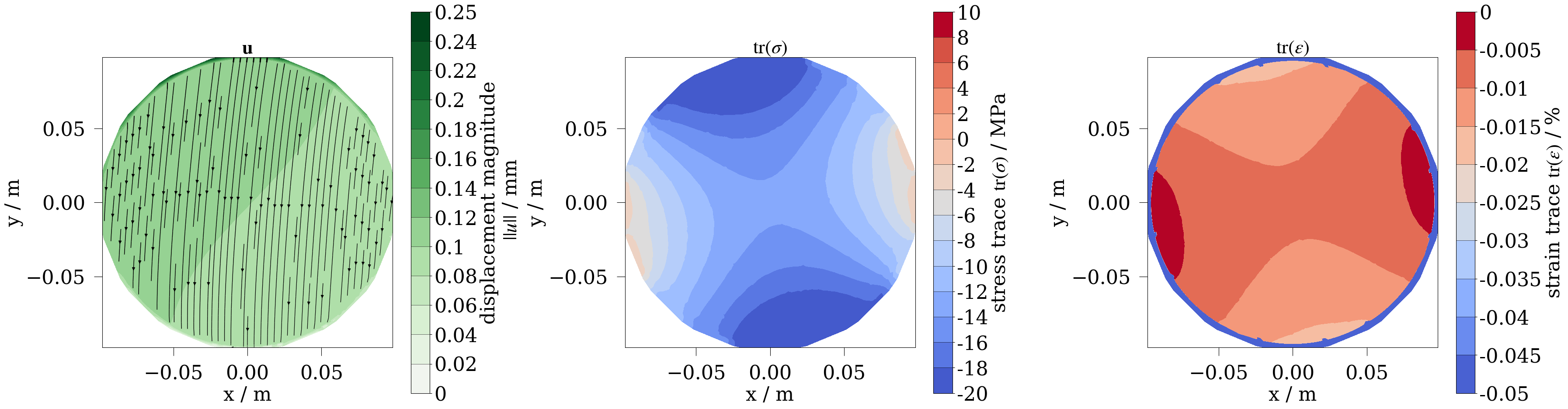

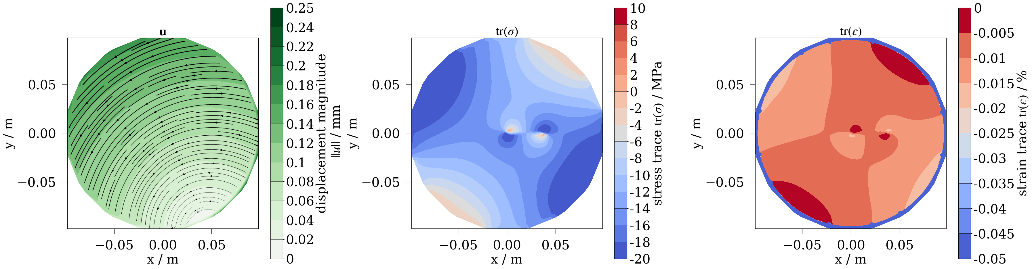

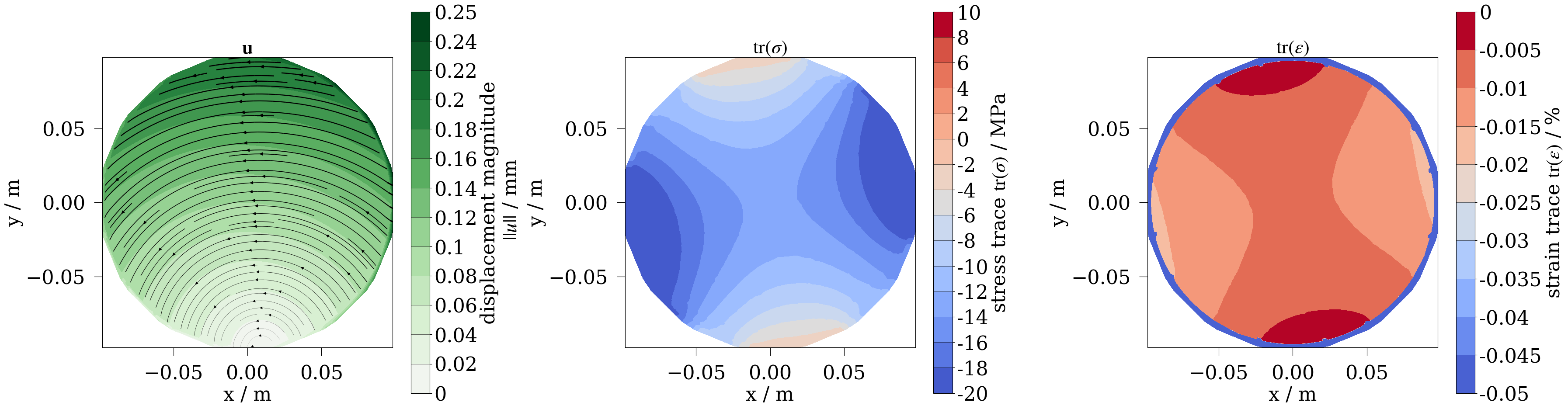

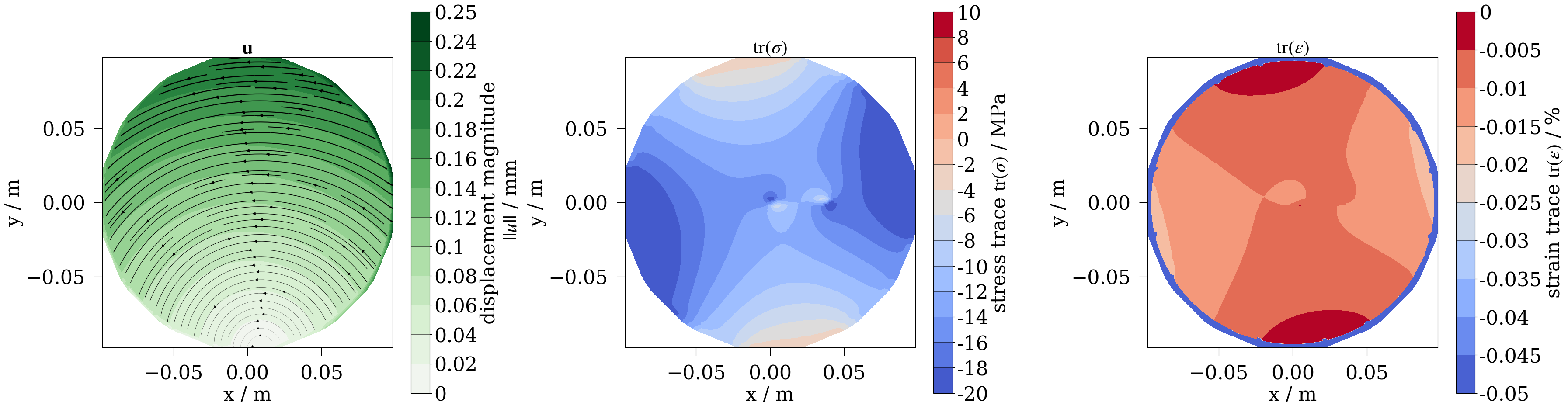

Intact Samples ($\texttt{M}_1$)
The primary objective of the first benchmark exercise is to evaluate the mechanical deformation of different rock samples in the GREAT cell under various boundary conditions in a 2D plane strain setup.
This benchmark considers a plane strain triaxial stress condition, where the in-plane principal stresses are defined as:
$$ \sigma_2 = 10\ \text{MPa},\quad \sigma_3 = 1\ \text{MPa} $$
The out-of-plane stress component, $\sigma_1$, is governed by the plane strain constraint:
$$ \sigma_1 = \nu (\sigma_2 + \sigma_3) $$
This loading condition is applied to both Greywacke and Gneiss samples (see also loading Table referenced in earlier section).

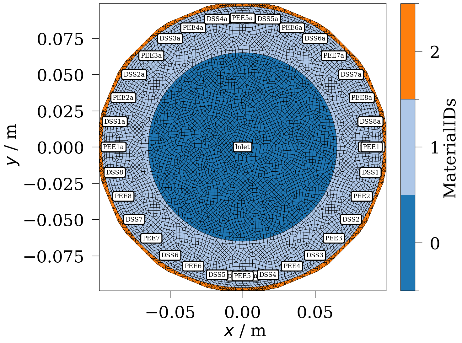

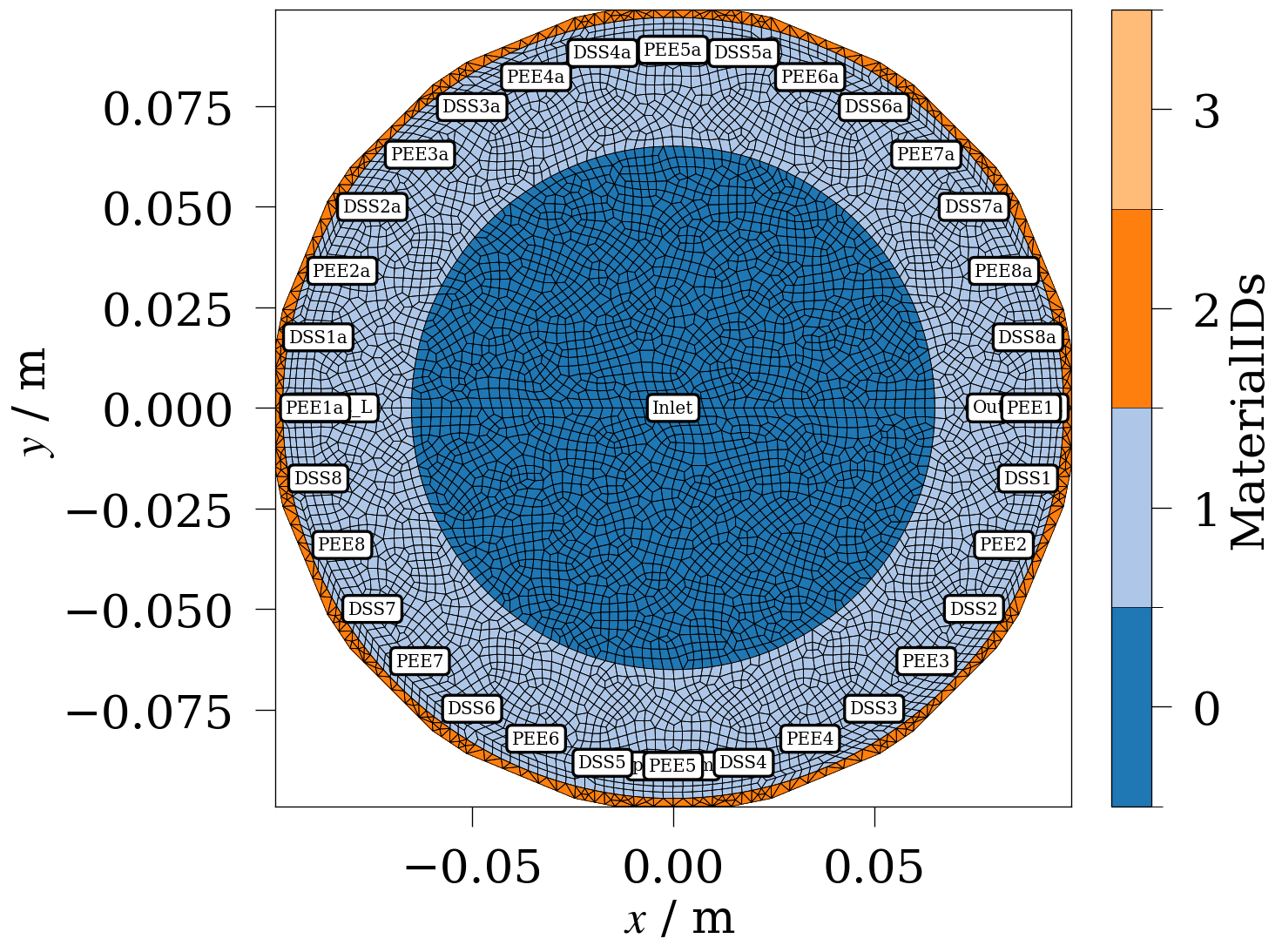

Mesh Generation
Input
h = 0.0025
meshname = "GreatCell"
mesh_id = "mesh_intact"… (click to toggle)
meshes_intact = mesh_GreatCell_intact_meshes(
    lc=0.005,
    lc2=h,
    r0=0.097,
    r1=0.094,
    r2=0.090,
    r3=0.065,
    out_dir=(out_dir / "gmsh" / mesh_id).resolve(),
    meshname=meshname,
meshes_intact.save(out_dir / f"Meshes/{mesh_id}", overwrite=True)

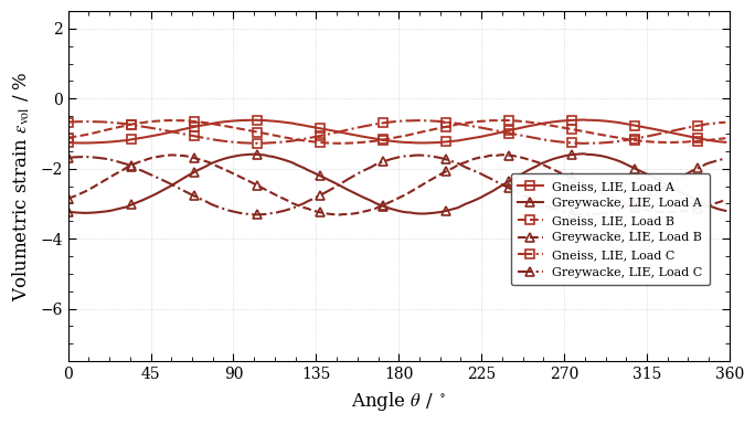

Volumetric strain vs angle at probe circle
json_path = Path("./external_data_dict.py").resolve()… (click to toggle)
print(f"[DEBUG] Trying path: {json_path}")
if json_path.exists():
    from external_data_dict import external_data
    print("[WARNING] External data dict not found! Skipping...")
    external_data = None
plotter = Plotter(
    output_dir=out_dir,
    save_extracted_data=True,
plotter.plot_volumetric_strain_vs_angle(
    vtu_files_dict,
    model_type="M1",
    ylim_range=[-7.5, 2.5],
    layout="subplots",
    external_data=external_data,

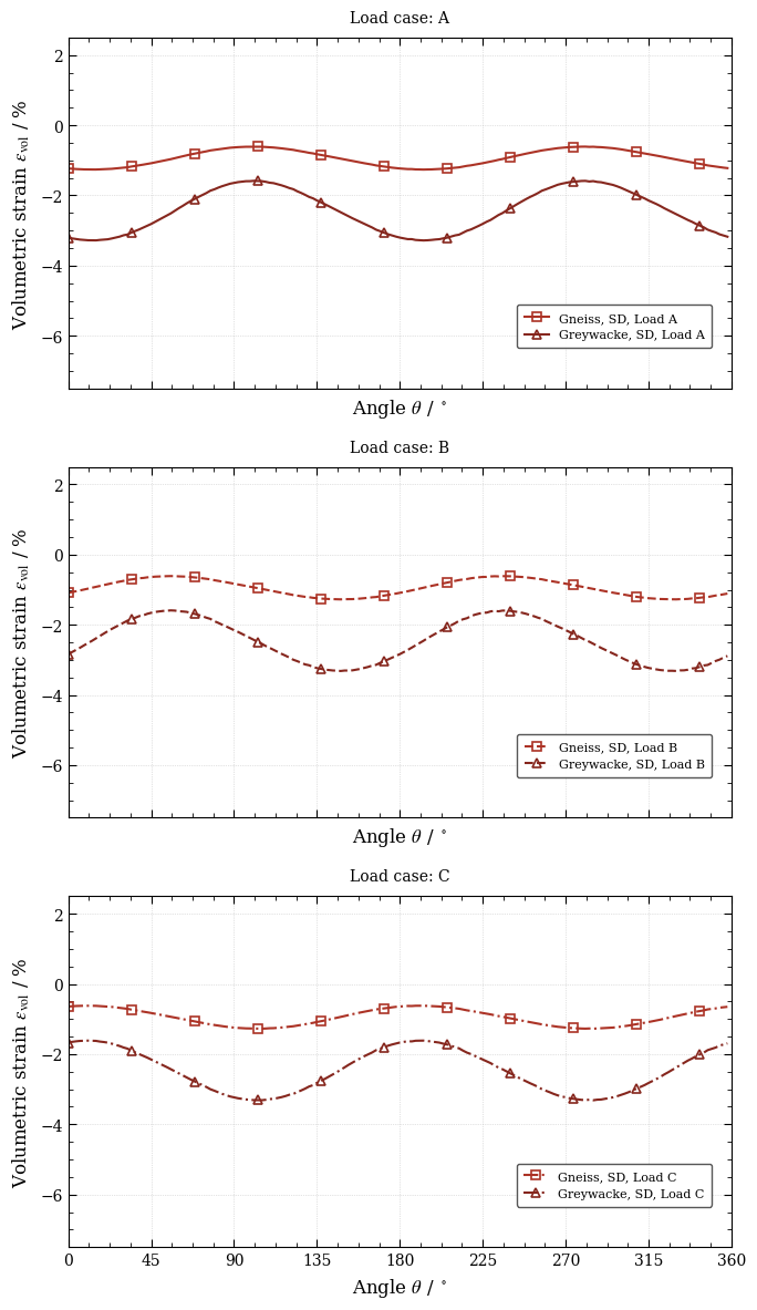

Figure below shows the results of this benchmark:

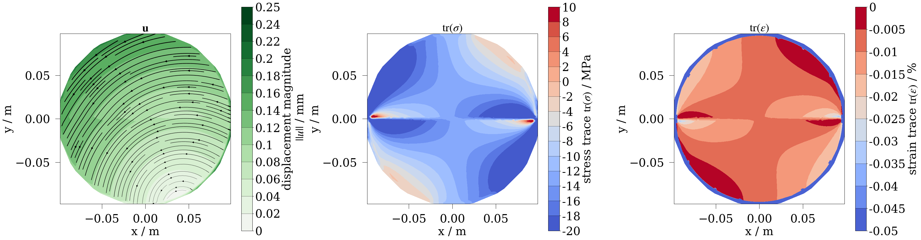

  • The trace of effective stress, defined as $\sum_{i=x,y,z} \sigma'_{ii}$,
  • and the corresponding volumetric strain plotted versus loading angle,
  • for both Greywacke and Gneiss,
These results are shown for the intact rock samples under $\texttt{M}_1$ loading.
plotter.plot_field_variables(vtu_files_dict)
Load: A, File 0, Benchmark: M1, Material: Gneiss
Load: A, File 1, Benchmark: M1, Material: Greywacke
Load: B, File 0, Benchmark: M1, Material: Gneiss
Load: B, File 1, Benchmark: M1, Material: Greywacke
Load: C, File 0, Benchmark: M1, Material: Gneiss
Load: C, File 1, Benchmark: M1, Material: Greywacke
Half fractured sample ($\texttt{M}_{2b}$)
In this section, all input data and boundary conditions provided in $\texttt{M}_{2b}$, except a single wing fracture, defined as $\Gamma = \left[0, 0.04\right] \times \{0\}$, is considered.
Mesh Generation
mesh_id = "embedded_fracture"… (click to toggle)
meshes_embedded = mesh_GreatCell_embeddedFracture_meshes(
    lc=0.005,
    lc2=h,
    r0=0.097,
    r1=0.094,
    r2=0.090,
    r3=0.065,
    meshname=meshname,
plot_contourf_with_annotations(meshes_embedded)
meshes_embedded.save(out_dir / f"Meshes/{mesh_id}", overwrite=True)

Run the simulation
Input
# Times for load curves… (click to toggle)
times = "0.0  1000. 3500"
simulation_end_time = 3500.0
n_fracture_p_ncs = 3
model_type = "M2b"
output_prefix = "M2b_LIE"
# Load
PEE_load_values = {
# Project file
prj_file = Path("M2_LIE.prj")
Run OGS
vtu_files_dict_embedded = SingleOGSModel.run_simulations_with_fracture(… (click to toggle)
    times=times,
    base_project_file=prj_file,
    mesh_path=meshes_embedded.active_target.resolve(),
    load_cases=PEE_load_values,
    materials=materials,
    model_type=model_type,
    output_prefix=output_prefix,
    out_dir=out_dir,
    use_b_bar_value="true",
    tension_cutoff="true",
[DEBUG] Current working directory: /var/lib/gitlab-runner/builds/t1_R7hwLX/1/ogs/ogs/Tests/Data/LIE/Mechanics/GreatCelljupyterNotebook
[DEBUG] output project file: /var/lib/gitlab-runner/builds/t1_R7hwLX/1/ogs/build/release-all/Tests/Data/LIE/Mechanics/GreatCelljupyterNotebook/GreatCellM/M2b_LIE_A.prj
Running simulation for load case: A with method: LIE, tension_cutoff: true
 ogs -o /var/lib/gitlab-runner/builds/t1_R7hwLX/1/ogs/build/release-all/Tests/Data/LIE/Mechanics/GreatCelljupyterNotebook/GreatCellM -m /var/lib/gitlab-runner/builds/t1_R7hwLX/1/ogs/build/release-all/Tests/Data/LIE/Mechanics/GreatCelljupyterNotebook/GreatCellM/Meshes/embedded_fracture /var/lib/gitlab-runner/builds/t1_R7hwLX/1/ogs/build/release-all/Tests/Data/LIE/Mechanics/GreatCelljupyterNotebook/GreatCellM/M2b_LIE_A.prj
['ogs', '-o', '/var/lib/gitlab-runner/builds/t1_R7hwLX/1/ogs/build/release-all/Tests/Data/LIE/Mechanics/GreatCelljupyterNotebook/GreatCellM', '-m', '/var/lib/gitlab-runner/builds/t1_R7hwLX/1/ogs/build/release-all/Tests/Data/LIE/Mechanics/GreatCelljupyterNotebook/GreatCellM/Meshes/embedded_fracture', '/var/lib/gitlab-runner/builds/t1_R7hwLX/1/ogs/build/release-all/Tests/Data/LIE/Mechanics/GreatCelljupyterNotebook/GreatCellM/M2b_LIE_A.prj']
* Running the simulation for sample Greywacke:
[DEBUG] output project file: /var/lib/gitlab-runner/builds/t1_R7hwLX/1/ogs/build/release-all/Tests/Data/LIE/Mechanics/GreatCelljupyterNotebook/GreatCellM/M2b_LIE_B.prj
Running simulation for load case: B with method: LIE, tension_cutoff: true
 ogs -o /var/lib/gitlab-runner/builds/t1_R7hwLX/1/ogs/build/release-all/Tests/Data/LIE/Mechanics/GreatCelljupyterNotebook/GreatCellM -m /var/lib/gitlab-runner/builds/t1_R7hwLX/1/ogs/build/release-all/Tests/Data/LIE/Mechanics/GreatCelljupyterNotebook/GreatCellM/Meshes/embedded_fracture /var/lib/gitlab-runner/builds/t1_R7hwLX/1/ogs/build/release-all/Tests/Data/LIE/Mechanics/GreatCelljupyterNotebook/GreatCellM/M2b_LIE_B.prj
['ogs', '-o', '/var/lib/gitlab-runner/builds/t1_R7hwLX/1/ogs/build/release-all/Tests/Data/LIE/Mechanics/GreatCelljupyterNotebook/GreatCellM', '-m', '/var/lib/gitlab-runner/builds/t1_R7hwLX/1/ogs/build/release-all/Tests/Data/LIE/Mechanics/GreatCelljupyterNotebook/GreatCellM/Meshes/embedded_fracture', '/var/lib/gitlab-runner/builds/t1_R7hwLX/1/ogs/build/release-all/Tests/Data/LIE/Mechanics/GreatCelljupyterNotebook/GreatCellM/M2b_LIE_B.prj']
[DEBUG] output project file: /var/lib/gitlab-runner/builds/t1_R7hwLX/1/ogs/build/release-all/Tests/Data/LIE/Mechanics/GreatCelljupyterNotebook/GreatCellM/M2b_LIE_C.prj
Running simulation for load case: C with method: LIE, tension_cutoff: true
 ogs -o /var/lib/gitlab-runner/builds/t1_R7hwLX/1/ogs/build/release-all/Tests/Data/LIE/Mechanics/GreatCelljupyterNotebook/GreatCellM -m /var/lib/gitlab-runner/builds/t1_R7hwLX/1/ogs/build/release-all/Tests/Data/LIE/Mechanics/GreatCelljupyterNotebook/GreatCellM/Meshes/embedded_fracture /var/lib/gitlab-runner/builds/t1_R7hwLX/1/ogs/build/release-all/Tests/Data/LIE/Mechanics/GreatCelljupyterNotebook/GreatCellM/M2b_LIE_C.prj
['ogs', '-o', '/var/lib/gitlab-runner/builds/t1_R7hwLX/1/ogs/build/release-all/Tests/Data/LIE/Mechanics/GreatCelljupyterNotebook/GreatCellM', '-m', '/var/lib/gitlab-runner/builds/t1_R7hwLX/1/ogs/build/release-all/Tests/Data/LIE/Mechanics/GreatCelljupyterNotebook/GreatCellM/Meshes/embedded_fracture', '/var/lib/gitlab-runner/builds/t1_R7hwLX/1/ogs/build/release-all/Tests/Data/LIE/Mechanics/GreatCelljupyterNotebook/GreatCellM/M2b_LIE_C.prj']
Post-processing
plotter = Plotter(… (click to toggle)
plotter = Plotter(
    output_dir=out_dir,
    vtu_files_dict_embedded,
    model_type="M2b",
    layout="single",

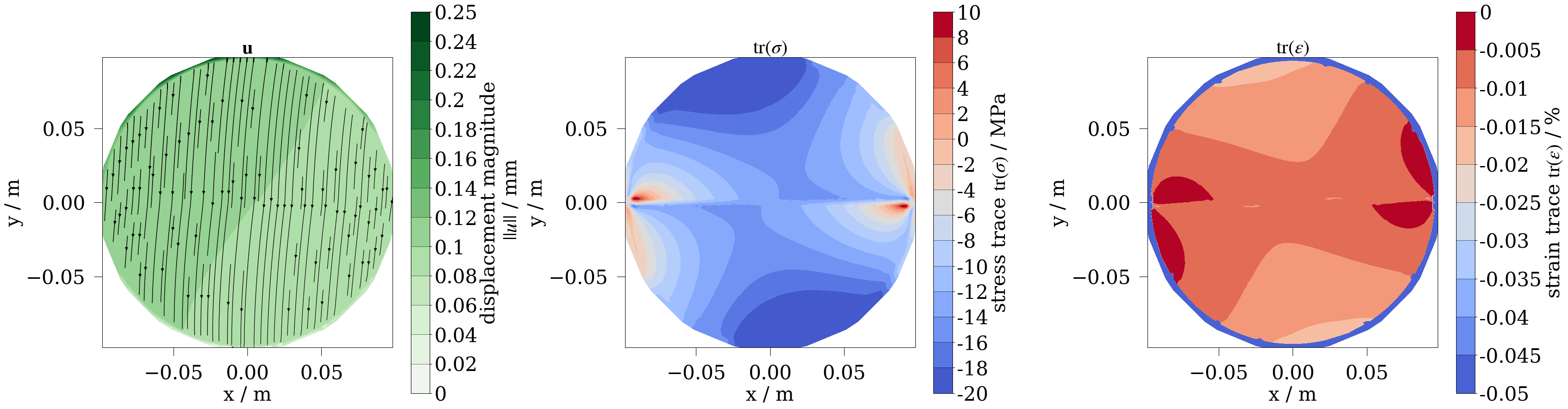

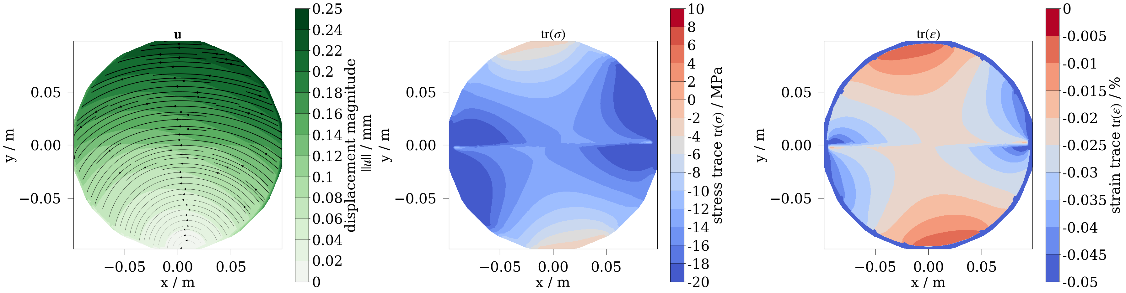

Profiles
plotter.plot_field_variables(vtu_files_dict_embedded)
Load: A, File 0, Benchmark: M2b, Material: Gneiss
Load: A, File 1, Benchmark: M2b, Material: Greywacke
Load: B, File 0, Benchmark: M2b, Material: Gneiss
Load: B, File 1, Benchmark: M2b, Material: Greywacke
Load: C, File 0, Benchmark: M2b, Material: Gneiss
Load: C, File 1, Benchmark: M2b, Material: Greywacke
Fully fractured sample ($\texttt{M}_{2a}$)
In this benchmark, 2D plane strain numerical simulations are performed to establish a baseline model for assessing the impact of fracture orientation on strain distribution under poly-axial loading. A planar fracture within the specimen, $\Gamma = \left[-0.094, 0.094\right] \times \{0\}$, is considered, under poly-axial loading applied on PEE’s and DSS’s

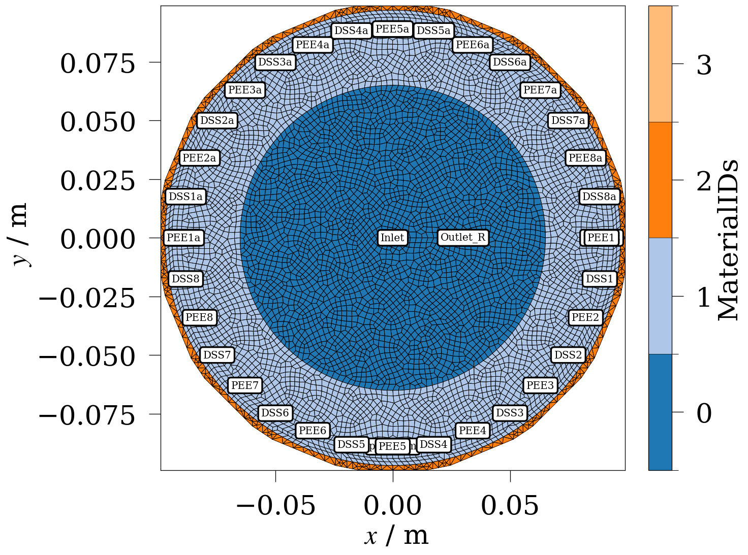

Mesh Generation
Input
mesh_id = "fullFracture"… (click to toggle)
meshes_full = mesh_GreatCell_fullFracture_meshes(
    lc=0.005,
    lc2=h,
    r0=0.097,
    r1=0.094,
    r2=0.090,
    r3=0.065,
    meshname=meshname,
plot_contourf_with_annotations(meshes_full)
meshes_full.save(out_dir / f"Meshes/{mesh_id}", overwrite=True)

Post-processing
plotter = Plotter(
    output_dir=out_dir,
    vtu_files_dict_full,
    model_type="M2a",
    layout="subplots",
Profiles
plotter.plot_field_variables(vtu_files_dict_full)
