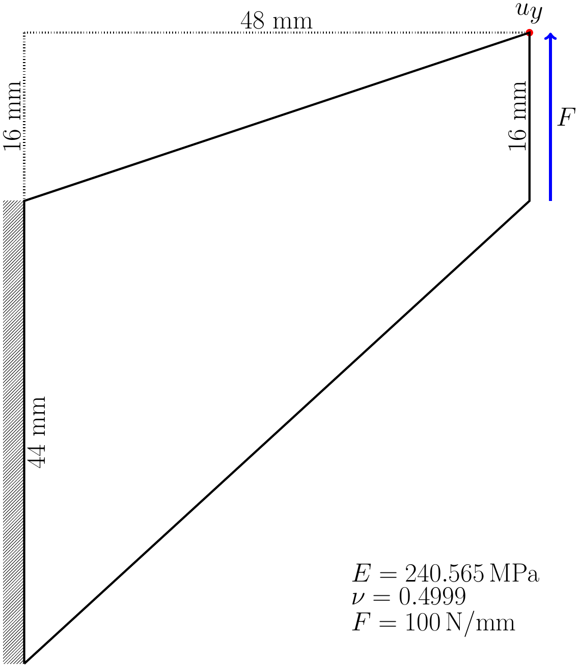

To verify the implementation of the B bar method, the so called Cook’s membrane is used as a benchmark. Illustrated in the following figure, this example simulates a tapered and swept panel of unit thickness. The left edge is clamped and the right edge is applied with a distributed shearing load $F$ = 100 N/mm. The plane strain condition is considered. This numerical model is exactly the same as that is presented in the paper by T. Elguedj et al [1,2].

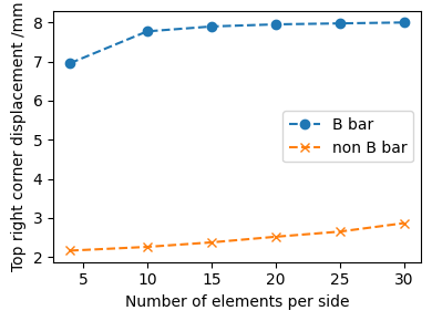

Result

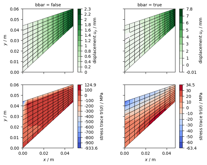

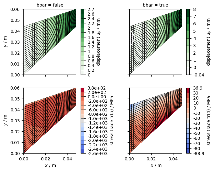

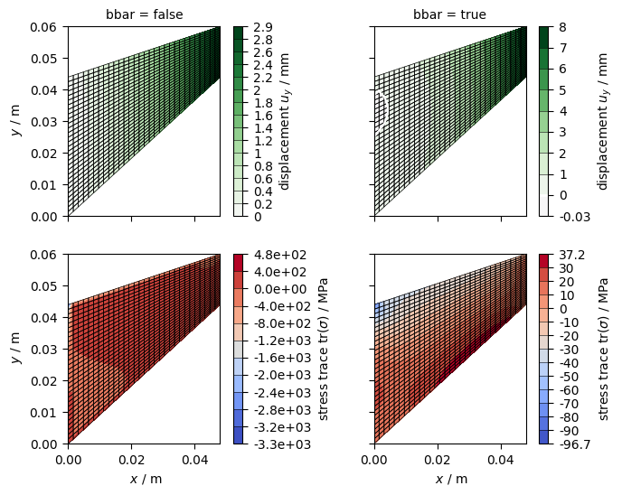

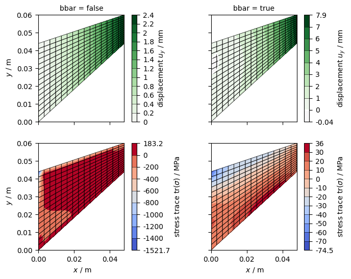

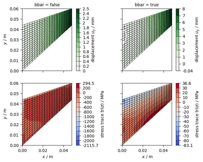

The following figure shows that the convergence of the solutions obtained by using the B bar method follows the one presented in the paper by T. Elguedj et al [1]. However, the results obtained without the B bar method are quit far from the converged solution with the finest mesh.
fig, ax = plt.subplots(figsize=(4, 3))… (click to toggle)
ax.plot(n_range, np.asarray(uy_top_bbar_true) * 1e3, "--o", label="B bar")
ax.plot(n_range, np.asarray(uy_top_bbar_false) * 1e3, "--x", label="non B bar")
ax.legend()

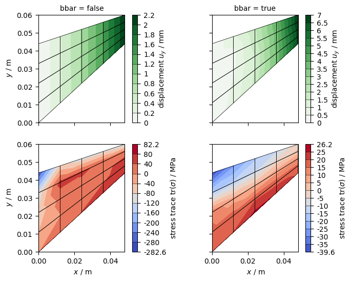

Comparison of results
for n in n_range:
    compare(results_bbar_false[n][-1], results_bbar_true[n][-1])
The contour plots show that even with the coarsest mesh, the B bar method still gives reasonable stress results.
