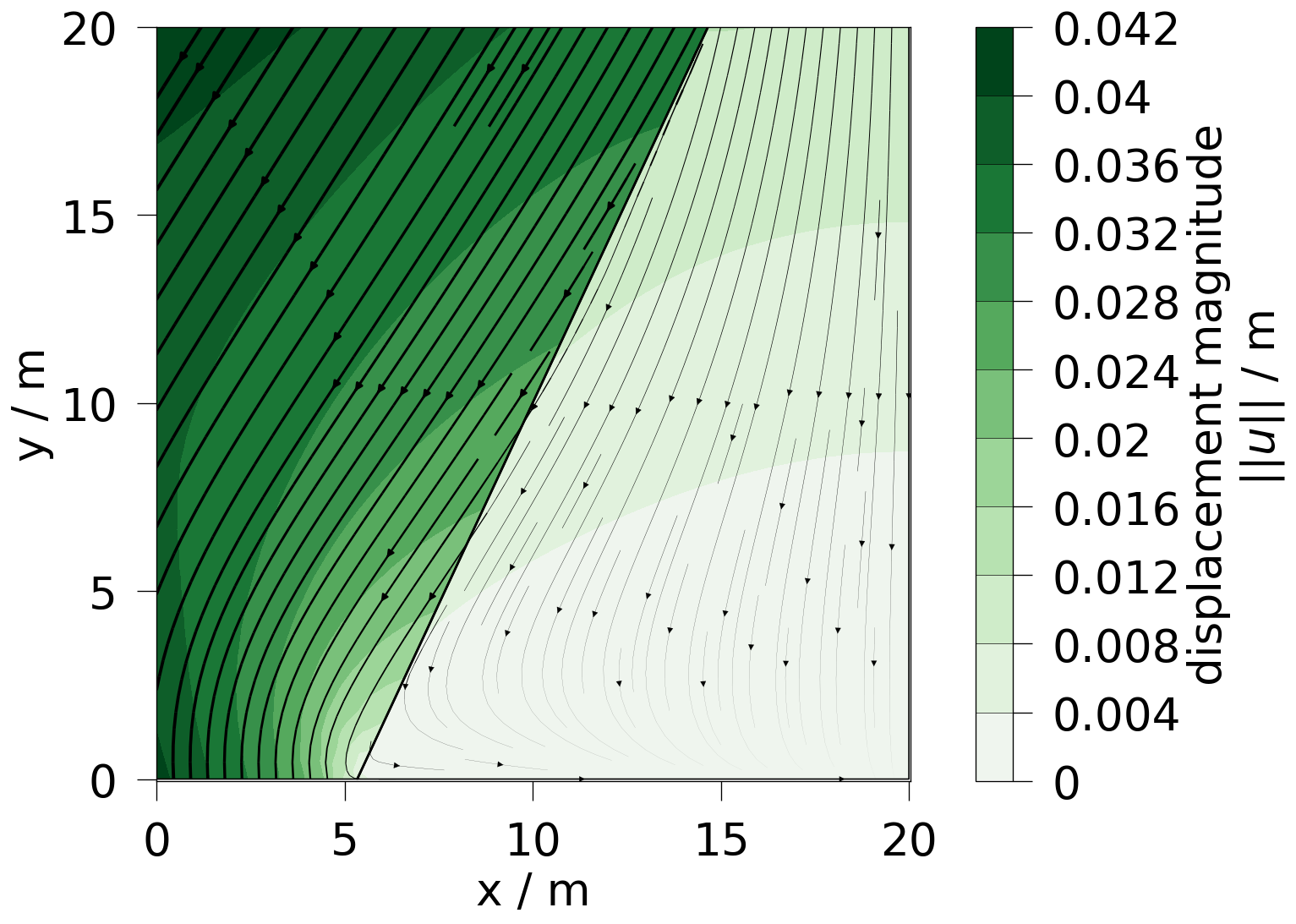

The problem consists of a rectangular model domain divided by a weakness plan. While the right part is fixed at the bottom and the right side, the left part is only controlled by Neumann traction forces. A force pushing at the top on both sides causes a slipping of the slope. This slip can be prevented by fixing the left part using one-dimesional anchor elements to the fixed side.
sketch

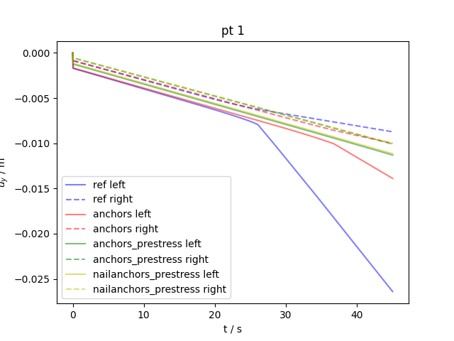

The following plot shows the difference in the displacement of the left and the right side without anchors, with relaxed and prestressed anchors. (Keep in mind that the simulation time in the ctest was shortened for faster executions in the ci-test pipeline. Details can be found in the reference prj file: fault_slip_SD_noniterWP_reference.prj)
Displacement Graph
