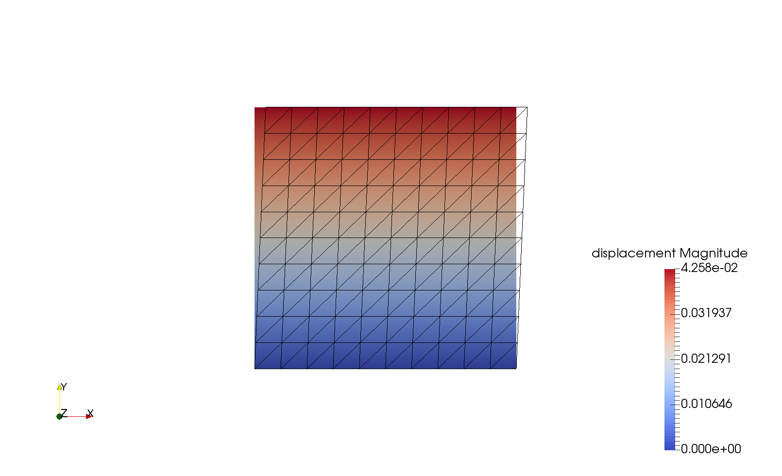

We solve a non-linear small deformation problem on a cube with shear traction on the top boundary face. The 3D problem is setup identical to the corresponding 2D problem.
Result showing the displacement field and distortion relative to the initial configuration:
