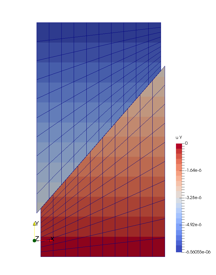

Result showing sliding of the upper part of the domain along the fracture:

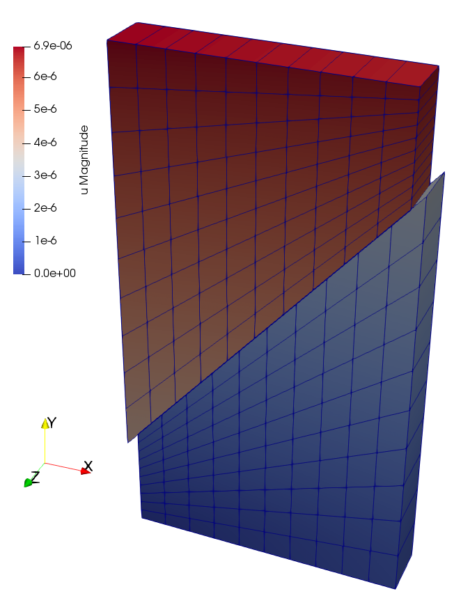

Same benchmark setup with plane strain conditions in 3D:

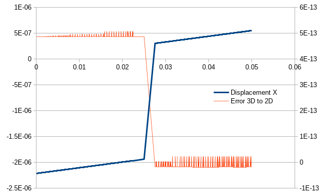

Comparison with 2D setup yields identical results (up to numerical differences in order of 1e-15); Resulting displacement on the left axis, and error on the right:
