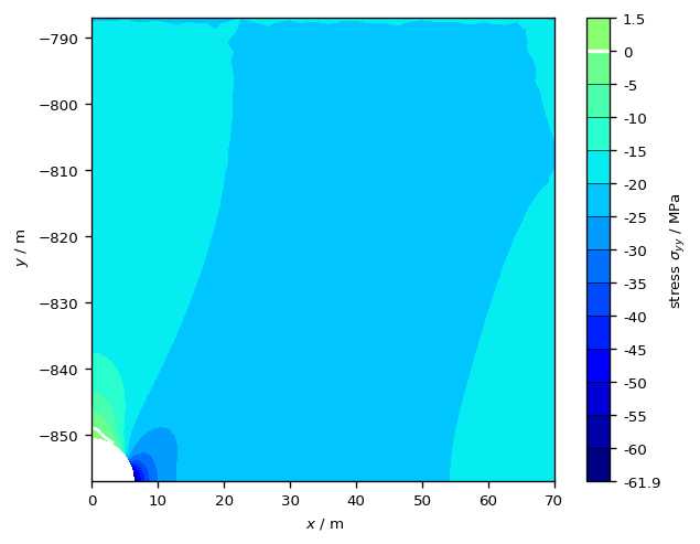

fig = ot.plot.contourf(
mesh_last,
figsize=(6, 4),
fontsize=8,
cmap="jet",
)/var/lib/gitlab-runner/builds/sy3_rc3xP/0/ogs/build/release-petsc/.venv/lib/python3.14/site-packages/ogstools/meshseries/_meshseries.py:112: RuntimeWarning: This is a parallel (pvtu) result, read natively (fast) instead of merged. This leaves ghost cells/boundary points duplicated, and integration-point data (e.g. '*_ip') may come from only one partition. Pass pvtu2vtu=True for a correctly merged mesh (slower), or pvtu2vtu=False to silence this warning.

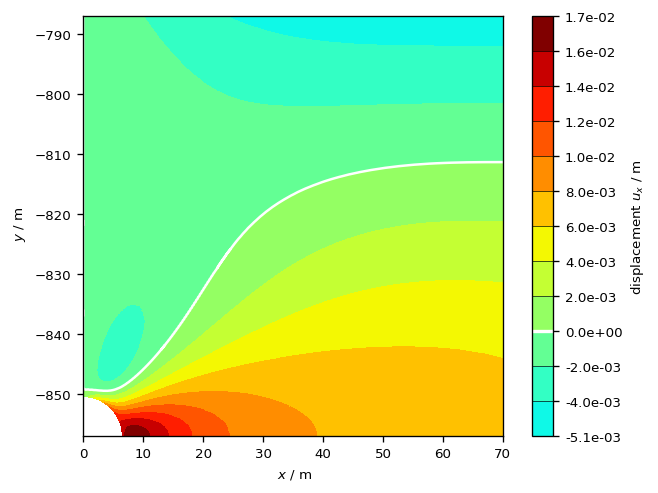

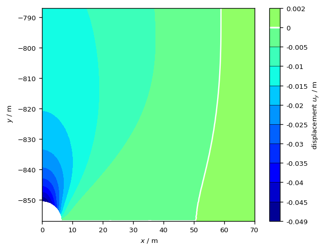

mesh_last, ot.variables.displacement["y"], figsize=(6, 4), fontsize=8, cmap="jet"

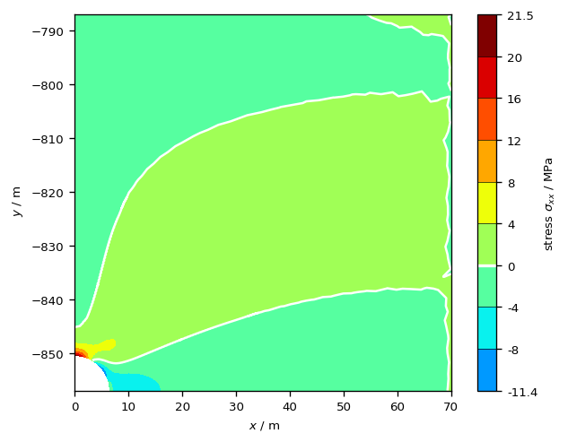

mesh_last, ot.variables.stress["xx"], figsize=(6, 4), fontsize=8, cmap="jet"
mesh_last, ot.variables.stress["yy"], figsize=(6, 4), fontsize=8, cmap="jet"

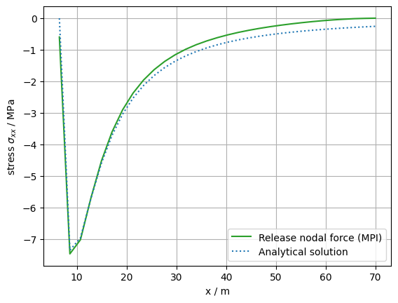

plt.plot(
xs, profile["sigma"][:, 0] * 1e-6, color="C2", label="Release nodal force (MPI)"
a = 6.5
sigma_t = -20 # MPa
sigma_x_a = np.asarray(
[0.5 * (3.0 * a * a / (r * r) - 3 * a**4 / (r**4)) * sigma_t for r in xs],
plt.plot(xs, sigma_x_a, linestyle="dotted", color="C0", label="Analytical solution")
plt.xlabel("x / m")
plt.ylabel(r"stress $\sigma_{xx}$ / MPa")
plt.legend()
plt.grid()
In the above figure, the radial stress $\sigma_r$ profiles along the $\theta = 0^\circ$ axis, obtained using the release nodal force approach, and the analytical solution, are compared.

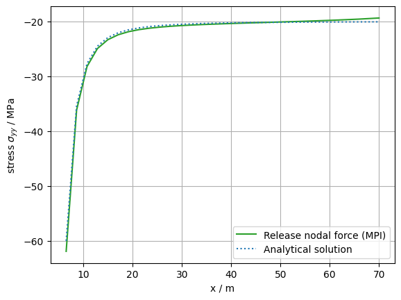

plt.plot(
xs, profile["sigma"][:, 1] * 1e-6, color="C2", label="Release nodal force (MPI)"
a = 6.5
sigma_t = -20 # MPa
sigma_y_a = np.asarray(
[0.5 * (2 + a * a / (r * r) + 3 * a**4 / (r**4)) * sigma_t for r in xs],
plt.plot(xs, sigma_y_a, linestyle="dotted", color="C0", label="Analytical solution")
plt.xlabel("x / m")
plt.ylabel(r"stress $\sigma_{yy}$ / MPa")
plt.legend()
plt.grid()
In the above two figures, the tangential stress $\sigma_{\theta}$ profiles along the $\theta = 0^\circ$ axis, obtained using the release nodal force approach, and the analytical solution, are compared.
