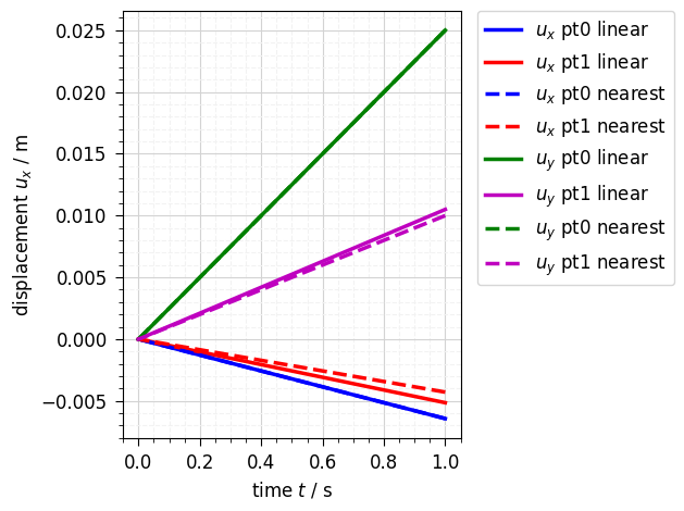

ms = ot.MeshSeries(f"{out_dir}/{prj_name}.pvd")…
(click to toggle)
points_labels = ["pt0", "pt1"]
fig, ax = plt.subplots(nrows=1, ncols=1)…
(click to toggle)
colors = {"x": ["b", "r"], "y": ["g", "m"]}
linestyles = {"linear": "-", "nearest": "--"}
for component in ["x", "y"]:
for interp_method in ["linear", "nearest"]:
labels = [f"$u_{component}$ {label} {interp_method}" for label in points_labels]
ms_pts = ot.MeshSeries.probe(ms, points_coords, interp_method=interp_method)
ot.plot.line(
ms_pts,
ot.variables.displacement[component],
labels=labels,
ax=fig.axes[0],
colors=colors[component],
linestyle=linestyles[interp_method],
fontsize=12,
outer_legend=True,
