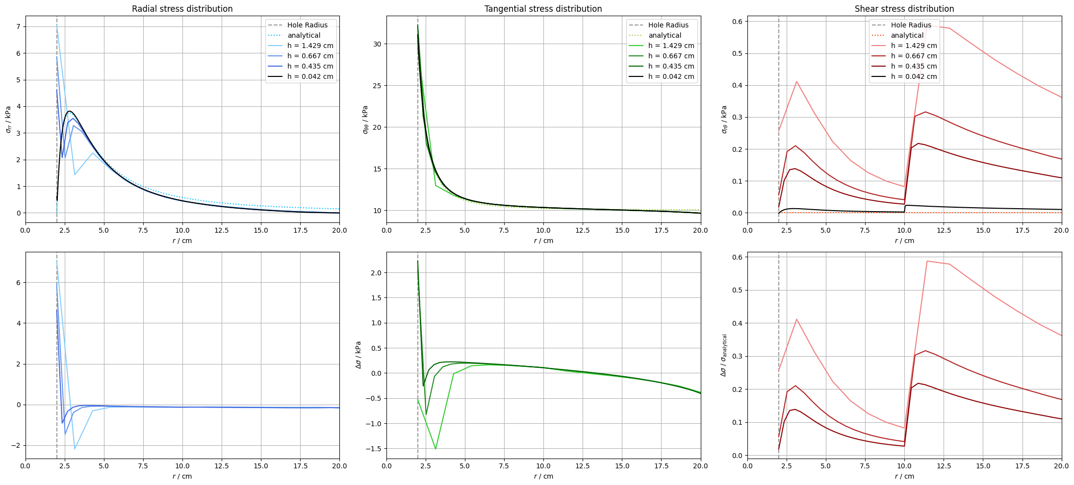

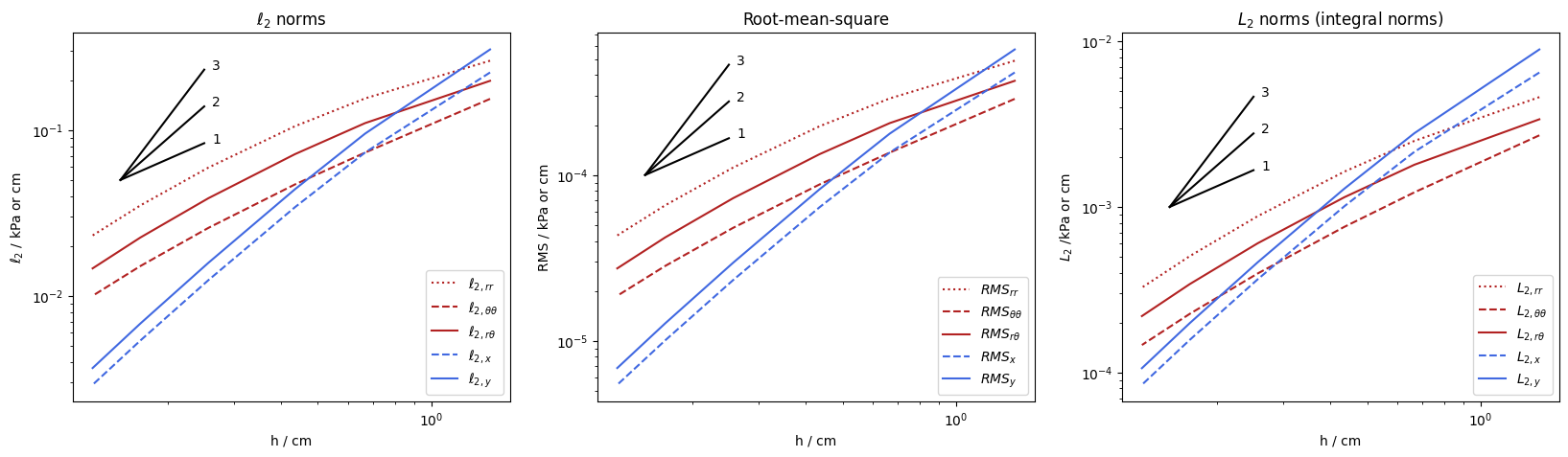

Convergence Analysis: Disc with a hole
For many typical engineering problems that need to be solved using numerical techniques, convergence plays a decisive role. It is important to obtain an accurate numerical solution, i.e., to know the mesh refinement level beyond which the results of the numerical analysis do not change significantly, anymore.
In this study the convergence in stress and displacement values for the disc with hole problem are analysed and compared to each other. This study is based on the accomanying Jupyter notebook “Linear_Disc_with_hole.ipynb”, which explains the main features of the analytical and numerical solution of the disc with hole problem. For a better access to the solutions used in this document, it is recommended to read through the previously mentioned Jupyter notebook first.
For the evaluation of the stress and displacement convergence, we consider seven steps of mesh refinement, described by an index parameter. The following table lists each refinement index with the corresponding edge length, which is considered representative of the cell size.
$$ \begin{aligned} &\begin{array}{cccc} \text {Refinement Index} & \text {Cell Size [cm]} \\ \hline 8 & 1.429 \\ 16 & 0.667 \\ 24 & 0.435 \\ 40 & 0.256 \\ 60 & 0.169 \\ 80 & 0.127 \\ 240 & 0.042 \\ \end{array} \end{aligned} $$

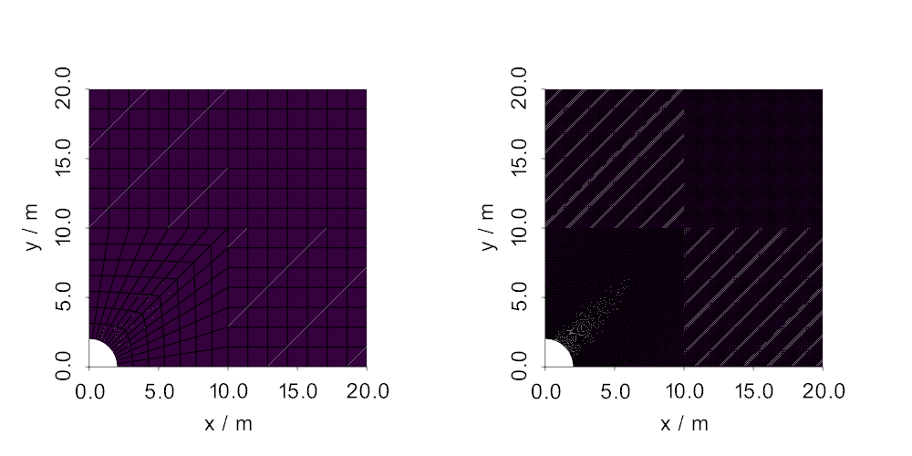

Create Gmsh meshes
To generate the meshes and to enable the individual parameters to be adjusted from within this notebook the script “mesh_quarter_of_rectangle_with_hole.py” is used. For the considered problem the parameter $a$ and $b$ which define the size of the rectangular quarter of the plate are set to a value of $20\, \text{cm}$. The radius of the central hole is controlled by the value of $r$, which is set at $r = 2\, \text{cm}$.
The arguments Nx, Ny, NR and Nr of the script describe the refinement of the mesh and are determined according to each refinement index.
Parameter $R$ describes the area for a further refinement in the vicinity of the hole. This additional refinement is needed for better capturing the stress and strain gradients near the hole. Because the fine resolution of the mesh is only needed in the area around the hole, the size of $R$ is half the size of the plate.

Transform to VTU meshes suitable for OGS
Visualize the meshes
To get a better sense of cell sizes and the additional refinement around the hole, the meshes of refinement indices 8 and 80 are shown below.
if pv.global_theme.trame.server_proxy_enabled:(click to toggle)
domain_8 = meshes_dict[8].domain(click to toggle)
domain_80 = meshes_dict[80].domain
p = pv.Plotter(shape=(1, 2), border=False)(click to toggle)
p.subplot(0, 0)
p.add_mesh(domain_8, show_edges=True, show_scalar_bar=False, color=None, scalars=None)
p.view_xy()
p.show_bounds(ticks="outside", xlabel="x / m", ylabel="y / m")
p.camera.zoom(1.3)
p.subplot(0, 1)
p.add_mesh(domain_80, show_edges=True, show_scalar_bar=False, color=None, scalars=None)
p.view_xy()
p.camera.zoom(1.3)
p.window_size = [1000, 500]
p.show()

Stress distribution along the x-axis
def plot_stress_distribution_along_xaxis():(click to toggle)
    ### Step 1: Compute data ##########################################
    # These variables will hold the error data for all STUDY_indices
    f_abs_rr = {}
    f_abs_tt = {}
    f_abs_rt = {}
    # Plot setup
    fig, ax = plt.subplots(nrows=2, ncols=3, figsize=(22, 10))
    for i in range(2):
        for j in range(3):
            ax[i][j].axvline(2, color="0.6", linestyle="--", label="Hole Radius")
            ax[i][j].grid(True)
            ax[i][j].set(xlim=(0, STUDY_mesh_size))
            ax[i][j].set_xlabel("$r$ / cm")
            ax[i][1].set_ylabel("$\\Delta\\sigma$ / kPa")
            ax[i][2].set_ylabel("$\\Delta\\sigma$ / $\\sigma_{\\mathrm{analytical}}$")
    for iteration, idx in enumerate(STUDY_indices):
        # we use the line mesh we extracted before
        line_mesh = STUDY_num_result_xaxis_meshes_by_index[idx]
        sig_rr, sig_tt, sig_rt = get_sigma_polar_components(line_mesh)
            indices_sorted,
            dist_sorted,
        ) = get_sort_indices_and_distances_by_distance_from_origin_2D(line_mesh)
        # sort sigma by distance from origin
        # compute errors
        f_abs_rr, _f_rel_rr = compute_abs_and_rel_stress_error_rr(
            sig_rr_sorted, dist_sorted, -90
        f_abs_tt, _f_rel_tt = compute_abs_and_rel_stress_error_tt(
            sig_tt_sorted, dist_sorted, -90
        f_abs_rt, _f_rel_rt = compute_abs_and_rel_stress_error_rt(
            sig_rt_sorted, dist_sorted, -90
        ### Step 2: Plot data ##############################################
        ax[0][0].set_ylabel("$\\sigma_{rr}$ / kPa")
        ax[0][1].set_ylabel("$\\sigma_{\\theta\\theta}$ / kPa")
        ax[0][2].set_ylabel("$\\sigma_{r\\theta}$ / kPa")
        # analytical results
        if iteration == 0:
            r = np.linspace(2, STUDY_mesh_size, 1000)
            ax[0][0].plot(
                r,
                kirsch_sig_rr(10, r, -90, 2),
                color="deepskyblue",
                linestyle=":",
                label="analytical",
            ax[0][1].plot(
                r,
                kirsch_sig_tt(10, r, -90, 2),
                color="yellowgreen",
                linestyle=":",
                label="analytical",
            ax[0][2].plot(
                r,
                kirsch_sig_rt(10, r, -90, 2),
                color="orangered",
                linestyle=":",
                label="analytical",
        # numerical results
        cell_size = compute_cell_size(idx, STUDY_num_result_meshes_by_index[idx])
        if idx == 8:
            ax[0][0].plot(
                dist_sorted,
                sig_rr_sorted * 1000,
                color="lightskyblue",
                label=f"h = {cell_size:.3f} cm",
            ax[0][1].plot(
                dist_sorted,
                sig_tt_sorted * 1000,
                color="limegreen",
            ax[0][2].plot(
                dist_sorted,
                sig_rt_sorted * 1000,
                color="lightcoral",
            ax[1][0].plot(dist_sorted, f_abs_rr, color="lightskyblue")
            ax[1][1].plot(dist_sorted, f_abs_tt, color="limegreen")
            ax[1][2].plot(dist_sorted, f_abs_rt, color="lightcoral")
        if idx == 16:
            ax[0][0].plot(
                dist_sorted,
                color="cornflowerblue",
            ax[0][1].plot(
                dist_sorted,
                color="forestgreen",
            ax[0][2].plot(
                dist_sorted,
                color="firebrick",
            ax[1][0].plot(dist_sorted, f_abs_rr, color="cornflowerblue")
            ax[1][1].plot(dist_sorted, f_abs_tt, color="forestgreen")
            ax[1][2].plot(dist_sorted, f_abs_rt, color="firebrick")
        if idx == 24:
            ax[0][0].plot(
                dist_sorted,
                color="royalblue",
            ax[0][1].plot(
                dist_sorted,
                color="darkgreen",
            ax[0][2].plot(
                dist_sorted,
                color="darkred",
            ax[1][0].plot(dist_sorted, f_abs_rr, color="royalblue")
            ax[1][1].plot(dist_sorted, f_abs_tt, color="darkgreen")
            ax[1][2].plot(dist_sorted, f_abs_rt, color="darkred")
        if idx == 240:
            ax[0][0].plot(
                dist_sorted,
                color="black",
            ax[0][1].plot(
                dist_sorted,
                color="black",
            ax[0][2].plot(
                dist_sorted,
                color="black",
        # final plot settings
        for i in range(3):
            ax[0][i].legend()
        ax[0][0].set_title("Radial stress distribution")
        ax[0][1].set_title("Tangential stress distribution")
        ax[0][2].set_title("Shear stress distribution")

The following plots represent the development of the Euclidean and Integral norm and $RMS$ for the refinement of the mesh. How fast the considered element converge is expressed by the slope of the lines in the plot. First the detailed discussed error norms for the stresses are visualised and in addition to them the norms for the associated displacements to draw conclusions about the quality of convergence.
The main conclusion that can be drawn is that the solution for the displacements converge significantly faster than those for the stresses. As a practical consequence, it might be possible to get a sufficiently accurate displacement solution already on a relatively coarse mesh, whereas for an accurate stress solution a much finer mesh might be necessary.

def plot_slope_sketch(ax, x0, y0, slopes, xmax=None):(click to toggle)
    """Plot sketch for slopes. All slopes cross at (x0, y0)"""
    if xmax is None:
        xmax = 2 * x0
    xs = np.linspace(x0, xmax, 20)
    for slope in slopes:
        y_ = xs[0] ** slope
        ys = y0 / y_ * xs**slope
        ax.plot(xs, ys, color="black")
        ax.text(xs[-1] * 1.05, ys[-1], slope)
h = np.linspace(size[80], size[8], 1000)(click to toggle)
k = np.linspace(1, 2, 20)
fig, ax = plt.subplots(ncols=3, figsize=(20, 5))
ax[0].plot(
    size.values(),
    l2_rr.values(),
    color="firebrick",
    linestyle=":",
    label=r"$\ell_{2, rr}$",
ax[0].plot(
    size.values(),
    l2_tt.values(),
    color="firebrick",
    linestyle="--",
    label="$\\ell_{2, \\theta\\theta}$",
ax[0].plot(
    size.values(),
    l2_rt.values(),
    color="firebrick",
    label="$\\ell_{2, r\\theta}$",
ax[0].plot(
    size.values(),
    l2_x.values(),
    color="royalblue",
    linestyle="--",
    label=r"$\ell_{2, x}$",
ax[0].plot(size.values(), l2_y.values(), color="royalblue", label=r"$\ell_{2, y}$")
plot_slope_sketch(ax[0], 1.5e-1, 5e-2, [1, 2, 3], xmax=2.5e-1)
ax[0].set_title(r"$\ell_2$ norms")
ax[0].set_ylabel(r"$\ell_2$ / kPa or cm")
ax[1].plot(
    size.values(),
    rms_rr.values(),
    color="firebrick",
    linestyle=":",
    label="$RMS_{rr}$",
ax[1].plot(
    size.values(),
    rms_tt.values(),
    color="firebrick",
    linestyle="--",
    label="$RMS_{\\theta\\theta}$",
ax[1].plot(size.values(), rms_rt.values(), color="firebrick", label="$RMS_{r\\theta}$")
ax[1].plot(
    size.values(),
    rms_x.values(),
    color="royalblue",
    linestyle="--",
    label="$RMS_{x}$",
ax[1].plot(size.values(), rms_y.values(), color="royalblue", label="$RMS_{y}$")
plot_slope_sketch(ax[1], 1.5e-1, 1e-4, [1, 2, 3], xmax=2.5e-1)
ax[1].set_title("Root-mean-square")
ax[1].set_ylabel("RMS / kPa or cm")
ax[2].plot(
    size.values(),
    L2_rr.values(),
    color="firebrick",
    linestyle=":",
    label="$L_{2, rr}$",
ax[2].plot(
    size.values(),
    L2_tt.values(),
    color="firebrick",
    linestyle="--",
    label="$L_{2, \\theta\\theta}$",
ax[2].plot(size.values(), L2_rt.values(), color="firebrick", label="$L_{2, r\\theta}$")
ax[2].plot(
    size.values(),
    L2_x.values(),
    color="royalblue",
    linestyle="--",
    label="$L_{2, x}$",
ax[2].plot(size.values(), L2_y.values(), color="royalblue", label="$L_{2, y}$")
plot_slope_sketch(ax[2], 1.5e-1, 1e-3, [1, 2, 3], xmax=2.5e-1)
ax[2].set_title("$L_2$ norms (integral norms)")
ax[2].set_ylabel("$L_2$ /kPa or cm")
for i in range(3):
    ax[i].legend()
    ax[i].set_xlabel("h / cm")
    ax[i].loglog(base=10)
