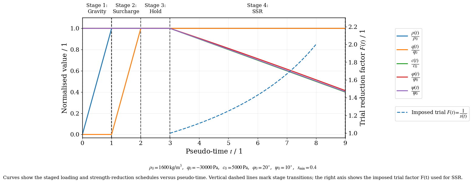

We compute the slope factor of safety using the shear strength reduction (SSR) method, in which the Mohr–Coulomb shear strength is reduced by a trial factor ($F$) until static equilibrium can no longer be achieved (typically observed as non-convergence and/or formation of a continuous plastic shear band). In the classical formulation, reduction is applied as \begin{equation} c_{\text{trial}}=\frac{c_0}{F}, \qquad \tan\varphi_{\text{trial}}=\frac{\tan\varphi_0}{F}, \qquad \left(\Rightarrow\ \varphi_{\text{trial}}=\arctan\left(\frac{\tan\varphi_0}{F}\right)\right), \end{equation} and the limiting value of ($F$) at failure is interpreted as the factor of safety.
Staged procedure in OpenGeoSys
To avoid numerical artefacts from an unrealistic initial stress state, loading and reduction are applied in stages using pseudo-time. This staged procedure follows the OGS slope-stability workflow where gravity and surface load are ramped first and strength reduction starts later.
Stage 1 — Gravity ramp ($t=0\rightarrow1$) Gravity is activated by ramping the solid density from 0 to its target value using a time-dependent function, \begin{equation} \rho(t)=\rho_0\cdot r_\rho(t), \qquad r_\rho(t)=\max\left(0,\ \min\left(1,\ \frac{t}{t_\rho}\right)\right), \qquad \rho_0=1600~\mathrm{kg/m^3}, \end{equation} with $t_\rho=1$ and fixed body force $\mathbf{b}=(0,-9.81)\ \mathrm{m/s^2}$.
Stage 2 — Surcharge (top load) ramp ($t=1\rightarrow2$) A distributed top load is applied using a time-dependent ramp, \begin{equation} q(t)=q_0\cdot r_q(t), \qquad r_q(t)=\max\left(0,\ \min\left(1,\ \frac{t-t_{q0}}{t_{q1}-t_{q0}}\right)\right), \qquad q_0=-30~\mathrm{kPa}, \end{equation} with $t_{q0}=1$ and $t_{q1}=2$. Thus $q=0$ for $t\le 1$ and reaches full magnitude at $t=2$.
Stage 3 — Hold / equilibration ($t=2\rightarrow 3$) After gravity and surcharge are fully applied, the model is held for 1 unit of pseudo-time with no strength reduction before weakening starts.
Stage 4 — Strength reduction (SSR) ($t\ge 3$) Strength reduction is prescribed as a time-dependent multiplier $s(t)\in[s_{\min},1]$, and the trial factor is defined as \begin{equation} F(t)=\frac{1}{s(t)}. \end{equation} We use a linear decrease (clipped to $[s_{\min},1]$) during the SSR interval $t\in[t_0,t_1]$, \begin{equation} s(t)= \left( s_{\min}, \quad \left( 1, \quad 1-(1-s_{\min})\frac{t-t_0}{t_1-t_0} \right)\right), \qquad t_0=3,\quad t_1=9,\quad s_{\min}=0.4. \end{equation}
Cohesion reduction Cohesion is reduced linearly as \begin{equation} c(t)=s(t)\cdot c_0, \qquad c_0=5000~\mathrm{Pa}. \end{equation}
Friction and dilatancy reduction (SSR-consistent) In SSR the reduction is defined on $\tan\varphi$, i.e. \begin{equation} \tan\varphi(t)=\frac{\tan\varphi_0}{F(t)}=\tan\varphi_0\cdot s(t), \qquad \Rightarrow\quad \varphi(t)=\arctan\big(\tan\varphi_0\cdot s(t)\big). \end{equation} An analogous relation is used for the dilatancy angle ($\psi$): \begin{equation} \psi(t)=\arctan\big(\tan\psi_0\cdot s(t)\big). \end{equation}
Failure is identified by loss of numerical convergence, corroborated by the formation of a continuous plastic shear band.

"stages": {
"rho_t1": 1.0, # density ramp 0->1 on [0, rho_t1]
"load_t0": 1.0, # load starts ramping at t=load_t0
"load_t1": 2.0, # load reaches full at t=load_t1
# SSR schedule (user edits only these 3)
"ssr": {
"t0": 3.0, # SSR starts
"t1": 9.0, # SSR reaches minimum
"smin": 0.4, # minimum strength multiplier s(t)=1/F(t)

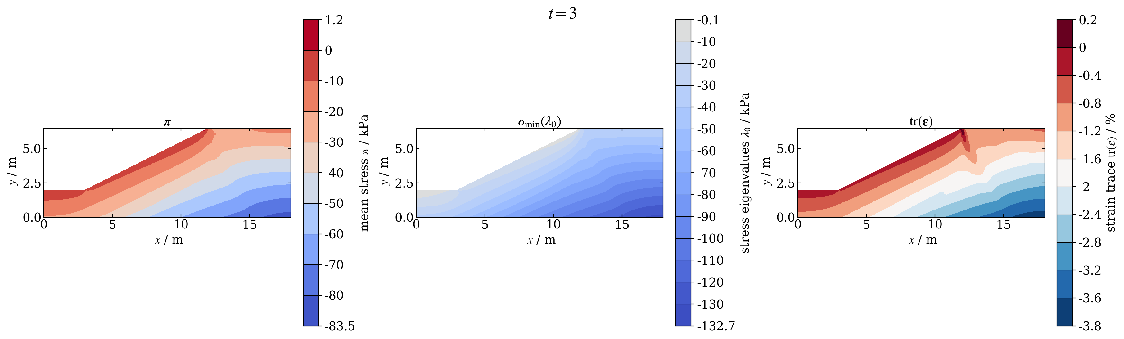

Post-processing

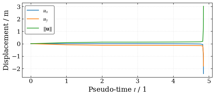

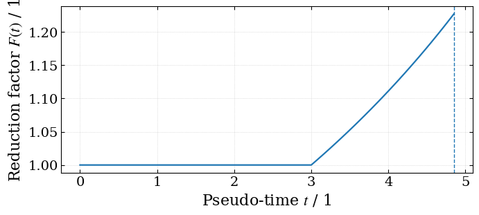

Plots: factor of safety vs pseudo-time, slope crown displacement vs time, and field maps.
The first row of profiles shows baseline fields at the at end of Stage 3 (hold/equilibration, ($t=3$)): mean stress ($\pi$), minimum principal stress ($\sigma_{\min}$), and trace strain ($\mathrm{tr}(\boldsymbol{\varepsilon})$).

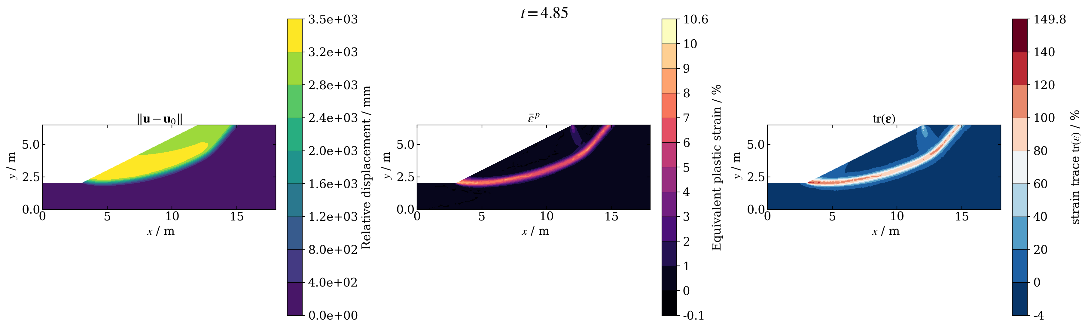

The second row shows end-of-SSR fields ($t=t_{\mathrm{end}}$): relative displacement magnitude ($\|\mathbf{u}-\mathbf{u}_0\|$), equivalent plastic strain ($\bar{\varepsilon}^{\,p}$), and trace strain ($\mathrm{tr}(\boldsymbol{\varepsilon})$).

)[POST] SSR postprocessing
[CASE]
mesh size h: 0.25 m
element order: quadratic (quad)
minimum dt: 1e-04
nonlinear reltol: 1e-14
load: all (label: reference)
time stepping: IterationNumberBasedTimeStepping
VTU files: 50
last converged step: 50
last converged time before failure: 4.85015
state at last converged time: s=0.814985, c=4074.93 Pa, phi=16.522 deg, psi=8.17764 deg
FoS estimate: FoS >= 1.227016
[PLOT] time series: F(t) and probe at slope crest (12, 6.5, 0)
[PLOT] baseline stress fields at end of Stage 3 (hold/equilibration, before SSR) (t=3, vtu='slope_ts_17_t_3.000000.vtu')
[PLOT] end fields @ t_end=4.85003 (vtu='slope_ts_49_t_4.850033.vtu')
