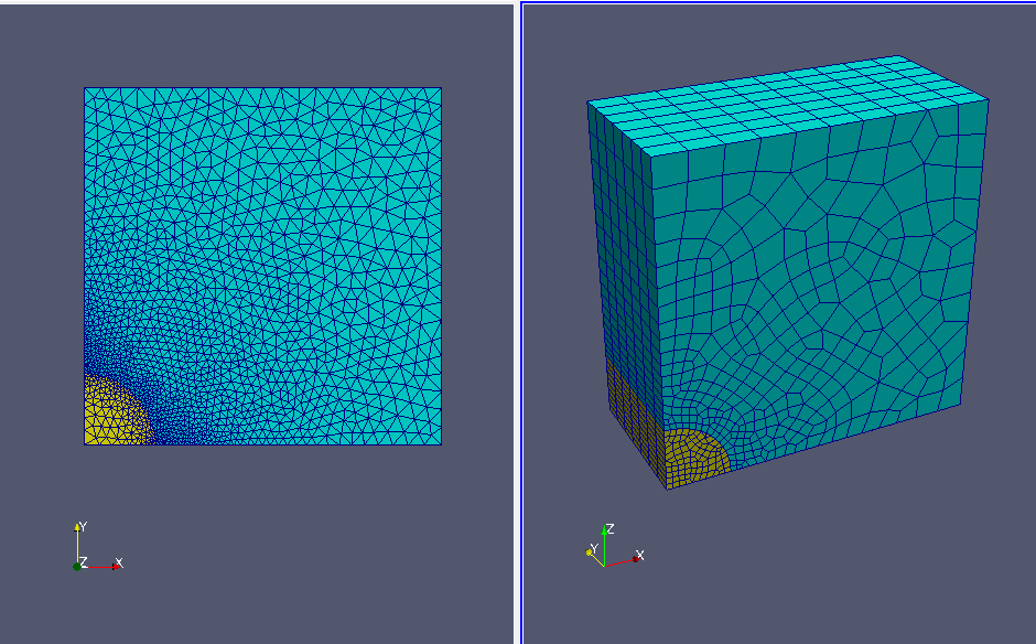

Mesh
2D and 3D meshes

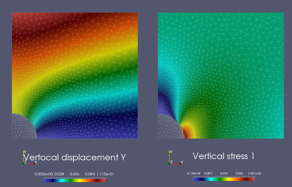

2D results

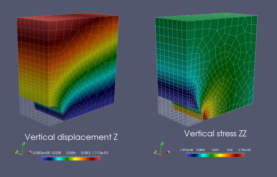

3D results:
