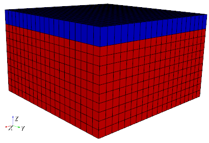

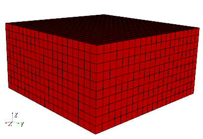

AddLayer -i <input-mesh> -o <output-mesh> [-t <thickness>]
Usage for example:
AddLayer -i quad.vtu -o quad_with_new_top_layer.vtu -t 1The tool was used to add a “soil” layer to the hydro-geological model of the Unstrut catchment within the INFLUINS project:
