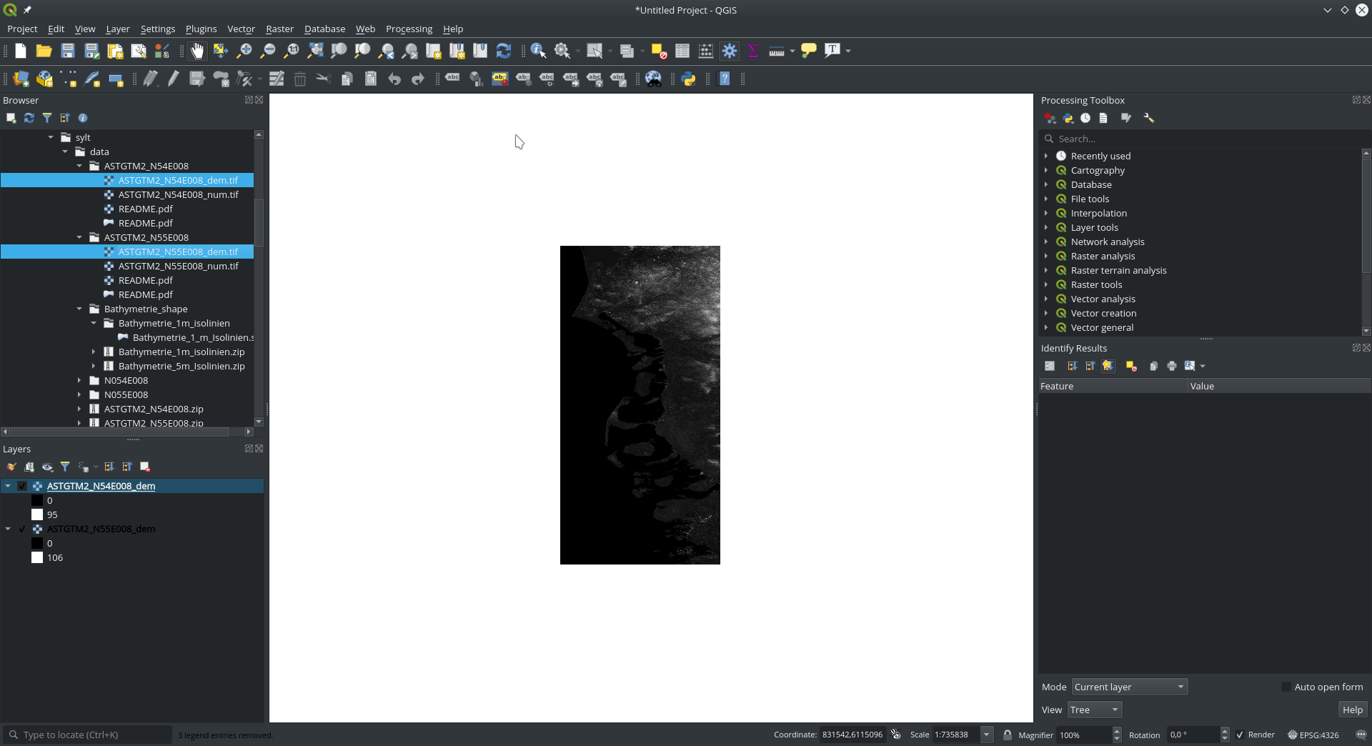

  • It is likely that you will need to download more than one remote sensing image when the study area is large or overlapping the borders of one section. Download the required DGM data (here .tif files) of the study area and load them into QGIS. Load DGM TIFF files

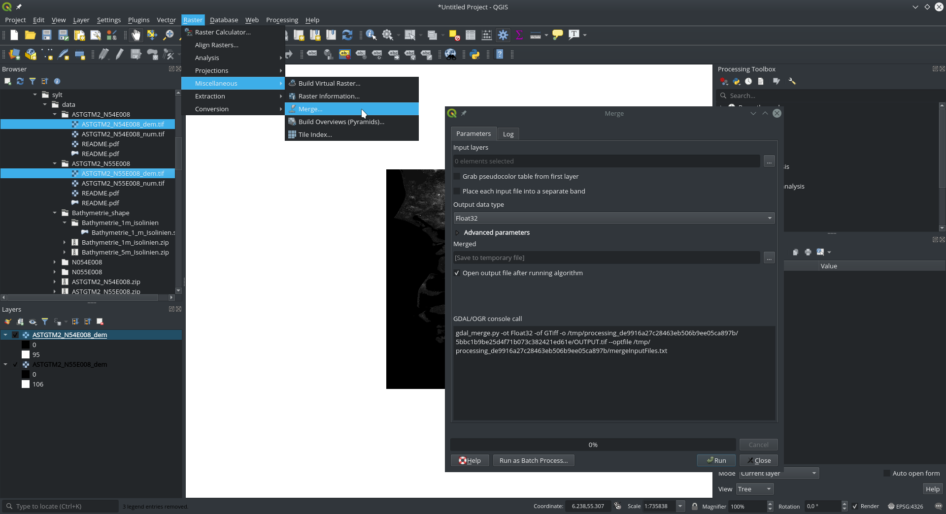

  • Merge the images with Raster -> Miscellaneous -> Merge...; select the Input Layers. Merge multiple DGM TIFF files

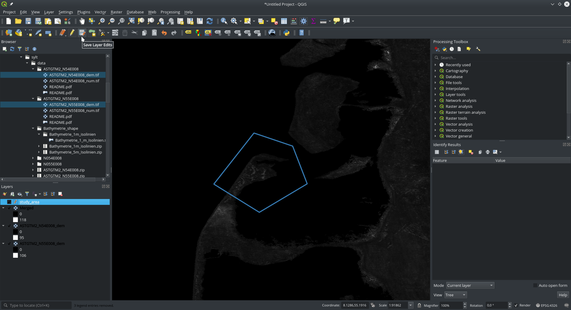

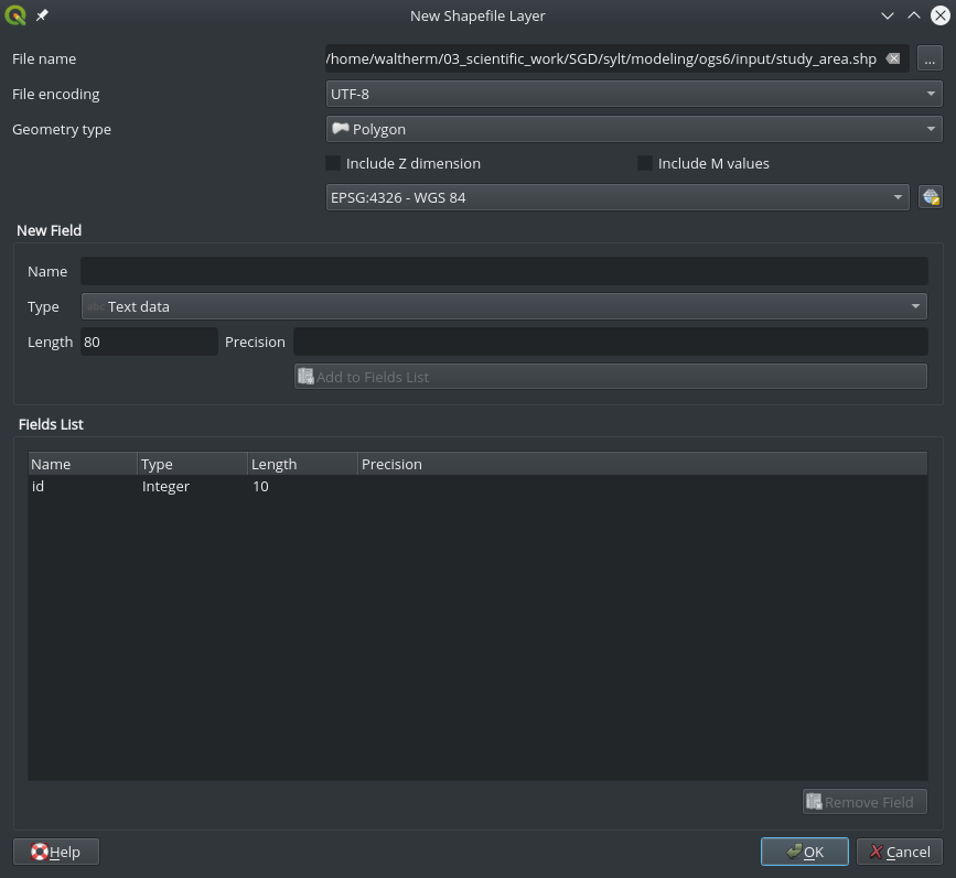

  • Extract a subregion of the (merged) DGMs and define the study area through a shape file. One may also use a predefined shape file and continue with step 5. Choose New Shapefile Layer... from the toolbar and enter a File name and a projection. Create clipping shape
  • Edit the shape (Toggle Editing in toolbar), add points, and save the layer edits. Save layer edits

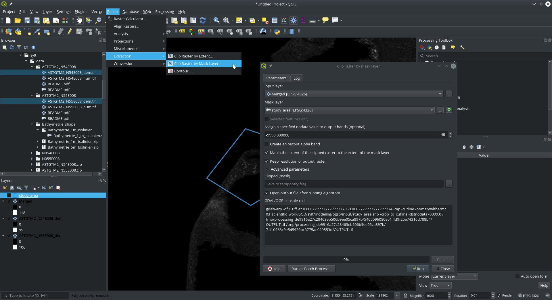

  • Clip the DGM with the shape file with Raster -> Extraction -> Clip Raster by Mask Layer...; define Input Layer and Mask layer, and assign the Nodata value. Clip DGM with shape

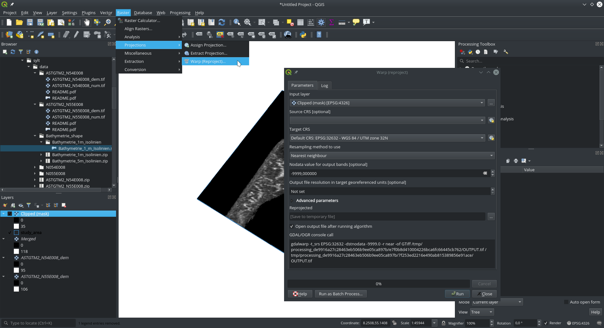

  • If the raster does not have the correct projection, you will have to reproject it with the appropriate target system with Raster -> Projections -> Warp (Reproject); select the Input Layer and the Target CRS. Reprojection

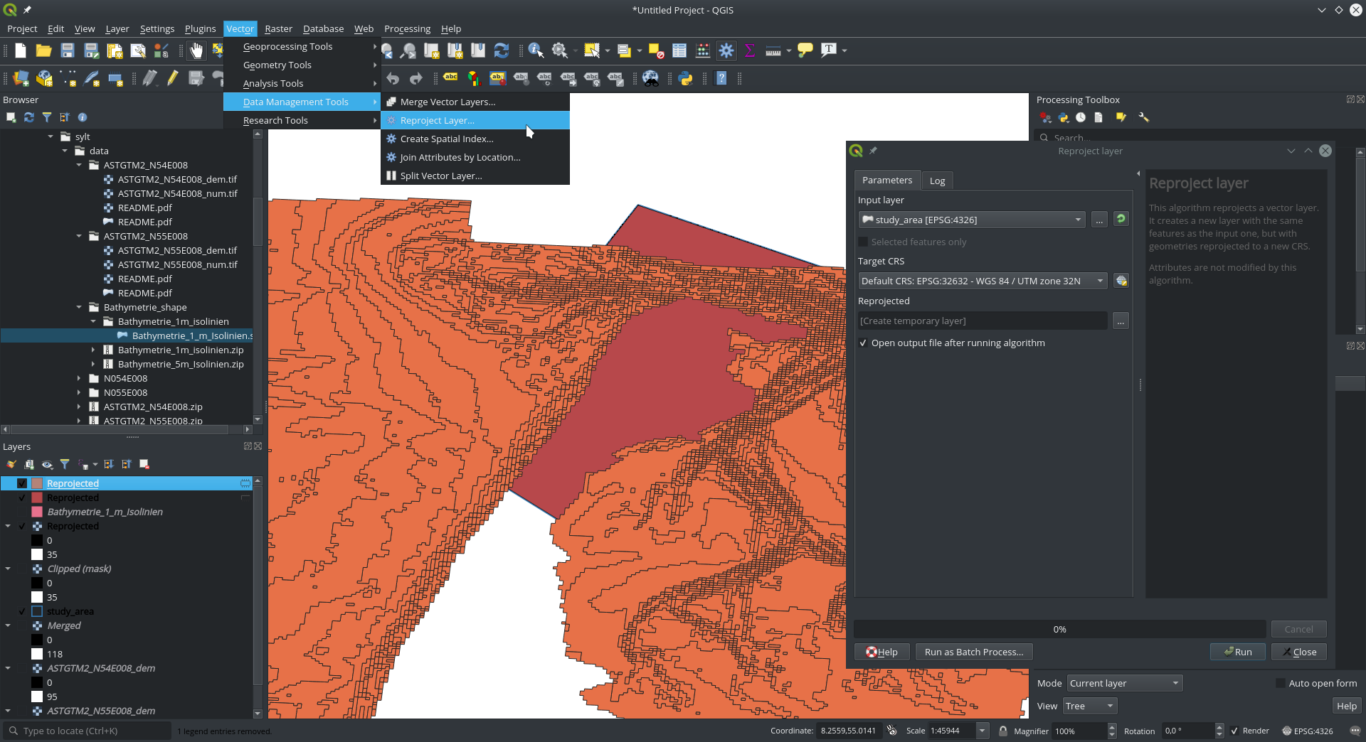

  • This example also includes bathymetry data, which was available as vector data (isoline in a shape file). This file must be reprojected to the same coordinate system as the raster before with Vector -> Data Management Tools -> Reproject Layer; select Input Layer and the Target CRS. Reproject shape bathymetry data

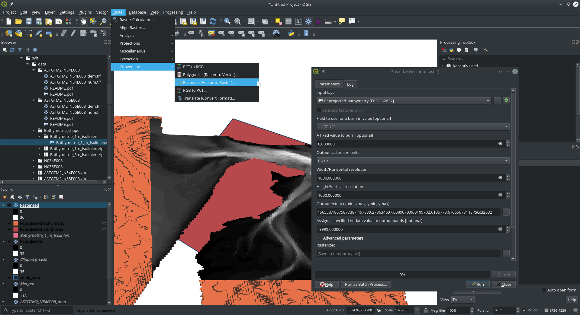

  • Before merging DGM and bathymetry, the shape data needs to be converted to raster data with Raster -> Conversion -> Rasterize (Vector to Raster); define Input Layer, the z-value (burn-in value), the resolutions, and the nodata value. Rasterize vector data

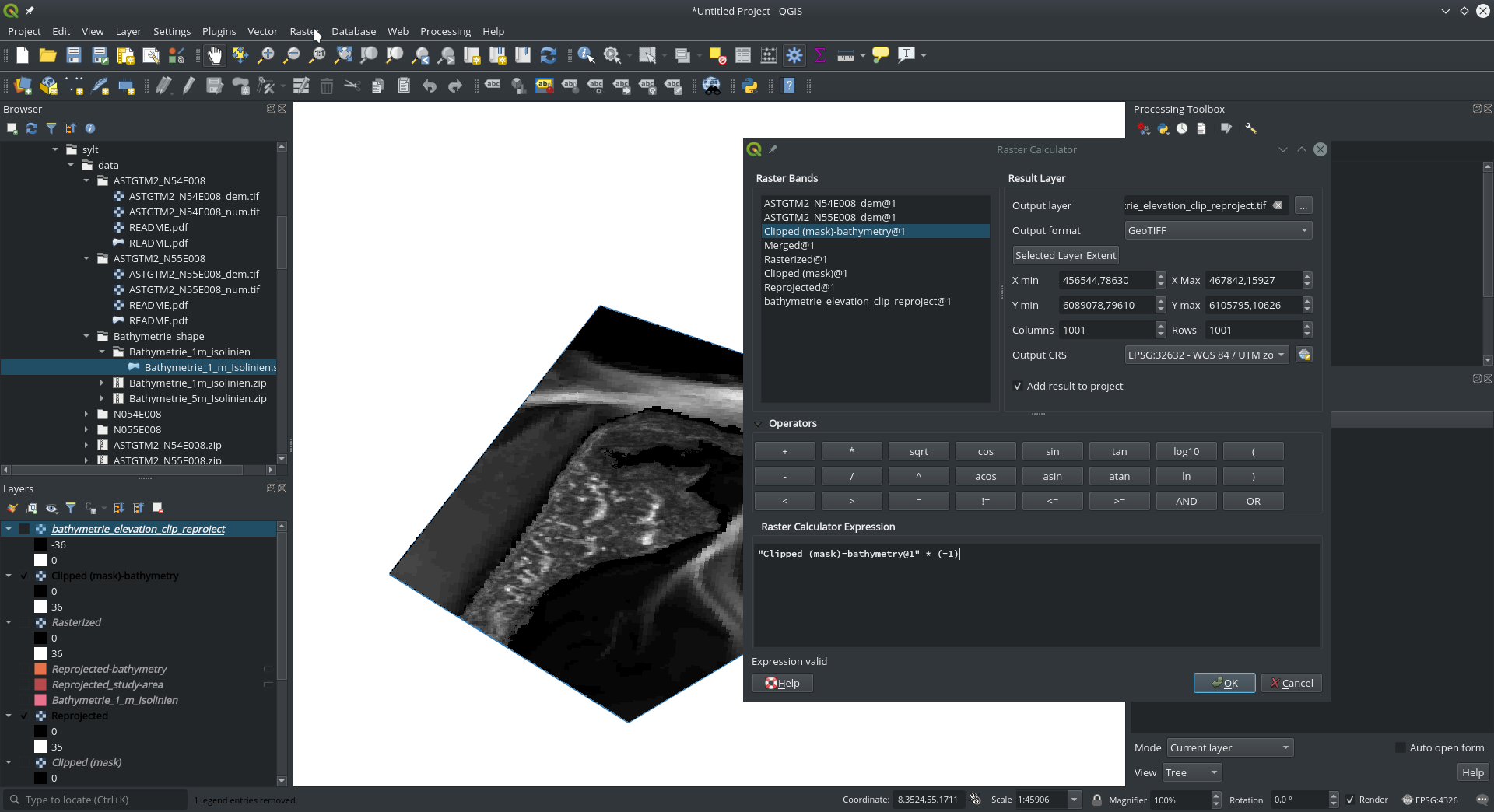

  • As bathymetry was given as “depth”, this parameter needs to be converted to an “elevation”; use Raster -> Raster Calculator and define the Output layer, the Output format and the Raster Calculator Expression (shown formula only inverts the sign). Depth to elevation with the raster calculator

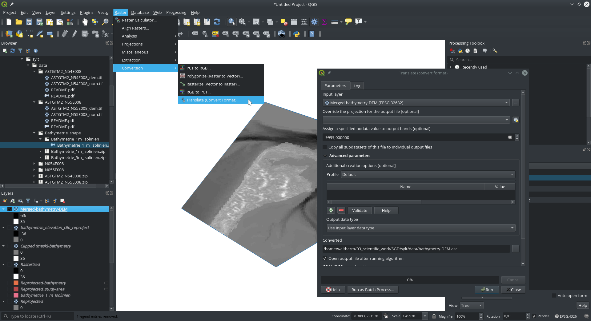

  • Merge the DGM and bathymetry rasters (as done in step 2), and save the merged file as a .asc file with Raster -> Conversion -> Translate (Convert Format); define the Input Layer and the Converted output file. Convert to .asc format

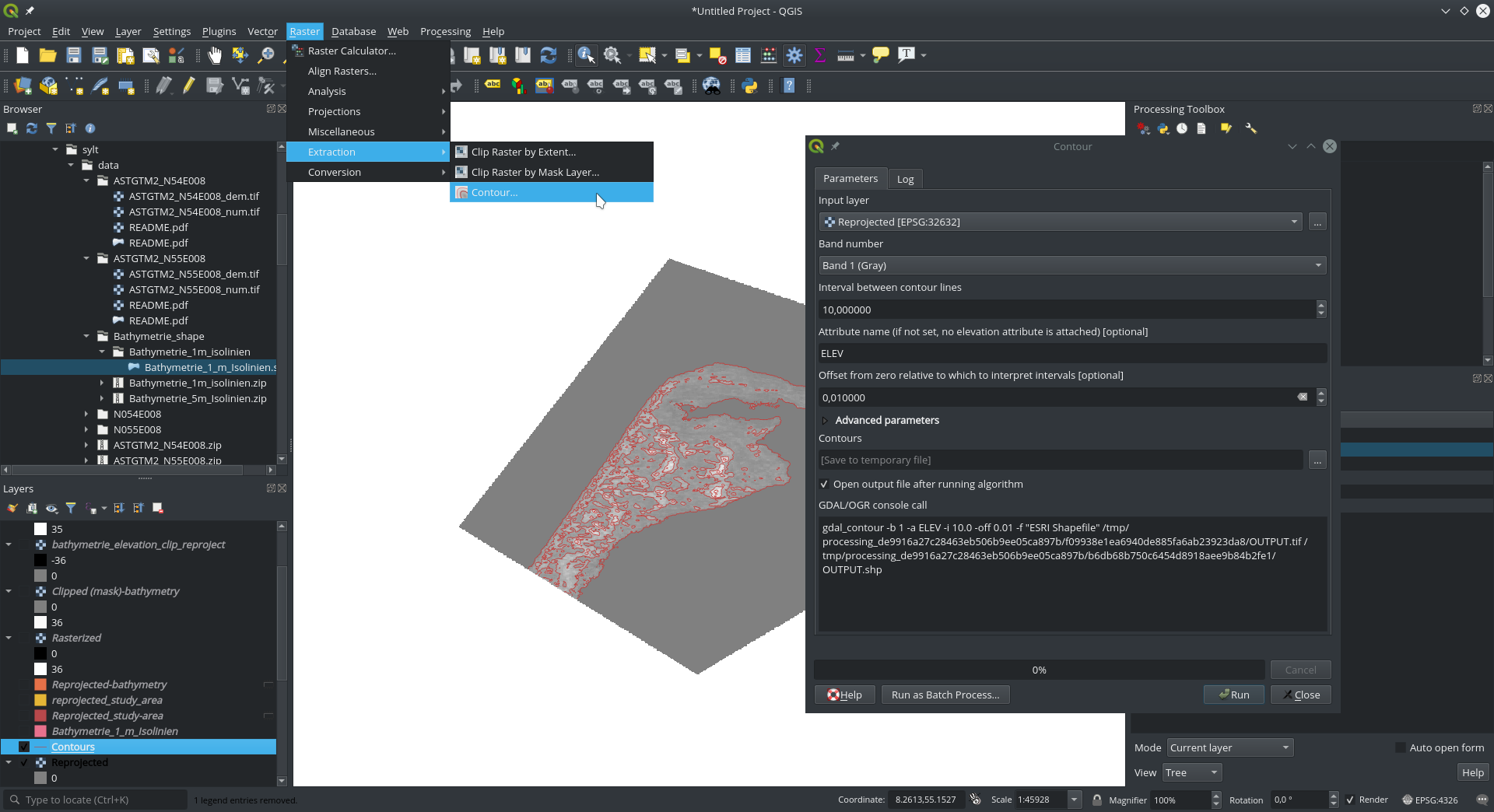

  • To make the coastline part of the mesh, the merged DGM-bathymetry will be used to create a contour isoline at an elevation of 0.01 m with Extraction -> Contour...; select the Input Layer, set the Interval between contour lines to a high value and set the Offset from zero. Raster to contour

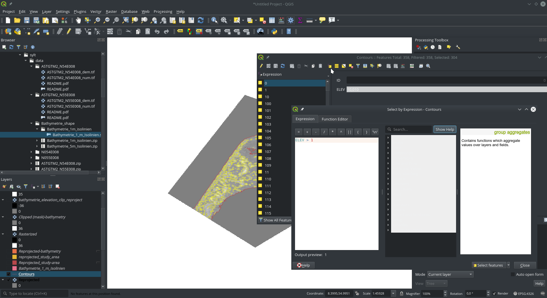

  • If more than the 0.01 m contour is present in the new shape file, remove the not required contours by right-clicking the new shape file and Open Attribute Table; click Select features using an expression and define the contours based on your liking that you want to exclude (here, anything with an elevation larger than 1 is removed). Select features

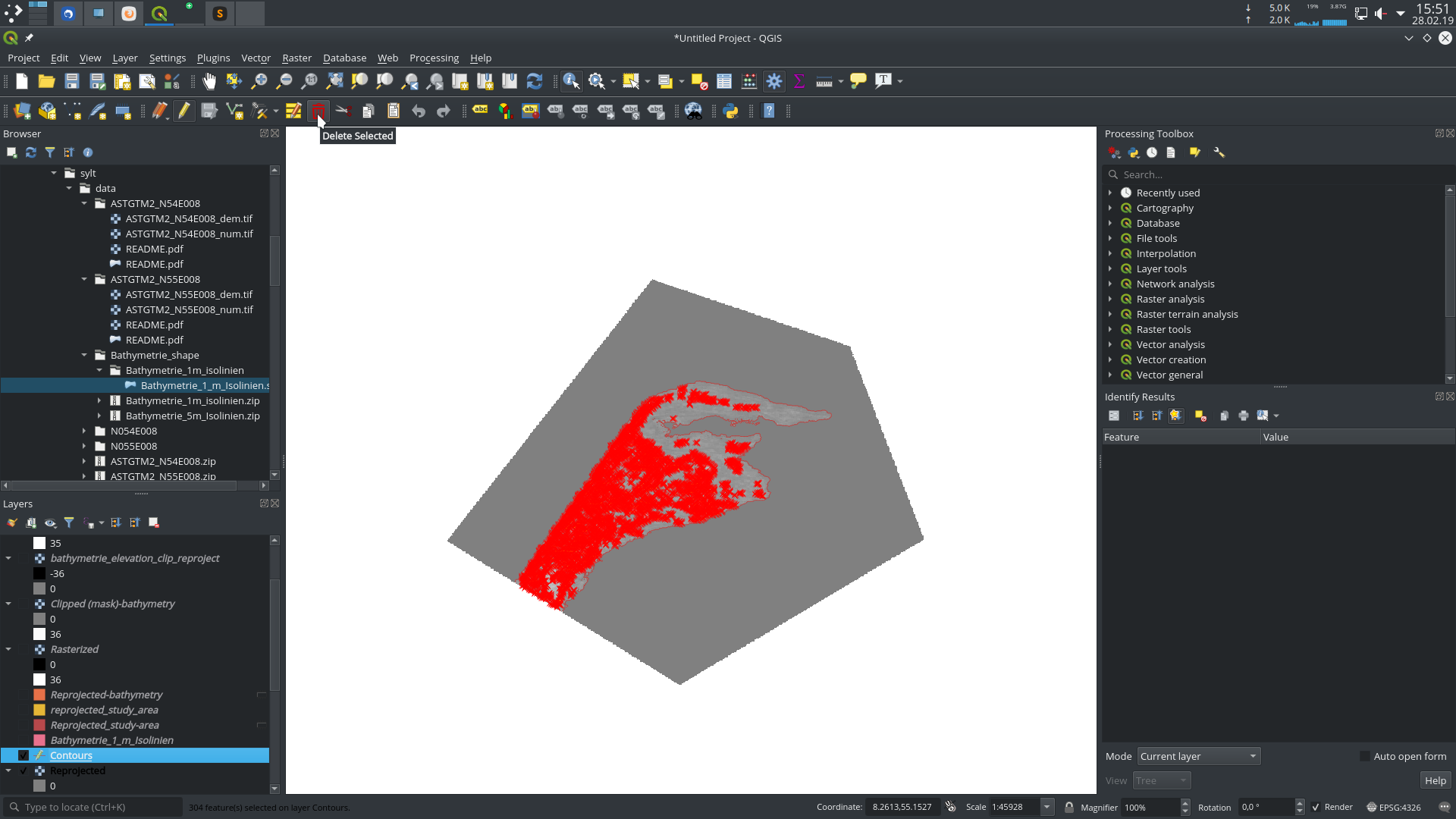

  • Finish the selection (close attribute table) and remove the selected features by editing the shape (Toggle Editing) and clicking Delete Selected; save the changes. Remove selected features

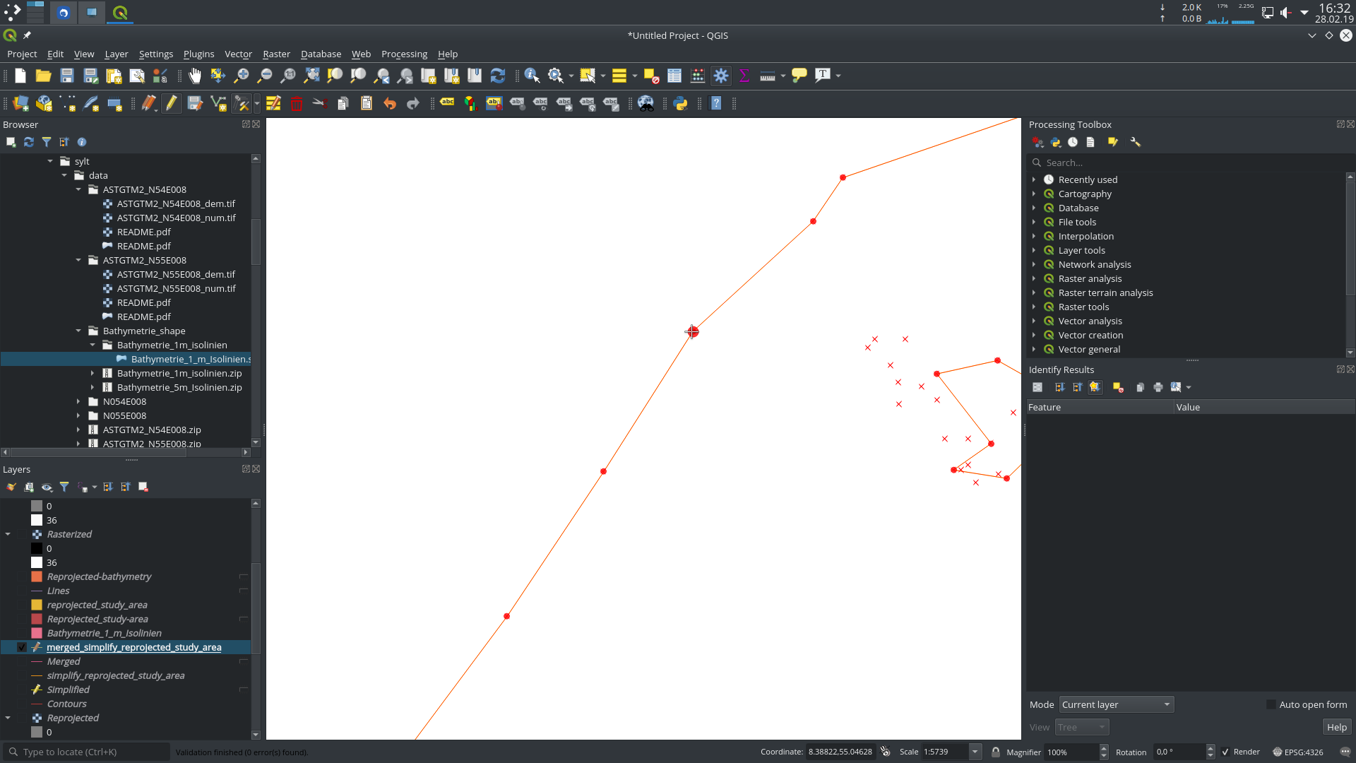

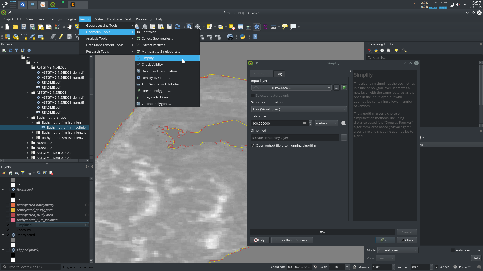

  • The remaining features may have a high resolution (see red line in below figure); choose Vector -> Geometry Tools -> Simplify..., and select an Input Layer as well as the Simplification method with an appropriate Tolerance. Simplify extracted coastline
  • Further, it might be useful to manually remove even more vertices from the polygon; Toggle Editing of the simplified shape and select and remove vertices. Further thinning of simplified coastline

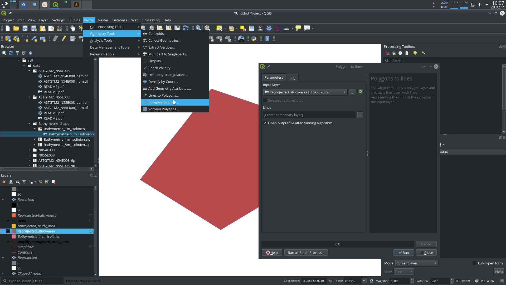

  • The shape file used to clip the study area in step 5 will be used as the boundary of the model setup and be combined with the coastline. Firstly, convert the polygon of the study area to a polyline with Vector -> Geometry Tools -> Polygons to Lines; select the Input Layer. Convert polygon to line

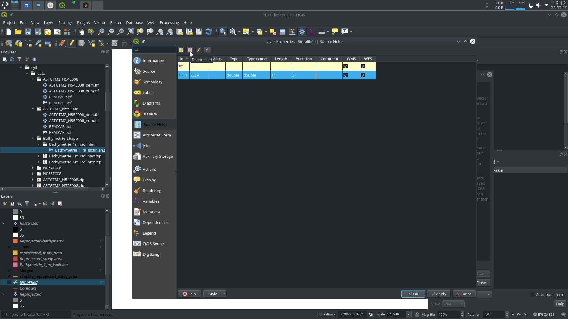

  • Before merging the boundary and the coastline shapes, remove all fields from the boundary polyline through the Attribute Table; select everything and click Delete field. Delete fields of polyline

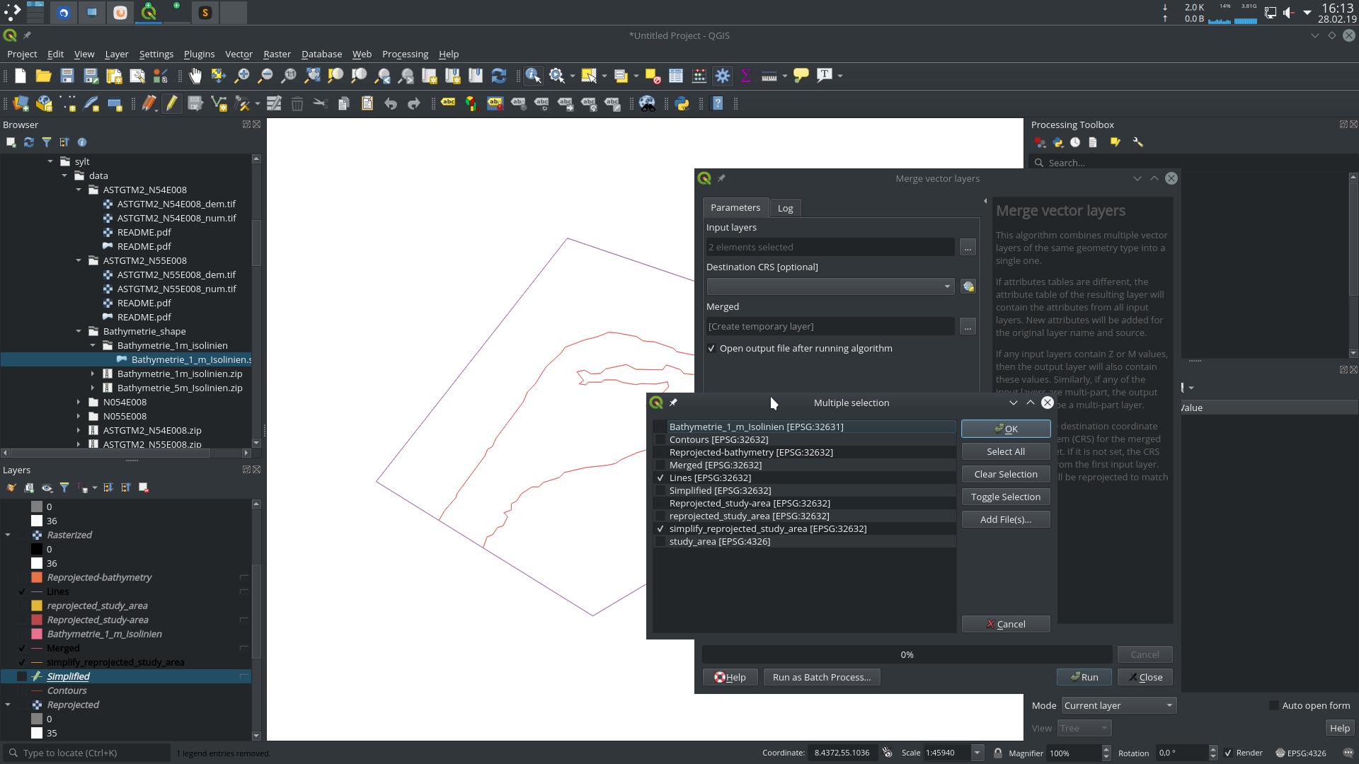

  • Merge the boundary polyline and the coastline with Vector -> Data Management Tools -> Merge Vector Layers; select Input Layers. Merge vector layers boundary polyline and coastline

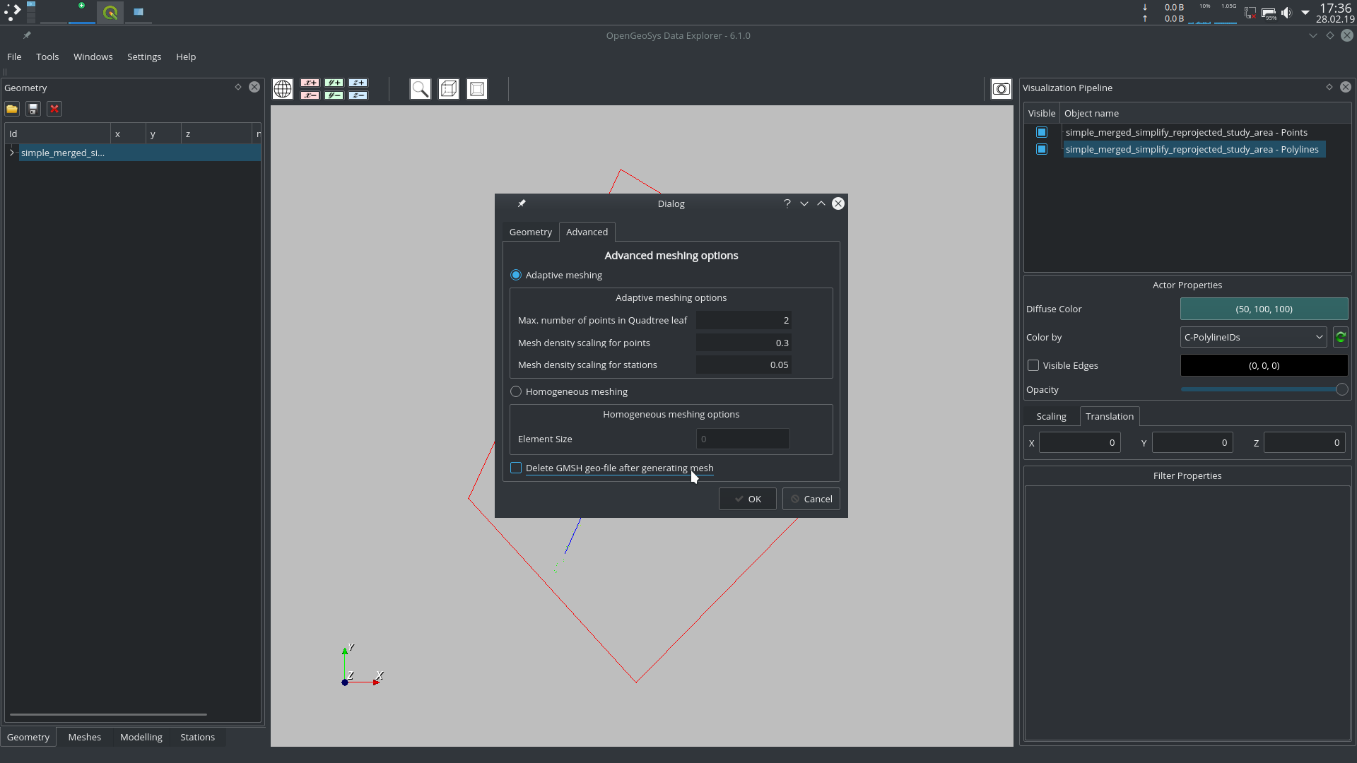

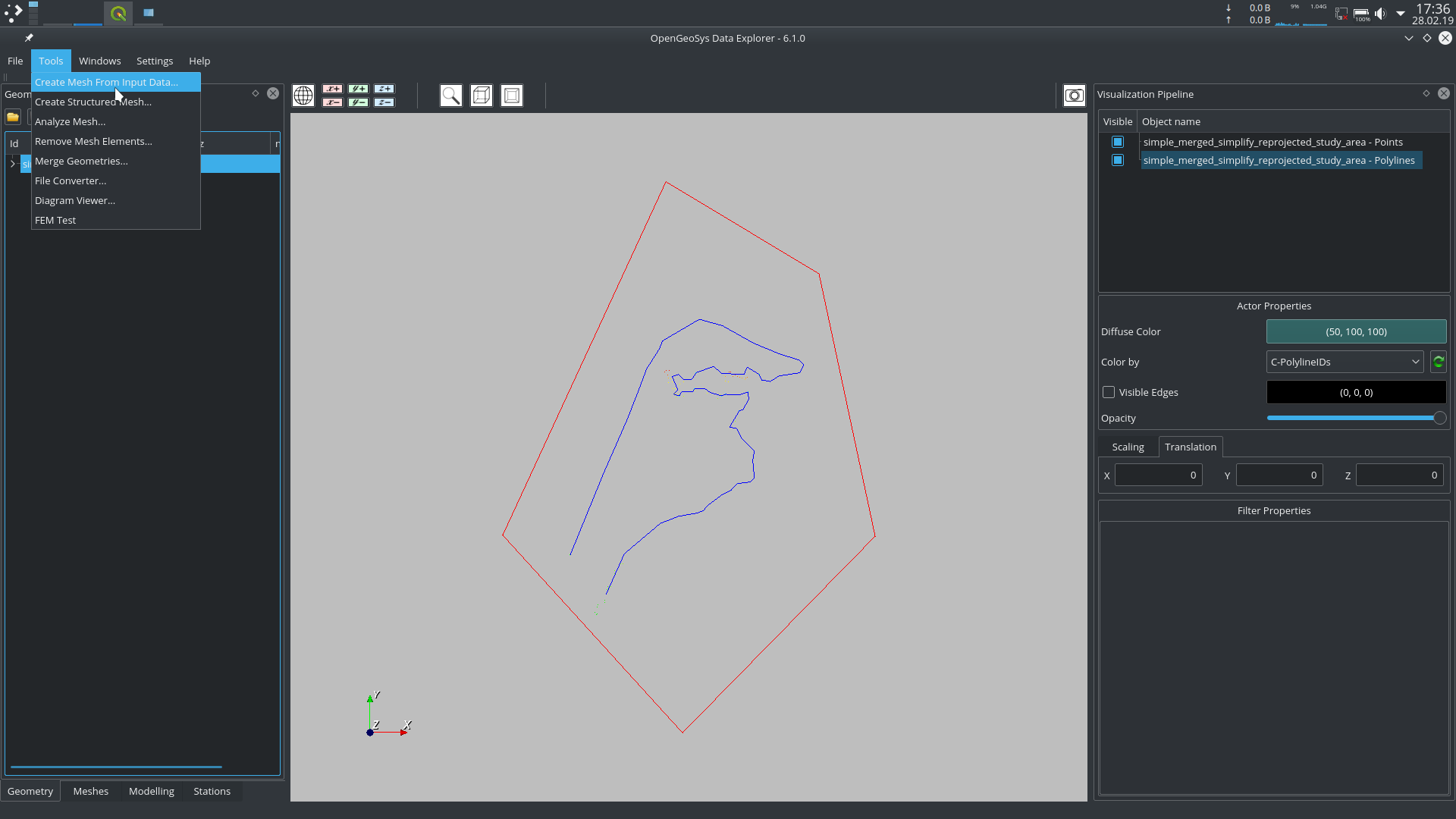

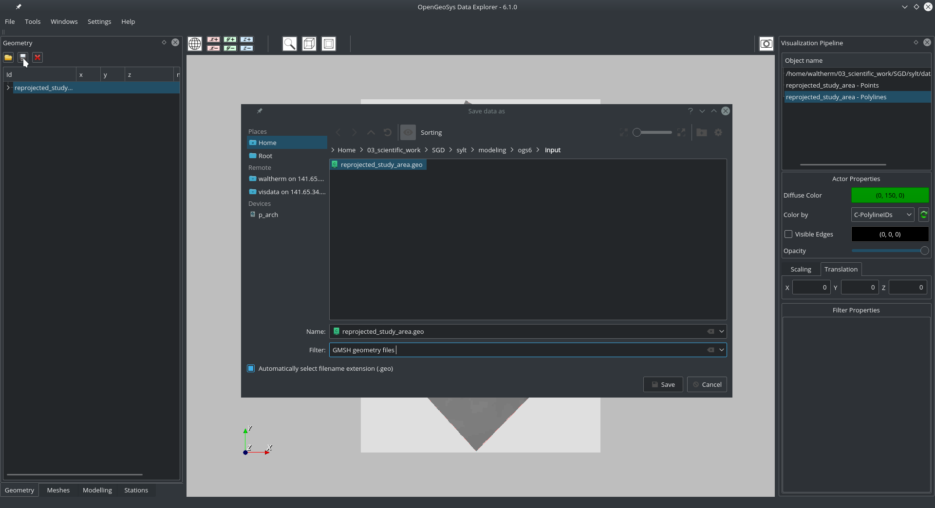

  • Load the merged boundary-coastline shape into the DataExplorer (File -> Import -> Shape Files). Creation of the 2D mesh can be done in two ways: a) Either use GMSH: Save the geometry as a .geo file for usage in GMSH by choosing the tab Geometry and clicking the save icon. Afterwards, use GMSH to generate a 2D mesh to your liking and import it with File -> Import Files -> GMSH files.... Save imported boundary shape as GMSH .geo file b) Or use the DataExplorer interface for GMSH: Use Tools -> Create Mesh From Input Data.... Select meshing option From the dialogue, select the geometry which should be used and let it show up on the right side (Employed information). Select geometry Select the Advanced tab, choose Adaptive meshing, and remove the tick at Delete GMSH geo-file after generating mesh (in case you still want to manipulate the .geo file); click OK. Advanced meshing settings

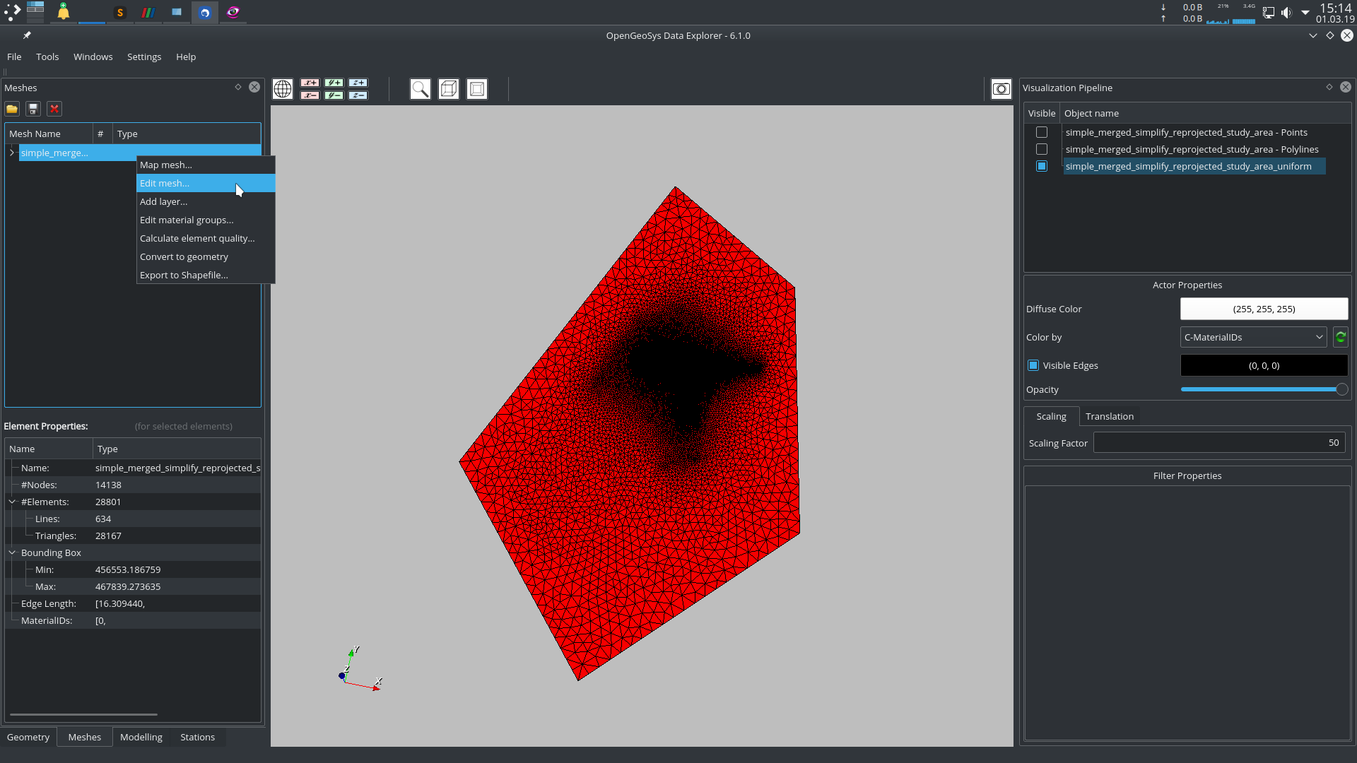

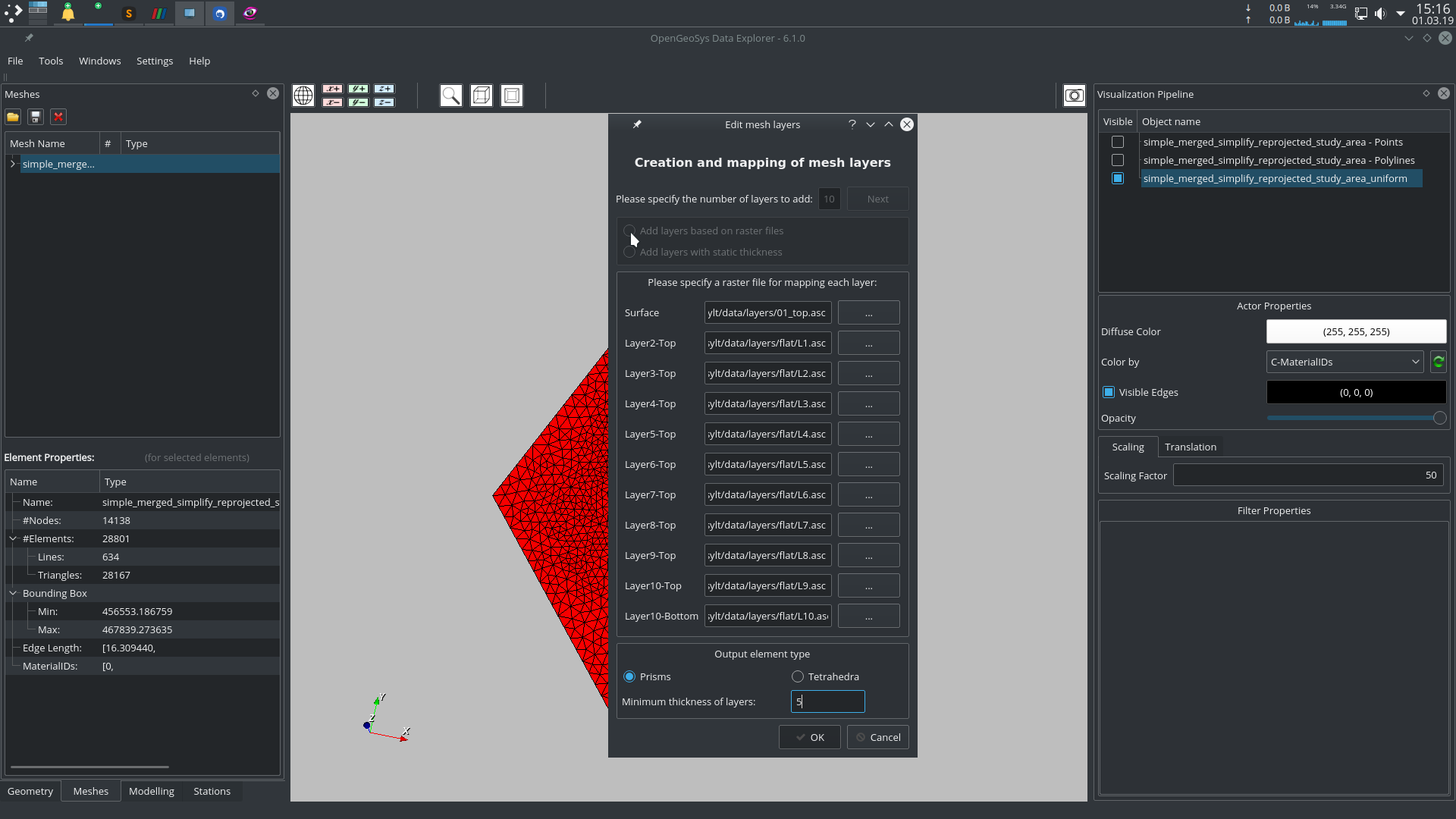

  • To create a 3D mesh, the previously defined elevation data and subsurface layer data will be used to define multiple layers of the model. In the left-side tab Meshes, right-click the newly created (or imported) mesh, and choose Edit mesh... Start creation of 3D mesh
  • In the new dialogue, Specify the number of layers to add (here 10), click Add layers based on raster files, and load all .asc files that define the different layers into the interface. Also, define a Minimum thickness of layers (here 5 height units). Create layered 3D mesh

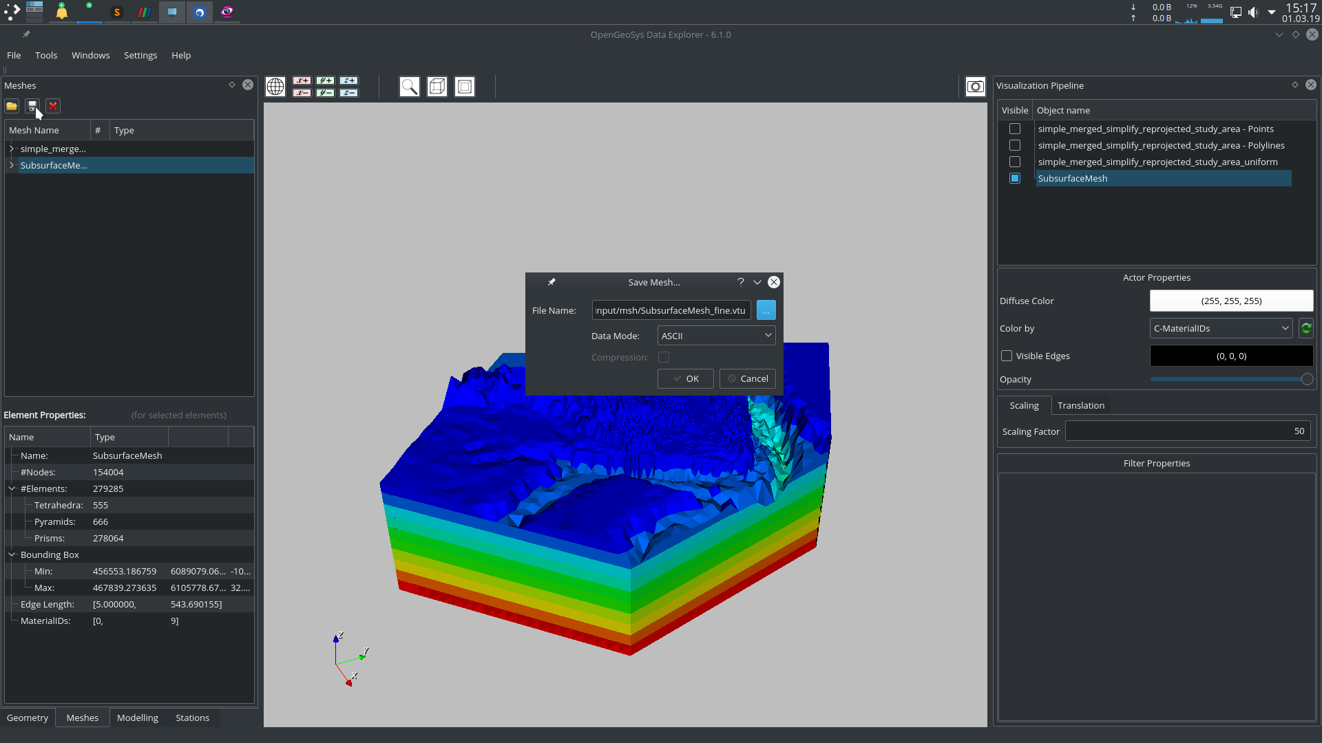

  • Save the created 3D mesh as a .vtu file by selecting the 3D mesh in the Meshes tab and clicking the save icon. In the new dialogue, choose a output directory, filename, and the Data mode. Save 3D mesh as .vtu file

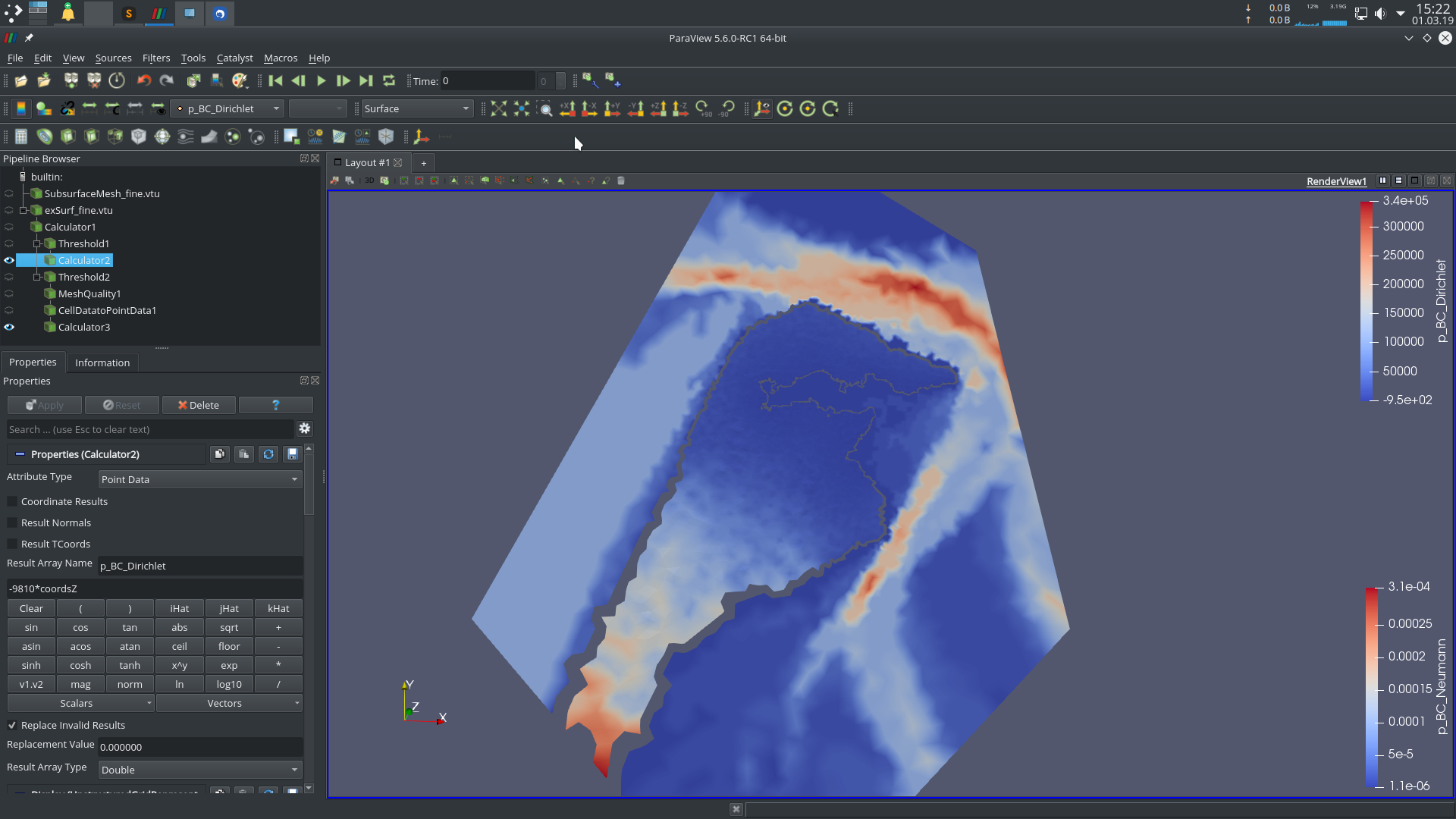

  • ParaView will be used to define boundary and initial condition values. For boundary conditions, a separation of the water level (Dirichlet) and recharge (Neumann) boundary condition is required. Load the extracted top surface into ParaView and apply the following filter pipeline: a) Apply a Calculator with the operation coordsZ to get a new parameter field with elevation data. b) Apply a Threshold and define the value range from the lowest to the water level (here -35 to 0.01 height units); this will be the input file for the Dirichlet boundary condition. c) Apply a Calculator with the operation -9810*coordsZ (i.e. fluid density multiplied by gravity by elevation) to get a pressure gradient. d) repeat b) and c) on the Calculator from a) but with the value range water level to highest value (in the Threshold), and define the recharge value for the land area (in the Calculator). e) Save the “land” and “water” meshes as .vtu files. ParaView filter pipeline
