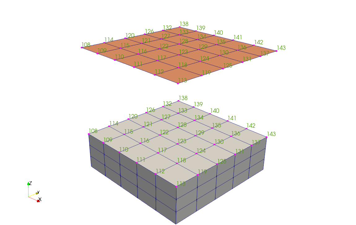

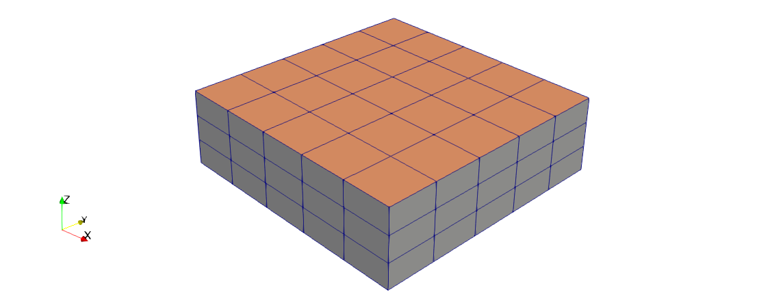

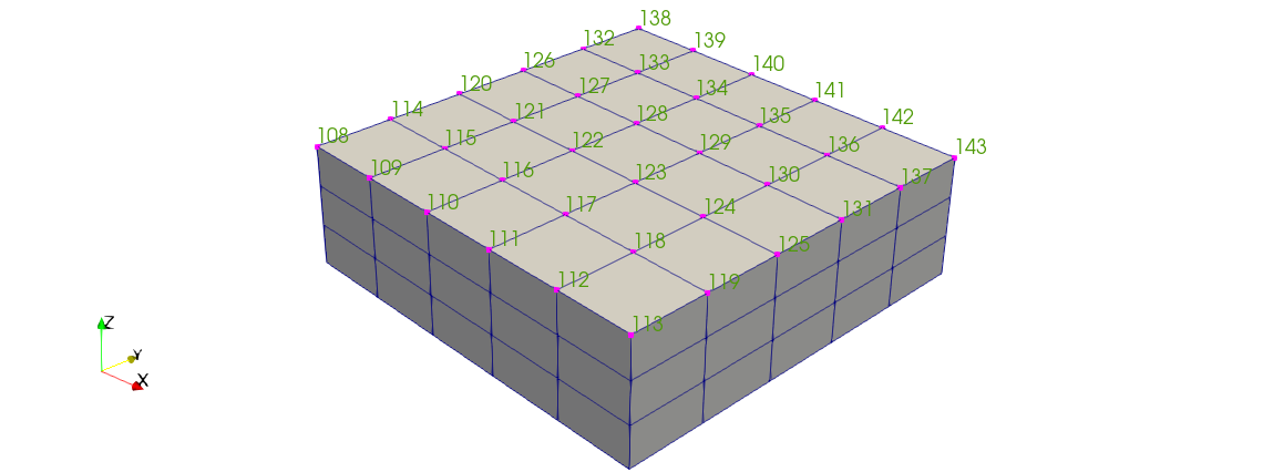

In the next figures it is explained how a boundary condition can be set to the top surface of a quad domain for a OGS-6 simulation. The first figure depicts the bulk mesh and the id’s of the nodes on the top. 01_bulk_mesh_with_top_node_ids The differently coloured top surface mesh can be obtained for instance by the ExtractSurface tool. 02_bulk_mesh_top_surface For visualisation purposes the top surface is translated upwards. The picture shows the bulk mesh and the id’s of the nodes on the top of it. Furthermore, the translated top surface mesh with the corresponding bulk node id’s are represented. 03_bulk_mesh_with_ids_top_surface_bulk_node_ids
