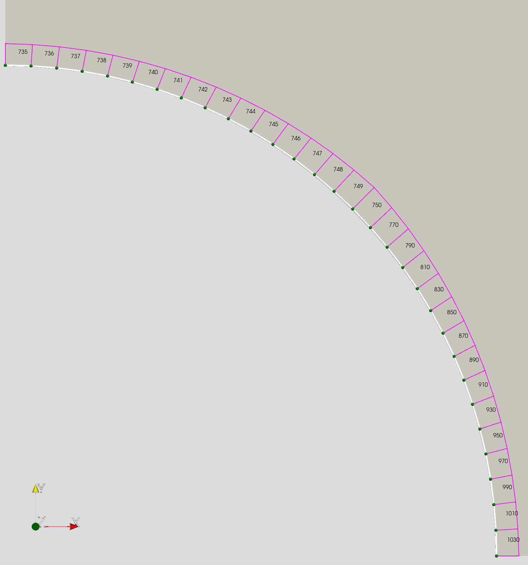

Given a “bulk” mesh (Tests/Data/Mechanics/Linear/disc_with_hole.vtu) and a quarter circle mesh extracted manually we want to use the quarter circle mesh for heterogeneous boundary condition. OGS requires two mappings into the “bulk” mesh, one for the nodes and one for the elements.
a part of the ‘bulk’ mesh with boundary element numbers
The figure shows a part of the ‘bulk’ mesh with boundary element numbers, and the quarter circle mesh shown as white line with green points.

The tool will first try to find all unique nodes in the “bulk” mesh using search radius 1e-6, and create the bulk_node_ids mapping upon success. Then the bulk_element_ids mapping is created by finding a unique element containing all the nodes of the subdomain element. The output file new_quater_circle.vtu will now contain both mappings and is prepared for usage as a boundary condition mesh.
