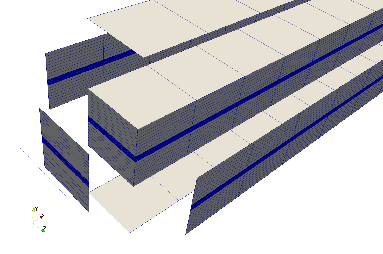

yields new meshes for each named geometry: single_fracture_3D_inlet.vtu, single_fracture_3D_right.vtu, single_fracture_3D_outlet.vtu, single_fracture_3D_left.vtu, single_fracture_3D_front.vtu, single_fracture_3D_top.vtu, single_fracture_3D_bottom.vtu, and single_fracture_3D_back.vtu.
The front part of the mesh with the extracted geometries
Shows the front part of the mesh with the extracted geometries. Note, the lower dimensional inlet boundary, shown as a line.
