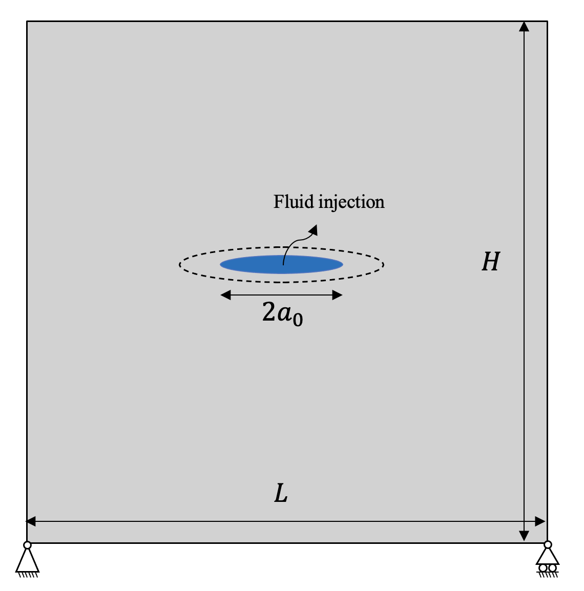

Problem Description
Based on Sneddon's solution (Sneddon et al., 1969), we verified the model with plane-strain hydraulic fracture propagation in a toughness-dominated regime. In an infinite 2D domain, the problem was solved with a line fracture $[-a_0, a_0] \times \{0\}$ ($a_0$ = 0.05). We considered a large finite domain $[-40a_0,40a_0] \times [-40a_0,40a_0]$ to account for the infinite boundaries in the closed-form solution. The effective size of an element, $h$, is $1\times10^{-2}$.
Schematic view of hydraulic fracturing problem and Boundary conditions
Schematic view of hydraulic fracturing problem and Boundary conditions.
  • In order to have the hydraulic fracturing in the toughness dominated-regime, add, $\texttt{propagating}$ in the project file.
  • Yoshioka et al., 2019 provides additional information on the implementation, use of real material properties, and rescaling of the phase-field energy functional.

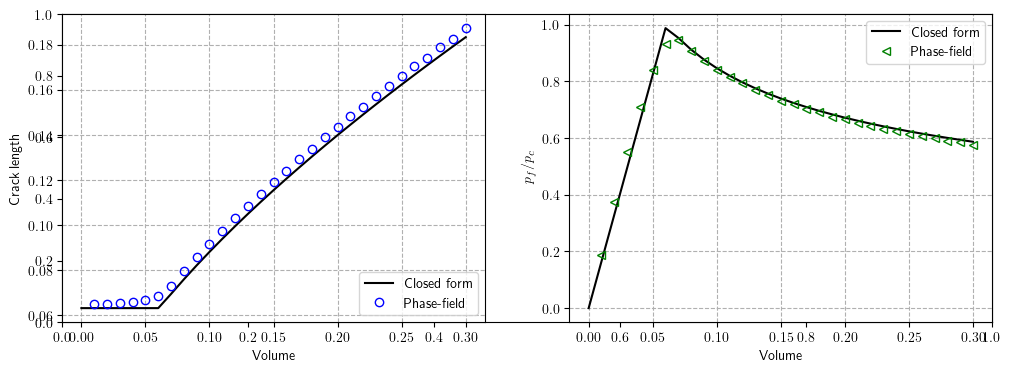

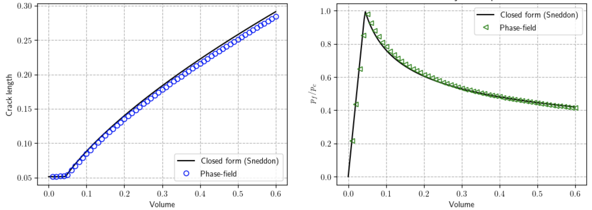

Phase Field Versus Analytical Solution for Fracture Length and Pressure Evolution
In phase field approach, we can retrieve the crack length $a$ as:
$$ \begin{equation} a = \dfrac{\displaystyle \int_\Omega \frac{G_c}{4 c_n} \left(\frac{(1-v)^n}{\ell}+ \ell |\nabla v|^2\right)\,\mathrm{d} \Omega }{G_c \left( \dfrac{h}{4 c_n \ell} + 1 \right)}. \end{equation} $$
where $n=1$ corresponds to $\texttt{AT}_1$ ($c_n = 2/3$) and $n=2$ to $\texttt{AT}_2$ ($c_n = 1/2$).
plt.subplots(figsize=(12, 4))(click to toggle)
plt.subplot(1, 2, 1)
fluid_volume = []
surface_energy = []
# Open the file for reading
with (out_dir / "log.txt").open() as fd:
    # Iterate over the lines
    for _i, line in enumerate(fd):
        match_surface_energy = re.search(
            r"""Surface energy: (\d+\.\d*) Pressure work: (\d+\.\d*)  at time: (\d+\.\d*)""",
            line,
        if match_surface_energy:
            surface_energy.append(float(match_surface_energy.group(1)))
            fluid_volume.append(float(match_surface_energy.group(3)))
plt.grid(linestyle="dashed")
plt.xlabel("Volume")
plt.ylabel("Crack length")
plt.plot(fluidVolume_analytical, length_analytical, "black", label="Closed form")
plt.plot(
    fluid_volume,
    np.array(surface_energy[:]) / Gc_ref / 2,
    "bo",
    fillstyle="none",
    label="Phase-field",
plt.subplot(1, 2, 2)
fluid_volume = []
pressure = []
        match_pressure = re.search(
            r"""Pressure: (\d+\.\d*) at time: (\d+\.\d*)""", line
        if match_pressure:
            fluid_volume.append(float(match_pressure.group(2)))
            pressure.append(float(match_pressure.group(1)))
plt.ylabel("$p_f/p_c$")
plt.plot(fluidVolume_analytical, pressure_analytical, "black", label="Closed form")
plt.plot(
    np.array(fluid_volume[:]),
    np.array(pressure[:]) / P_c,
    "g<",
    fillstyle="none",

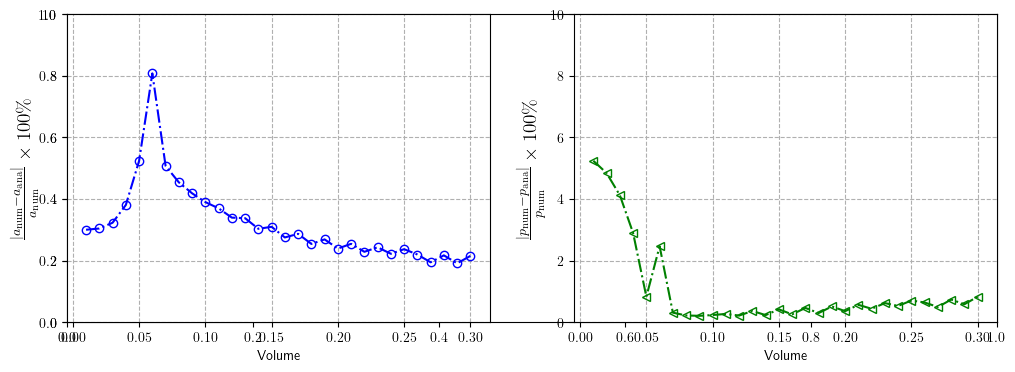

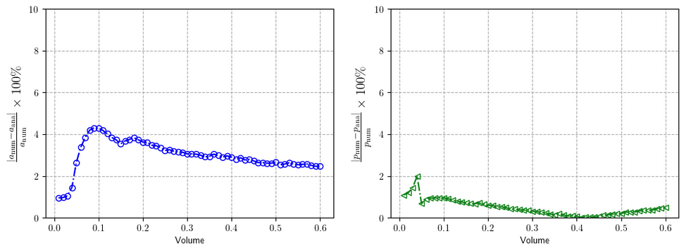

plt.plot(
    fluidVolume_analytical[1:],
        abs(length_analytical[1:] - np.array(surface_energy[:]) / (2 * Gc_ref))
        / (np.array(surface_energy[:]) / (2 * Gc_ref))
    * 100,
    "-.ob",
    fillstyle="none",
    label="Closed form",
plt.ylim([0.0, 10])
plt.ylabel(
    r"$\frac{|a_\mathrm{num}-{a}_\mathrm{ana}|}{{a}_\mathrm{num}}\times 100\%$",
    fontsize=14,
plt.plot(
    (abs(pressure_analytical[1:] - np.array(pressure[:]) / P_c) / pressure[:]) * 100,
    "-.<g",
    fillstyle="none",
plt.ylim([0.0, 10])
plt.ylabel(
    r"$\frac{|p_\mathrm{num}-{p}_\mathrm{ana}|}{{p}_\mathrm{num}}\times 100\%$",
    fontsize=14,
In order to reduce computation time, we perform the simulation with a coarse mesh; the results for the $\texttt{AT}_1$ Model with a mesh size of $h=0.001$ are provided below.
$\texttt{AT}_1$ Model:
Phase field versus analytical solution for fracture length and pressure evolution
Phase field versus analytical solution for fracture length and pressure evolution, $\texttt{AT}_1$.
Error between the Phase field and analytical solution for fracture length and pressure evolution.
Error between the Phase field and analytical solution for fracture length and pressure evolution, $\texttt{AT}_1$.

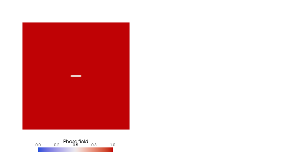

Hydraulic Fracturing Animation (Using Phase Field Approach)
filename = f"results_h_{h:0.4f}_{phasefield_model}"(click to toggle)
reader = pv.get_reader(f"{out_dir}/" + filename + ".pvd")
plotter = pv.Plotter(shape=(1, 2), border=False, off_screen=True)
plotter.open_gif(f"{out_dir}/Kregime_Propagating.gif")
    mesh = reader.read()[0]
    sargs = {
        "title": "Phase field",
        "title_font_size": 16,
        "label_font_size": 12,
        "n_labels": 5,
        "position_x": 0.25,
        "position_y": 0.15,
        "fmt": "%.1f",
        "width": 0.5,
    clim = [0, 1.0]
    xs = mesh.points[:, 0]
    ys = mesh.points[:, 1]
    plotter.clear()
    plotter.add_mesh(
        mesh,
        scalars=pf,
        show_scalar_bar=True,
        colormap="coolwarm",
        clim=clim,
        scalar_bar_args=sargs,
        lighting=False,
    plotter.add_text(f"Time: {time_value:0.02f}", color="black")
    plotter.view_xy()
    plotter.write_frame()
plotter.close()
