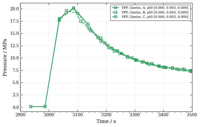

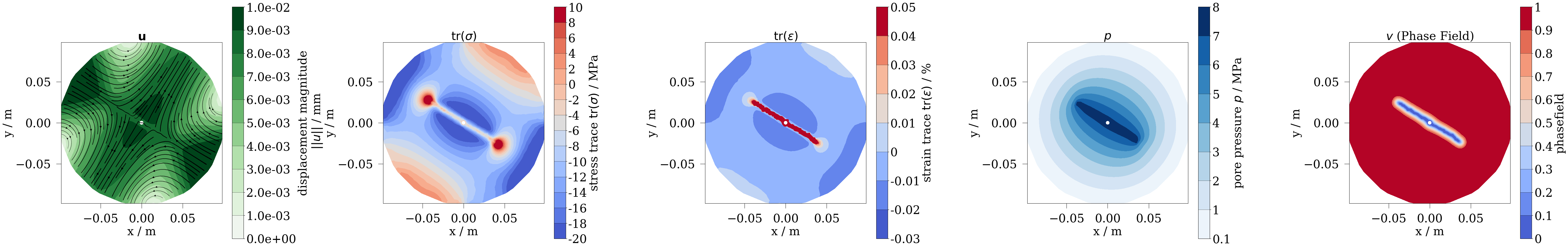

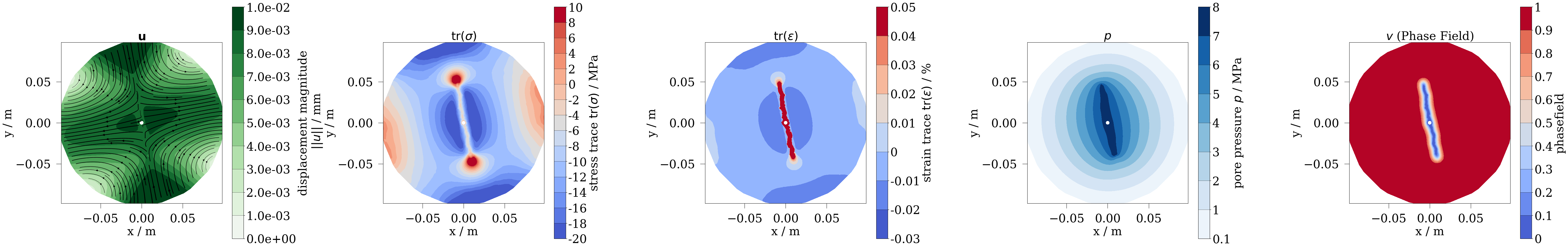

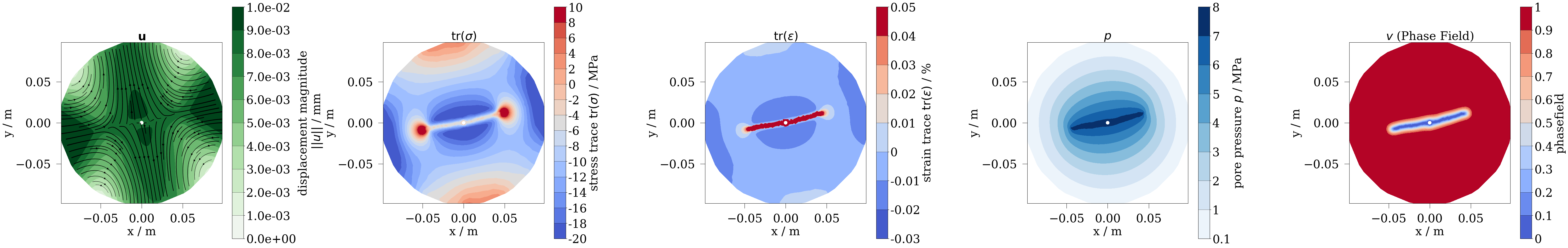

Great cell
$\texttt{HM}_{3d}$: Fracture Nucleation from Borehole under Poly-Axial Stress
The $\texttt{HM}_{3d}$ benchmark simulates fracture nucleation directly from a borehole in an intact rock sample subjected to poly-axial stress conditions.
Fluid is injected at a rate of:
$$ Q_0 = 2 \times 10^{-7} \times 2\pi r \quad \text{m}^2/\text{s}, \quad \text{with } r = 0.005\,\text{m}. $$
This test provides insight into fluid-driven fracture processes under realistic in situ conditions and is especially useful for validating coupled hydro-mechanical models.

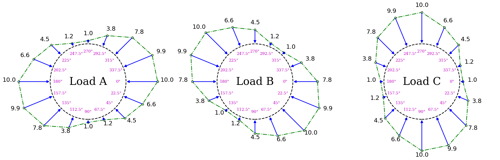

Loads
Table: Load Conditions
A 10.0 6.64 4.46 1.17 1.0 3.82 7.80 9.95
B 45.0° 7.80 9.95 10.0 6.64 4.46 1.17 1.0 3.82
C 90° 1.0 3.82 7.80 9.95 10.0 6.64 4.46 1.17
Schematic loading conditions
loads = {(click to toggle)
loads = {
    "A": [
        10.0e6,
        6.64e6,
        4.46e6,
        1.17e6,
        1.0e6,
        3.82e6,
        7.80e6,
        9.95e6,
        10.0e6,
        6.64e6,
        4.46e6,
        1.17e6,
        1.0e6,
        3.82e6,
        7.80e6,
        9.95e6,
    "B": [
        7.80e6,
        9.95e6,
        10.0e6,
        6.64e6,
        4.46e6,
        1.17e6,
        1.0e6,
        3.82e6,
        7.80e6,
        9.95e6,
        10.0e6,
        6.64e6,
        4.46e6,
        1.17e6,
        1.0e6,
        3.82e6,
    "C": [
        1.0e6,
        3.82e6,
        7.80e6,
        9.95e6,
        10.0e6,
        6.64e6,
        4.46e6,
        1.17e6,
        1.0e6,
        3.82e6,
        7.80e6,
        9.95e6,
        10.0e6,
        6.64e6,
        4.46e6,
        1.17e6,
angles_degrees = [(click to toggle)
angles_degrees = [
    0,
    -22.5,
    -45,
    -67.5,
    -90,
    -112.5,
    -135,
    -157.5,
    -180,
    -202.5,
    -225,
    -247.5,
    -270,
    -292.5,
    -315,
    -337.5,
circle_radius = 6

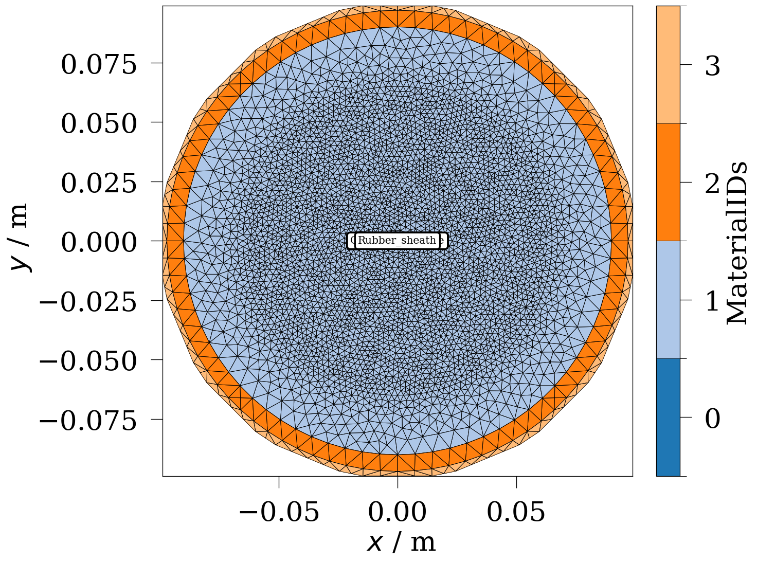

Mesh generation of intact samples
Input
h = 0.0025(click to toggle)
h = 0.0025
borehole_radius = 0.0025
delta = 0.00025
meshname = "GreatCell"
mesh_path = Path(out_dir, "mesh_borehole").resolve()
print(mesh_path)
/var/lib/gitlab-runner/builds/sy3_rc3xP/0/ogs/build/release-petsc/Tests/Data/HMPhaseField/GreatCell/GreatCellHM_VPF_propagating/mesh_borehole
Boundary meshes
Gmsh
msh_file = mesh_GreatCell_Borehole_VPF((click to toggle)
    lc=0.0075,
    h=h,
    lc1=h,
    r0=0.097,
    r1=0.090,
    r2=0.065,
    borehole_radius=borehole_radius,
    delta=delta,
    out_dir=mesh_path,
    meshname=meshname,
    mode="BC",
ot.Meshes.from_gmsh(msh_file, dim=[0, 1], reindex=True, log=False).save(
    mesh_path, overwrite=True

Pressure over time at observation points
(click to toggle)
obs_points = {"pt0": np.array([[0.0, 0.0025, 0.0]])}
plotter.plot_observation_points_vs_time(
    vtu_files_dict_HM,
    obs_points,
    var=ot.variables.pressure,
    methods_to_include=["VPF"],
    time_min=2900,
    time_max=3500,
/var/lib/gitlab-runner/builds/sy3_rc3xP/0/ogs/build/release-petsc/.venv/lib/python3.14/site-packages/ogstools/meshseries/_meshseries.py:112: RuntimeWarning: This is a parallel (pvtu) result, read natively (fast) instead of merged. This leaves ghost cells/boundary points duplicated, and integration-point data (e.g. '*_ip') may come from only one partition. Pass pvtu2vtu=True for a correctly merged mesh (slower), or pvtu2vtu=False to silence this warning.
