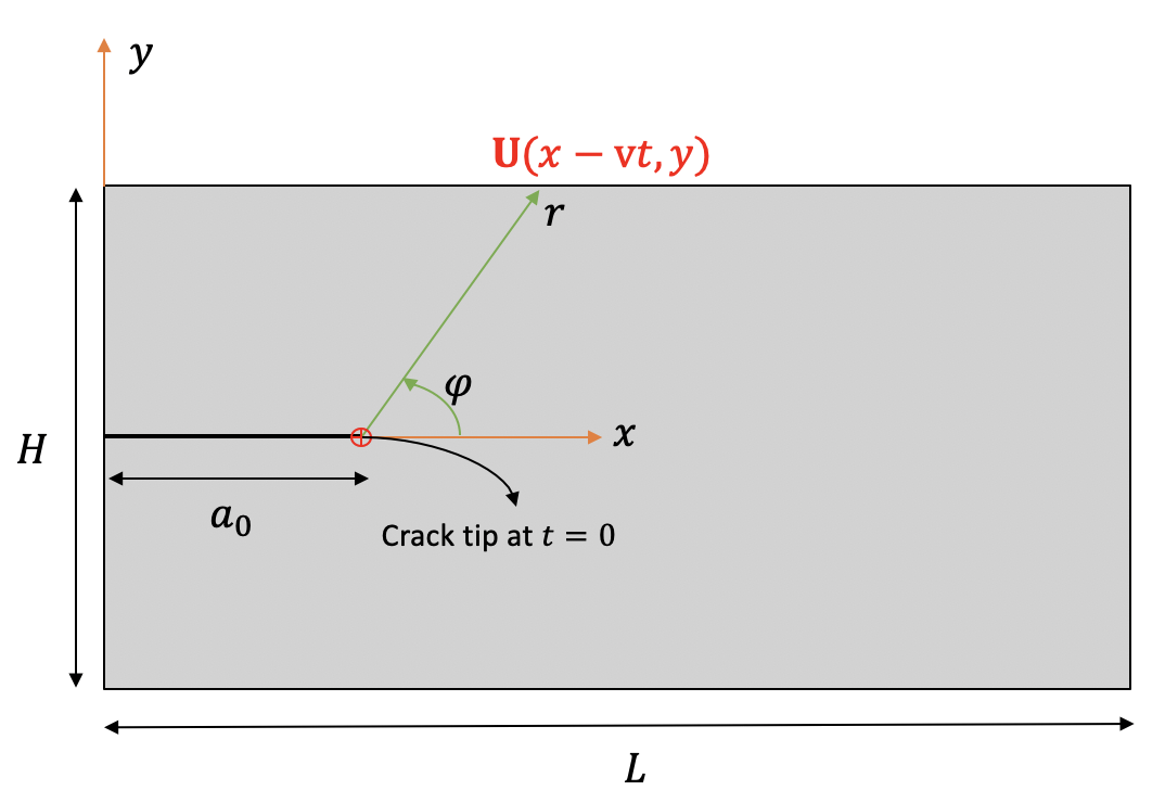

Surfing boundary
Consider a plate, $\Omega=[0,2]\times [-0.5,0.5]$, with an explicit edge crack, $\Gamma=[0,0.5]\times \{0\}$; that is subjected to a time dependent crack opening displacement:
\begin{eqnarray} \label{eq:surfing_bc} \mathbf{u}(x,y,t)= \mathbf{U}(x-\text{v}t,y) \quad \text{on} \quad \partial\Omega_D, \end{eqnarray} where $\text{v}$ is an imposed loading velocity; and $\mathbf{U}$ is the asymptotic solution for the Mode-I crack opening displacement \begin{eqnarray} \label{eq:asymptotic} U_x= \dfrac{K_I}{2\mu} \sqrt{\dfrac{r}{2\pi}} (\kappa-\cos \varphi) \cos \frac{\varphi}{2}, \nonumber \ U_y= \dfrac{K_I}{2\mu} \sqrt{\dfrac{r}{2\pi}} (\kappa-\cos \varphi) \sin \frac{\varphi}{2}, \end{eqnarray}
where $K_I$ is the stress intensity factor, $\kappa=(3-\nu)/(1+\nu)$ and $\mu=E / 2 (1 + \nu) $; $(r,\varphi)$ are the polar coordinate system, where the origin is crack tip. Also, we used $G_\mathrm{c}=K_{Ic}^2(1-\nu^2)/E$ as the fracture surface energy under plane strain condition. Table 1 lists the material properties and geometry of the numerical model.
Schematic view of surfing boundary condition benchmark
Schematic view of surfing boundary condition benchmark.
Input Data
Name Value Unit Symbol
Young’s modulus 210x$10^3$ MPa $E$
Critical energy release rate 2.7 MPa$\cdot$mm $G_{c}$
Poisson’s ratio 0.3 $-$ $\nu$
Regularization parameter 2$h$ mm $\ell_s$
Imposed loading velocity 1.5 mm/s $\text{v}$
Length $2$ mm $L$
Height $1$ mm $H$
Initial crack length $0.5$ mm $a_0$

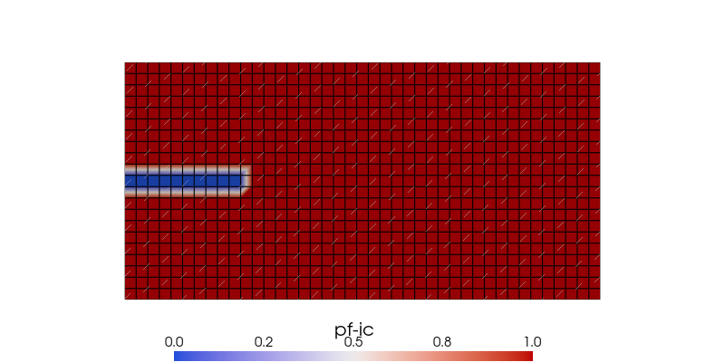

Pre-processing
At fracture, we set the initial phase field to zero.
if pv.global_theme.trame.server_proxy_enabled:(click to toggle)
mesh = pv.read(f"{out_dir}/surfing_quad_1x2_NR.vtu")
    if (
        x[0] < x_tip_Initial + h / 10
        and x[1] < Height / 2 + h
        and x[1] > Height / 2 - h
        phase_field[node_id] = 0.0
mesh.point_data["pf-ic"] = phase_field
mesh.save(f"{out_dir}/surfing_quad_1x2_NR_pf_ic.vtu")
pf_ic = mesh.point_data["pf-ic"]
sargs = {
    "title": "pf-ic",
    "title_font_size": 20,
    "label_font_size": 15,
    "n_labels": 5,
    "position_x": 0.24,
    "position_y": 0.0,
    "fmt": "%.1f",
    "width": 0.5,
clim = [0, 1.0]
p.add_mesh(
    mesh,
    scalars=pf_ic,
    show_edges=True,
    show_scalar_bar=True,
    colormap="coolwarm",
    clim=clim,
    scalar_bar_args=sargs,
p.view_xy()
p.camera.zoom(1.5)
p.window_size = [800, 400]
p.show()

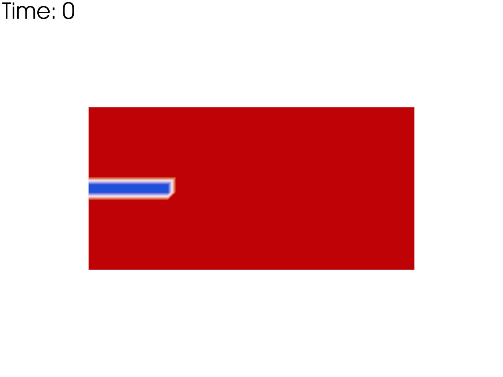

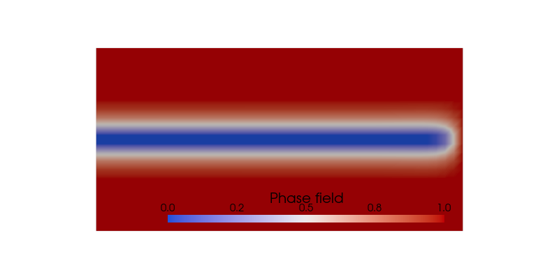

Run the simulation
# Change the length scale and phasefield model in project file(click to toggle)
    input_file=prj_name,
    MKL=True,
    args=f"-o {out_dir}",
gml_file = Path("./surfing.gml").resolve()
model.replace_parameter_value(name="ls", value=2 * h)
model.replace_text(Path("./Surfing_python.py").resolve(), xpath="./python_script")
t0 = time.time()
run(
    shell=True,
    check=True,
tf = time.time()
>>> OGS terminated execution  <<< Elapsed time:  19.96  s.

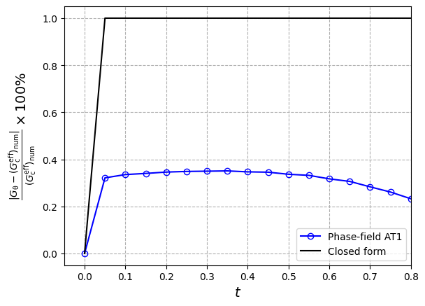

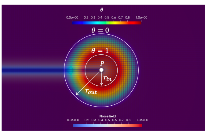

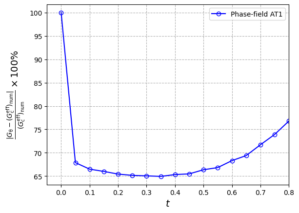

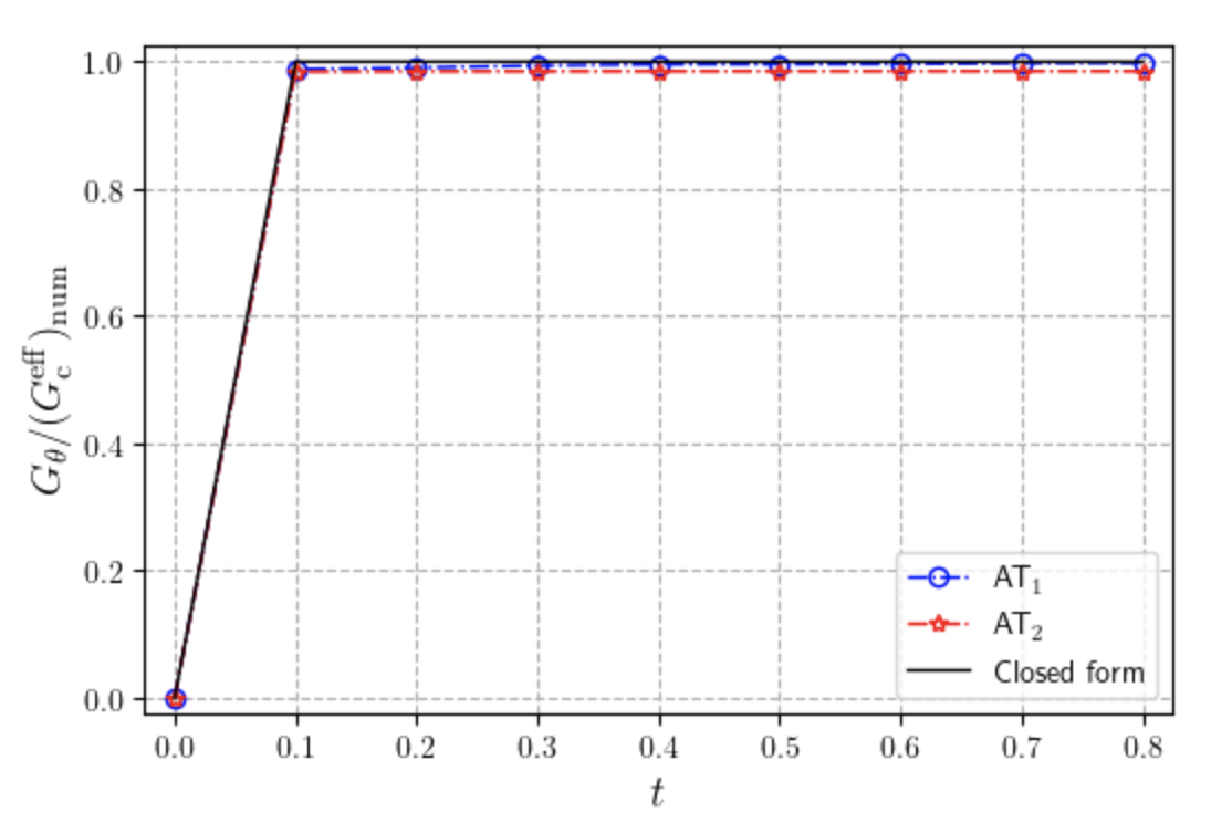

We computed the energy release rate using $G_{\theta}$ method (Destuynder et al., 1983; Li et al., 2016) and plot the errors against the theoretical numerical toughness i.e. $(G_c^{\text{eff}})_{\texttt{num}}=G_c(1+\frac{h}{2\ell})$ for $\texttt{AT}_2$, and $(G_c^{\text{eff}})_{\texttt{num}}=G_c(1+\frac{3h}{8\ell})$ for $\texttt{AT}_1$ (Bourdin et al., 2008).
Alt text
Phase field and $\theta$ profile for the volumetric deviatoric $\texttt{AT}_2$ models. We use virtual perturbation of $\theta$ to compute energy release rate using $G_{\theta}$ Dubois et al., 1998. The $\theta$ value is 1 inside of $B_{r_{in}}(P)$, 0 outside, and a linear interpolation in between. We set $r_{in}=4\ell$ and $r_{out}=2.5r_{in}$ (see Li et al., 2016).

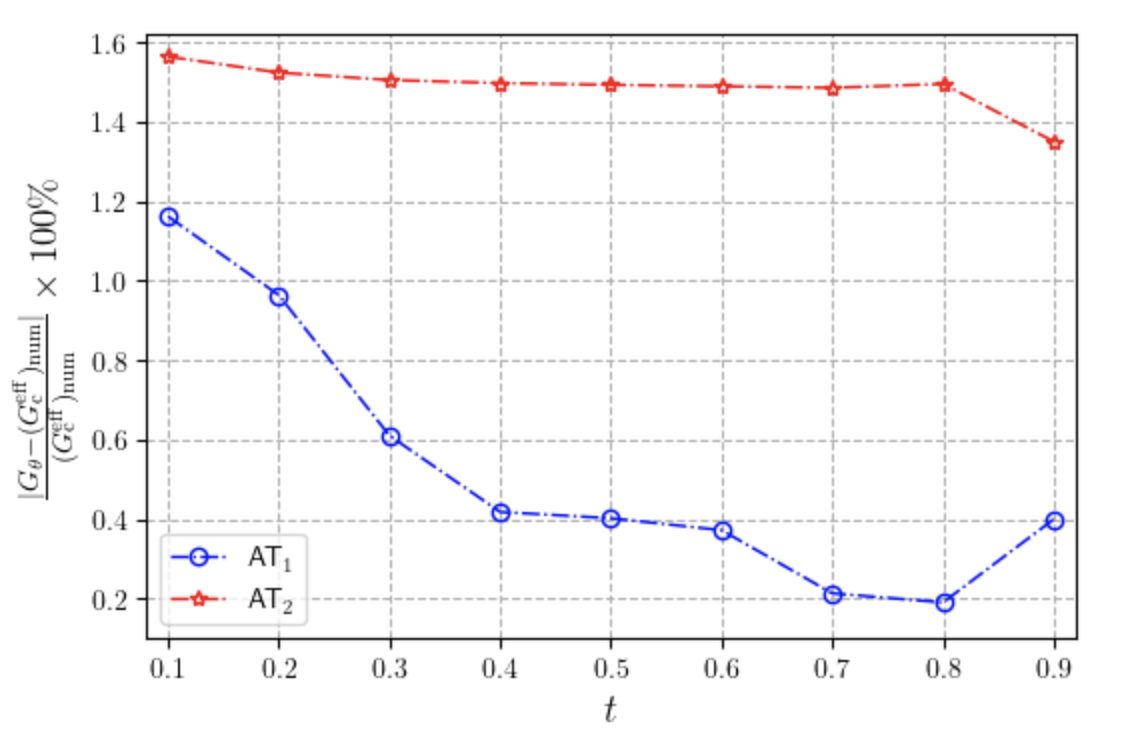

Alt text
R_inn = 4 * ls(click to toggle)
R_inn = 4 * ls
R_out = 2.5 * R_inn
if phasefield_model == "AT1":
    G_eff = G_i * (1 + 3 * h / (8 * ls))
    G_eff = G_i * (1 + h / (2 * ls))
We run the simulation with a coarse mesh here to reduce computing time; however, a finer mesh would give a more accurate results. The energy release rate and its error for Models $\texttt{AT}_1$ and $\texttt{AT}_2$ with a mesh size of $h=0.005$ are shown below.
Alt text Alt text
Post-processing
reader = pv.get_reader(f"{out_dir}/surfing.pvd")(click to toggle)

        return np.sqrt(np.sum(np.cross(x - y, x - z), axis=-1) ** 2) / 2
    G_theta = 0
    for vertices in tri.simplices:
        mean_value = (
            G_theta_i[vertices[0]] + G_theta_i[vertices[1]] + G_theta_i[vertices[2]]
        ) / 3
        area = area_from_3_points(
            domain_points[vertices[0]],
            domain_points[vertices[1]],
            domain_points[vertices[2]],
        G_theta += mean_value * area
    G_theta_time[t][1] = G_theta
    G_theta_time[t][0] = time_value
mesh.save(f"{out_dir}/surfing_Post_Processing.vtu")

Plots
plt.xlabel("$t$", fontsize=14)(click to toggle)
plt.ylabel(
    r"$\frac{|{G}_\mathrm{\theta}-({G}_\mathrm{c}^{\mathrm{eff}})_\mathrm{num}|}{({G}_\mathrm{c}^{\mathrm{eff}})_\mathrm{num}}\times 100\%$",
    fontsize=14,
plt.plot(
    G_theta_time[:, 0],
    abs(G_theta_time[:, 1]) / G_eff,
    "-ob",
    fillstyle="none",
    linewidth=1.5,
    label=f"Phase-field {phasefield_model}",
plt.plot(
    G_theta_time[:, 0],
    np.append(0, np.ones(len(G_theta_time[:, 0]) - 1)),
    "-k",
    fillstyle="none",
    linewidth=1.5,
    label="Closed form",
plt.grid(linestyle="dashed")
plt.xlim(-0.05, 0.8)
plt.ylabel(
    fontsize=14,
plt.plot(
    G_theta_time[:, 0],
    abs(G_theta_time[:, 1] - G_eff) / G_eff * 100,
    "-ob",
    fillstyle="none",
    linewidth=1.5,
# plt.ylim(0,4)
Hint: Accurate results can be obtained by using the mesh size below 0.02.

Fracture propagation animation
plotter = pv.Plotter(off_screen=True)(click to toggle)
figures_dir = Path(os.environ["OGS_TESTRUNNER_WEB_OUT_DIR"]) / "figures"
figures_dir.mkdir(parents=True, exist_ok=True)
plotter.open_gif(figures_dir / "surfing.gif")
    sargs = {
        "title": "Phase field",
        "n_labels": 5,
        "position_x": 0.3,
        "position_y": 0.2,
        "fmt": "%.1f",
        "width": 0.5,
    clim = [0, 1.0]
    xs = mesh.points[:, 0]
    ys = mesh.points[:, 1]
    plotter.clear()
    plotter.add_mesh(
        mesh,
        scalars=pf,
        show_scalar_bar=False,
        clim=clim,
        lighting=False,
    plotter.view_xy()
    plotter.write_frame()
plotter.close()
Phase field profile at last time step
mesh = reader.read()[0](click to toggle)
p.add_mesh(
    mesh,
    scalars=pf,
    show_edges=False,
    clim=clim,
p.view_xy()
p.camera.zoom(1.5)
p.show()
