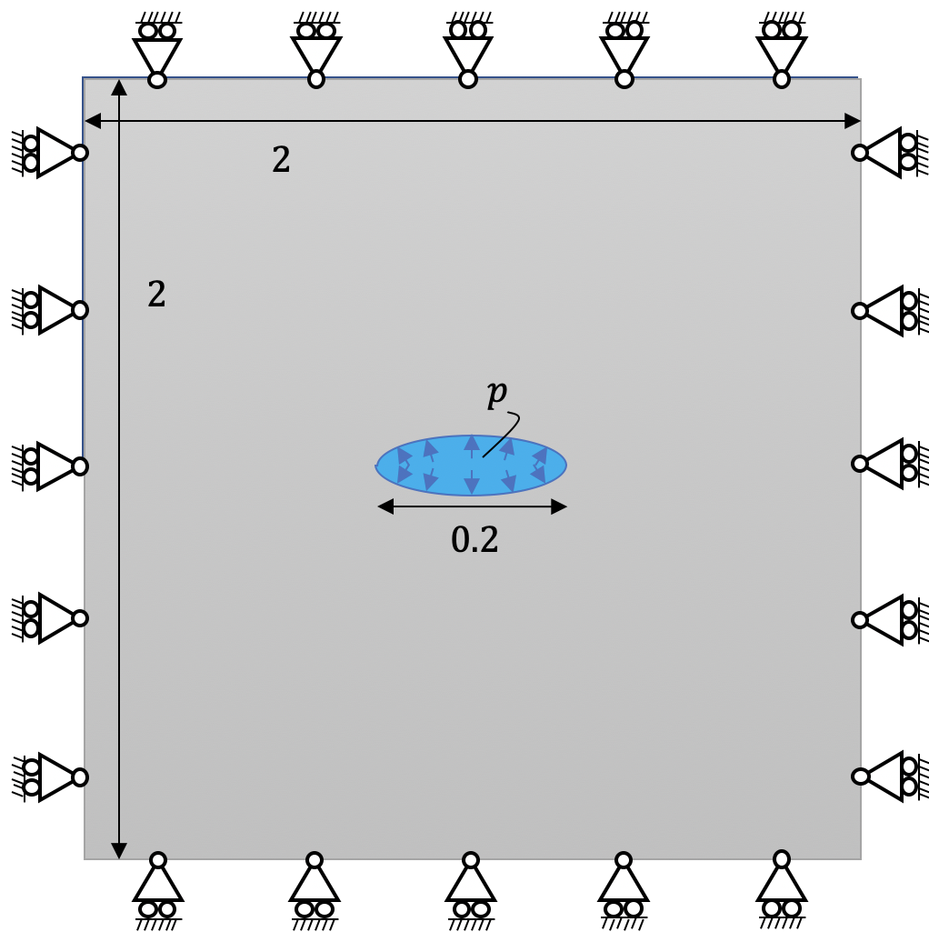

Static fracture opening under a constant pressure
Consider a line fracture $[-a_0, a_0] \times \{0\}$ ($a_0$ = 0.1) with no external loading and an internal fluid pressure of $p=1$ was applied to the fracture surfaces. The results are compared to the analytical solution (Sneddon et al., 1969) for the fracture half-opening: \begin{eqnarray} u(x,0) = \frac{2 p a_0}{ E’} \sqrt{1-(x/a_0)^2} , \label{eq:sneddon_2D_static} \end{eqnarray}
where $u$ is the displacement $E'$ is the plane strain Young’s modulus ($E' = E/(1-\nu^2)$) with $\nu$ is Poisson`s ratio, $p$ is the fluid pressure inside the fracture. To account for the infinite boundaries in the closed-form solution, we considered a large finite domain $ [-10a_o,10a_o] \times [-10a_o,10a_o]$. The effective element size, $h$, is $1\times10^{-2}$.
- In order to have a static pressurized fracture, add, $\texttt{
static }$ in the project file. It’s important to note that static pressurized fracture implementation assumes $p=1$. Yoshioka et al., 2019 discussed using real material properties and rescaling the phase-field energy functional.
Input data
The material and geometrical properties are listed in the Table below. It’s worth noting that the properties are dimensionless and scaled.
| Name | Value | Symbol |
| Young’s modulus | 1 | $E$ |
| Poisson’s ratio | 0.15 | $\nu$ |
| Fracture toughness | 1 | $G_{c}$ |
| Regularization parameter | 2$h$ | $\ell_s$ |
| Pressure | 1 | $p$ |
| Length | 2 | $L$ |
| Height | 2 | $H$ |
| Initial crack length | 0.2 | $2a_0$ |

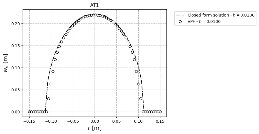

return x, uy, a_effOpening profile
color = ["-.k", "ko", "-.r", "ro", "-.b", "bo", "-.g", "go"]…
(click to toggle)
Label = ["Closed form solution", "VPF-FEM"]
lineWIDTH = [1.5, 1.5, 1.5]
for j, h_j in enumerate(h_list):
r_i_num = []
width_line_num = []
filename = f"results_h_{h_j:0.4f}"
print(filename)
width_calculation(filename)
r_i_num = width_calculation(filename)[0]
width_line_num = width_calculation(filename)[1]
ls = 2 * h_j
x_Sneddon = sneddon(h_j, ls, phasefield_model)[0]
uy_Sneddon = sneddon(h_j, ls, phasefield_model)[1]
a_eff_Sneddon = sneddon(h_j, ls, phasefield_model)[2]
plt.plot(
np.array(x_Sneddon[:]),
np.array(uy_Sneddon[:]),
color[2 * j],
fillstyle="none",
markersize=0,
linewidth=lineWIDTH[0],
label=f"Closed form solution - $h= ${h_j:0.4f}",
plt.plot(
np.array(r_i_num[:]),
np.array(width_line_num[:]),
color[2 * j + 1],
fillstyle="none",
markersize=6,
linewidth=lineWIDTH[1],
label=f"VPF - $h =${h_j:0.4f}",
plt.rcParams["figure.figsize"] = [40, 20]
plt.rcParams["figure.dpi"] = 1600
plt.ylabel("$w_n$ [m]", fontsize=14)
plt.xlabel("$r$ [m]", fontsize=14)
plt.grid(linestyle="dashed")
plt.title(f"{phasefield_model}")
legend = plt.legend(bbox_to_anchor=(1.04, 1), loc="upper left")
plt.show()results_h_0.0100

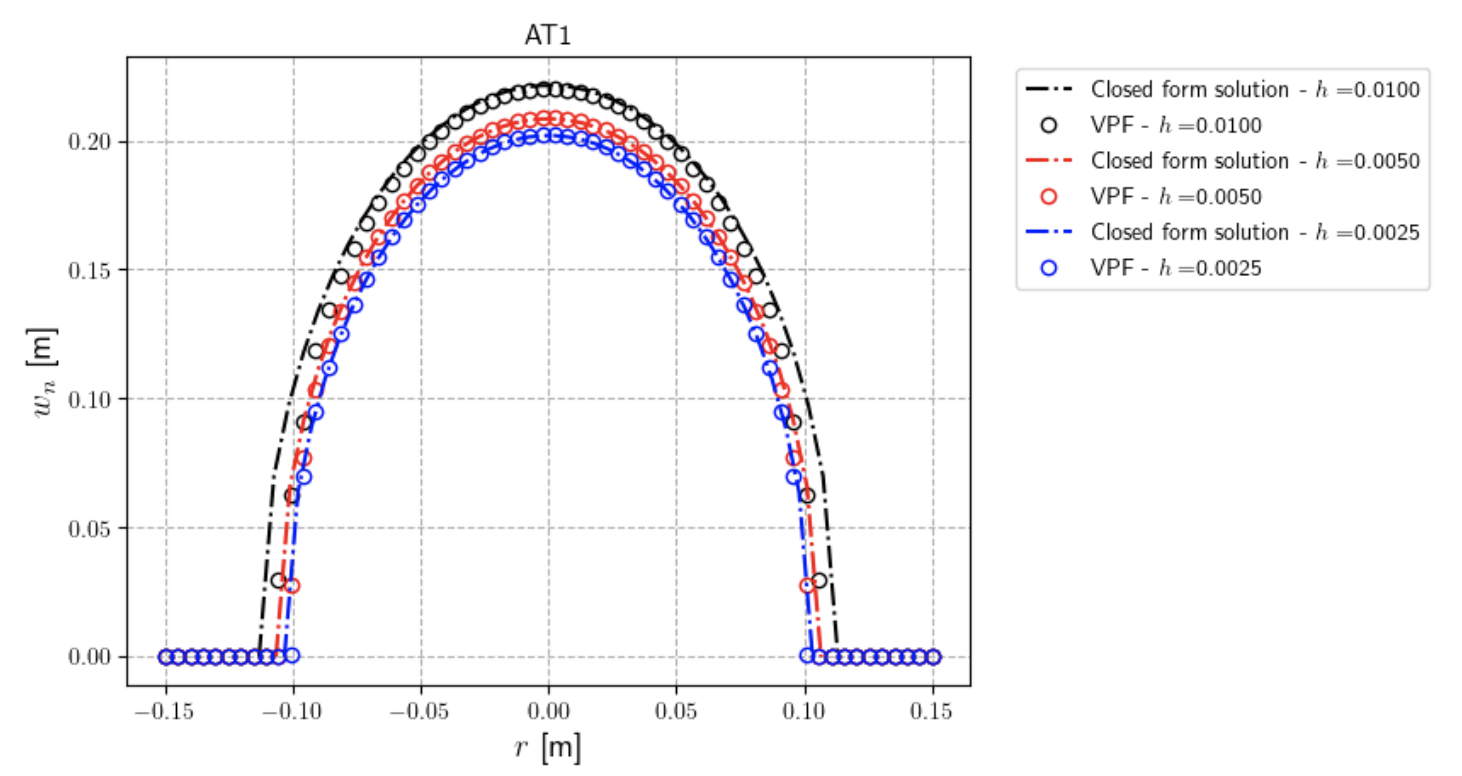

To decrease computing time, we perform the simulation with an one coarse mesh; Mesh sensitivity can be investigated in order to assess the convergence of the opening profile for various mesh discretizations. Following are the mesh sensivity results for for Models $\texttt{AT}_1$ and $\texttt{AT}_2$ ($h=0.01,~0.005,~\text{and} ~0.0025$ m.)
Our mesh size sensitivity study shows even with coarse mesh. The results away from crack tips agree well with the Sneddon solution. Using finer mesh demonstrates that the opening along the whole crack length is accurate compared with the closed-form solution.
It’s worth noting that we estimate width as part of post-processing (using the line integral and a given crack normal vector). However, near crack tips the crack normal vector is different to the given normal vector, so the width values are inaccurate near crack tips. For the sake of simplicity, we neglect determining the normal crack vector here; for more information on the line integral approach, see Yoshioka et al., 2020.
