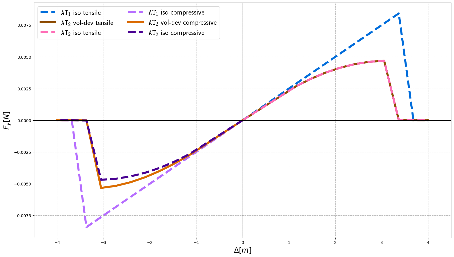

print(" > OGS terminated execution. Elapsed time: ", round(tf - t0, 2), " s.")Input data
The values of the material properties are choosen as follows.
| Name | Value | Unit | Symbol |
| Young’s modulus | 1 | Pa | $E$ |
| Critical energy release rate | 1 | Pa$\cdot$m | $G_{c}$ |
| Poisson’s ratio | 0.15 | $-$ | $\nu$ |
| Regularization parameter | 3$h$ | m | $\ell$ |
| Length | $1$ | m | $L$ |
| Height | $0.05$ | m | $H$ |
| Depth | $0.05$ | m | $D$ |
Run Simulations
pf_ms = ["AT1", "AT2"]…
(click to toggle)
es_ms = ["VolumetricDeviatoric", "Isotropic"]
displ = [4.0, -4.0]
for a in pf_ms:
for c in displ:
ogs_beam(a,es_ms[1],bc_displacement = c,mesh_size = 0.01, length_scale = 0.03)
ogs_beam(pf_ms[1],es_ms[0],bc_displacement = 4,mesh_size = 0.01, length_scale = 0.03)
# run AT1_vd_tensile with smaller timesteps in critical time range
ogs_beam(pf_ms[0],es_ms[0],bc_displacement = 5,mesh_size = 0.01, length_scale = 0.03,repeat_list=['62','2','20','1'], delta_t_list=['1e-2','1e-3','1e-4','1e-2'])
# run VolumetricDeviatoric in Compression with Hypre and smaller timesteps in critical time range
ogs_beam(pf_ms[1],es_ms[0],bc_displacement = -4.5,mesh_size = 0.01, length_scale = 0.03, hypre = True, repeat_list=['70','4','30','1'], delta_t_list=['1e-2','1e-3','1e-4','1e-2'])
# loosen relative error tolerance for displacement process in order to get convergence for the AT1 case
prj_path='./'
prj_name = "beam.prj"
model = ot.Project(input_file=prj_path+prj_name, output_file=prj_path+prj_name, MKL=True)
model.replace_text('1e-6', xpath="./time_loop/processes/process/convergence_criterion/reltol",occurrence=0)
ogs_beam(pf_ms[0],es_ms[0],bc_displacement = -4.95, mesh_size = 0.01, length_scale = 0.03, hypre= True, repeat_list=['66', '8','3','3','20','1'], delta_t_list=['1e-2','1e-3','1e-4','1e-5','1e-6','1e-2'],ts_coords='0 0.1 1', values ='0 0.5 1')
model.replace_text('1e-14', xpath="./time_loop/processes/process/convergence_criterion/reltol",occurrence=0)
## run only cases easy to handle with coarse timestepping:
for a in pf_ms:
for b in es_ms:
for c in displ:
if a == "AT1" and b == "VolumetricDeviatoric":
continue
if a == "AT2" and b == "VolumetricDeviatoric" and c < 0:
ogs_beam(
a,
b,
bc_displacement=c,
mesh_size=0.01,
length_scale=0.03,
hypre=True,
repeat_list=["1"],
delta_t_list=["1e-1"],
ogs_beam(
a,
b,
bc_displacement=c,
mesh_size=0.01,
length_scale=0.03,
repeat_list=["1"],
)> Running beam model AT1 - Isotropic ... <
> OGS started execution ...
> OGS terminated execution. Elapsed time: 7.2 s.
> OGS terminated execution. Elapsed time: 7.26 s.
> Running beam model AT2 - VolumetricDeviatoric ... <
> OGS terminated execution. Elapsed time: 18.81 s.
> OGS terminated execution. Elapsed time: 93.97 s.
> Running beam model AT2 - Isotropic ... <
> OGS terminated execution. Elapsed time: 20.74 s.
> OGS terminated execution. Elapsed time: 17.9 s.

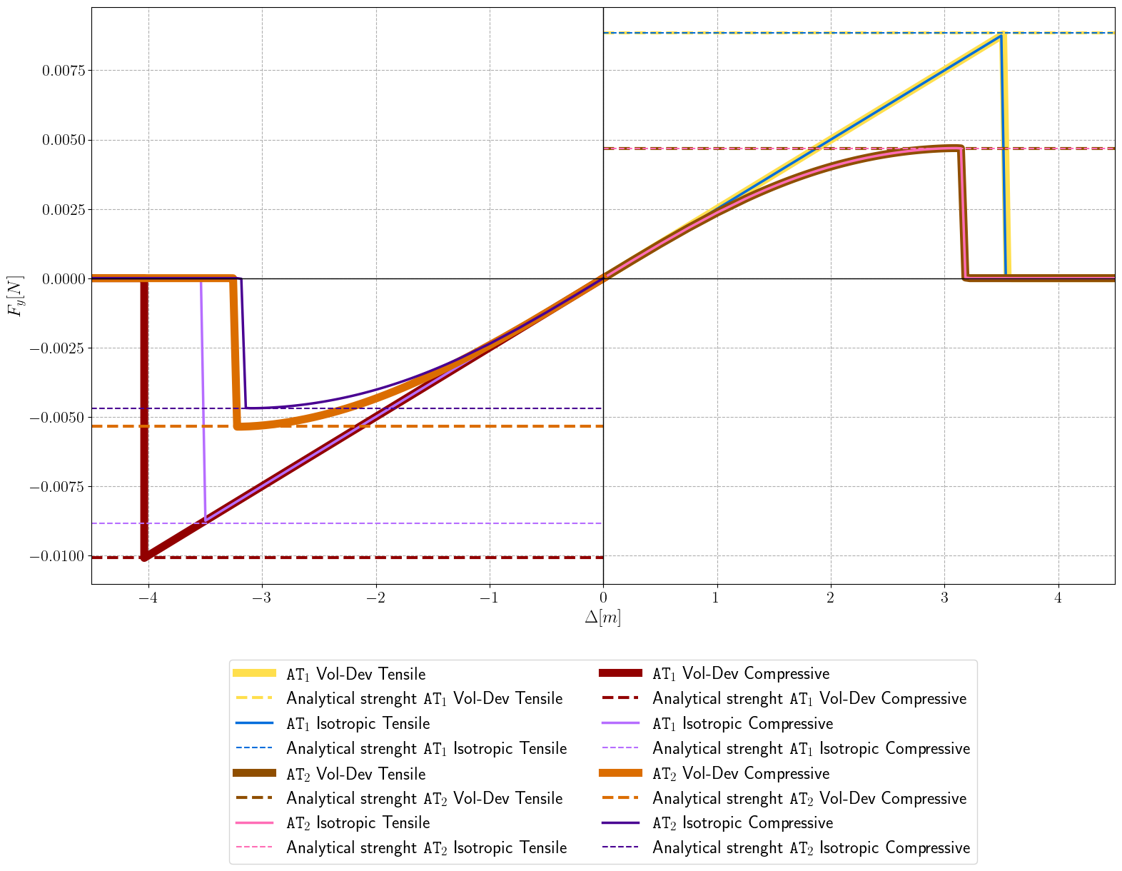

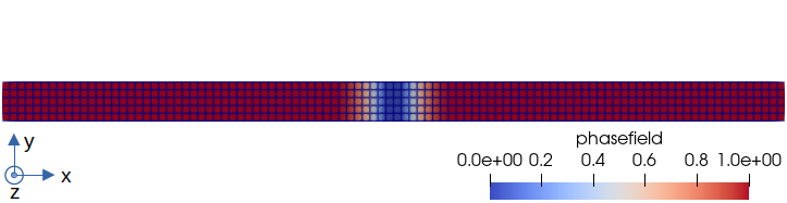

The final timestep of the AT1 iso tensile case is shown exemplary for the phasefield after fracture.
Post-processing
The force applied to the beam is compared to the change in length of the beam.
# define function to obtain displacement applied at the right end of the beam from rvtu file…
(click to toggle)
def displ_right(filename):
data = pv.read(filename)
data.point_data["displacement"]
max_x = max(data.points[:, 0])
return np.mean(
data.point_data["displacement"][:, 0],
where=np.transpose(data.points[:, 0] == max_x),
# define fuction to obtain force acting on the right end of the beam from vtu file
def force_right(filename):
data.point_data["NodalForces"]
return np.sum(
data.point_data["NodalForces"][:, 0],
# define function applying obove functions on all vtu file listet in pvd file, returning force-displacement curve
doc = minidom.parse(str(pvd))
forces_right = [force_right(f"{out_dir}/{x}") for x in vtu_files]
displs_right = [displ_right(f"{out_dir}/{x}") for x in vtu_files]
return [forces_right, displs_right]Plot force-strain curves
prefixes = […
(click to toggle)
prefixes = [
"AT1_vd_tensile",
"AT1_iso_tensile",
"AT2_vd_tensile",
"AT2_iso_tensile",
"AT1_vd_compressive",
"AT1_iso_compressive",
"AT2_vd_compressive",
"AT2_iso_compressive",
labels = [
r"$\texttt{AT}_1$ vol-dev tensile",
r"$\texttt{AT}_1$ iso tensile",
r"$\texttt{AT}_2$ vol-dev tensile",
r"$\texttt{AT}_2$ iso tensile",
r"$\texttt{AT}_1$ vol-dev compressive",
r"$\texttt{AT}_1$ iso compressive",
r"$\texttt{AT}_2$ vol-dev compressive",
r"$\texttt{AT}_2$ iso compressive",
ls = ["-", "--"]
colors = [
"#ffdf4d",
"#006ddb",
"#8f4e00",
"#ff6db6",
"#920000",
"#b66dff",
"#db6d00",
"#490092",
fig, ax = plt.subplots()
plt.rc("text", usetex=True)
fig.set_size_inches(18.5, 10.5)
pvd = out_dir / f"{pre}.pvd"
if pvd.is_file():
ax.plot(
curve[1],
curve[0],
ls[i % 2],
label=labels[i],
linewidth=5,
color=colors[i],
alpha=1,
plt.rcParams["xtick.labelsize"] = 16
plt.rcParams["ytick.labelsize"] = 16
ax.grid(linestyle="dashed")
ax.set_xlabel(r"$\Delta [m]$", fontsize=18)
ax.set_ylabel("$F_y [N]$", fontsize=18)
plt.legend(fontsize=18, ncol=2)
ax.set_xlim(-4.5, 4.5)(-4.5, 4.5)
Running all the cases with finer timesteps yields the following figure. The failure of the beam in the simulation is observed, when the loading reaches the analytical strength for the corresponding case.
