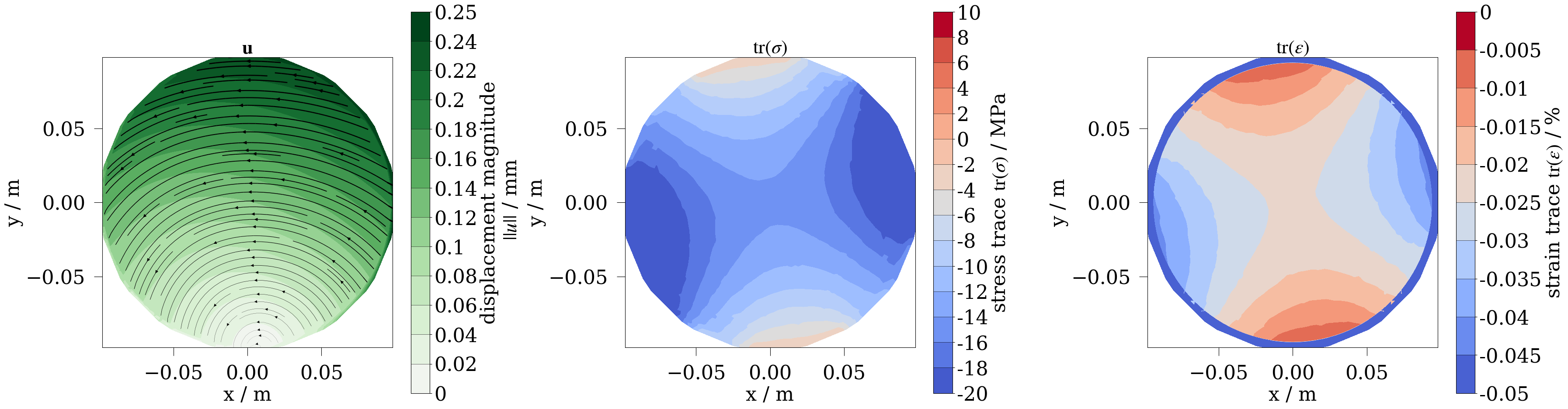

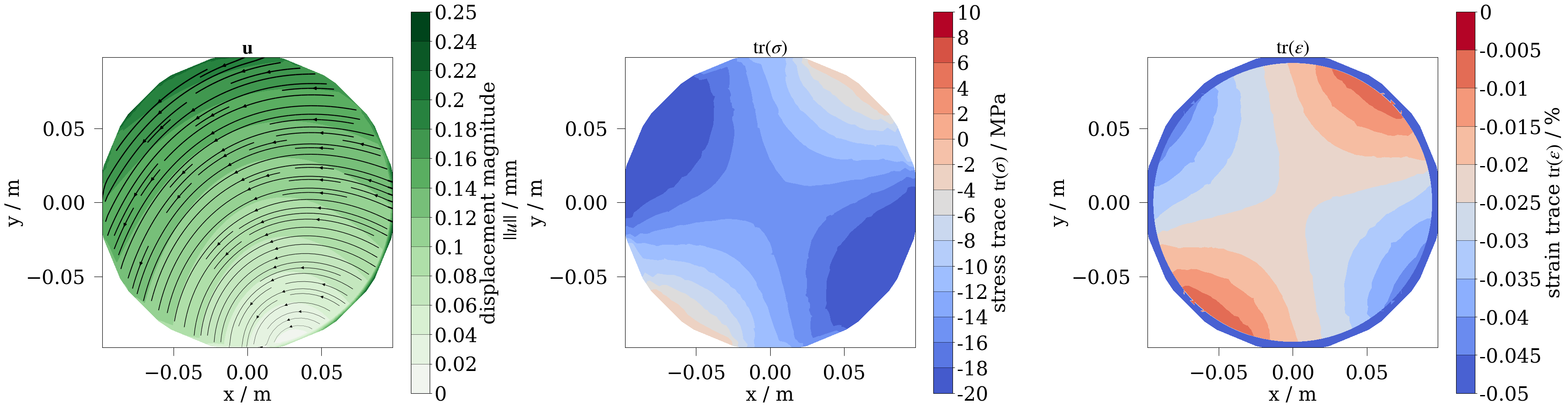

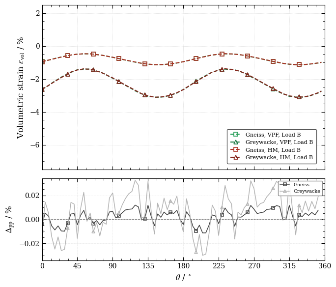

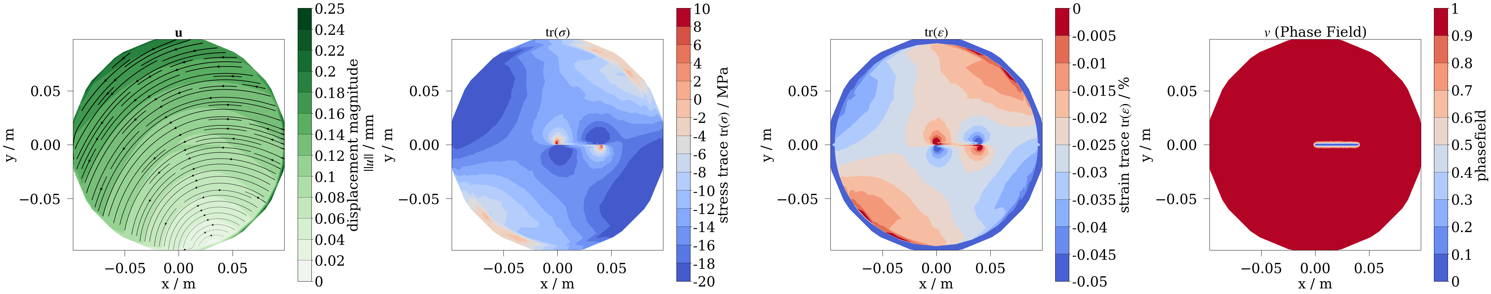

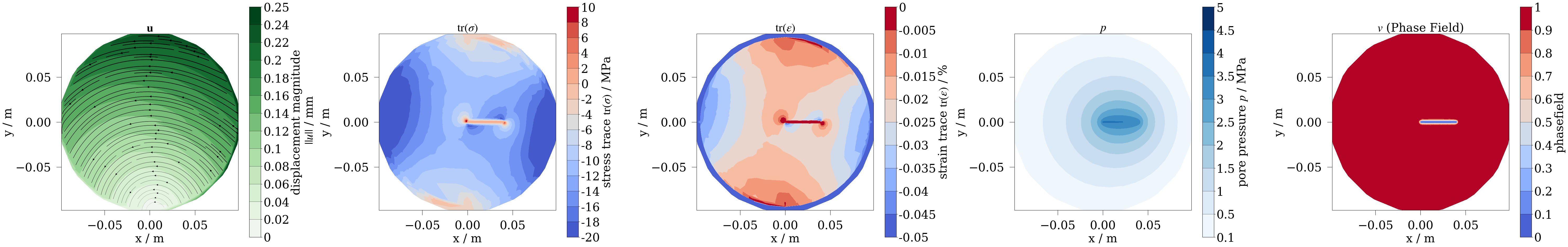

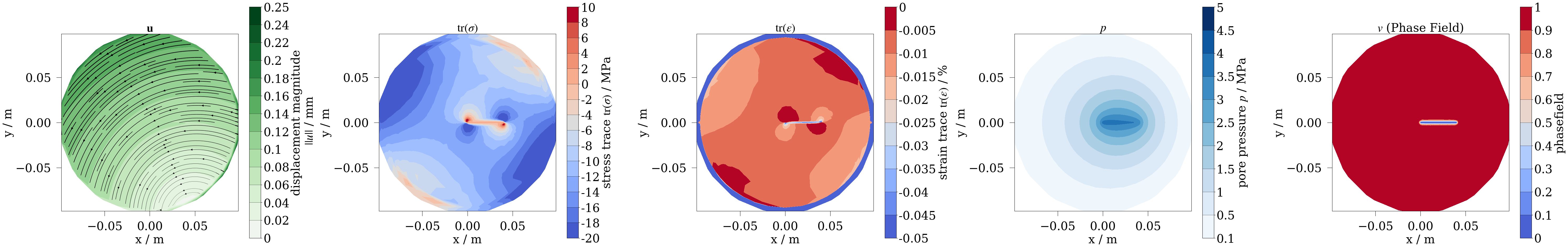

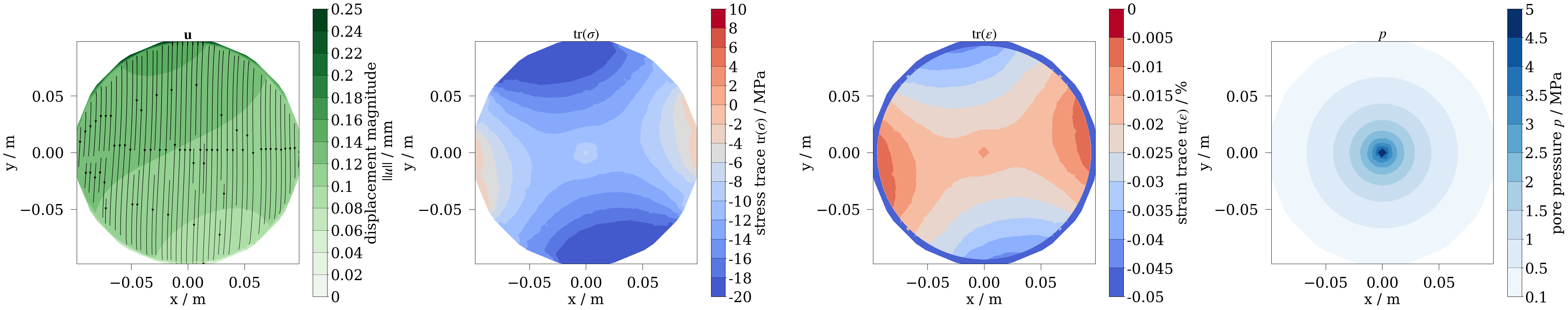

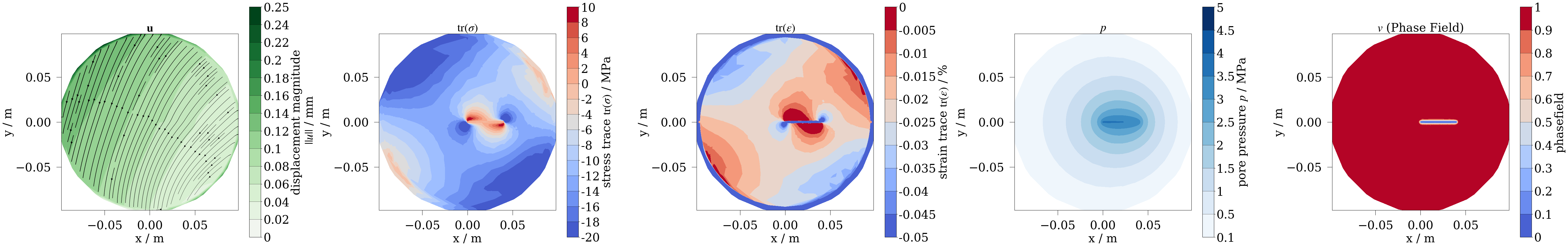

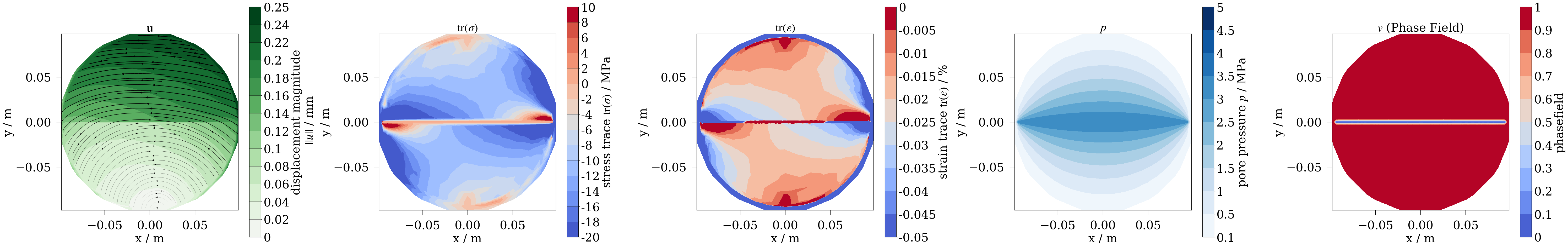

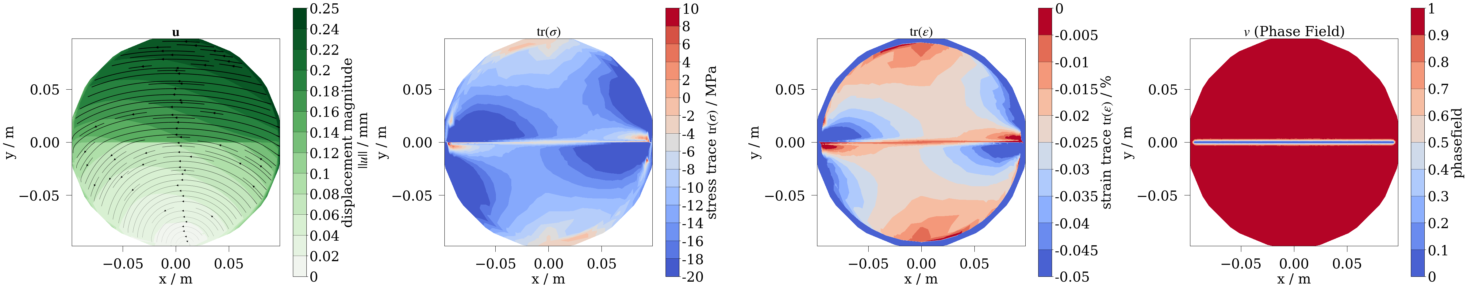

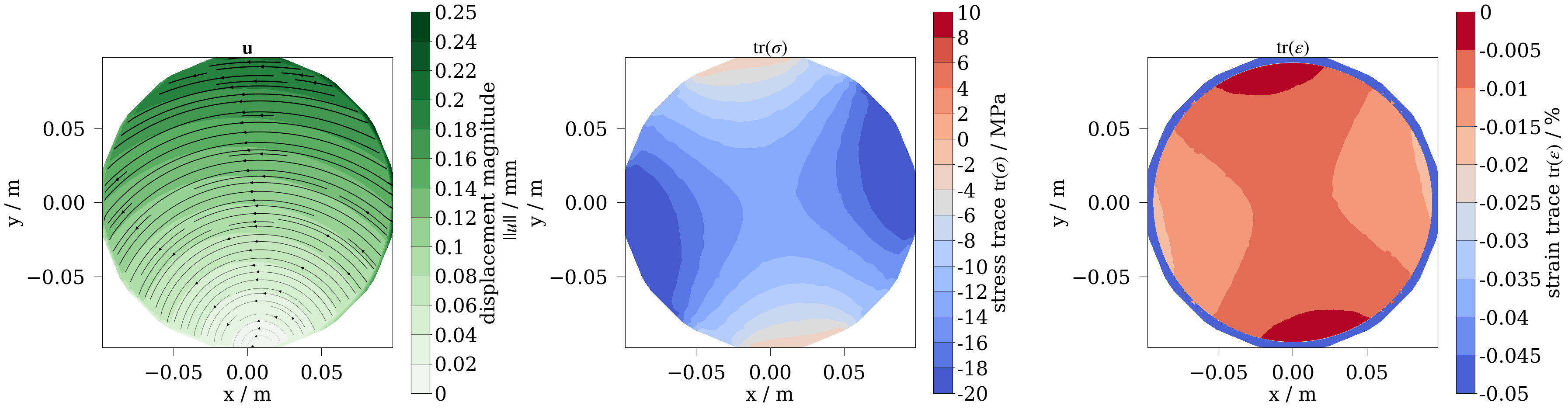

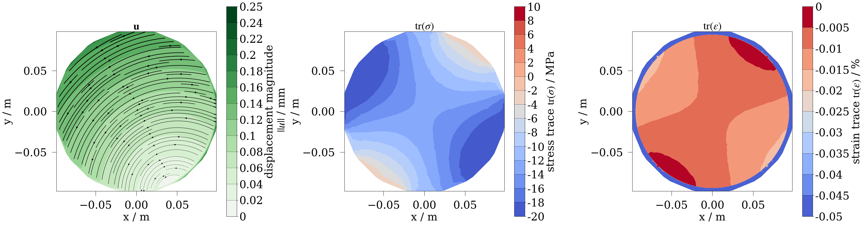

The GREAT cell is a poly-axial rock-testing device that reproduces subsurface conditions down to 3.5 km depth on 200 mm-diameter samples. It imposes a rotating stress field, injects fluid through a central borehole, and records both fiber-optic strain and pore-pressure data—providing a rich dataset for validating coupled hydro-mechanical models. For full details, see the GREAT cell benchmark docs: www.opengeosys.org/docs/benchmarks/small-deformations/greatcellm/
We distinguish two main types of benchmarks: intact and fractured rock tests. In the first type, an intact rock sample is subjected to rotating external stress conditions ($\texttt{M}_1$) and fluid is injected from a central borehole ($\texttt{HM}_1$):
- $\texttt{M}_1$: Intact rock sample under rotating boundary conditions.

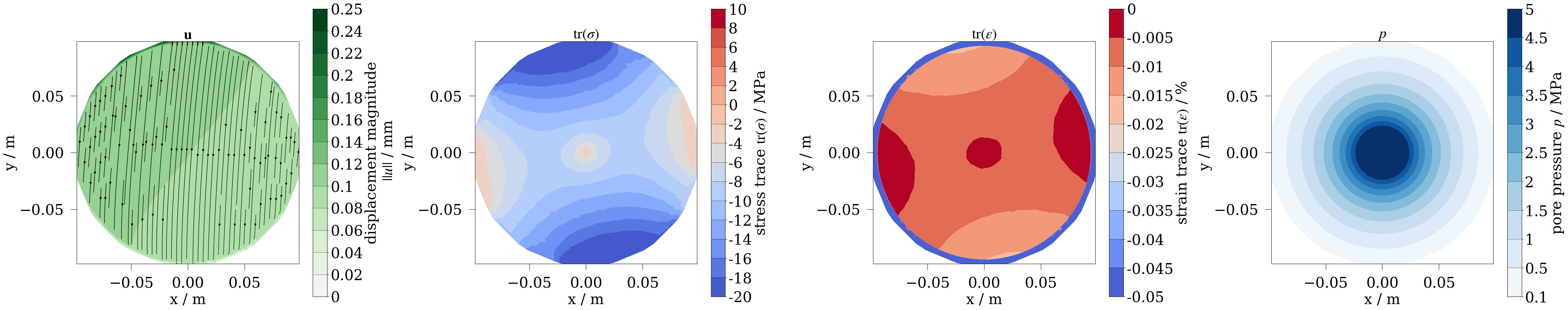

- $\texttt{HM}_1$: Intact rock sample with fluid injection.

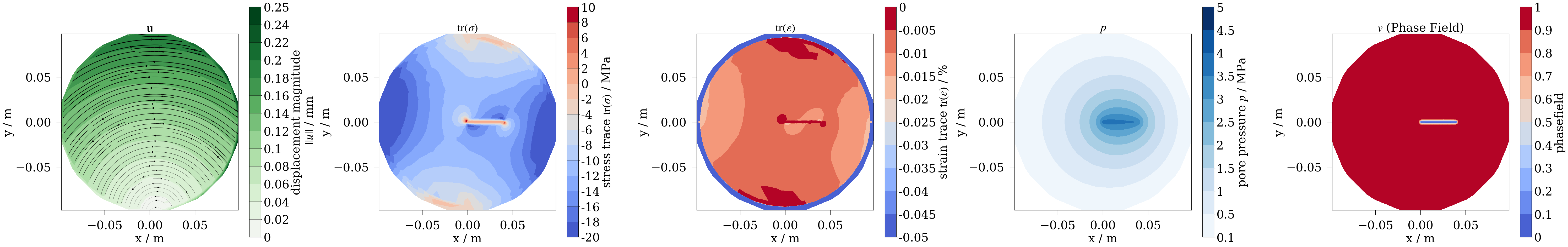

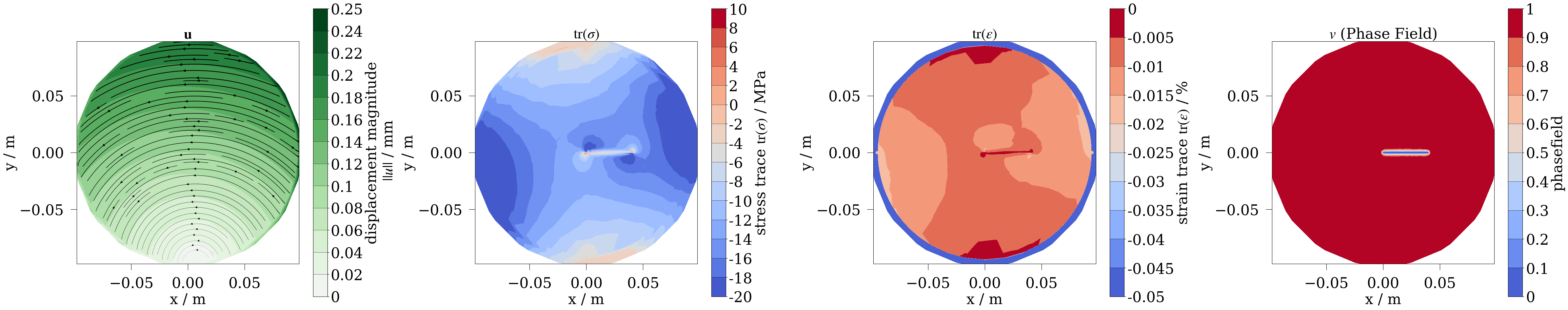

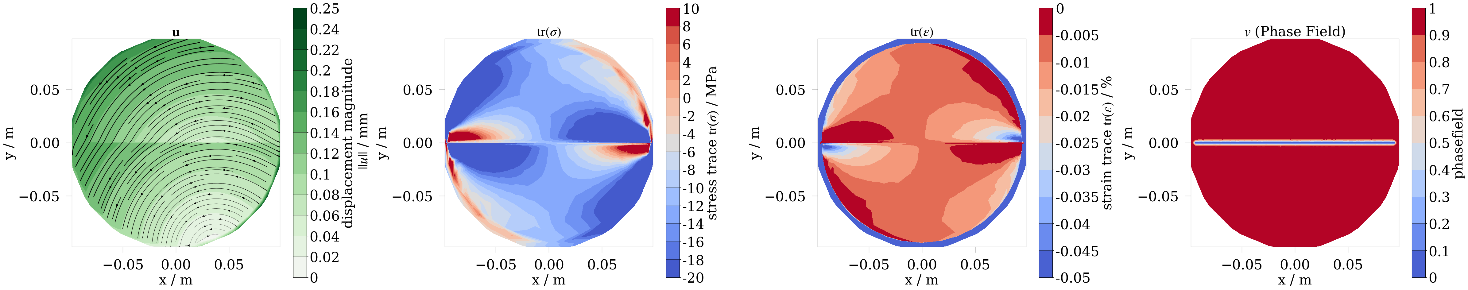

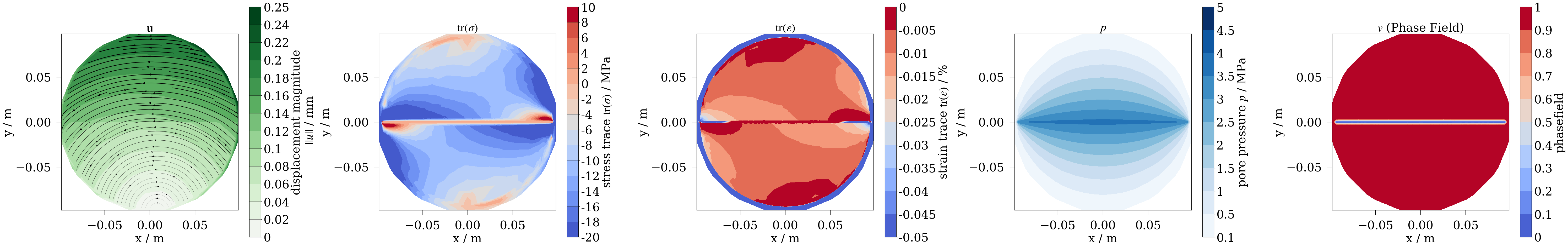

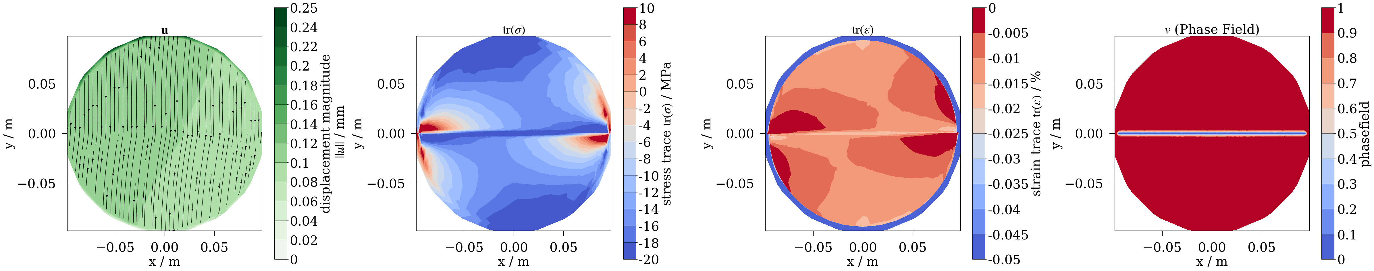

For the fractured rock samples, two subtypes are also considered: static and propagating fractures. Static fractures are studied as full ($\texttt{M}_{2a}$, $\texttt{HM}_{2a}$) and half-fractured ($\texttt{M}_{2b}$, $\texttt{HM}_{2b}$) versions to have a symmetric and non-symmetric case. Again, mechanical and hydro-mechanical versions are studied, the latter with fluid injection into the rock fracture:
- $\texttt{M}_{2a}$: Fully fractured sample.
- $\texttt{M}_{2b}$: Half-fractured sample.
- $\texttt{HM}_{2a}$: Fully fractured sample with inflow-outflow.
- $\texttt{HM}_{2b}$: Half-fractured sample with inflow-outflow.
To run this benchmark, you need to have OGS built with PETSc and PIP support. The following steps outline the process:

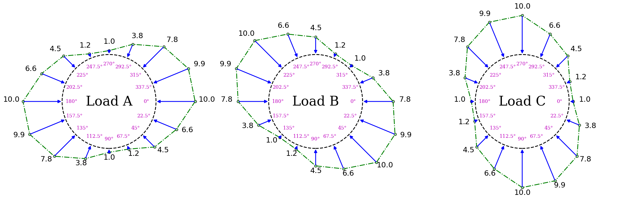

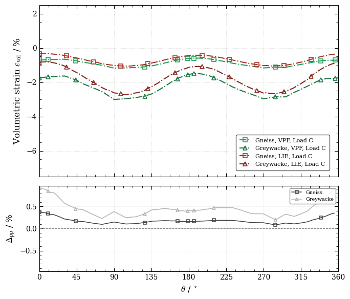

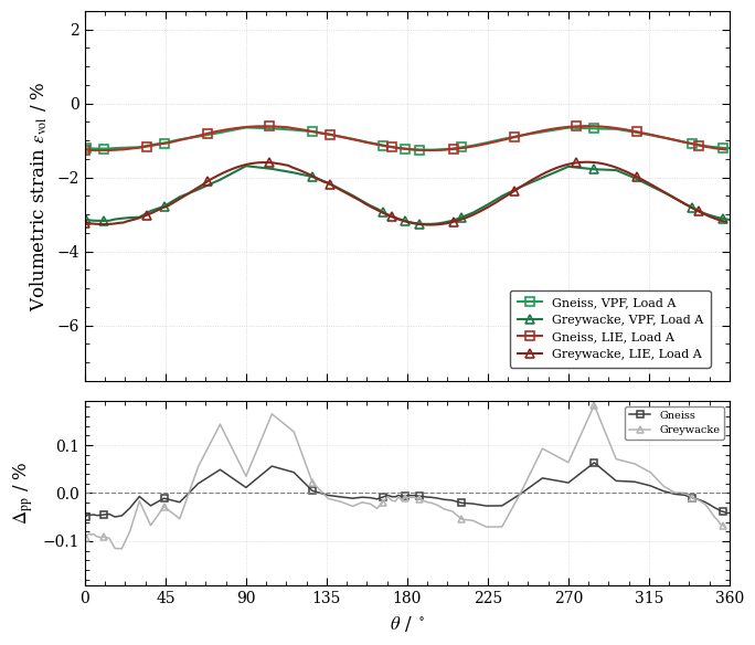

Table: Load Conditions
| Marker | PEE1 Angle to $\sigma_2$ | PEE1 & 1a | PEE2 & 2a | PEE3 & 3a | PEE4 & 4a | PEE5 & 5a | PEE6 & 6a | PEE7 & 7a | PEE8 & 8a |
| A | 0° | 10.0 | 6.64 | 4.46 | 1.17 | 1.0 | 3.82 | 7.80 | 9.95 |
| E | 22.5° | 9.95 | 10.0 | 6.64 | 4.46 | 1.17 | 1.0 | 3.82 | 7.80 |
| B | 45.0° | 7.80 | 9.95 | 10.0 | 6.64 | 4.46 | 1.17 | 1.0 | 3.82 |
| F | 67.5° | 3.82 | 7.80 | 9.95 | 10.0 | 6.64 | 4.46 | 1.17 | 1.0 |
| C | 90° | 1.0 | 3.82 | 7.80 | 9.95 | 10.0 | 6.64 | 4.46 | 1.17 |
Schematic loading conditions
loads = {…
(click to toggle)
loads = {
"A": [
10.0e6,
6.64e6,
4.46e6,
1.17e6,
1.0e6,
3.82e6,
7.80e6,
9.95e6,
10.0e6,
6.64e6,
4.46e6,
1.17e6,
1.0e6,
3.82e6,
7.80e6,
9.95e6,
"B": [
7.80e6,
9.95e6,
10.0e6,
6.64e6,
4.46e6,
1.17e6,
1.0e6,
3.82e6,
7.80e6,
9.95e6,
10.0e6,
6.64e6,
4.46e6,
1.17e6,
1.0e6,
3.82e6,
"C": [
1.0e6,
3.82e6,
7.80e6,
9.95e6,
10.0e6,
6.64e6,
4.46e6,
1.17e6,
1.0e6,
3.82e6,
7.80e6,
9.95e6,
10.0e6,
6.64e6,
4.46e6,
1.17e6,
angles_degrees = […
(click to toggle)
angles_degrees = [
0,
-22.5,
-45,
-67.5,
-90,
-112.5,
-135,
-157.5,
-180,
-202.5,
-225,
-247.5,
-270,
-292.5,
-315,
-337.5,
circle_radius = 6
ax = axs[idx]
ax.set_aspect("equal")
ax.axis("off")
circle = plt.Circle(
(0, 0),
circle_radius,
color="black",
fill=False,
linestyle="--",
linewidth=2,
ax.add_artist(circle)
zip(circle_x, circle_y, scaled_values, strict=True)
ax.annotate(
xytext=line_end,
xy=(x, y),
arrowprops={
"arrowstyle": "-|>",
"color": "blue",
"lw": 2,
"mutation_scale": 15,
"fill": True,
ax.text(
x - angle_offset[0],
y - angle_offset[1],
angle_label,
fontsize=12,
ha="center",
va="center",
color="m",
ax.text(
formatted_values[i],
fontsize=18,
ha="center",
weight="bold",
ax.plot(
top_points_x,
top_points_y,
color="green",
linestyle="-.",
lw=2,
marker="o",
markersize=6,
markerfacecolor="lightgreen",
markeredgewidth=1.0,
markeredgecolor="black",
ax.set_xlim([-12, 12])
ax.set_ylim([-12, 12])
ax.text(
0,
0,
f"Load {label}",
fontsize=32,
ha="center",
va="center",
family="serif",
plt.tight_layout()
Boundary Conditions

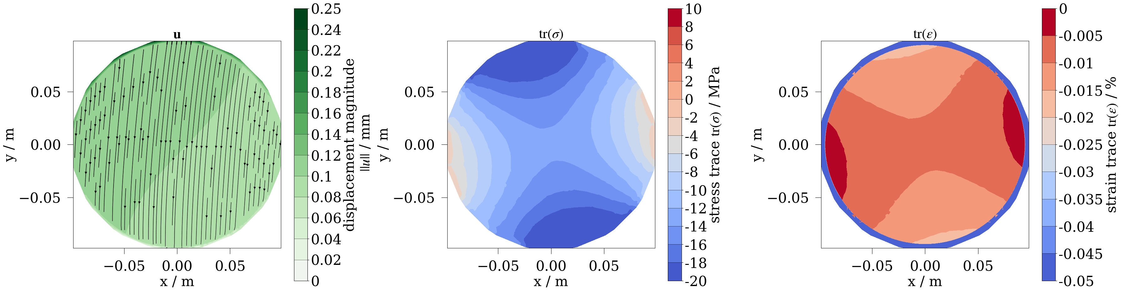

Intact Samples ($\texttt{M}_1$)
The primary objective of the first benchmark exercise is to evaluate the mechanical deformation of different rock samples in the GREAT cell under various boundary conditions in a 2D plane strain setup.
This benchmark considers a plane strain triaxial stress condition, where the in-plane principal stresses are defined as:
$$ \sigma_2 = 10\ \text{MPa},\quad \sigma_3 = 1\ \text{MPa} $$The out-of-plane stress component, $\sigma_1$, is governed by the plane strain constraint:
$$ \sigma_1 = \nu (\sigma_2 + \sigma_3) $$This loading condition is applied to both Greywacke and Gneiss samples

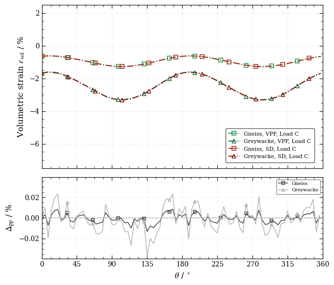

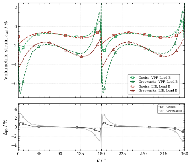

Post-processing
Volumetric strain vs angle at probe circle
json_path = Path("./external_data_dict.py").resolve()…
(click to toggle)
print(f"[DEBUG] Trying path: {json_path}")
if json_path.exists():
from external_data_dict import external_data
print("[WARNING] External data dict not found! Skipping...")
external_data = None
plotter = Plotter(
output_dir=out_dir,
save_extracted_data=True,
data_dir = Path("external_data")
external_data = Plotter.load_external_data(data_dir, benchmark_tag="M1")

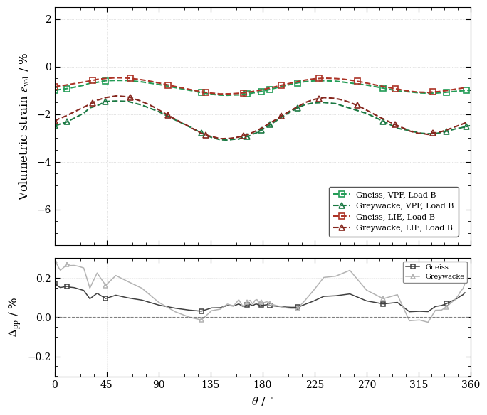

plotter.plot_volumetric_strain_vs_angle(
vtu_files_dict,
model_type="M1",
ylim_range=[-7.5, 2.5],
layout="subplots",
external_data=external_data["strain"],
)[DEBUG] Trying path: /var/lib/gitlab-runner/builds/sy3_rc3xP/0/ogs/ogs/Tests/Data/HMPhaseField/GreatCell/external_data_dict.py
Profiles
plotter.plot_field_variables(vtu_files_dict, show_phasefield=False, show_pressure=False)Load: A, File 0, Benchmark: M1, Material: Gneiss

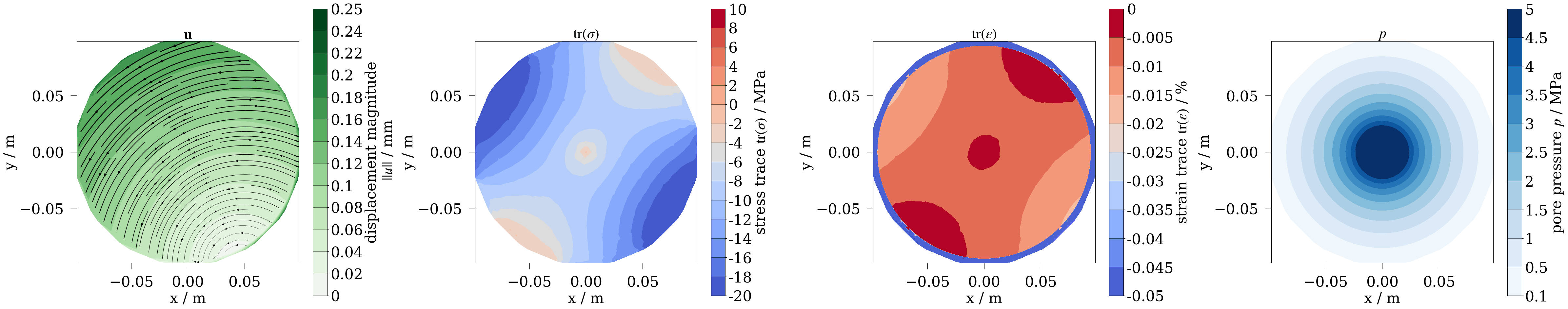

Intact rock sample with fluid injection ($\texttt{HM}_1$)
This benchmark, which does not consider any fracture, is designed to verify the basic computational setting for hydro-mechanical simulations. In addition to the mechanical loads, a zero constant pore pressure is prescribed at the outer boundary. At the center of sample, fluid is injected at a rate of $Q_0^{\text{v}} = 2.085 \times 10^{-9}$ m$^3$/s
The hydro-mechanical simulations follows a two-stage process: a 3000s equilibrium phase under mechanical loading to stabilize initial conditions, followed by a 500s fluid injection phase to model fluid flow. This loading condition is applied to both Greywacke and Gneiss samples

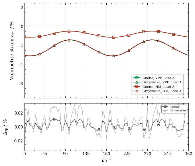

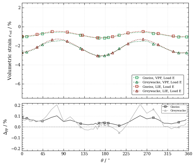

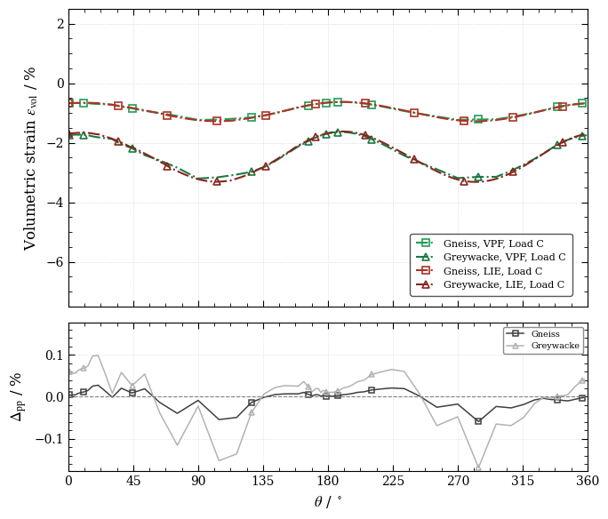

Post-processing
(click to toggle)
external_data = Plotter.load_external_data(data_dir, benchmark_tag="HM1")
plotter = Plotter(
output_dir=out_dir,
vtu_files_dict_HM,
model_type="HM1",
layout="subplots",
