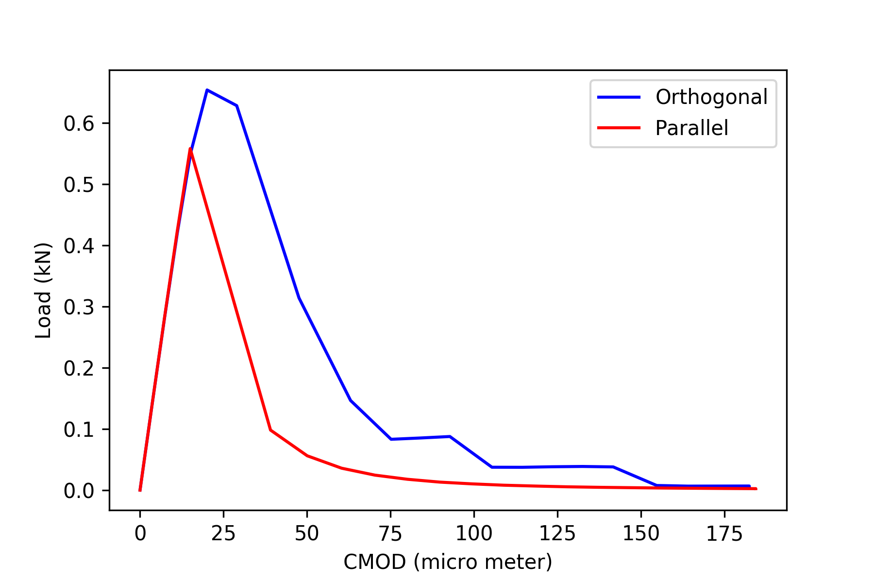

The responses of crack mouth opening displacement (CMOD) vs. force is as follows.
