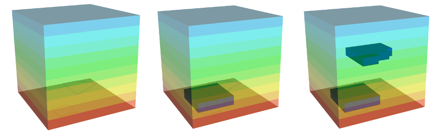

Second Example
Second example
The left figure shows the input mesh (transparent) with the original 10 layers symbolized by the different colours. At the bottom of the cube two regions are depicted by their bounding polygons. The intermediate mesh in the middle figure was generated by the following command:
ResetPropertiesInPolygonalRegion
    -m hex_5x5x5.vtu
    -g Regions.gml
    -p Region1
    -n MaterialIDs
    -i 11
    -r 2
    -o hex_5x5x5_Region1-Layer1.vtu
Here the elements with the material ID of 11 are displayed non-transparent.
The final mesh containing 12 material groups is represented in the right figure and was created by the command
    -m hex_5x5x5_Region1-Layer2.vtu
    -g Regions.gml
    -p Region2
    -n MaterialIDs
    -i 12
    -r 5
    -o hex_5x5x5_Region1-Layer2_Region2-Layer5.vtu
Again, the elements that are assigned to the new material group 12 are displayed non-transparent.
