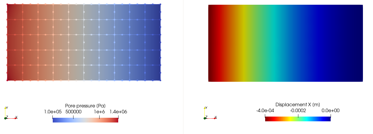

The problem is solved on a rectangular domain 2 m $\times$ 1 m. Nodal fluid flux is applied on the left boundary nodes with a value of 0.001 kg/s via the property of NodalSourceTerm. The pore pressure on the right boundary is equal to the initial pore pressure of $10^5$ Pa. The displacement in the normal direction of all boundaries except the left one is fixed.
| Property | Value | Unit |
| Fluid density | $10^3$ | kg/m$^3$ |
| Viscosity | $10^{-3}$ | Pa$\cdot$s |
| Permeability | $10^{-14}$ | m$^2$ |
| Young’s modulus (bulk) | $2.5\cdot 10^9$ | Pa |
| Poisson ratio (bulk) | $0.27$ | - |
| Biot coefficient | $0.9$ | - |
The time period of 86400 is discretised into 100 steps.
The distributions of pressure and displacement at the end time are shown in the
following figure:
