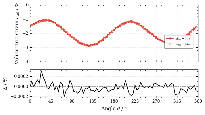

Compare the volume strains obtained with and without the B-bar method
The figure below shows that the B-bar method improves the strain result significantly.

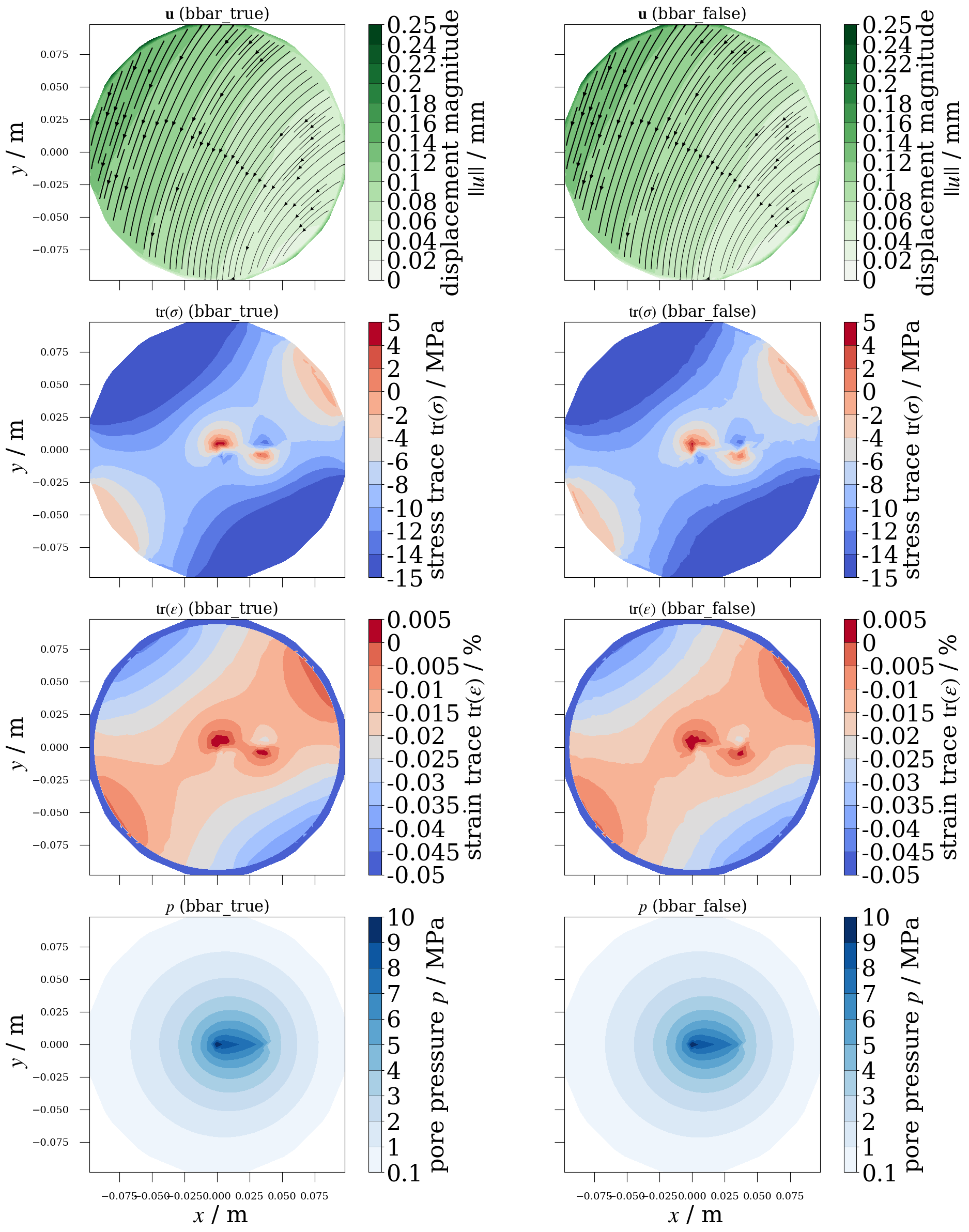

Results over the entire domain
def plot_mesh_compare(… (click to toggle)
    file_true: Path,
    file_false: Path,
    colorbar_opts: dict,
    save_file: Path | None = None,
    domain_limit: float = 0.098,
    mesh_true = ot.MeshSeries(file_true)[-1]
    mesh_false = ot.MeshSeries(file_false)[-1]
    has_p_true = "pressure" in mesh_true.point_data
    has_p_false = "pressure" in mesh_false.point_data
    include_pressure = has_p_true and has_p_false
    rows = [
            "$\\mathbf{u}$",
            ot.variables.displacement.replace(output_unit="mm"),
            "u",
        ("$\\mathrm{tr}(\\sigma)$", ot.variables.stress.trace, "stress"),
        ("$\\mathrm{tr}(\\varepsilon)$", ot.variables.strain.trace, "strain"),
    if include_pressure:
        rows.append(("$p$", ot.variables.pressure, "pressure"))
    nrows = len(rows)
    ncols = 2
    figsize = (10 * ncols, 6 * nrows)
    fig, axs = plt.subplots(
        nrows=nrows, ncols=ncols, figsize=figsize, sharex=True, sharey=True
    if nrows == 1:
        axs = np.array([axs])
    for i, (title, var, key) in enumerate(rows):
        ot.plot.contourf(mesh_true, var, fig, axs[i, 0], **colorbar_opts[key])
        axs[i, 0].set_title(f"{title} (bbar_true)", fontsize=22)
        ot.plot.contourf(mesh_false, var, fig, axs[i, 1], **colorbar_opts[key])
        axs[i, 1].set_title(f"{title} (bbar_false)", fontsize=22)
    for ax in axs.ravel():
        ax.set_aspect("equal")
        ax.tick_params(labelsize=14)
        ax.set_xlim(-domain_limit, domain_limit)
        ax.set_ylim(-domain_limit, domain_limit)
    if save_file:
        Path(save_file).parent.mkdir(parents=True, exist_ok=True)
        fig.savefig(save_file, dpi=300, bbox_inches="tight")
    plt.close(fig)
colorbar_opts = {
    "u": {"vmin": 0, "vmax": 0.25},
    "stress": {"vmin": -15, "vmax": 5},
    "strain": {"vmin": -0.05, "vmax": 0.005},
    "pressure": {"vmin": 0.1, "vmax": 10},
plot_mesh_compare(
    file_true=Path(out_dir, "hm_lie_bbar_true.pvd"),
    file_false=Path(out_dir, "hm_lie_bbar_false.pvd"),
    colorbar_opts=colorbar_opts,
    save_file=Path(out_dir, "compare_bbar.png"),
Check the the volumetric strain at the specified circle against reference results.
expected_eps_v_bbar_true = np.array([-0.01490984255021392 , -0.013987665076443945, -0.013291145162162097, -0.012657186344186994,… (click to toggle)
 -0.012077562490951627, -0.011593306527156625, -0.011176316797253946, -0.01092569848731069 ,
 -0.01091895899307576 , -0.010714526271895689, -0.01114387725791524 , -0.011504380671698598,
 -0.012092934118127245, -0.012863844099957972, -0.013891307884180757, -0.014824422439206673,
 -0.015842888407653168, -0.01698930615310603 , -0.01820004415291281 , -0.019311361785447873,
 -0.02037186498737685 , -0.021381900264295425, -0.02267022167453655 , -0.023700791466756962,
 -0.024651973931523918, -0.025834316049296095, -0.02665397856513444 , -0.02733189018996455 ,
 -0.02770781423765582 , -0.028345819993573197, -0.028607888986588764, -0.028921395881402683,
 -0.028527748160527878, -0.028321403010593223, -0.02785847219788058 , -0.02744136638137052 ,
 -0.026451557317533896, -0.025586383474529427, -0.024539938245160493, -0.023466049965989697,
 -0.022417380454526133, -0.02129466806681034 , -0.020118766322555316, -0.018890229381819928,
 -0.017632516373885486, -0.01646493848269331 , -0.015464670523898097, -0.014562092590426413,
 -0.013752144407338369, -0.013096148271584786, -0.012564590391080288, -0.012185082706746724,
 -0.01199447428001041 , -0.011893699392594523, -0.012263204688720017, -0.01261592084988576 ,
 -0.013186641784431212, -0.013856951863050332, -0.014948316001225192, -0.01588134762422188 ,
 -0.0168738751033352  , -0.017887279415493056, -0.01882953072448892 , -0.0197989418783354  ,
 -0.020800230539342886, -0.021787442243462178, -0.022928602250839102, -0.02382648570600328 ,
 -0.02473887039251807 , -0.02554854198958239 , -0.026241011041587634, -0.026767411360017812,
 -0.027160336582612497, -0.02742609130243981 , -0.027461460888973104, -0.027588143281204316,
 -0.02706688976921454 , -0.026720468413761987, -0.02598620743929075 , -0.02534338104812332 ,
 -0.023780857548122827, -0.022808214680706176, -0.021565074282019227, -0.02028192599371304 ,
 -0.019043182295690863, -0.017844613487726778, -0.01677439282883159 , -0.01579129577134375 ])  # fmt: skip
eps_v_bbar = sorted_angles_eps_trace("hm_lie_bbar_true.pvd")[1]
np.testing.assert_allclose(
    actual=eps_v_bbar, desired=expected_eps_v_bbar_true, atol=1e-10
