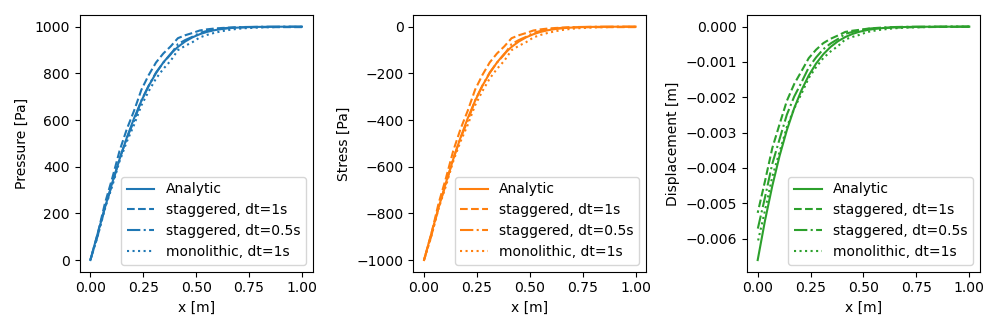

The mechanical load on the top boundary is 1000 Pa, i.e. $\sigma_0 = -1000$ Pa.
In the following figures, the solutions at $t=10$ s obtained by using the staggered scheme
with fixed stress rate over time step, the monolithic scheme, and analytic
approach are compared.
