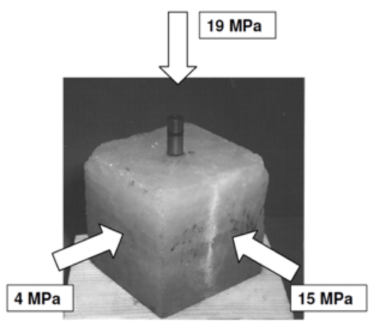

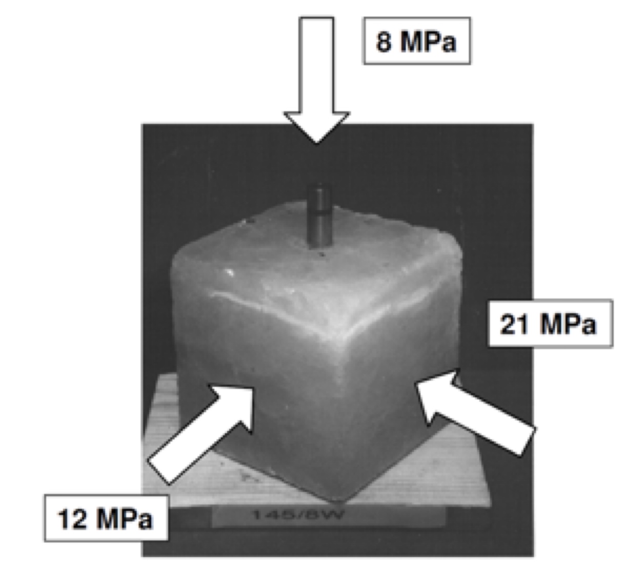

We simulate two different fluid percolation experiments performed on rock salt samples with a true tri-axial loading system as described in this PDF. The experiments were performed under two different stress configurations as below.

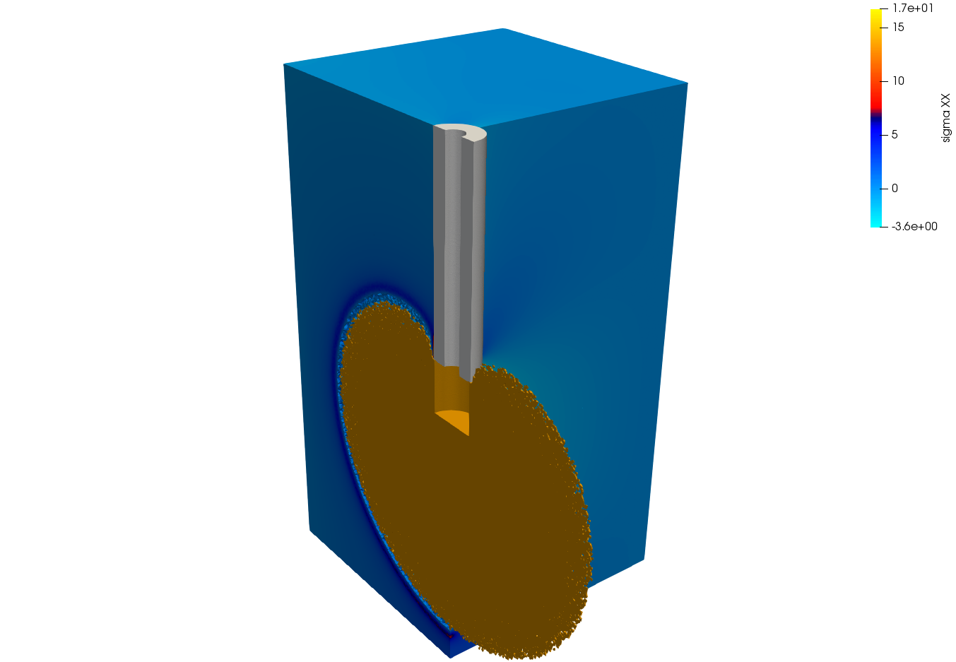

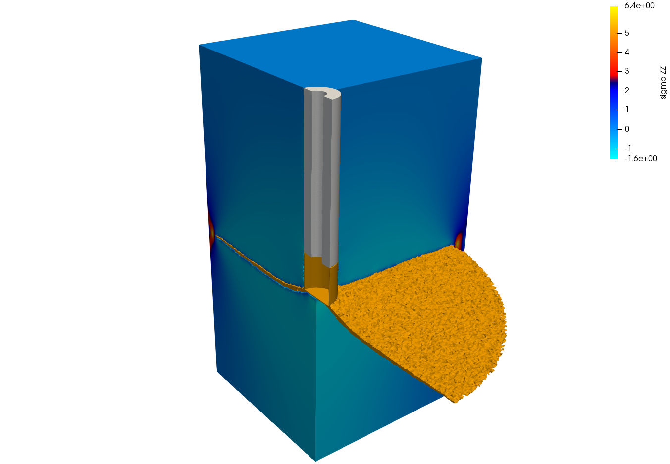

Simulated crack paths (phase-field) for the two cases are shown below:
