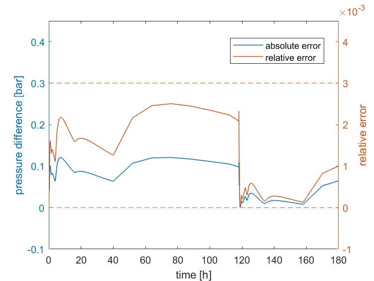

The pressure evolution is simulated throughout the domain and the result is compared with the analytical solution at $r=10.287\ \mathrm{m}$. In Figure 2, it can be observed that the numerical model fits with the analytical solution very well. The absolute and relative error between the analytical and numerical solution is depicted in Figure 3.
Figure 2: OGS 6 result compared with analytical solution
Figure 3: Absolute and relative error
