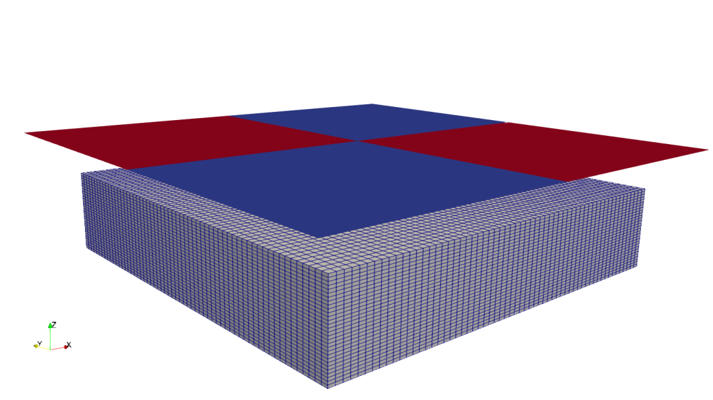

In the figure, the 2x2 raster contains 4 raster cells or 4 (possible different) values. In the example illustration, each raster grid cell covers 225 surface elements. If we were to store this information directly in the surface mesh, we would need about 225 times more memory. Study domain with raster data at the top

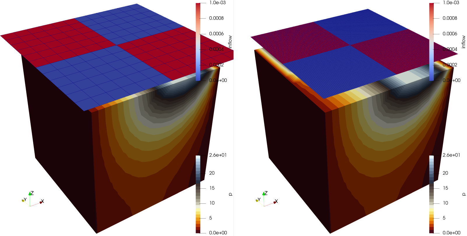

The domain $\Omega = [0,1]^3$ is a cube. Dirichlet-type boundary conditions are set on the left ($x=0$) side and the right ($x=1$) side of the cube. On the top a Neumann-type boundary condition is set by a raster parameter. Here, simulations of two almost identical models are conducted. The only difference is the raster used for setting the boundary condition. The first simulation is done with a coarse raster as input for the boundary condition, the second one is executed with a fine raster as input.

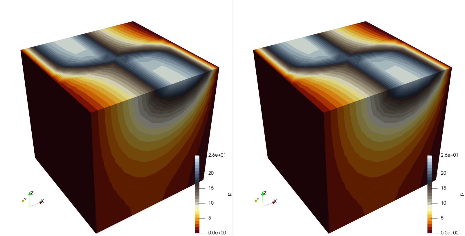

Cube with raster data at the top; left: coarse raster; right: fine raster The pressure distribution within the domain is depicted in the following figure (again left: coarse raster input; right: fine raster input). The distributions are identical up to machine precision. Cube with pressure distribution; left: coarse raster input; right: fine raster
input
