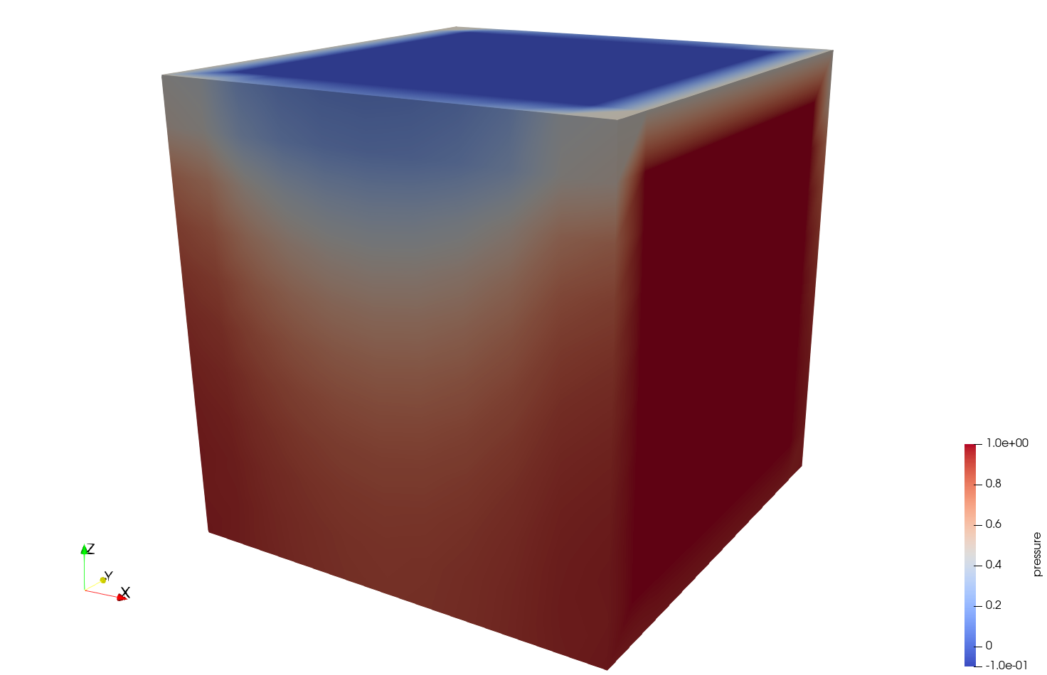

The benchmark at hand should demonstrate the primary variable constraint Dirichlet-type boundary condition. Here, the size of the sub-domain, the Dirichlet-type boundary condition is defined on, is variable and changes according to a condition depending on the value of the primary variable.
$$ \Gamma^\ast_D = \{ x \in \mathbb{R}^d, x \in \Gamma_D, \text{Condition}(p(x)) \} $$
Examples
On the left (x=0) and right side (x=1) of the domain $\Omega = [0,1]^3$ the usual Dirichlet-type boundary conditions are set, i.e.,
$$ p = 1, \quad x=0 \qquad \text{and} \qquad p = 1\quad x=1 $$
The initial condition $p_0$ is set to zero. Additionally, a primary variable constraint Dirichlet-type boundary condition (PVCDBC) is specified:
$$ p = -0.1, \quad \text{for}\quad z = 1 \quad \text{and}\quad p(x,y,1) > 0. $$
At the beginning of the simulation the PVCDBC is inactive. Because of the ’normal’ Dirichlet-type boundary conditions the pressure is greater than zero after the first time step and the PVCDBC is activated in the second time step. The effect is depicted in the figure:
