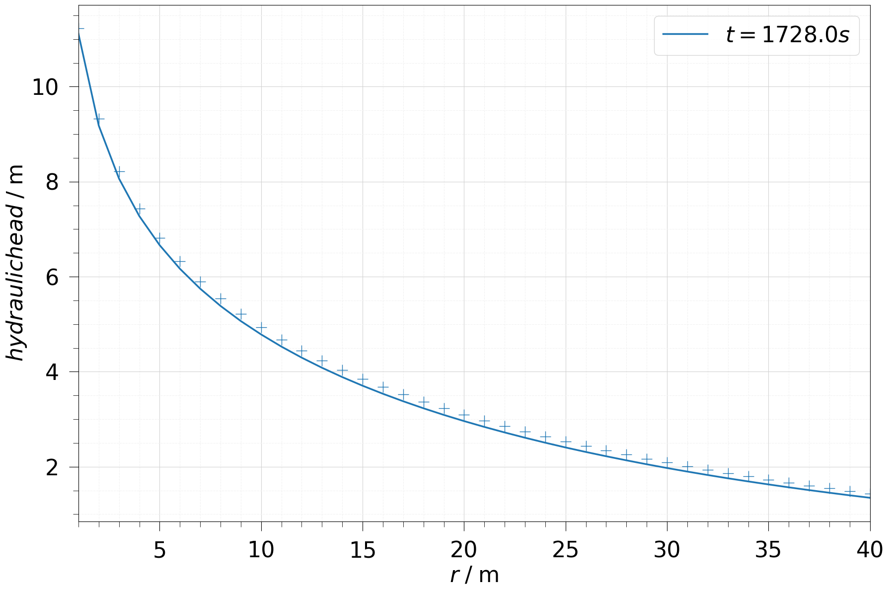

Here, we parameterise the problem to evaluate the Theis analytical solution against simulation results of OGS.
We set the pumping rate to $Q=0.016\,\mathrm{m^{3}/s}$ and consider the solution at time $t=1728.0\,\mathrm{s}$.
For the aquifer properties, we use a storativity of $S=1 \times 10^{-3}$ and a transmissivity of $T=1000\, \mathrm{m^{2}/day}$.
We show the drawdown over radial distances ranging from $r=1\,\mathrm{m}$ to $40\,\mathrm{m}$.

# Plot results(click to toggle)
# Plot results
labels = [f"$t={np.round(x, 2)}s$" for x in ms_probe[1:].timevalues]
fig, ax = plt.subplots(figsize=(18, 12))
ot.plot.line(ms_probe[1:], "x", pressure, labels=labels, ax=ax)
ax.plot(r, s_all, "+", markersize=16)
ax.set(
    xlim=(1, 40),
    xlabel=r"$r\;/\; \mathrm{m}$",
    ylabel=r"$hydraulic head \; /\; \mathrm{m}$",
# Validate results at time = 1728 s(click to toggle)
time = 1728.0
timestep = ms_probe.closest_timestep(time)
analytical_solution = s_all[:, timestep - 1]
assert time == time_vals[timestep - 1]
abs_error = np.abs(analytical_solution - ms_probe.point_data[pressure][timestep])
rel_error = np.abs(abs_error / analytical_solution)
np.testing.assert_array_less(abs_error, 0.2)
np.testing.assert_array_less(rel_error, 0.07)
Solutions at later time steps computed by OGS6 deviate from the analytical solution because of two reasons:
  • the time discretisation of the numerical model is chosen too coarse
  • the solution of Theis assumes an aquifer of infinite radial extent wich for larger times deviates more visibly from the solution for a finite radial extent
