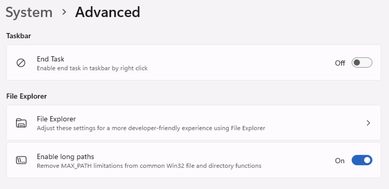

Open the Windows Settings app and navigate to System / Advanced. Enable the long paths option:
Enable long paths

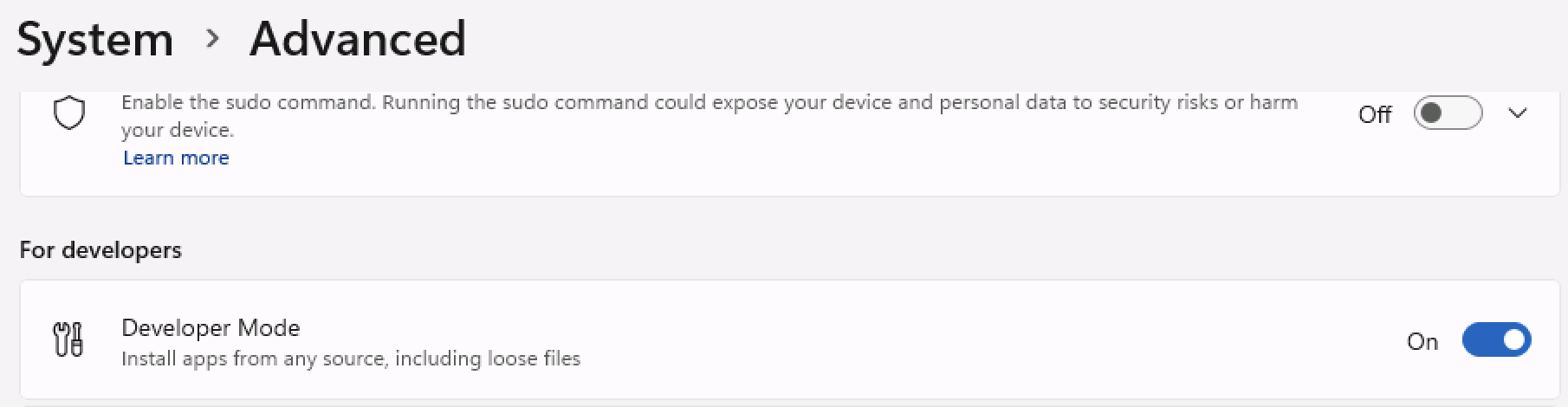

And also enable the Developer Mode:
Enable developer mode
These two features enable the file system (and also the ogs-executable) to handle long file names / paths and allow for symbolic link creation and PowerShell script execution.

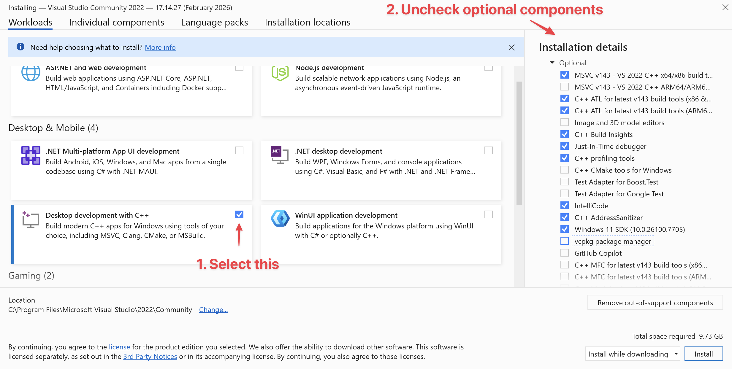

As we use lots of features of the C++23-standard we support Visual Studio 2022 with compiler version 19.24 and up. It is perfectly fine to use the free Community Edition of Visual Studio.
  • Download and install Visual Studio Community 2022.
    • Select the workload Desktop Development with C++.
    • See the following image for components which can be unchecked.
  • When installation finished please start Visual Studio once (when asked for credentials enter your Microsoft account or click on Skip for now).
Visual Studio Components

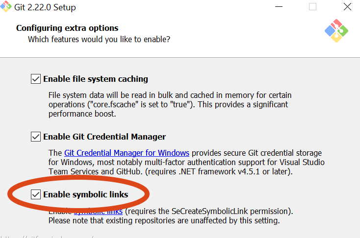

Download and install git from the git homepage. Use the default installer options but also enable Enable symbolic links under the Configuring extra options page.
Enable symbolic links option
This install a new command line called Git Bash which should be used for all git operations.
