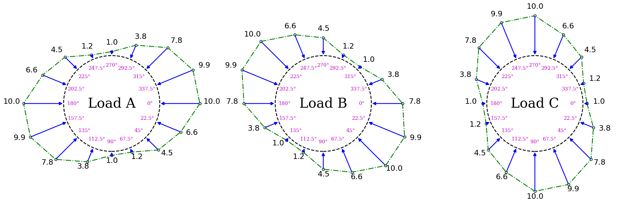

Loads
Table: Load Conditions
A 0° 10.0 6.64 4.46 1.17 1.0 3.82 7.80 9.95
B 45.0° 7.80 9.95 10.0 6.64 4.46 1.17 1.0 3.82
C 90° 1.0 3.82 7.80 9.95 10.0 6.64 4.46 1.17
Schematic loading conditions

Boundary Conditions
  • Dirichlet conditions (displacement control):
    \[ \begin{cases} u_y(x, 0) = 0, & \quad \text{for } x = \pm 0.09894~\text{m} \quad (\text{left and right points boundaries}), \\ u_x(0, y) = 0, & \quad \text{for } y = \pm 0.09894~\text{m} \quad (\text{top and bottom points boundaries}), \\ u_x = u_y = 0, & \quad \text{on } x^2 + y^2 = r_{\text{borehole}}^2 \end{cases} \]
  • Neumann conditions: Normal stress $\sigma_{rr}$ is applied on PEEs and DSSs. The DSS stress is calculated as:
    $$\sigma_\text{DSS}^i = \frac{\sigma_\text{PEE}^i + \sigma_\text{PEE}^{i+1}}{2}$$

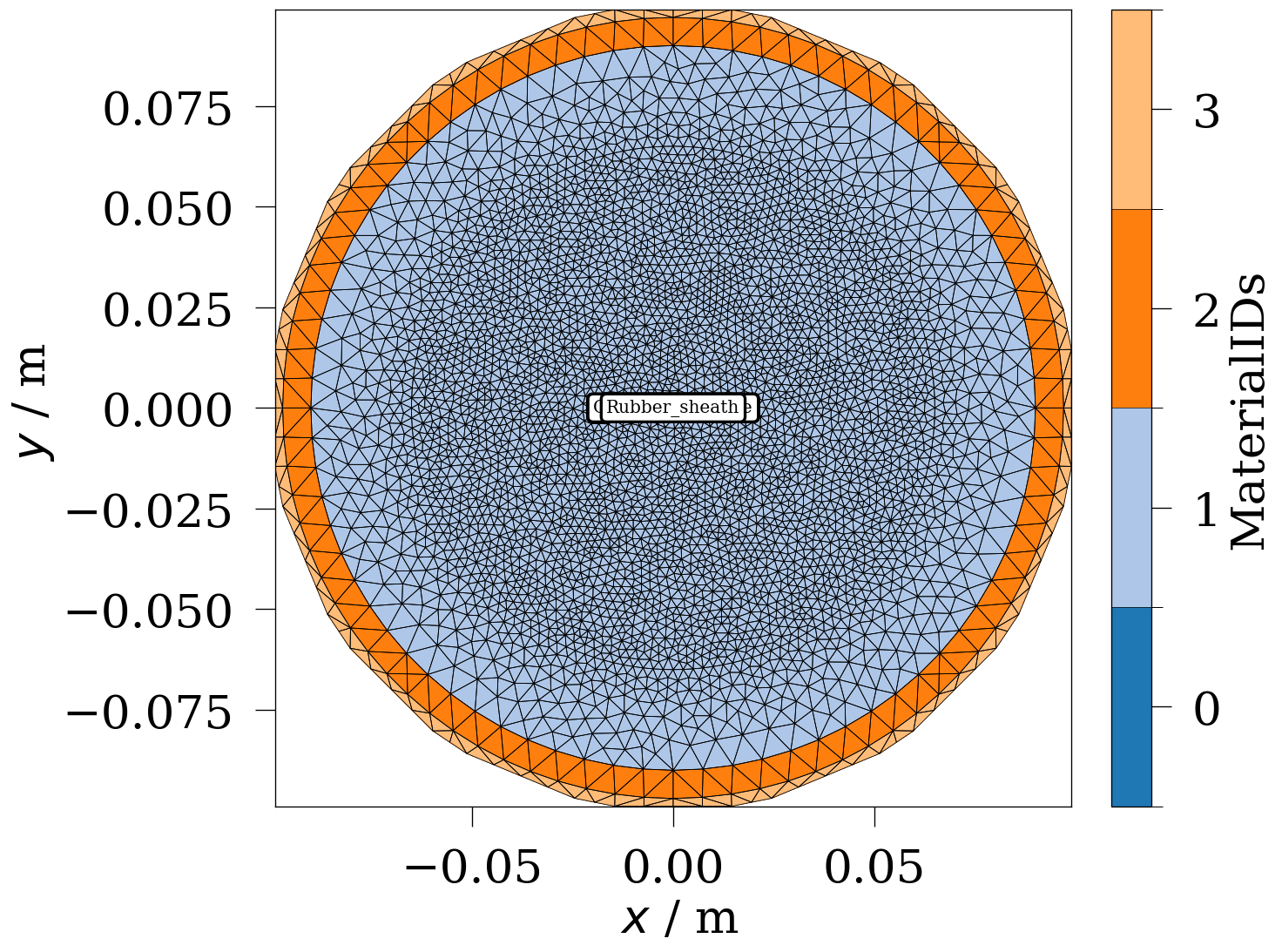

Mesh generation of intact samples
Input
h = 0.0025… (click to toggle)
h = 0.0025
borehole_radius = 0.0025
delta = 0.00025
meshname = "GreatCell"
mesh_path = Path(out_dir, "mesh_borehole").resolve()
print(mesh_path)
/var/lib/gitlab-runner/builds/F1XUyv4cx/0/ogs/build/release-petsc/Tests/Data/HMPhaseField/GreatCell/GreatCellHM_VPF_propagating/mesh_borehole
Boundary meshes
Gmsh
msh_file = mesh_GreatCell_Borehole_VPF(… (click to toggle)
    lc=0.0075,
    h=h,
    lc1=h,
    r0=0.097,
    r1=0.090,
    r2=0.065,
    borehole_radius=borehole_radius,
    delta=delta,
    out_dir=mesh_path,
    meshname=meshname,
    mode="BC",
ot.Meshes.from_gmsh(msh_file, dim=[0, 1], reindex=True, log=False).save(
    mesh_path, overwrite=True

Computational domain mesh
Gmsh
    lc=0.0075,
    h=h,
    lc1=h,
    r0=0.097,
    r1=0.090,
    r2=0.065,
    delta=delta,
    out_dir=mesh_path,
    meshname=meshname,
    mode="domain",
meshes_borehole = ot.Meshes.from_gmsh(msh_file, dim=[1, 2], reindex=True, log=False)
meshes_borehole.save(mesh_path, overwrite=True)
