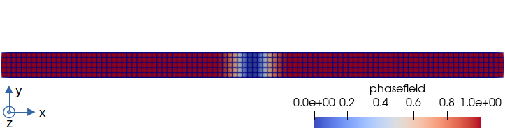

The final timestep of the AT1 iso tensile case is shown exemplary for the phasefield after fracture.
Phasefield after fracture

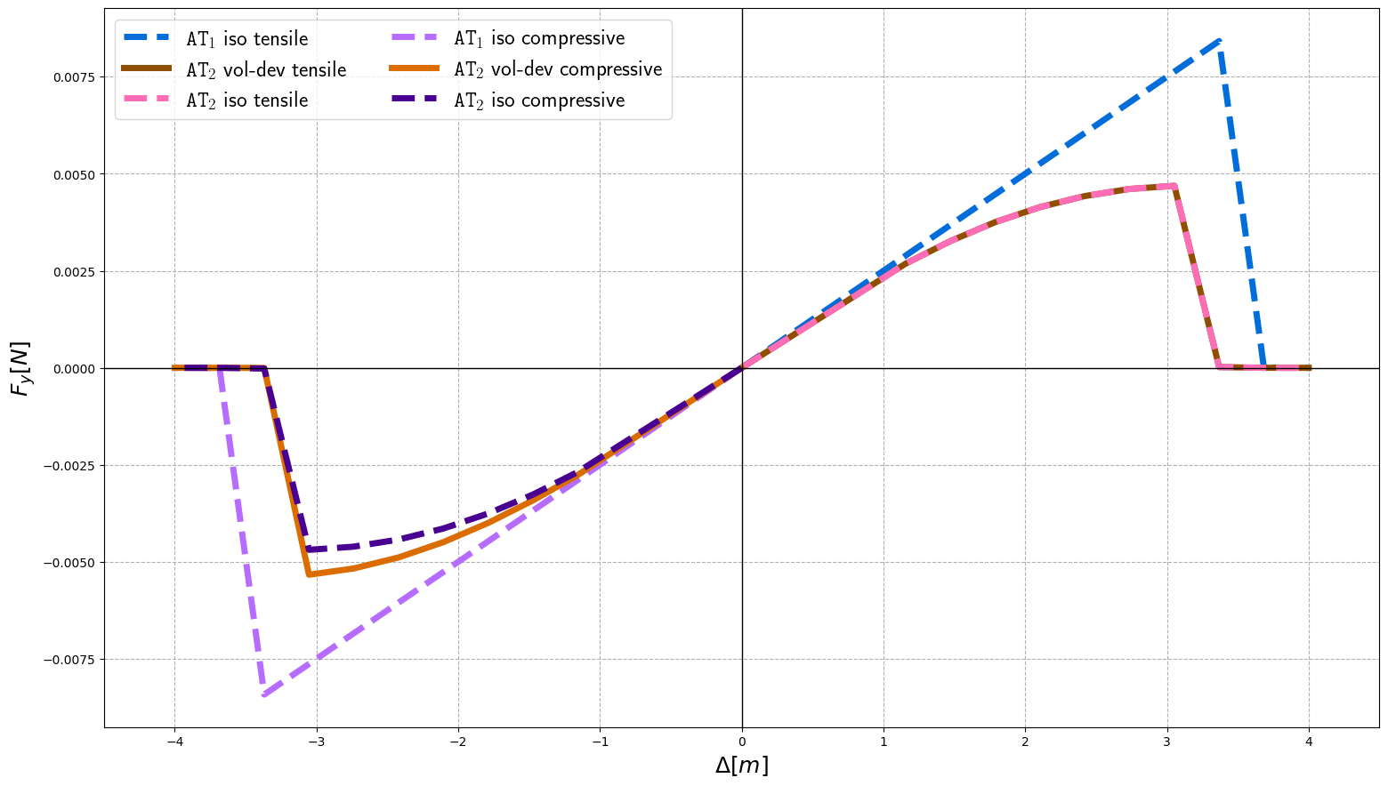

The force applied to the beam is compared to the change in length of the beam.

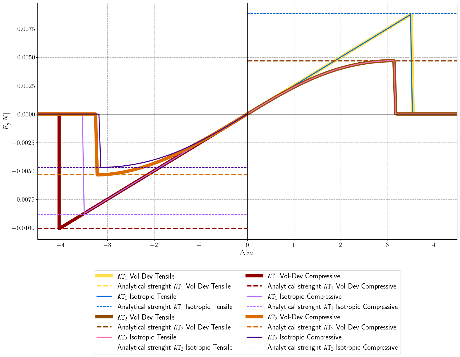

Running all the cases with finer timesteps yields the following figure. The failure of the beam in the simulation is observed, when the loading reaches the analytical strength for the corresponding case.
