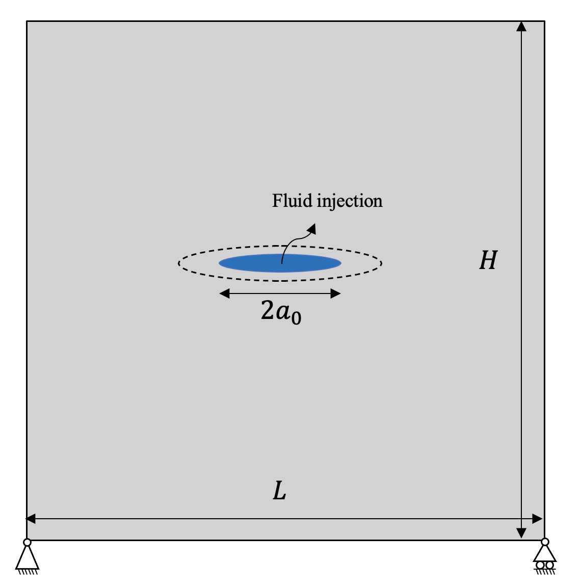

Based on Sneddon's solution (Sneddon et al., 1969), we verified the model with plane-strain hydraulic fracture propagation in a toughness-dominated regime. In an infinite 2D domain, the problem was solved with a line fracture $[-a_0, a_0] \times \{0\}$ ($a_0$ = 0.05). We considered a large finite domain $[-40a_0,40a_0] \times [-40a_0,40a_0]$ to account for the infinite boundaries in the closed-form solution. The effective size of an element, $h$, is $1\times10^{-2}$.
Schematic view of hydraulic fracturing problem and Boundary conditions
Schematic view of hydraulic fracturing problem and Boundary conditions.
  • In order to have the hydraulic fracturing in the toughness dominated-regime, add, $\texttt{propagating}$ in the project file.
  • Yoshioka et al., 2019 provides additional information on the implementation, use of real material properties, and rescaling of the phase-field energy functional.

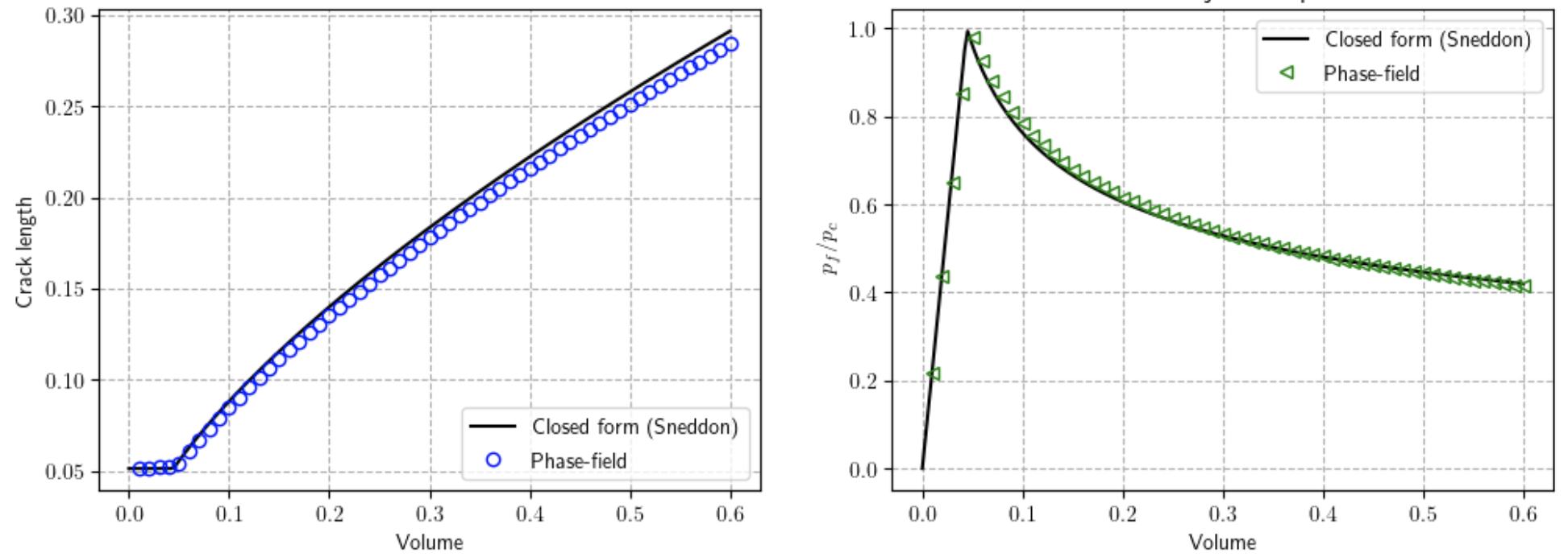

Phase Field Versus Analytical Solution for Fracture Length and Pressure Evolution
In phase field approach, we can retrieve the crack length $a$ as:
$$ \begin{equation} a = \dfrac{\displaystyle \int_\Omega \frac{G_c}{4 c_n} \left(\frac{(1-v)^n}{\ell}+ \ell |\nabla v|^2\right)\,\mathrm{d} \Omega }{G_c \left( \dfrac{h}{4 c_n \ell} + 1 \right)}. \end{equation} $$
where $n=1$ corresponds to $\texttt{AT}_1$ ($c_n = 2/3$) and $n=2$ to $\texttt{AT}_2$ ($c_n = 1/2$).

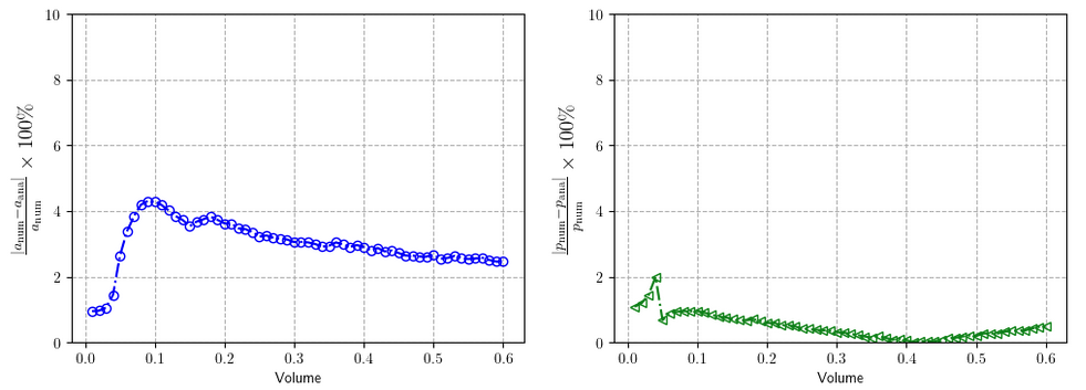

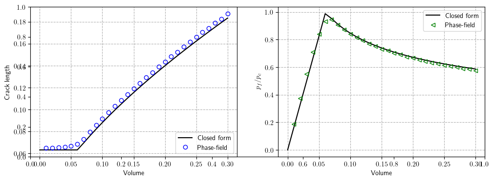

In order to reduce computation time, we perform the simulation with a coarse mesh; the results for the $\texttt{AT}_1$ Model with a mesh size of $h=0.001$ are provided below.
$\texttt{AT}_1$ Model:
Phase field versus analytical solution for fracture length and pressure evolution
Phase field versus analytical solution for fracture length and pressure evolution, $\texttt{AT}_1$.

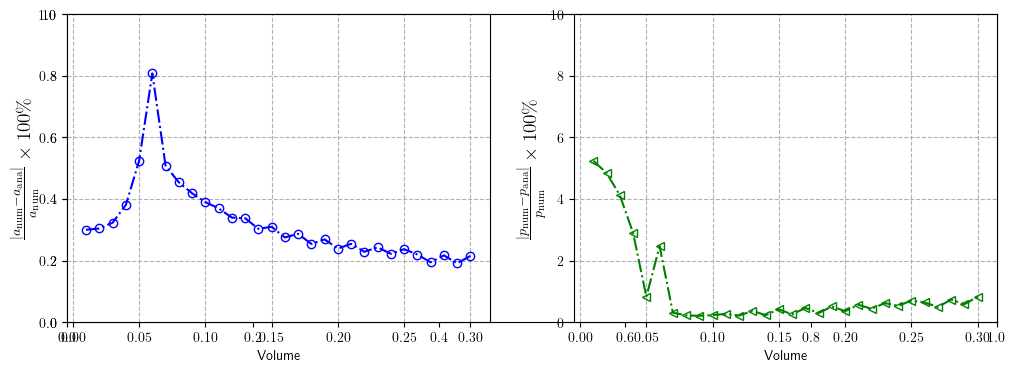

Error between the Phase field and analytical solution for fracture length and pressure evolution.
Error between the Phase field and analytical solution for fracture length and pressure evolution, $\texttt{AT}_1$.
