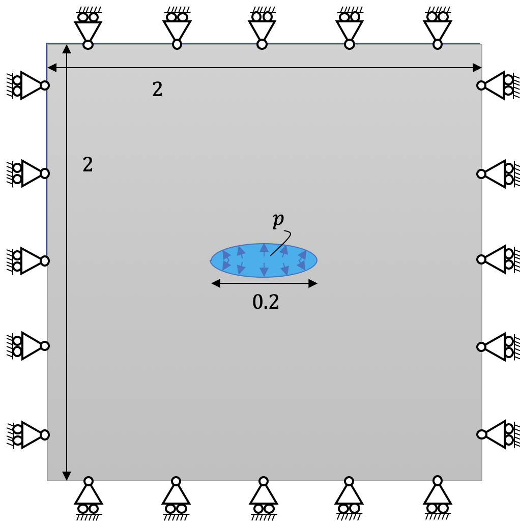

Static fracture opening under a constant pressure
Consider a line fracture $[-a_0, a_0] \times \{0\}$ ($a_0$ = 0.1) with no external loading and an internal fluid pressure of $p=1$ was applied to the fracture surfaces. The results are compared to the analytical solution (Sneddon et al., 1969) for the fracture half-opening: \begin{eqnarray} u(x,0) = \frac{2 p a_0}{ E’} \sqrt{1-(x/a_0)^2} , \label{eq:sneddon_2D_static} \end{eqnarray}
where $u$ is the displacement $E'$ is the plane strain Young’s modulus ($E' = E/(1-\nu^2)$) with $\nu$ is Poisson`s ratio, $p$ is the fluid pressure inside the fracture. To account for the infinite boundaries in the closed-form solution, we considered a large finite domain $ [-10a_o,10a_o] \times [-10a_o,10a_o]$. The effective element size, $h$, is $1\times10^{-2}$.
Schematic view of Sneddon problem and Boundary conditions
Schematic view of Sneddon problem and Boundary conditions.

The material and geometrical properties are listed in the Table below. It’s worth noting that the properties are dimensionless and scaled.
Name Value Symbol
Young’s modulus 1 $E$
Poisson’s ratio 0.15 $\nu$
Fracture toughness 1 $G_{c}$
Pressure 1 $p$
Length 2 $L$
Height 2 $H$
Initial crack length 0.2 $2a_0$

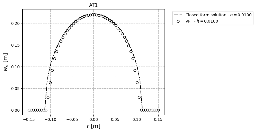

Opening profile
color = ["-.k", "ko", "-.r", "ro", "-.b", "bo", "-.g", "go"]… (click to toggle)
Label = ["Closed form solution", "VPF-FEM"]
lineWIDTH = [1.5, 1.5, 1.5]
for j, h_j in enumerate(h_list):
    r_i_num = []
    width_line_num = []
    filename = f"results_h_{h_j:0.4f}"
    print(filename)
    width_calculation(filename)
    r_i_num = width_calculation(filename)[0]
    width_line_num = width_calculation(filename)[1]
    ls = 2 * h_j
    x_Sneddon = sneddon(h_j, ls, phasefield_model)[0]
    uy_Sneddon = sneddon(h_j, ls, phasefield_model)[1]
    a_eff_Sneddon = sneddon(h_j, ls, phasefield_model)[2]
    plt.plot(
        np.array(x_Sneddon[:]),
        np.array(uy_Sneddon[:]),
        color[2 * j],
        fillstyle="none",
        markersize=0,
        linewidth=lineWIDTH[0],
        label=f"Closed form solution - $h= ${h_j:0.4f}",
    plt.plot(
        np.array(r_i_num[:]),
        np.array(width_line_num[:]),
        color[2 * j + 1],
        fillstyle="none",
        markersize=6,
        linewidth=lineWIDTH[1],
        label=f"VPF - $h =${h_j:0.4f}",
plt.rcParams["figure.figsize"] = [40, 20]
plt.rcParams["figure.dpi"] = 1600
plt.ylabel("$w_n$ [m]", fontsize=14)
plt.xlabel("$r$ [m]", fontsize=14)
plt.grid(linestyle="dashed")
plt.title(f"{phasefield_model}")
legend = plt.legend(bbox_to_anchor=(1.04, 1), loc="upper left")
results_h_0.0100

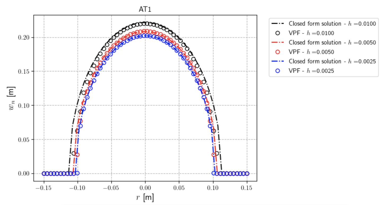

To decrease computing time, we perform the simulation with an one coarse mesh; Mesh sensitivity can be investigated in order to assess the convergence of the opening profile for various mesh discretizations. Following are the mesh sensivity results for for Models $\texttt{AT}_1$ and $\texttt{AT}_2$ ($h=0.01,~0.005,~\text{and} ~0.0025$ m.)
Crack opening profiles of  VPF ($\texttt{AT}_1$) with different mesh sizes compared against the Sneddon solution.
Crack opening profiles of  VPF ($\texttt{AT}_2$) with different mesh sizes compared against the Sneddon solution.
Our mesh size sensitivity study shows even with coarse mesh. The results away from crack tips agree well with the Sneddon solution. Using finer mesh demonstrates that the opening along the whole crack length is accurate compared with the closed-form solution.
