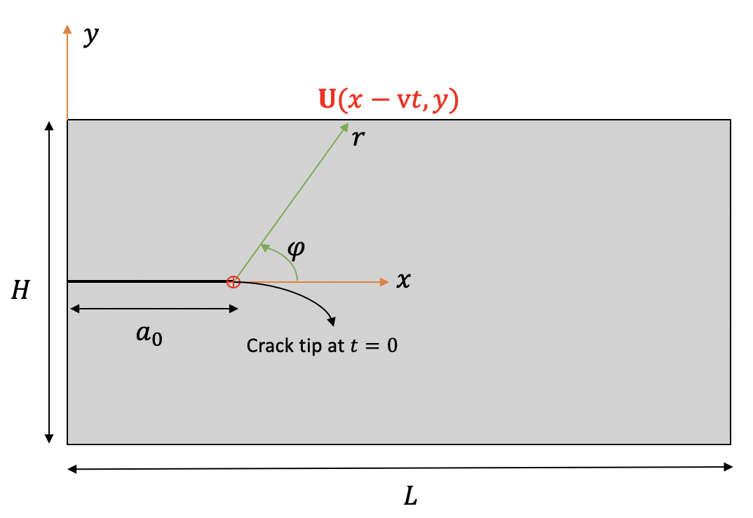

Consider a plate, $\Omega=[0,2]\times [-0.5,0.5]$, with an explicit edge crack, $\Gamma=[0,0.5]\times \{0\}$; that is subjected to a time dependent crack opening displacement:
\begin{eqnarray} \label{eq:surfing_bc} \mathbf{u}(x,y,t)= \mathbf{U}(x-\text{v}t,y) \quad \text{on} \quad \partial\Omega_D, \end{eqnarray} where $\text{v}$ is an imposed loading velocity; and $\mathbf{U}$ is the asymptotic solution for the Mode-I crack opening displacement \begin{eqnarray} \label{eq:asymptotic} U_x= \dfrac{K_I}{2\mu} \sqrt{\dfrac{r}{2\pi}} (\kappa-\cos \varphi) \cos \frac{\varphi}{2}, \nonumber \ U_y= \dfrac{K_I}{2\mu} \sqrt{\dfrac{r}{2\pi}} (\kappa-\cos \varphi) \sin \frac{\varphi}{2}, \end{eqnarray}
where $K_I$ is the stress intensity factor, $\kappa=(3-\nu)/(1+\nu)$ and $\mu=E / 2 (1 + \nu) $; $(r,\varphi)$ are the polar coordinate system, where the origin is crack tip. Also, we used $G_\mathrm{c}=K_{Ic}^2(1-\nu^2)/E$ as the fracture surface energy under plane strain condition. Table 1 lists the material properties and geometry of the numerical model.
Schematic view of surfing boundary condition benchmark
Schematic view of surfing boundary condition benchmark.

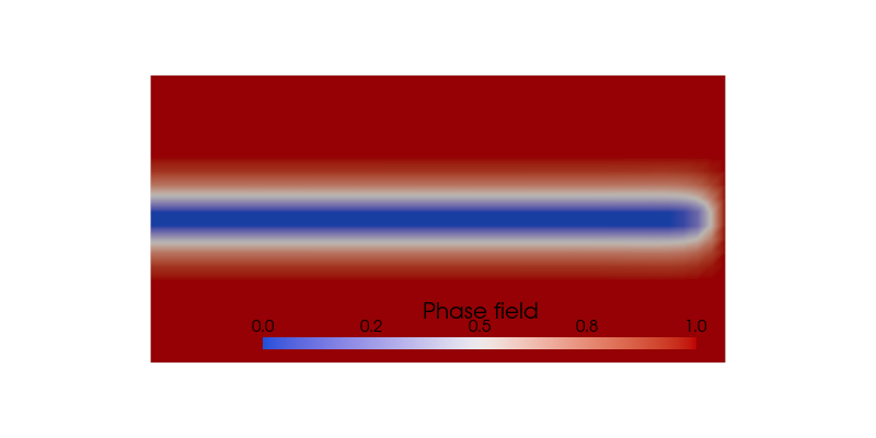

Pre-processing

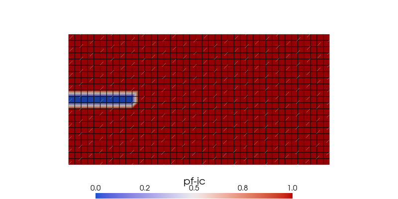

At fracture, we set the initial phase field to zero.
pv.set_plot_theme("document")
mesh = pv.read(f"{out_dir}/surfing_quad_1x2_NR.vtu")
    if (
        x[0] < x_tip_Initial + h / 10
        and x[1] < Height / 2 + h
        and x[1] > Height / 2 - h
        phase_field[node_id] = 0.0
mesh.point_data["pf-ic"] = phase_field
mesh.save(f"{out_dir}/surfing_quad_1x2_NR_pf_ic.vtu")
pf_ic = mesh.point_data["pf-ic"]
sargs = {
    "title": "pf-ic",
    "title_font_size": 20,
    "label_font_size": 15,
    "n_labels": 5,
    "position_x": 0.24,
    "position_y": 0.0,
    "fmt": "%.1f",
    "width": 0.5,
clim = [0, 1.0]
p.add_mesh(
    mesh,
    scalars=pf_ic,
    show_edges=True,
    show_scalar_bar=True,
    colormap="coolwarm",
    clim=clim,
    scalar_bar_args=sargs,
p.view_xy()
p.camera.zoom(1.5)
p.window_size = [800, 400]
p.show()

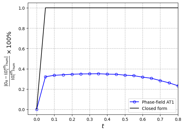

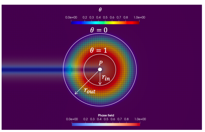

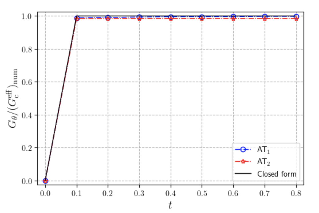

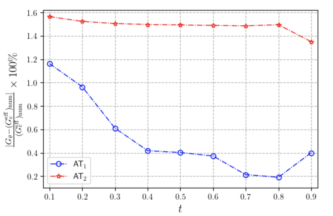

We computed the energy release rate using $G_{\theta}$ method (Destuynder et al., 1983; Li et al., 2016) and plot the errors against the theoretical numerical toughness i.e. $(G_c^{\text{eff}})_{\texttt{num}}=G_c(1+\frac{h}{2\ell})$ for $\texttt{AT}_2$, and $(G_c^{\text{eff}})_{\texttt{num}}=G_c(1+\frac{3h}{8\ell})$ for $\texttt{AT}_1$ (Bourdin et al., 2008).
Alt text
Phase field and $\theta$ profile for the volumetric deviatoric $\texttt{AT}_2$ models. We use virtual perturbation of $\theta$ to compute energy release rate using $G_{\theta}$ Dubois et al., 1998. The $\theta$ value is 1 inside of $B_{r_{in}}(P)$, 0 outside, and a linear interpolation in between. We set $r_{in}=4\ell$ and $r_{out}=2.5r_{in}$ (see Li et al., 2016).
Alt text
R_inn = 4 * ls… (click to toggle)
R_inn = 4 * ls
R_out = 2.5 * R_inn
if phasefield_model == "AT1":
    G_eff = G_i * (1 + 3 * h / (8 * ls))
    G_eff = G_i * (1 + h / (2 * ls))

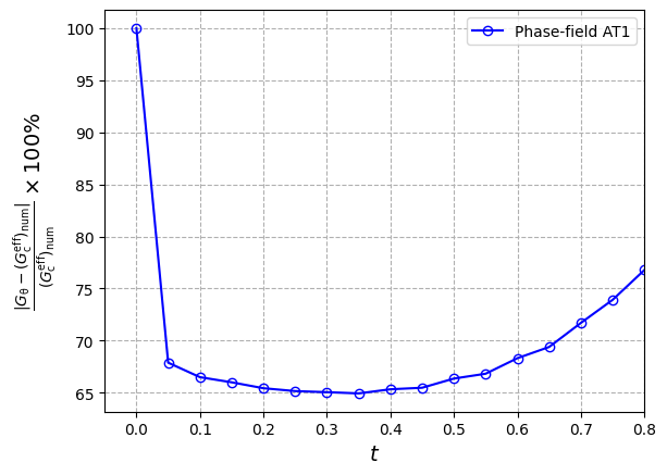

We run the simulation with a coarse mesh here to reduce computing time; however, a finer mesh would give a more accurate results. The energy release rate and its error for Models $\texttt{AT}_1$ and $\texttt{AT}_2$ with a mesh size of $h=0.005$ are shown below.
Alt text Alt text

Plots
plt.xlabel("$t$", fontsize=14)… (click to toggle)
plt.ylabel(
    r"$\frac{|{G}_\mathrm{\theta}-({G}_\mathrm{c}^{\mathrm{eff}})_\mathrm{num}|}{({G}_\mathrm{c}^{\mathrm{eff}})_\mathrm{num}}\times 100\%$",
    fontsize=14,
plt.plot(
    G_theta_time[:, 0],
    abs(G_theta_time[:, 1]) / G_eff,
    "-ob",
    fillstyle="none",
    linewidth=1.5,
    label=f"Phase-field {phasefield_model}",
plt.plot(
    G_theta_time[:, 0],
    np.append(0, np.ones(len(G_theta_time[:, 0]) - 1)),
    "-k",
    fillstyle="none",
    linewidth=1.5,
    label="Closed form",
plt.grid(linestyle="dashed")
plt.xlim(-0.05, 0.8)
plt.ylabel(
    fontsize=14,
plt.plot(
    G_theta_time[:, 0],
    abs(G_theta_time[:, 1] - G_eff) / G_eff * 100,
    "-ob",
    fillstyle="none",
    linewidth=1.5,
# plt.ylim(0,4)
Hint: Accurate results can be obtained by using the mesh size below 0.02.
Phase field profile
Fracture propagation animation

Phase field profile at last time step
mesh = reader.read()[0]… (click to toggle)
p.add_mesh(
    mesh,
    scalars=pf,
    show_edges=False,
    clim=clim,
p.view_xy()
p.camera.zoom(1.5)
p.show()
