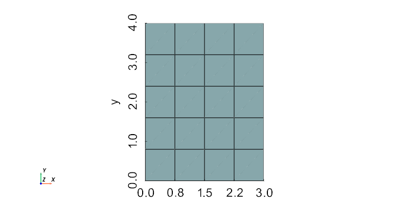

Quadrilateral mesh
In this step a simple rectangular mesh of size 3 by 4 units, with 4 and 5 cells respectively will be created and written to a quad.vtu file in folder output.
Please follow the folder and file names provided in each step, as some files will be reused later.
In order to select the type of the elements, that the mesh is built with you use the flag -e followed by one of the available mesh element types.
In this section a mesh of quadrilateral elements is created, so the command will be as follows:
generateStructuredMesh -e quad
this however, is not a complete command.
There are more required parameters, next the name of the output file has to be provided.
It is done using the flag -o followed by a file name.
If the mesh file should be written to a folder, it can be provided as path relative to the place from where the command is run.
For example:
generateStructuredMesh -e quad -o folder1/folder2/mesh_file_name.vtu
There are two more groups of parameters that need to be provided: length of the mesh in each direction and number of cells in each direction.
The length parameters are indicated by --l$direction $length, where $direction is the direction indicated by x, y or z and $length is length of the mesh.
In order to create mesh with length of 3 in x-direction and 4 in y-direction.
The number of cells is provided in the same convention with parameter --n: --n$direction $length.
In order to create 4 cells in x-direction and 5 cells in y-direction.
The complete command can be written as follows:
generateStructuredMesh -e quad -o {out_dir}/quads.vtu --lx 3 --ly 4 --nx 4 --ny 5
The created mesh can be viewed with any software supporting .vtu-file format and should look as in the following figure.
Let’s create the mesh with the above command and visualize it:
! generateStructuredMesh -e quad -o {out_dir}/quad.vtu --lx 3 --ly 4 --nx 4 --ny 5(click to toggle)
assert _exit_code == 0
mesh = pv.read(f"{out_dir}/quad.vtu")
show_mesh(mesh)
info: Mesh created: 30 nodes, 20 elements.

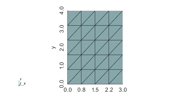

Triangle mesh
In this step a mesh using triangular cells will be created.
The size and number of cells will remain the same as in previous example.
The produced mesh file will be placed in output folder in triangle.vtu file.
Compared to the command from previous step, only element type and output file name changes, therefore we can use it:
generateStructuredMesh -e quad -o out/quads.vtu --lx 3 --ly 4 --nx 4 --ny 5
after changing element type quad to tri and file name quad.vtu to triangle.vtu:
! generateStructuredMesh -e tri -o {out_dir}/triangle.vtu --lx 3 --ly 4 --nx 4 --ny 5
info: Mesh created: 30 nodes, 40 elements.
info: 0 property vectors copied, 0 vectors skipped.
info: Removing total 13 elements...
info: 5 elements remain in mesh.
info: Removing total 12 nodes...
info: Boundary mesh 'left' written: 6 nodes, 5 elements.
info: Boundary mesh 'right' written: 6 nodes, 5 elements.
info: Removing total 14 elements...
info: 4 elements remain in mesh.
info: Removing total 13 nodes...
info: Boundary mesh 'bottom' written: 5 nodes, 4 elements.
info: Boundary mesh 'top' written: 5 nodes, 4 elements.
Running this command should create following mesh:
mesh = pv.read(f"{out_dir}/triangle.vtu")
show_mesh(mesh)
/tmp/ipykernel_434101/1051293568.py:8: PyVistaDeprecationWarning:
/var/lib/gitlab-runner/builds/K-X1vcp78/0/ogs/build/release-all/.venv/lib/python3.14/site-packages/pyvista/plotting/plotter.py:1577: Argument 'mesh' must be passed as a keyword argument to function 'Renderer.show_bounds'.
  plotter.show_bounds(mesh, xtitle="x", ytitle="y")

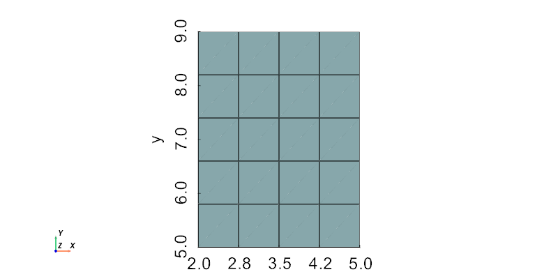

Shifting the reference point of the mesh
By adding parameter --o$direction $value, the reference point of the created mesh can be shifted.
In this example, the mesh from the step Quadrilateral mesh , will be created again but with the reference point shifted from (0,0) to (2,5) (in (x,y) format).
In order to do this, the final command from that step will be expanded by --ox 2 --oy 5:
! generateStructuredMesh -e quad -o {out_dir}/quads.vtu --lx 3 --ly 4 --nx 4 --ny 5 --ox 2 --oy 5
mesh = pv.read(f"{out_dir}/quads.vtu")
show_mesh(mesh)
Compare the values on X and Y axis with the ones in the figure in step Quadrilateral mesh .

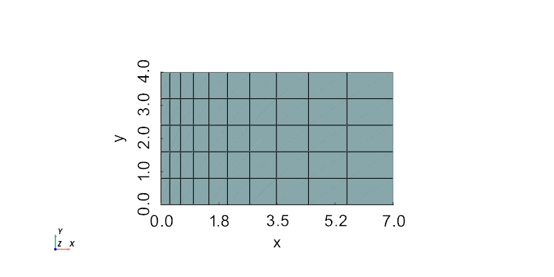

Quadrilateral graded meshes
…with automatically computed cell sizes
In this step a quadrilateral mesh with size of 7 in x-direction and 4 in y-direction (10 and 5 cells respectively) will be created.
However, this time an additional parameter will be passed.
It will change the sizes of the cells from equal to increasingly progressing.
By adding --mx 1.2, each next cell (in positive direction alongside x-axis) will be 1.2 times bigger than the previous one.
Value below zero will make cells smaller than the previous ones.
The command to create this mesh:
! generateStructuredMesh -e quad -o {out_dir}/quads_graded.vtu --lx 7 --ly 4 --nx 10 --ny 5 \(click to toggle)
    --mx 1.2
info: Mesh created: 66 nodes, 50 elements.
info: Removing total 25 elements...
info: Removing total 24 nodes...
info: Removing total 20 elements...
info: 10 elements remain in mesh.
info: Removing total 19 nodes...
info: Boundary mesh 'bottom' written: 11 nodes, 10 elements.
info: Boundary mesh 'top' written: 11 nodes, 10 elements.
Note that the name of the output file, values in --l and --n were changed compared to the command in Quadrilateral mesh step.
The \ allows to break the line and split command into more than one line to improve its readability.
Running it produces following mesh:
mesh = pv.read(f"{out_dir}/quads_graded.vtu")
show_mesh(mesh)
…with automatically computed cell sizes with given initial cell size
The command from previous step can be expanded with parameter --d$direction0 $value to define initial cell size, alongside $direction (x, y, or z).
Let’s say that the initial cell size is 1.
For this case following parameter should be appended: --dx0 1.
Expanded command from previous step:
! generateStructuredMesh -e quad -o {out_dir}/quads_graded_init_size.vtu --lx 7 --ly 4 --ny 5 \(click to toggle)
    --mx 1.2 --dx0 1
Note, that output file name has been changed, too.
The mesh produced by that command can be seen in this figure:
mesh = pv.read(f"{out_dir}/quads_graded_init_size.vtu")
show_mesh(mesh)

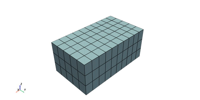

Structured mesh in 3D
In previous examples only 2D meshes were created.
createStructuredMesh is capable of creating 3D meshes, too.
In order to create one, the element type has to be changed to a 3D one and parameters --lz and --nz need to be passed additionally.
In 3D, the quadrilateral element type has to be replaced by hexahedral one.
! generateStructuredMesh -e hex -o {out_dir}/hexes.vtu --lx 7 --ly 4 --lz 3 --nx 10 --ny 5 --nz 3
info: Mesh created: 264 nodes, 150 elements.
info: Removing total 175 elements...
info: 15 elements remain in mesh.
info: Removing total 168 nodes...
info: Boundary mesh 'left' written: 24 nodes, 15 elements.
info: Boundary mesh 'right' written: 24 nodes, 15 elements.
info: Removing total 160 elements...
info: 30 elements remain in mesh.
info: Removing total 148 nodes...
info: Boundary mesh 'bottom' written: 44 nodes, 30 elements.
info: Boundary mesh 'top' written: 44 nodes, 30 elements.
info: Removing total 140 elements...
info: 50 elements remain in mesh.
info: Removing total 126 nodes...
info: Boundary mesh 'front' written: 66 nodes, 50 elements.
info: Boundary mesh 'back' written: 66 nodes, 50 elements.
The command above will create the following mesh:
mesh = pv.read(f"{out_dir}/hexes.vtu")(click to toggle)
plotter = pv.Plotter()
plotter.add_mesh(mesh, show_edges=True)
plotter.window_size = [800, 400]
plotter.add_axes()
plotter.show()

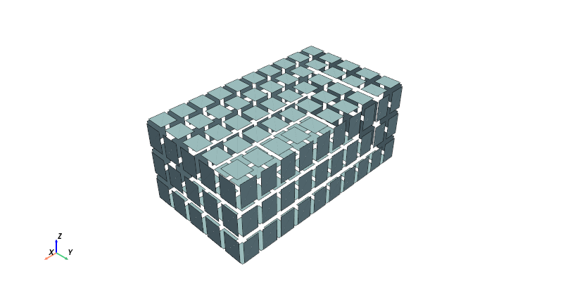

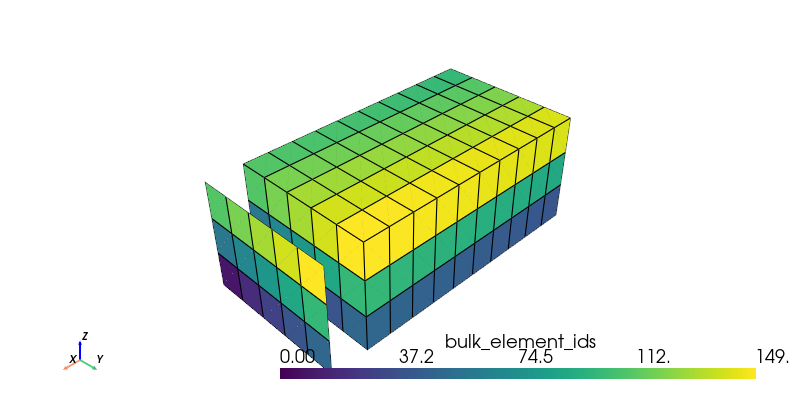

We can use the same command to extract the boundary of a 3D mesh.
# Using a previously generated mesh(click to toggle)
! ExtractBoundary -i "{out_dir}/hexes.vtu" -o "{out_dir}/hexes_boundary.vtu"
info: Mesh read: 264 nodes, 150 elements.
info: Created surface mesh: 192 nodes, 190 elements.
And visualize it:
boundary_mesh = pv.read(f"{out_dir}/hexes_boundary.vtu")
show_mesh_3D(boundary_mesh.shrink(0.8))

Let’s load the boundary mesh that we have extracted in the last step:
boundary_mesh = pv.read(f"{out_dir}/hexes_boundary.vtu")(click to toggle)
xmin, xmax, ymin, ymax, zmin, zmax = boundary_mesh.bounds
BoundsTuple(x_min = 0.0,
            x_max = 7.0,
            y_min = 0.0,
            y_max = 4.0,
            z_min = 0.0,
            z_max = 3.0)

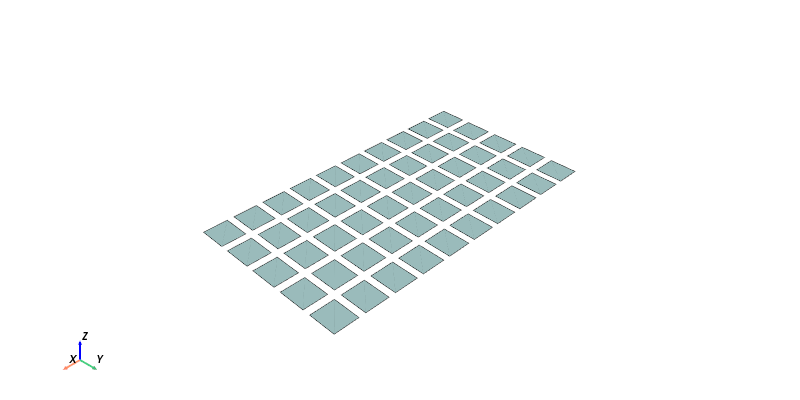

We remove all mesh elements except for the ones at the minimum z-value i.e. the plane at the minimum z-value.
! removeMeshElements -i "{out_dir}/hexes_boundary.vtu" -o "{out_dir}/hexes_zmin.vtu" --z-min {zmin + 1e-8}(click to toggle)
mesh = pv.read(f"{out_dir}/hexes_zmin.vtu")
show_mesh_3D(mesh.shrink(0.8))
info: Mesh read: 192 nodes, 190 elements.
info: Bounding box of "hexes_boundary" is
x = [0.000000,7.000000]
y = [0.000000,4.000000]
z = [0.000000,3.000000]
info: 140 elements found.

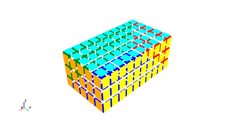

We can also remove all other bounding planes and plot them.
! removeMeshElements -i "{out_dir}/hexes_boundary.vtu" -o "{out_dir}/hexes_zmax.vtu" --z-max {zmax - 1e-8}(click to toggle)
! removeMeshElements -i "{out_dir}/hexes_boundary.vtu" -o "{out_dir}/hexes_xmin.vtu" --x-min {xmin + 1e-8}
! removeMeshElements -i "{out_dir}/hexes_boundary.vtu" -o "{out_dir}/hexes_xmax.vtu" --x-max {xmax - 1e-8}
! removeMeshElements -i "{out_dir}/hexes_boundary.vtu" -o "{out_dir}/hexes_ymin.vtu" --y-min {ymin + 1e-8}
! removeMeshElements -i "{out_dir}/hexes_boundary.vtu" -o "{out_dir}/hexes_ymax.vtu" --y-max {ymax - 1e-8}
info: 175 elements found.
info: 160 elements found.
plotter = pv.Plotter()(click to toggle)
plotter.add_mesh(pv.read(f"{out_dir}/hexes_xmin.vtu").shrink(0.8), lighting=False, color="red")
plotter.add_mesh(pv.read(f"{out_dir}/hexes_xmax.vtu").shrink(0.8), lighting=False, color="orange")
plotter.add_mesh(pv.read(f"{out_dir}/hexes_ymin.vtu").shrink(0.8), lighting=False, color="green")
plotter.add_mesh(pv.read(f"{out_dir}/hexes_ymax.vtu").shrink(0.8), lighting=False, color="yellow")
plotter.add_mesh(pv.read(f"{out_dir}/hexes_zmin.vtu").shrink(0.8), lighting=False, color="blue")
plotter.add_mesh(pv.read(f"{out_dir}/hexes_zmax.vtu").shrink(0.8), lighting=False, color="cyan")
plotter.add_axes()
plotter.window_size = [800,400]
plotter.show()

Exercises

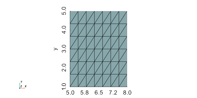

Exercise 1
  • Create a 2D mesh consisting of triangles.
  • There shall be 7 cells in x direction and 6 cells in y direction.
  • The mesh shall be 3 units wide and 4 units tall.
  • Its origin shall be at (5, 1).
  • The result can be visualized with show_mesh().
# Put your solution here
# Visualize your result
mesh_name = "" # Put your mesh name inside the ""
mesh = pv.read(f"out/{mesh_name}")
show_mesh(mesh)

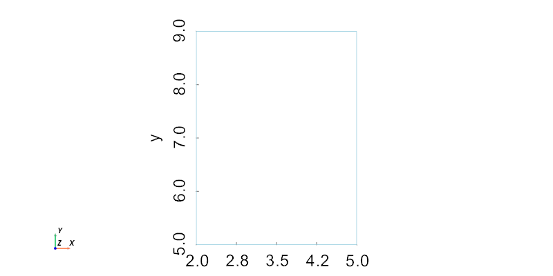

Exercise 2
Consider the mesh from the beginning of the previous step:
Remove all elements from this mesh that are not at the mesh boundary.
mesh_name = "" # Put your mesh name inside the brackets
mesh = pv.read(f"{out_dir}/{mesh_name}")
show_mesh(mesh)

Exercise 1
! generateStructuredMesh -e tri -o {out_dir}/ex1_triangle.vtu --lx 3 --ly 4 --nx 7 --ny 6 --ox 5 --oy 1(click to toggle)
# Visualize the result
mesh_name = "ex1_triangle.vtu" # Put your mesh name inside the brackets
show_mesh(mesh)
info: Mesh created: 56 nodes, 84 elements.

Exercise 2
# Extract boundary(click to toggle)
# Extract boundary
! ExtractBoundary -i "{out_dir}/quads.vtu" -o "{out_dir}/ex2quads_boundary.vtu"
# Visualize result
mesh_name = "ex2quads_boundary.vtu" # Put your mesh name inside the brackets
show_mesh(mesh)
info: Mesh read: 30 nodes, 20 elements.
info: Created surface mesh: 18 nodes, 18 elements.

Bulk mesh
import pyvista as pv(click to toggle)
# Created with: ! generateStructuredMesh -e hex -o out/hexes.vtu --lx 7 --ly 4 --lz 3 --nx 10 --ny 5 --nz 3
mesh
UnstructuredGridInformation
N Cells150
N Points264
X Bounds0.000e+00, 7.000e+00
Y Bounds0.000e+00, 4.000e+00
Z Bounds0.000e+00, 3.000e+00
N Arrays0
From the above cell’s output we see that ‘N Arrays == 0’. This means there is no data contained.

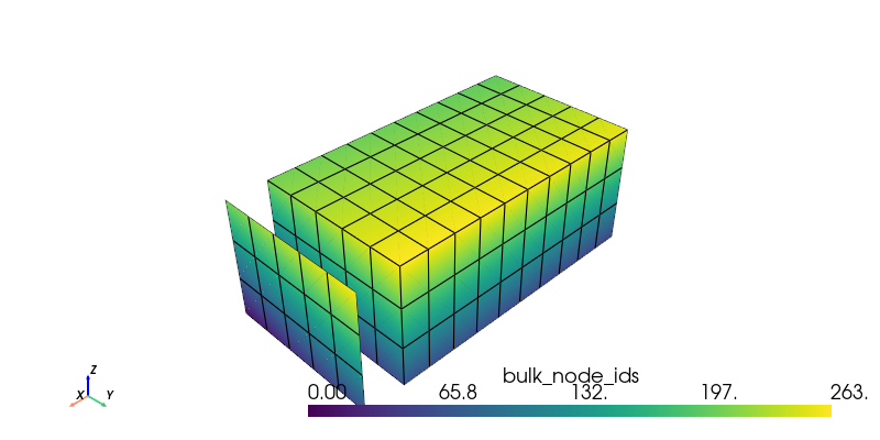

What is this data used for?
  • bulk_node_ids identify where the contributions of BCs and STs will go in the global equation system
  • bulk_element_ids, bulk_face_ids used with some advanced features, e.g. special BCs and surface flux computation
OGS will complain if the needed data is missing for BC or ST meshes.
bulk_mesh = pv.read(f"{out_dir}/hexes.vtu")(click to toggle)
bulk_mesh.point_data["bulk_node_ids"] = np.arange(bulk_mesh.n_points)
boundary_mesh = pv.read(f"{out_dir}/hexes_xmax.vtu")
# move the mesh a bit for better visualization
boundary_mesh.points[:,0] += 1
plotter.add_mesh(bulk_mesh, scalars="bulk_node_ids", show_edges=True, lighting=False)
plotter.add_mesh(boundary_mesh, scalars="bulk_node_ids", show_edges=True, lighting=False)
plotter.add_axes()
plotter.show()
bulk_mesh.cell_data["bulk_element_ids"] = np.arange(bulk_mesh.n_cells)
# Move the mesh a bit for better visualization
plotter.add_mesh(bulk_mesh, scalars="bulk_element_ids", show_edges=True, lighting=False)
plotter.add_mesh(boundary_mesh, scalars="bulk_element_ids", show_edges=True, lighting=False)
plotter.add_axes()
plotter.show()
