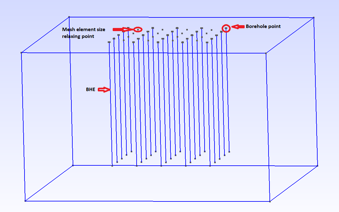

Next step is to include 25 boreholes in this project, organized in a 5X5 array. The corresponding coordinates are imported from a Excel spreadsheet file.
df_bhe = pd.read_excel('bhe_coordinates.xlsx')
df_relax = pd.read_excel('bhe_coordinates.xlsx', sheet_name=1)
Finally, all the borehole points and surrounding points are added to the surface 1. Here, 6 surrounding points for each borehole point are added with hexagonal shape like in this picture.

In this step, all BHE points will be extruded up to bhe_depth and each BHE line will be assigned unique physical group.
k= 2(click to toggle)
k= 2
for u in j:
    G = gmsh.model.geo.extrude([(0, u)], 0, 0, -bhe_depth, [10], [1], True)
    gmsh.model.addPhysicalGroup(1, [G[1][1]], k)
    k = k + 1
gmsh.model.geo.synchronize()

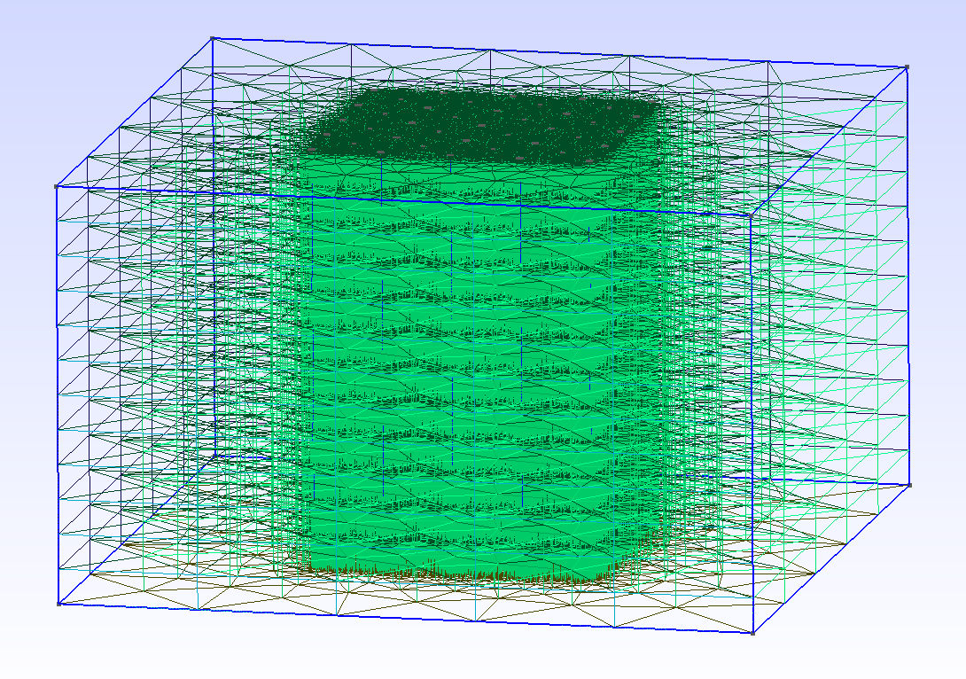

We can then generate a 3D mesh and save it to disk
gmsh.model.mesh.generate(3)(click to toggle)

If everything runs well, you will see the following mesh.
