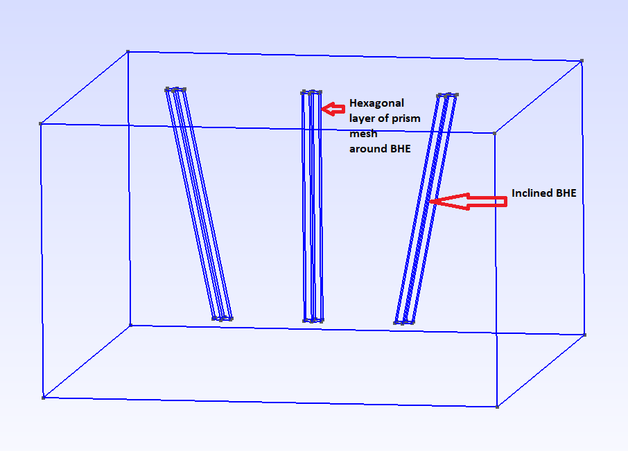

gmsh.model.geo.synchronize()The gmsh.model.geo.extrude command extrudes BHE surface 1, 2 and 3 along the z axis and automatically creates a new volume (as well as all the needed points, curves and surfaces).
The function takes a vector of (dim, tag) pairs as input as well as the translation vector, and returns a vector of (dim, tag) pairs as output.
For the BHE 1 and 2 in translational vector, x-coordinate is set to 2 and -2 respectively in order to create inclined BHE along x-direction.
As a result, the end point of BHEs will be deflected by 2 units along (+) and (-) x-direction.
The 2D mesh extrusion is done with the same extrude() function, but by specifying element ‘Layers’ (Here, one layer each with 10 subdivisions).
The number of elements for each layer and the (end) height of each layer are specified in two vectors.
The last (optional) argument for the extrude() function specifies whether the extruded mesh should be recombined or not.
In this case, it is True since we want to recombine and produce prism mesh elements.
Later, BHE points 5, 12 and 19 have been extruded in the same way to create line elements (Lr, Ll and Lm) which represent BHEs.
P = gmsh.model.geo.extrude([(2, 2)], 2, 0, -10, [10], [1], True) # BHE surface 1…
(click to toggle)
Q = gmsh.model.geo.extrude([(2, 3)], -2, 0, -10, [10], [1], True) # BHE surface 2
R = gmsh.model.geo.extrude([(2, 4)], 0, 0, -10, [10], [1], True) # BHE surface 3
Lr = gmsh.model.geo.extrude([(0, 5)], 2, 0, -10, [10], [1], True) # BHE 1
Ll = gmsh.model.geo.extrude([(0, 12)], -2, 0, -10, [10], [1], True) # BHE 2
Lm = gmsh.model.geo.extrude([(0, 19)], 0, 0, -10, [10], [1], True) # BHE 3

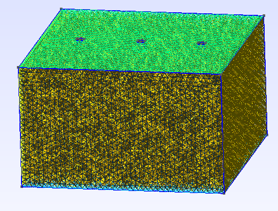

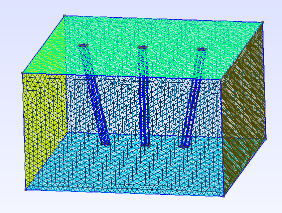

gmsh.option.setNumber("Mesh.MshFileVersion", 2.2)Then We can then generate a 3D mesh and save it to disk
gmsh.model.mesh.generate(3)…
(click to toggle)
gmsh.write(f"{out_dir}/{bhe_mesh_file_name}.msh")Info : Meshing 1D...

gmsh.finalize()If everything runs well, you will see the following mesh with incline BHEs.
2D version will look like this.
