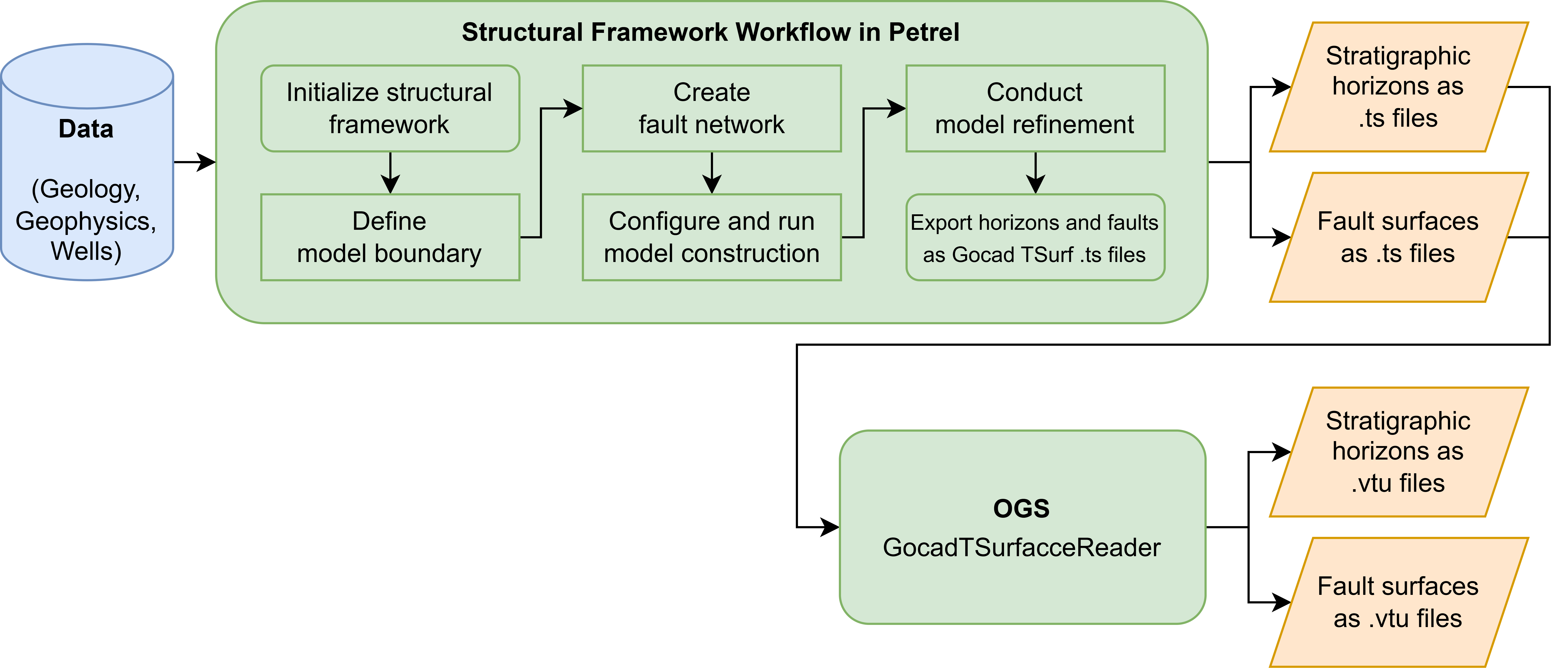

Model Preparation in Petrel
The underlying 3D model originates from the Master’s thesis by Fransiskus Litani Santoso with the title “Thermo-Hydraulic Modeling of the Northern Upper Rhine Graben using OpenGeoSys” (simplified version). The model is located in the Northern Upper Rhine Graben, which extends from 447000 to 475000 easting and from 5495000 to 5501000 northing (UTM zone 32N). The 3D modeling was conducted in Petrel with the structural framework workflow. All geological and fault surfaces should be exported from PETREL as Gocad TSurfaces .ts files. These .ts files must be converted into .vtu files before the meshing work can begin. This can be done using the GocadTSurfaceReader in OpenGeoSys, which reads the voxel set (VSET), the polylines (PLINE) and the triangulated surfaces (TSURF) from the .ts file and translates them into the *.vtu file format. These converted vtu files can then be used for the meshing procedure with PyVista and OGSTools ogstools.meshlib later.
Petrel Structural Framework Workflow & GocadTSurfaceReader
Now we convert TSurfaces (*.ts) files to VTU (*.vtu) files with GocadTSurfaceReader.

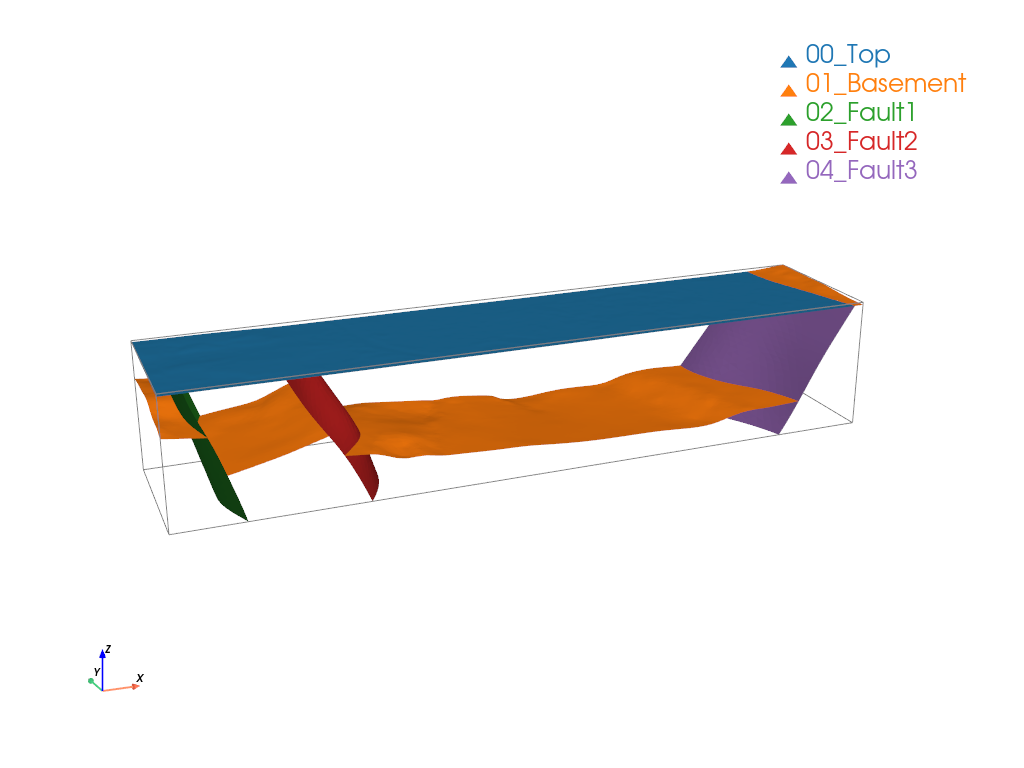

Then read *.vtu surface files and visualize all surfaces in PyVista.
strat_vtu = [pv.read(i) for i in [path_vtu + i + ".vtu" for i in strat_list]]
fault_vtu = [pv.read(i) for i in [path_vtu + i + ".vtu" for i in fault_list]]
pl = pv.Plotter()
pl.renderer.set_color_cycler("default") # for coloring
for i in range(len(strat_vtu)):
    pl.add_mesh(strat_vtu[i], label=strat_list[i])
for i in range(len(fault_vtu)):
    pl.add_mesh(fault_vtu[i], label=fault_list[i])
pl.add_legend(bcolor='w')
pl.add_bounding_box()
pl.show_axes()
pl.view_vector([-1,-2.5,1])
#pl.show()
pl.show(jupyter_backend="static")

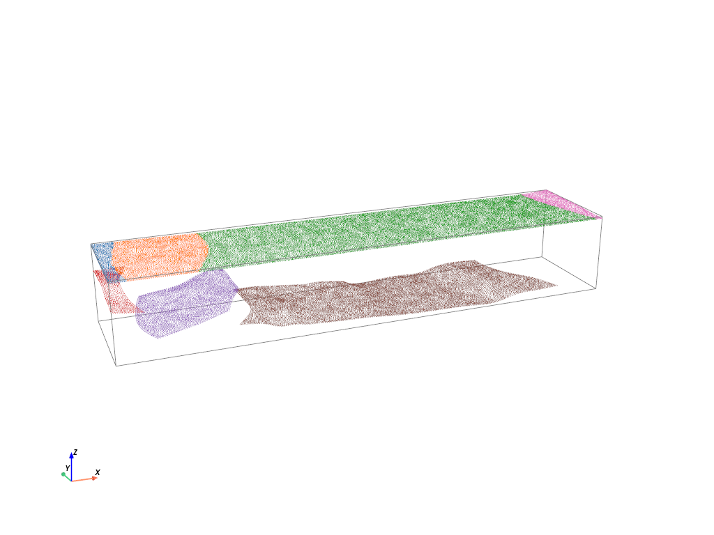

Here we extract nodes from the stratigraphical surfaces and separate nodes into different parts (ordered from west to east). First the top nodes
nodes_top_1 = strat_vtu[0].points[24638:] # West
nodes_top_2 = strat_vtu[0].points[20244:24638] # Center
nodes_top_3 = strat_vtu[0].points[:20244] # East
nodes_top = [nodes_top_1, nodes_top_2, nodes_top_3]
Then the basement nodes.
nodes_basement_1 = strat_vtu[1].points[21695:] # West
nodes_basement_2 = strat_vtu[1].points[16929:21695] # Center-West
nodes_basement_3 = strat_vtu[1].points[1298:16929] # Center-East
nodes_basement_4 = strat_vtu[1].points[:1298] # East
nodes_basement = [nodes_basement_1, nodes_basement_2, nodes_basement_3, nodes_basement_4]
# confirm the number of entries in nodes_basement is correct
assert len(nodes_basement) == 4, f"Expected 4 basement nodes but got {len(nodes_basement)}"

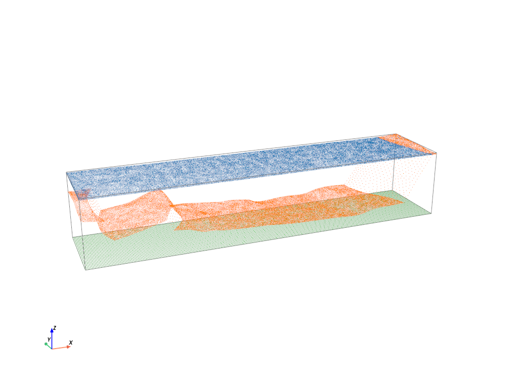

We can plot them in pyvista to check.
pl = pv.Plotter()
for i in range(len(nodes_top)):
    pl.add_points(nodes_top[i], point_size=1)
for i in range(len(nodes_basement)):
    pl.add_points(nodes_basement[i], point_size=1)
pl.show_axes()
#pl.show()

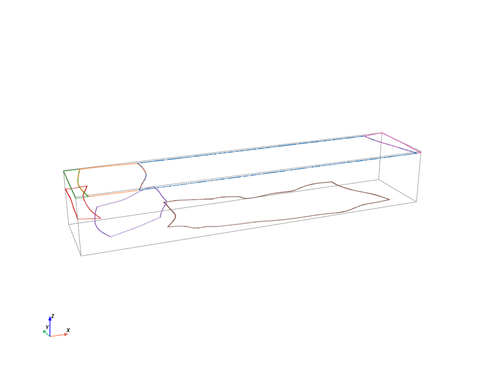

The boundaries are then to be extracted from each stratigraphic surface part. The work is also carried out manually and a semi-automatic calculation is recommended for bigger projects. Here we extract boundaries from the stratigraphical surfaces and separate boundaries into different parts (ordered from west to east).
boundary_strat_all = [i.extract_feature_edges(boundary_edges=True, non_manifold_edges=False, manifold_edges=False) for i in strat_vtu]
# 00_Top
boundary_top_1 = boundary_strat_all[0].points[:624] # West
boundary_top_2 = boundary_strat_all[0].points[624:830] # Center
boundary_top_3 = boundary_strat_all[0].points[828:] # East
boundary_top = [boundary_top_1, boundary_top_2, boundary_top_3]
# 01_Basement
boundary_basement_1 = boundary_strat_all[1].points[800:] # West
boundary_basement_2 = boundary_strat_all[1].points[608:800] # Center-West
boundary_basement_3 = boundary_strat_all[1].points[156:608] # Center-East
boundary_basement_4 = boundary_strat_all[1].points[:156] # East
boundary_basement = [boundary_basement_1, boundary_basement_2, boundary_basement_3, boundary_basement_4]
# Plot in pyvista for checking
pl = pv.Plotter()
for i in range(len(boundary_top)):
    pl.add_points(boundary_top[i], point_size=2)
for i in range(len(boundary_basement)):
    pl.add_points(boundary_basement[i], point_size=2)
pl.show_axes()

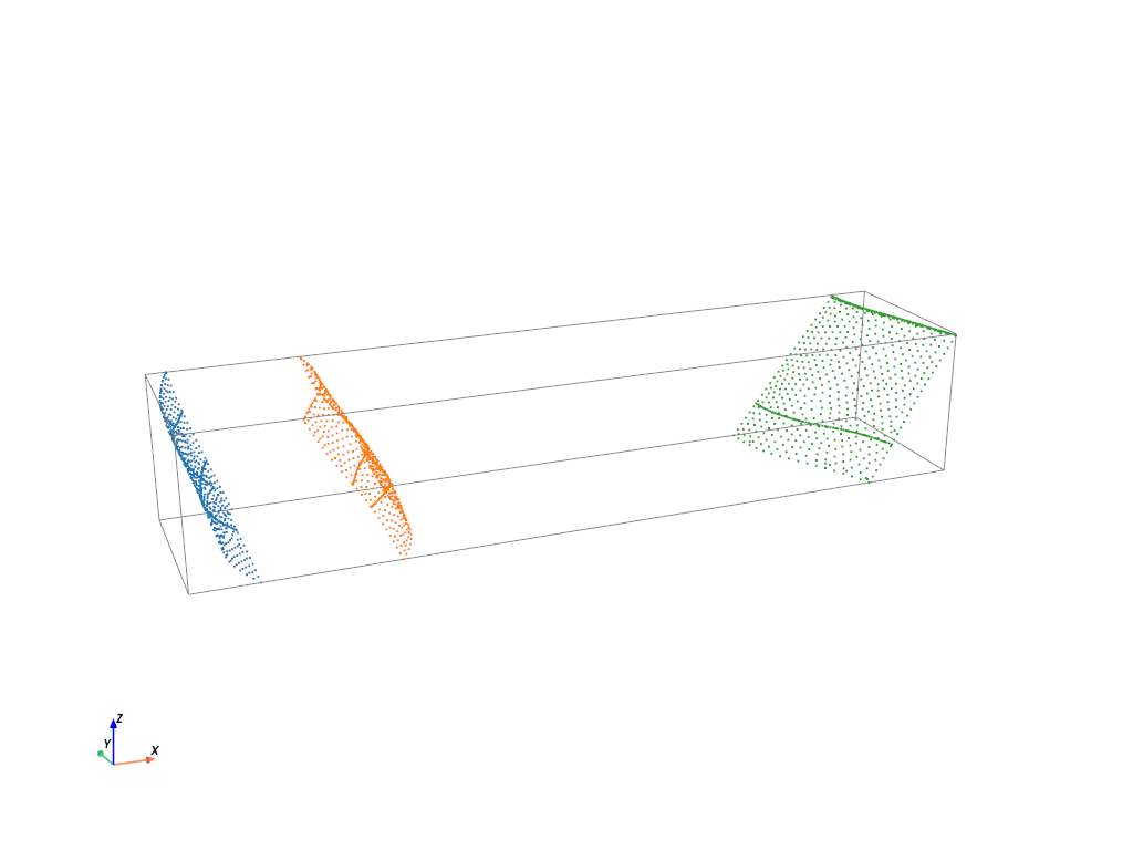

We get nodes from the fault surfaces and intersection with stratigraphical surfaces.
nodes_fault_all = []
    nodes_fault = fault_vtu[i].points
    # Basic idea: concatenate node fault with the discontinuity-pair of each fault
    # Boundary IDs, 0 is south, 1 is east, 2 is north, 3 is west
    nodes_fault = np.concatenate((nodes_fault, boundary_basement_sorted[i][1], boundary_basement_sorted[i+1][3]))
    nodes_fault_all.append(nodes_fault)
Now plot the figure in pyvista for checking.
pl = pv.Plotter()
for i in range(len(nodes_fault_all)):
    pl.add_points(nodes_fault_all[i], point_size=2)
pl.show_axes()

Here we close discontinuities in 01_Basement.
nodes_faults_basement = []
    # Basic idea: clip fault between two boundary-pair of each fault to close the discontinuity later
    west_dis = np.mean(boundary_basement_sorted[i][1][:,2])
    east_dis = np.mean(boundary_basement_sorted[i+1][3][:,2])
    if west_dis >= east_dis:
        nodes_clipped = clip_fault(nodes_fault_all[i], boundary_basement_sorted[i][1], boundary_basement_sorted[i+1][3])
        nodes_faults_basement.append(nodes_clipped)
        nodes_clipped = clip_fault(nodes_fault_all[i], boundary_basement_sorted[i+1][3][::-1], boundary_basement_sorted[i][1][::-1])
Subsequently, all parts of each stratigraphic layer are to be combined with the clipped faults as one stratigraphical surface to ensure there are no “empty nodes” in the point clouds. Once this step is done, the 3D mesh can be created with OGSTools.
# 00_Top
# Note: The basement is outcropped in the east of the graben shoulder
nodes_top_new = np.concatenate((nodes_top[0],nodes_top[1],nodes_top[2],nodes_basement[-1]))
surface_top = pv.UnstructuredGrid(pv.PolyData(nodes_top_new).delaunay_2d())
# 01_Basement
nodes_basement_new = np.concatenate((nodes_basement[0], nodes_faults_basement[0],
                                     nodes_basement[1], nodes_faults_basement[1],
                                     nodes_basement[2], nodes_faults_basement[2],
                                     nodes_basement[3]))
surface_basement = pv.UnstructuredGrid(pv.PolyData(nodes_basement_new).delaunay_2d())
Afterwards, a surface must be constructed for the bottom boundary.
# Bottom Boundary
nodes_bottom = []
for y in range(model_extent[2], model_extent[3]+1, int(0.5*model_res)):
    for x in range(model_extent[0], model_extent[1]+1, int(0.5*model_res)):
        nodes_bottom.append([float(x), float(y), model_extent[4]])
nodes_bottom = np.array(nodes_bottom)
surface_bottom = pv.UnstructuredGrid(pv.PolyData(nodes_bottom).delaunay_2d())
We plot the figures in PyVista for checking.
pl = pv.Plotter()
pl.add_points(nodes_top_new, point_size=1)
pl.add_points(nodes_basement_new, point_size=1)
pl.add_points(nodes_bottom, point_size=1)
pl.show_axes()
#pl.show()

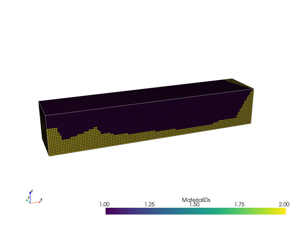

And plot it in PyVista.
pl = pv.Plotter()
pl.add_mesh(vm, scalars="MaterialIDs", show_edges=True)
pl.show_axes()
#pl.show()

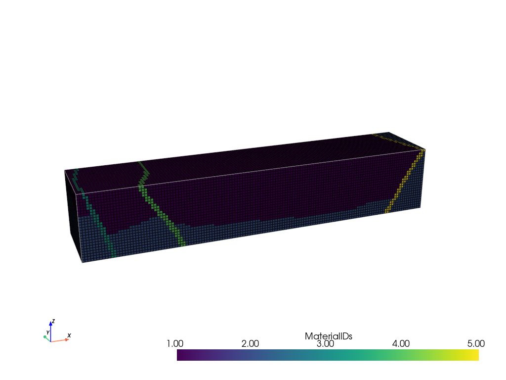

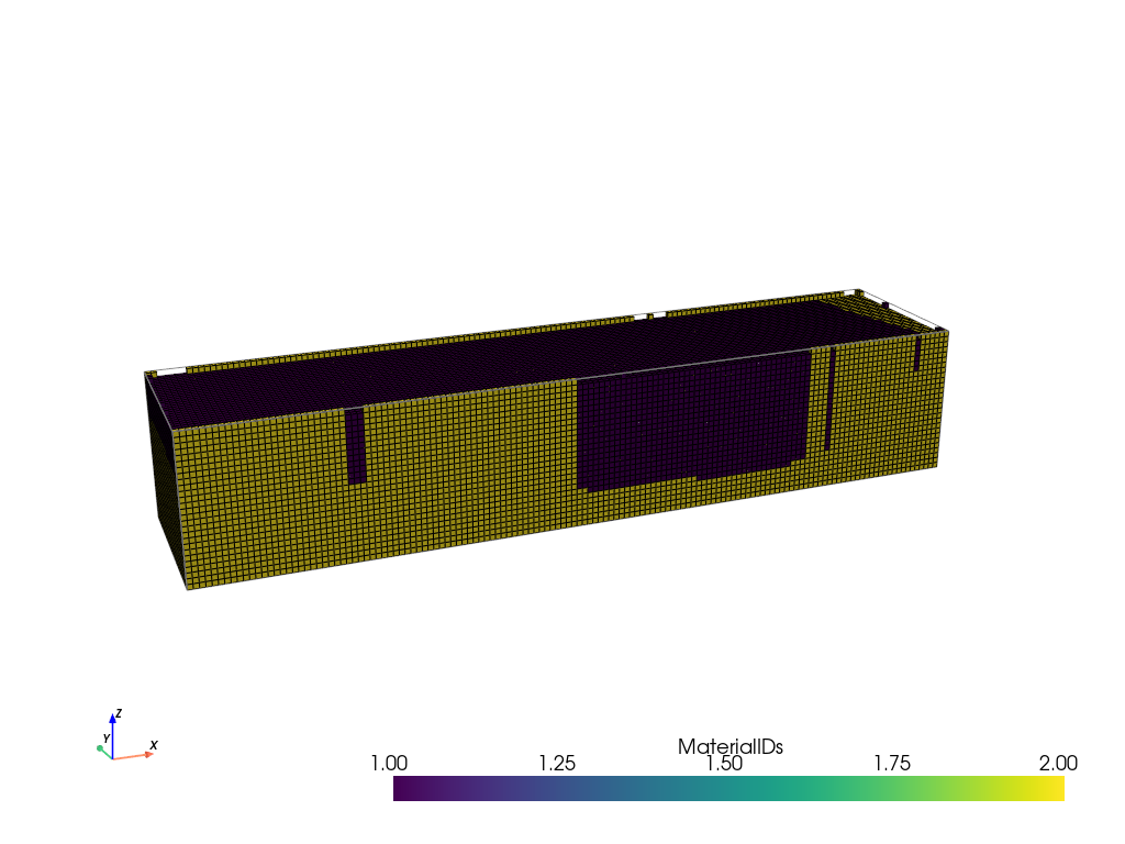

As can be seen above, the mesh quality along the boundaries of the model domain is poor. Therefore, the mesh must be clipped to eliminate this poor mesh quality. With the code below, the original 3D mesh is cut on each boundary by 1.5x of the model resolution, i.e. $1.5*\textrm{resolution} = 1.5*200~\textrm{m} = 250~\textrm{m}$.
# Clip the 3D mesh (exclude boundary of the model extent due to poor mesh quality)
resolution = [model_res, model_res, model_res]
vm_bounds = [model_extent[0]+1.5*resolution[0],
             model_extent[1]-1.5*resolution[0],
             model_extent[2]+1.5*resolution[1],
             model_extent[3]-1.5*resolution[1],
             model_extent[4]+1.5*resolution[2],
             model_extent[5]-1.5*resolution[2]]
vm_clipped = vm.clip_box(vm_bounds, invert=False, crinkle=True, merge_points=False)
# Function to plot mesh in PyVista
def plot_mesh(mesh):
    pl = pv.Plotter()
    pl.add_mesh(mesh, scalars="MaterialIDs", show_edges=True)
    pl.show_axes()
# Plot the clipped mesh
plot_mesh(vm_clipped)
# Save mesh as .vtu file
vm_clipped.save("./exported/3D_hex_mesh.vtu")
