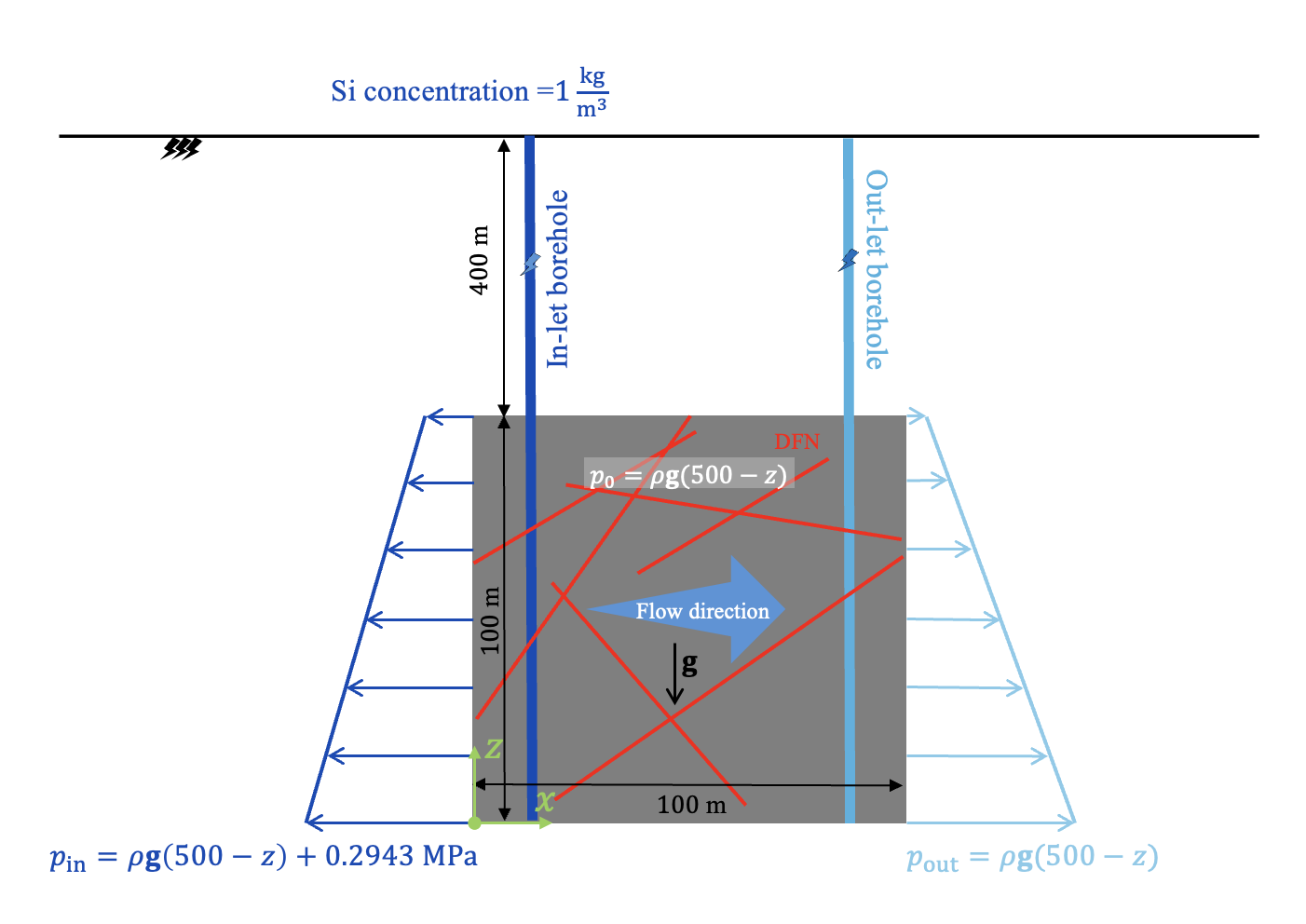

To investigate solute transport and retention in fractured rocks, a DFN is generated using PorePy with stochastic fracture placement algorithms. The resulting DFN geometry is processed through OGSTools to create OpenGeoSys (OGS)-compatible input files, enabling the setup and execution of a Hydro-Component (HC) simulation for flow and solute transport, and retention in realistic fractured media.

See DFNbyPorePy.py how to generate the DFN mesh and geometry data required by this notebook.

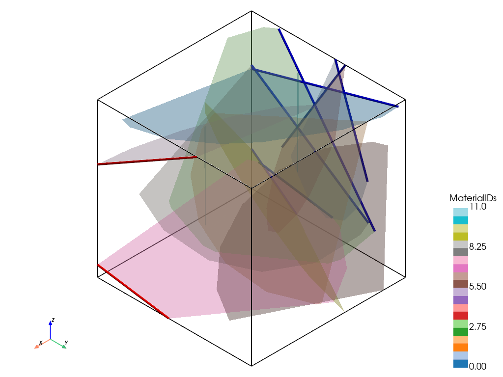

Plot DFN and boundaries
os.chdir(orig_dir)(click to toggle)
os.chdir(orig_dir)
DFN_2D = pv.read(f"{out_dir}/mixed_dimensional_grid_2.vtu")
x_inlet = pv.read(f"{out_dir}/x_inlet.vtu")
x_outlet = pv.read(f"{out_dir}/x_outlet.vtu")
plotter.add_mesh(
    DFN_2D,
    scalars="MaterialIDs",
    cmap="tab20",
    opacity=0.4,
    scalar_bar_args={"title": "MaterialIDs", "vertical": True},
plotter.add_mesh(DFN_2D.outline(), color="black", line_width=2)
plotter.add_mesh(
    x_inlet,
    color="blue",
    opacity=1.0,
    line_width=5,
    render_lines_as_tubes=True,
plotter.add_mesh(
    x_outlet,
    color="red",
    opacity=1.0,
    line_width=5,
plotter.show_axes()
plotter.enable_parallel_projection()
plotter.view_isometric()
if not pv.global_theme.trame.server_proxy_enabled:
    output_path = out_dir.joinpath("Concentration.png")
    plotter.screenshot(str(output_path))
plotter.show()
plotter.close()

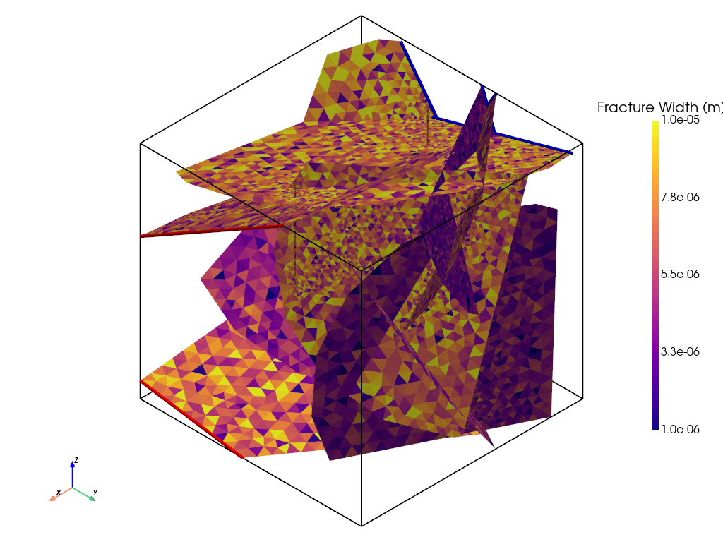

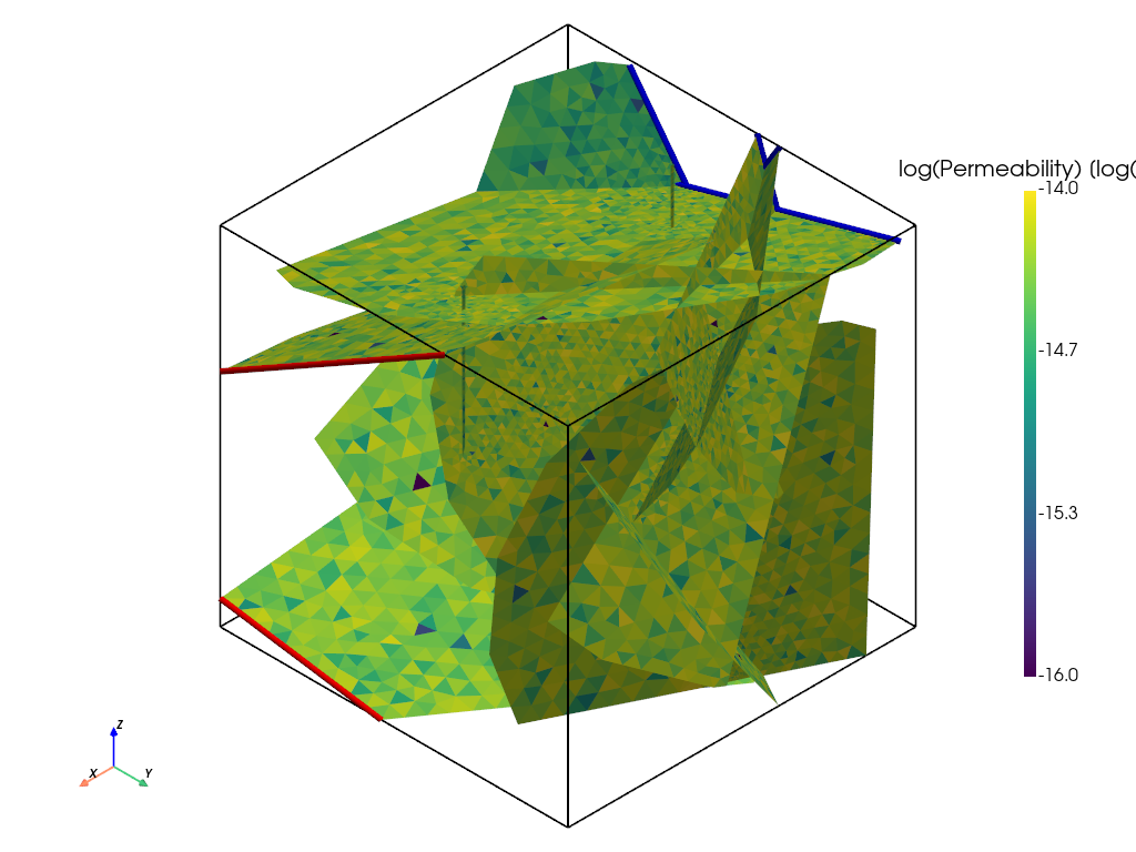

Generate and assign random fracture properties with Gaussian distributions
We assign random fracture properties (e.g., width and permeability) by calculating each mean value, $\mu$, from one of three user-defined distributions: Uniform , clipped Gaussian , or truncated Gaussian , constrained within specified bounds. The standard deviation is then calculated as $\sigma = \mathrm{rel_{std}} \times \mu$, with $\mathrm{rel_{std}}$ fixed at 30%, and cell values are subsequently sampled from a Gaussian distribution $\bigl(\mu, \sigma\bigr)$ and mapped to the mesh. Permeability can be configured as either isotropic or anisotropic.
Remark: Random fields with spatial correlation would be a more suitable representation of fracture heterogeneity. In the context of OGS see [8,9].

            k_vals = sample_truncnorm(k_min, k_max, k_mean, k_std, rng, size=n)
        elif method == "gaussian":
            width_vals = np.clip(rng.normal(w_mean, w_std, n), w_min, w_max)
            k_vals = np.clip(rng.normal(k_mean, k_std, n), k_min, k_max)
            msg = "Unknown sampling method"
            raise ValueError(msg)
        width_ic[idx] = np.clip(width_vals, clip_min, None)
        permeability[idx] = k_vals

SEED = 20250818(click to toggle)
SEED = 20250818
rng = default_rng(SEED)
fracture_stats = generate_random_fracture_stats(
    fracture_ids,
    width_range=(1e-6, 1e-5),
    k_range=(1e-16, 1e-14),
    rel_std=0.3,  # standard deviation is 30 % of mean value.
    mean_dist="gaussian",  # constant, uniform, gaussian, or truncated
    rng=rng,
assign_cellwise_random_props(mesh, fracture_stats, seed=SEED)
mesh.save(Path(out_dir, output_mesh), binary=False)

def plot_scalar_field(mesh, inlet, outlet, scalar_data, title, cmap, filename):
    scalar_bar_args = base_scalar_bar_args.copy()
    scalar_bar_args.update({"title": title, "fmt": "%.1e", "n_labels": 5})
    plotter.add_mesh(
        mesh,
        scalars=scalar_data,
        cmap=cmap,
        show_edges=False,
        scalar_bar_args=scalar_bar_args,
    plotter.add_mesh(mesh.outline(), color="black", line_width=2)
    plotter.add_mesh(inlet, color="blue", line_width=5, render_lines_as_tubes=True)
    plotter.add_mesh(outlet, color="red", line_width=5, render_lines_as_tubes=True)
    plotter.show_axes()
        plotter.screenshot(Path(out_dir, filename))
    plotter.show()
    plotter.close()
def plot_isotropic_permeability(
    mesh,
    inlet,
    outlet,
    out_dir,
    cmap="viridis",
    image_name="permeability_isotropic.png",
    k_iso = mesh.cell_data["permeability_ic"]
    k_log = np.log10(np.clip(k_iso, 1e-20, None))
    mesh.cell_data["log_k_iso"] = k_log
    scalar_bar_args["title"] = "log₁₀(Permeability) [log₁₀(m²)]"
    plotter.add_mesh(
        mesh,
        scalars="log_k_iso",
        cmap=cmap,
        show_edges=False,
    plotter.add_mesh(inlet, color="blue", line_width=6, render_lines_as_tubes=True)
    plotter.add_mesh(outlet, color="red", line_width=6, render_lines_as_tubes=True)
    plotter.show_axes()
        plotter.screenshot(Path(out_dir, image_name))
    plotter.show()
    plotter.close()
    mesh=DFN_2D,
    inlet=x_inlet,
    outlet=x_outlet,
    out_dir=out_dir,
plot_scalar_field(
    mesh=DFN_2D,
    inlet=x_inlet,
    outlet=x_outlet,
    scalar_data="width_ic",
    title="Fracture Width (m)",
    cmap="plasma",
    filename="width_ic.png",
Project file preparation

user_parameters = {(click to toggle)
user_parameters = {
    "prefix": "DFN_HC",
    "initial_pressure_expression": "1000*9.81*(500-z)",
    "inlet_pressure_expression": "1000*9.81*(500-z)+2.943e5",
    "outlet_pressure_expression": "1000*9.81*(500-z)",
    "inlet_concentration_value": "1",
    "porosity_value": "0.05",
    "decay_Si_value": "1e-12",
    "t_end": "1e11",
    "maximum_dt": "5e9",
    "numerical_stabilization": {
        "type": "FluxCorrectedTransport",
    "n_fractures": n_fractures,

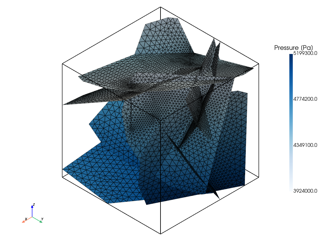

plotter = pv.Plotter(off_screen=True)(click to toggle)
scalar_bar_args["title"] = "Pressure [Pa]"
plotter.add_mesh(
    mesh,
    scalars="pressure",
    cmap="Blues",
    show_edges=True,
    opacity=1.0,
plotter.show_axes()
    output_path = out_dir.joinpath("pressure.png")
plotter.show()
plotter.close()

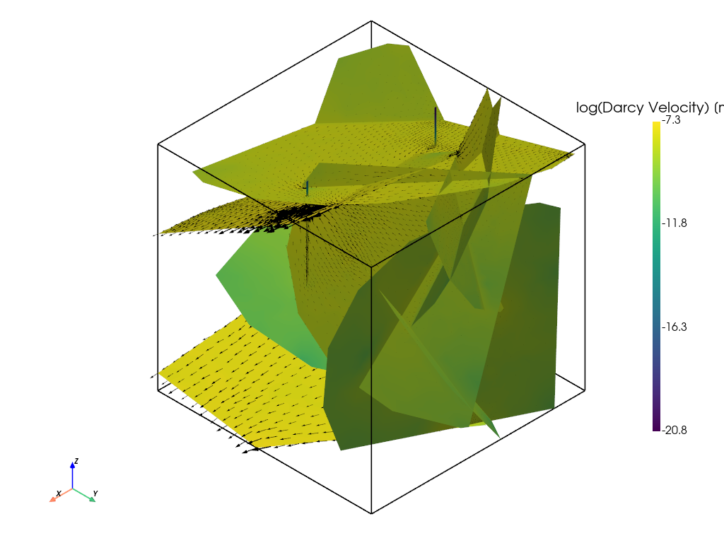

magnitude = np.linalg.norm(mesh["darcy_velocity"], axis=1)(click to toggle)
magnitude[magnitude <= 0] = 1e-12
log_magnitude = np.log10(magnitude)
mesh["darcy_velocity_magnitude"] = magnitude
mesh["log_darcy_velocity_magnitude"] = log_magnitude
mesh.set_active_vectors("darcy_velocity")
vmax = magnitude.max()
domain_size = max(mesh.bounds[1::2]) - min(mesh.bounds[::2])
scale_factor = domain_size * 0.1 / vmax if vmax > 0 else 1.0
arrows = mesh.glyph(
    scale="darcy_velocity_magnitude",
    orient="darcy_velocity",
    factor=scale_factor,
scalar_bar_args["title"] = "log₁₀(Darcy Velocity) [m/s]"
plotter.add_mesh(
    mesh,
    scalars="log_darcy_velocity_magnitude",
    cmap="viridis",
    opacity=1.0,
    show_edges=False,
plotter.add_mesh(arrows, color="black", label="Velocity Vectors")
plotter.show_axes()
    output_path = out_dir.joinpath("full_mesh_velocity_log_arrows.png")
plotter.show()
plotter.close()

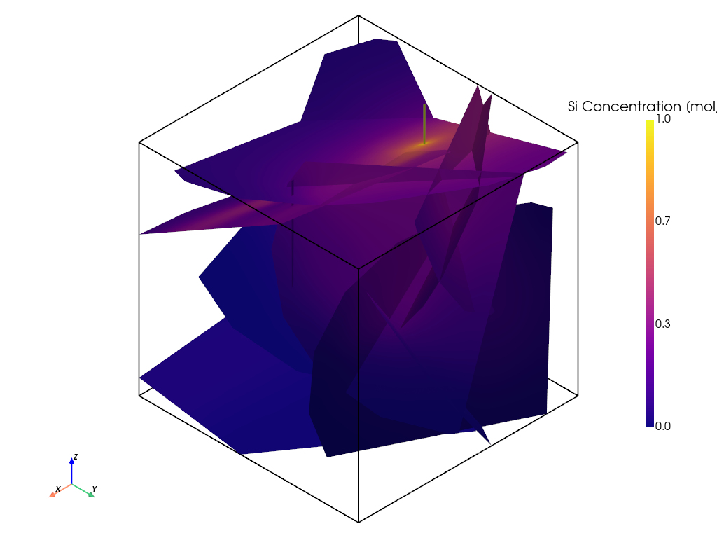

scalar_bar_args["title"] = "Si Concentration [mol/m³]"
plotter.add_mesh(
    mesh,
    scalars="Si",
    cmap="plasma",
    clim=(0, 1),
    show_edges=False,
    opacity=1.0,
plotter.show_axes()
    output_path = out_dir.joinpath("concentration.png")
plotter.show()
plotter.close()

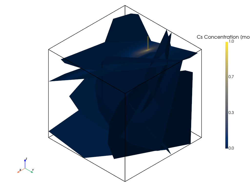

scalar_bar_args["title"] = "Cs Concentration [mol/m³]"
plotter.add_mesh(
    mesh,
    scalars="Cs",
    clim=(0, 1),
    cmap="cividis",
    show_edges=False,
    opacity=1.0,
plotter.show_axes()
    output_path = out_dir.joinpath("concentration_Cs.png")
plotter.show()
plotter.close()

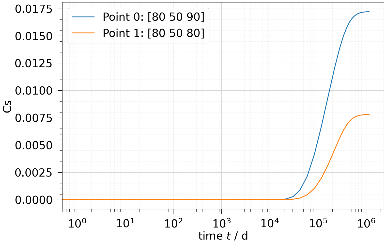

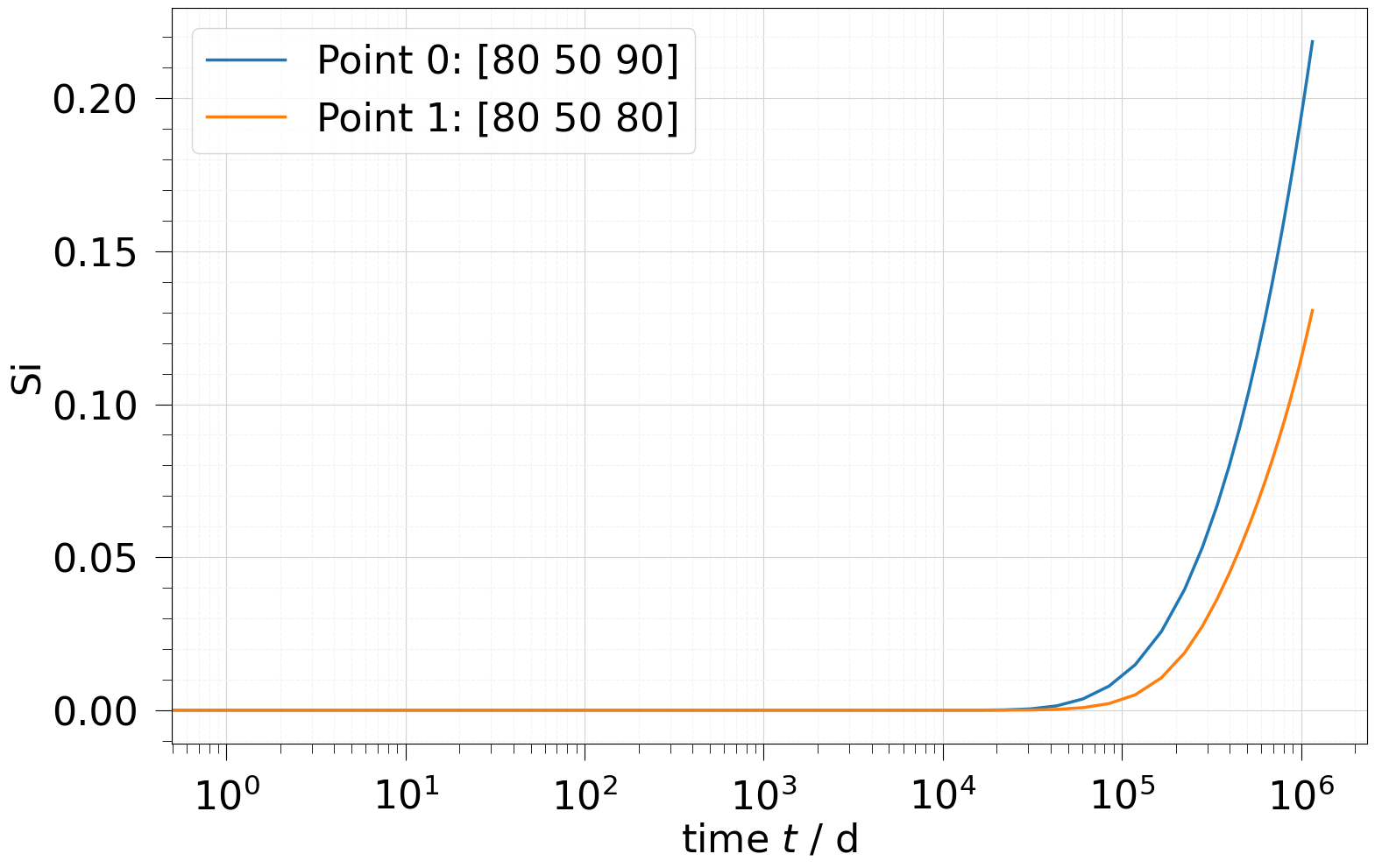

Breakthrough curve (BTC)
the temporal evolution of tracer concentration at a downstream monitoring point in a flow-through porous medium,
mesh_series = ot.MeshSeries(f"{out_dir}/{user_parameters['prefix']}.pvd")(click to toggle)
print("Scalar fields available in mesh:", mesh.array_names)
observation_points = np.array(
        [80, 50, 90],
        [80, 50, 80],
labels = [f"Point {i}: {pt}" for i, pt in enumerate(observation_points)]
ms_days = mesh_series.scale(time="d")
var = ot.variables.Scalar("Si")
ms_probe = ms_days.probe(points=observation_points)
fig_si = ms_probe.plot_line("time", var, labels=labels)
fig_si.axes[0].set_xscale("log")
fig_cs = ms_probe.plot_line("time", "Cs", labels=labels)
fig_cs.axes[0].set_xscale("log")
