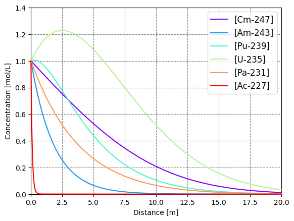

Concentration profiles
c = ana.computeConcentrations(x, t, v, D, k, radionuclides, c_inlet)…
(click to toggle)
fig, ax = plt.subplots()
colors = plt.cm.rainbow(np.linspace(0, 1, radionuclides.size))
for rn, color in zip(radionuclides, colors, strict=True):
ax.plot(x, c[rn], "-", lw=1.5, label=str(rn), c=color, zorder=10, clip_on=False)
ax.legend(frameon=True, loc="upper right", numpoints=1, fontsize=12, ncol=1)
ax.set(xlim=(0, 20), ylim=(0, 1.4))
ax.set(xlabel="Distance [m]", ylabel="Concentration [mol/L]")
ax.grid(which="both", color="gray", linestyle="dashed")

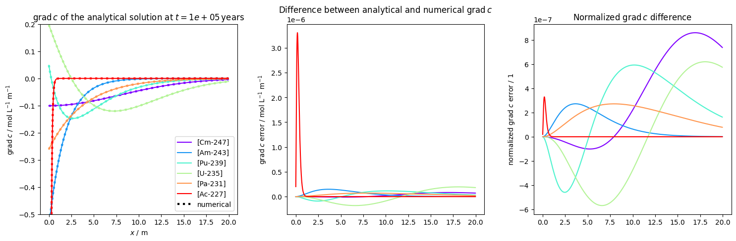

Concenctration gradient
x_mid = 0.5 * (x[:-1] + x[1:])…
(click to toggle)
grad_c = ana.computeGradients(x_mid, t, v, D, k, radionuclides, c_inlet)
grad_c_num = {n: (cs[1:] - cs[:-1]) / np.diff(x) for n, cs in c.items()}The following graph is just a self-check that the derived analytical expression for the gradient of the analytical solution is correct. The left plot shows both the analytical and numerical (central differences) gradient of the analytical solution for all nuclide concentrations. The center plot shows the difference between analytical and numerical gradients, and the right one the difference normalized to the range in which the numerical gradient varies. This normalized error is smaller than $10^{-6}$ for all nuclides.
fig, axs = plt.subplots(1, 3, sharex=True)…
(click to toggle)
for name, color in zip(radionuclides, colors, strict=True):
grad_cs = grad_c[name]
grad_cs_num = grad_c_num[name]
delta_grad_cs = grad_cs - grad_cs_num
delta_grad_cs_normalized = delta_grad_cs / np.ptp(grad_cs_num)
np.testing.assert_array_less(np.abs(delta_grad_cs), 3.5e-6)
np.testing.assert_array_less(np.abs(delta_grad_cs_normalized), 9e-7)
axs[0].plot(x_mid, grad_cs, label=name, color=color)
axs[0].plot(x_mid, grad_cs_num, ls=":", color=color, lw=3)
axs[1].plot(x_mid, grad_cs - grad_cs_num, color=color)
axs[2].plot(x_mid, delta_grad_cs_normalized, color=color)
axs[0].set_xlabel("$x$ / m")
axs[0].set_ylabel(r"$\mathrm{grad}\;c$ / mol L$^{-1}$ m$^{-1}$")
axs[1].set_ylabel(r"$\mathrm{grad}\;c$ error / mol L$^{-1}$ m$^{-1}$")
axs[2].set_ylabel(r"normalized $\mathrm{grad}\;c$ error / 1")
axs[0].set_title(
rf"$\mathrm{{grad}}\,c$ of the analytical solution at $t = {t:.0g}\,\mathrm{{years}}$"
axs[1].set_title(r"Difference between analytical and numerical $\mathrm{grad}\,c$")
axs[2].set_title(r"Normalized $\mathrm{grad}\,c$ difference")
axs[0].set_ylim(-0.5, 0.2)
axs[0].plot([], [], ":k", lw=3, label="numerical")
axs[0].legend()
fig.set_size_inches(18, 5)
fig.subplots_adjust(wspace=0.25)

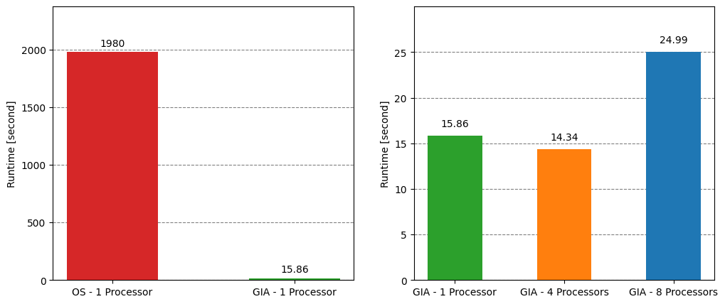

Two numerical models are presented here, one based on the global implicit approach (GIA) and the other on the operator splitting approach (OS). The OGS input files of these two models can be found here. Then, the obtained numerical solutions both are plotted against the analytical solution for verification.
###Run two numerical models###…
(click to toggle)
prj_name = "1d_decay_chain"
prj_file_GIA = Path(f"./GlobalImplicitApproach/{prj_name}_GIA.prj")
prj_file_OS = Path(f"./{prj_name}_OS.prj")
start_time = time.time()…
(click to toggle)
run(
f"ogs -o {out_dir} {prj_file_GIA} > {out_dir}/out.txt",
shell=True,
check=True,
end_time = time.time()
runtime_GIA = round(end_time - start_time, 2)
print("Execution time for the GIA model is ", runtime_GIA, "s")Execution time for the GIA model is 15.86 s

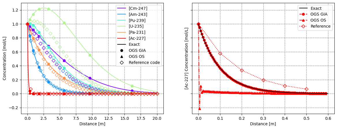

ms_GIA = ot.MeshSeries(f"{out_dir}/{prj_name}_GIA.pvd")…
(click to toggle)
assert np.isclose(ms_GIA.timevalues[-1], t * 3.1536e7)
mesh_GIA = ms_GIA[-1].clip("x", origin=(20, 0, 0))
GIA_x = mesh_GIA.points[:, 0]
# Given the fact that the runtime of the OS model (about 1800s) is
# far longer than the time constraint specified (600s), we decide not
# to use the OS simulation results obtained from automated testing.
# Instead, the pre-prepared reference simulation results are used.
ms_OS = ot.MeshSeries(f"{prj_name}_OS.pvd")
mesh_OS = ms_OS[-1].clip("x", origin=(20, 0, 0))
assert np.isclose(ms_OS.timevalues[-1], t * 3.1536e7)
OS_x = mesh_OS.points[:, 0]
(click to toggle)
def clip_data(x_, y_, x_lim=0.6):
return (x_[np.where(x_ < x_lim)], y_[np.where(x_ < x_lim)])
fig, axs = plt.subplots(1, 2, figsize=(14, 5), sharey=True)
axs[0].set(xlabel="Distance [m]", ylabel="Concentration [mol/L]")
axs[1].set(xlabel="Distance [m]", ylabel="[Ac-227] Concentration [mol/L]")
axs[1].plot(*clip_data(x, c["[Ac-227]"]), "-k", lw=1.5, label="Exact", zorder=10)
axs[1].plot(*clip_data(GIA_x, mesh_GIA["[Ac-227]"]), "--or", lw=1.5, label="OGS GIA")
axs[1].plot(*clip_data(OS_x, mesh_OS["[Ac-227]"]), "-.^r", lw=1.5, label="OGS OS")
c_gia = mesh_GIA[rn]
c_os = mesh_OS[rn]
axs[0].plot(x, c[rn], "-", lw=1.5, label=rn, c=color)
axs[0].plot(GIA_x, c_gia, "o", color=color, markevery=50)
axs[0].plot(OS_x, c_os, "^", color=color, markevery=50)
# numerical solution by reference code
# added once the bc value is double-checked
with h5py.File("./solution_reference_code.hdf5", "r") as f:
for s_, color in zip(f["species"][:], colors, strict=True):
value = f[s_][:, 1] / porosity
axs[0].plot(f["x"][:], value, "D", color=color, markevery=5, fillstyle="none")
if s_ == b"Ac-227":
axs[1].plot(
*clip_data(f["x"][:], value), ":Dr", label="Reference", fillstyle="none"
axs[0].grid(which="both", color="gray", linestyle="dashed")
axs[1].grid(which="both", color="gray", linestyle="dashed")
axs[0].plot([], [], "-k", lw=1.5, label="Exact")
axs[0].plot([], [], "ok", label="OGS GIA")
axs[0].plot([], [], "^k", label="OGS OS")
axs[0].plot([], [], "Dk", fillstyle="none", label="Reference code")
axs[0].legend()
_ = axs[1].legend()

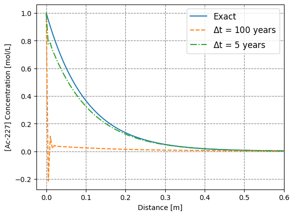

As can be seen from Subfigure 1, for all radionuclides except the fastest decaying Actinium-227, the predicted concentration profiles using GIA and OS both agree well with the analytical solutions. For Actinium-227 concentration, the GIA solution perfectly matches with the reference result (see Subfigure 2). By contrast, the OS solution near the inlet deviates significantly from the reference result. The observed deviation is due to the fact that the time step size adopted in the simulation ($\Delta t$ = 100 years) is too large compared to the half-life of Actinium-227 ($t_{1/2}$ = 21.773 years).

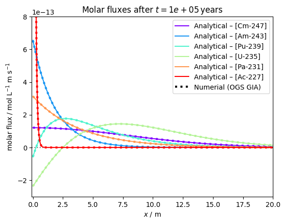

Molar fluxes (GIA simulation)
The following graph shows the molar fluxes obtained both analytically (solid lines) and numerically (GIA approach, thick, dotted lines). It can be seen that both results coincide well.
grad_c = ana.computeGradients(x, t, v, D, k, radionuclides, c_inlet)…
(click to toggle)
molar_flux_ana = {
n: -porosity * diffusion_constant * grad_cs for n, grad_cs in grad_c.items()
ax.axhline(0, ls=":", color="gray")
ax.set_title(rf"Molar fluxes after $t = {t:.0g}\,\mathrm{{years}}$")
ax.set(xlabel="$x$ / m", ylabel="molar flux / mol L$^{-1}$ m s$^{-1}$")
ax.plot(x, molar_flux_ana[rn], "-", lw=1.5, label=f"Analytical – {rn}", c=color)
ax.plot(GIA_x, mesh_GIA[rn + "Flux"], ":", lw=3, c=color)
ax.set(xlim=(-0.1, 20), ylim=(-3e-13, 8e-13))
ax.plot([], [], ":k", lw=3, label="Numerial (OGS GIA)")
ax.legend()<matplotlib.legend.Legend at 0x7f693c588c20>

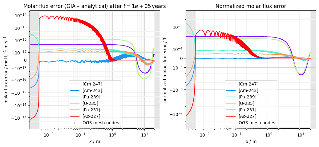

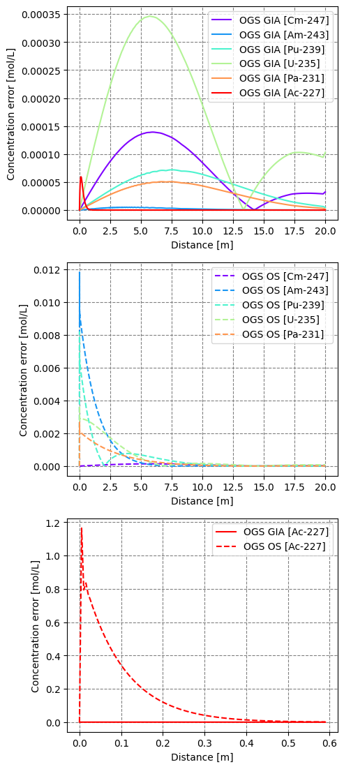

Error analysis
Furthermore, we perform an error analysis of the GIA and OS solutions. As can be observed from Subfigures 1 and 3, the absolute error of the GIA solution for all the radionuclides is suppressed at a low level. The maximum absolute error is only $3.6 \cdot 10^{-4}$ mol/L. In contrast, the absolute error of the OS solution is two to three orders of magnitude greater than that of the GIA solution (see Subfigures 2 and 3). And the error becomes more apparent closer to the inlet.
fig, axs = plt.subplots(3, 1, figsize=(5, 13.5))…
(click to toggle)
delta_GIA = np.abs(mesh_GIA[rn] - np.interp(GIA_x, x, c[rn]))
delta_OS = np.abs(mesh_OS[rn] - np.interp(OS_x, x, c[rn]))
np.testing.assert_array_less(delta_GIA, 3.6e-4)
axs[0].plot(GIA_x, delta_GIA, "-", color=color, label=f"OGS GIA {rn}")
if rn == "[Ac-227]":
np.testing.assert_array_less(delta_OS, 1.2)
axs[2].plot(*clip_data(GIA_x, delta_GIA), "-r", label=f"OGS GIA {rn}")
axs[2].plot(*clip_data(OS_x, delta_OS), "--r", label=f"OGS OS {rn}")
np.testing.assert_array_less(delta_OS, 0.012)
axs[1].plot(OS_x, delta_OS, "--", color=color, label=f"OGS OS {rn}")
for i in range(3):
axs[i].set(xlabel="Distance [m]", ylabel="Concentration error [mol/L]")
axs[i].grid(which="both", color="gray", linestyle="dashed")
_ = axs[i].legend()

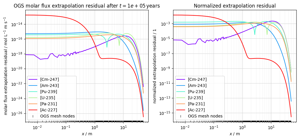

Molar fluxes
The following plots show the difference between numerically computed molar fluxes (OGS, GIA approach) and analytically derived fluxes (left plot), and that difference normalized to the range of analytical concentration gradients (right plot). That normalized error is smaller than 0.1 % for all nuclides.
fig, axs = plt.subplots(1, 2, figsize=(12, 5), sharex=True)…
(click to toggle)
axs: list[plt.Axes]
axs[0].set(xlabel="$x$ / m", ylabel=r"molar flux error / mol L$^{-1}$ m s$^{-1}$")
axs[1].set(xlabel="$x$ / m", ylabel=r"normalized molar flux error / 1")
axs[0].set_title(
rf"Molar flux error (GIA – analytical) after $t = {t:.0g}\,\mathrm{{years}}$"
axs[1].set_title(r"Normalized molar flux error")
axs[0].set_yscale("asinh", linear_width=5e-18)
axs[1].set_yscale("asinh", linear_width=1e-4)
flux_err = np.interp(x, GIA_x, mesh_GIA[rn + "Flux"]) - molar_flux_ana[rn]
flux_err_normalized = flux_err / np.ptp(molar_flux_ana[rn])
np.testing.assert_array_less(np.abs(flux_err_normalized)[x > GIA_x[1]], 8e-4)
axs[0].plot(x, flux_err, label=rn, color=color)
axs[1].plot(x, flux_err_normalized, label=rn, color=color)
for ax in axs:
ax.set_xlim((0.5 * GIA_x[1], 1.5 * x[-1]))
ax.autoscale(False)
marker_y = [ax.get_ylim()[0]] * len(GIA_x)
ax.scatter(GIA_x, marker_y, c="k", marker="|", alpha=0.5, label="OGS mesh nodes")
ax.axvspan(0.5 * GIA_x[1], GIA_x[1], alpha=1, color="0.9")
ax.axvspan(x[-1], 1.5 * x[-1], alpha=1, color="0.9")
ax.set_xscale("log")
ax.grid(which="minor", color="0.95")
ax.grid(which="major", color="lightgray")
ax.legend()
Molar fluxes are a secondary quantity in OGS. They are computed at the integration points of each mesh element and extrapolated to the mesh nodes for output purposes. The contributions to the nodal values from each adjacent mesh element are averaged. This extrapolation and averaging procedure leads to errors itself. OGS computes an error indicator for the extrapolation and averaging error. This indicator is the root mean square error when re-interpolating the extrapolated and averaged molar fluxes back to the integration points. It is computed as a cell field. It is shown for all nuclides in the plots below. The left plot shows the extrapolation residuals, the right one the extrapolation residuals normalized to the range of molar fluxes. That normalized error is smaller than 0.23 % for all nuclides but Ac-227, for which it is smaller than 1.5 %. The error estimate is larger — in the Ac-227 case much larger — than the actual error. I.e., in this case, it is a conservative estimate of the actual error, but it’s worthwhile to reconsider this on a case-by-case basis.
###Read simulation results###…
(click to toggle)
mesh_GIA = ms_GIA[-1].clip("x", origin=(50, 0, 0))
GIA_center_x = mesh_GIA.cell_centers(vertex=False).points[:, 0]
assert np.all(np.diff(GIA_center_x) > 0)
grad_c_ex = ana.computeGradients(GIA_center_x, t, v, D, k, radionuclides, c_inlet)
molar_flux_ana_ex = {
n: -porosity * diffusion_constant * grad_cs for n, grad_cs in grad_c_ex.items()
axs: list[plt.Axes]
axs[0].set_ylabel(
r"molar flux extrapolation residual / mol L$^{-1}$ m s$^{-1}$",
axs[1].set_ylabel(r"normalized extrapolation residual / 1")
axs[0].set_title(
rf"OGS molar flux extrapolation residual after $t = {t:.0g}\,\mathrm{{years}}$"
axs[1].set_title(r"Normalized extrapolation residual")
flux_res = mesh_GIA[rn + "Flux_residual"]
flux_res_normalized = flux_res / np.ptp(molar_flux_ana_ex[rn])
if rn != "[Ac-227]":
np.testing.assert_array_less(np.abs(flux_res_normalized), 0.0023)
np.testing.assert_array_less(np.abs(flux_res_normalized), 1.5e-2)
axs[0].loglog(GIA_center_x, flux_res, label=rn, color=color)
axs[1].loglog(GIA_center_x, flux_res_normalized, label=rn, color=color)
for ax in axs:
ax.set_xlim((0.75 * GIA_x[1], 1.5 * GIA_x[-1]))
ax.autoscale(False)
ax.set_xlabel("$x$ / m")
ax.legend()
The effect of time step size
As shown in the figure below, the OS solution is rather sensitive to the time stepping scheme. By reducing the time step size from 100 years to 5 years, the solution accuracy near the inlet is greatly improved. Nevertheless, the OS solution accuracy is yet lower than that of the GIA solution despite a larger time step size.
ms_OS_5a = ot.MeshSeries(f"{prj_name}_OS_5year.pvd")…
(click to toggle)
assert np.isclose(ms_OS_5a.timevalues[-1], t * 3.1536e7)
mesh_OS_5a = ms_OS_5a[-1].clip("x", origin=(0.6, 0, 0))
OS_5a_x = mesh_OS_5a.points[:, 0]
ac = radionuclides[-1]
ax.plot(x, c[ac], "-", lw=1.5, label="Exact")
ax.plot(OS_x, mesh_OS[ac], "--", lw=1.5, label=r"$\Delta$t = 100 years")
ax.plot(OS_5a_x, mesh_OS_5a[ac], "-.", lw=1.5, label=r"$\Delta$t = 5 years")
ax.legend(frameon=True, loc="upper right", fontsize=12)
ax.set(xlim=(-0.025, 0.6))
ax.set(xlabel="Distance [m]", ylabel=f"{ac} Concentration [mol/L]")
Computational performance of two solution strategies
The runtime of the GIA model is only 22.13 seconds, approximately two orders of magnitude faster than the OS model in this case (see the figure below). Further time profiling analysis for the OS model indicates that PHREEQC consumes over 90 percent of the runtime for solving the local decay-chain problem. To summarize, the global implicit approach (GIA) is clearly superior to the operator splitting approach in terms of solution accuracy and computational performance. Moreover, the global implicit approach even allows for a larger time step size.
The effect of parallelization on computational performance
In order to further improve the computational performance of the GIA model, MPI parallelization is employed. As its result, the simulation runtime is drastically reduced down to 4.82 seconds with the number of processors increased to 8. This results in a 4.6X speed boost.
runtimes = {"OS - 1 Processor": 1980, "GIA - 1 Processor": runtime_GIA}…
(click to toggle)
for n in [4, 8]:
prj_GIA_np = Path(f"./GlobalImplicitApproach/MPI/{n}Processors/{prj_name}_GIA.prj")
cmd = f"mpirun --bind-to none -np {n} ogs {prj_GIA_np} -o {out_dir} > {out_dir}/out.txt"
print(cmd)
run(cmd, shell=True, check=True)
runtimes[f"GIA - {n} Processors"] = round(end_time - start_time, 2)
print(
f"Execution time for the parallelized GIA model with {n} processors is ",
runtimes[f"GIA - {n} Processors"],
"s",
)mpirun --bind-to none -np 4 ogs GlobalImplicitApproach/MPI/4Processors/1d_decay_chain_GIA.prj -o /var/lib/gitlab-runner/builds/sy3_rc3xP/0/ogs/build/release-petsc/Tests/Data/Parabolic/ComponentTransport/ReactiveTransport/DecayChain/DecayChain > /var/lib/gitlab-runner/builds/sy3_rc3xP/0/ogs/build/release-petsc/Tests/Data/Parabolic/ComponentTransport/ReactiveTransport/DecayChain/DecayChain/out.txt
Execution time for the parallelized GIA model with 4 processors is 14.34 s
mpirun --bind-to none -np 8 ogs GlobalImplicitApproach/MPI/8Processors/1d_decay_chain_GIA.prj -o /var/lib/gitlab-runner/builds/sy3_rc3xP/0/ogs/build/release-petsc/Tests/Data/Parabolic/ComponentTransport/ReactiveTransport/DecayChain/DecayChain > /var/lib/gitlab-runner/builds/sy3_rc3xP/0/ogs/build/release-petsc/Tests/Data/Parabolic/ComponentTransport/ReactiveTransport/DecayChain/DecayChain/out.txt
Execution time for the parallelized GIA model with 8 processors is 24.99 s
fig, axs = plt.subplots(1, 2, figsize=(12, 5))…
(click to toggle)
for i, stop in enumerate([2, None]):
axs[i].set_ylabel("Runtime [second]")
axs[i].yaxis.grid(color="gray", linestyle="dashed", zorder=0)
axs[i].margins(y=0.2)
for j, (k, v) in enumerate(list(runtimes.items())[i:stop]):
color = f"C{3-list(runtimes).index(k)}"
axs[i].bar(k, v, width=0.5, zorder=3, color=color)
axs[i].annotate(v, (j, v + [50, 1][i]), ha="center")
