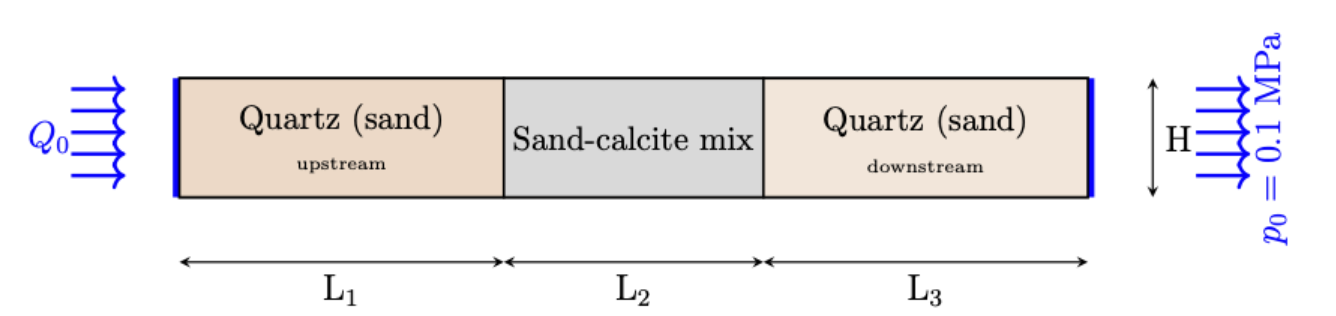

This study models how the injection of sulfuric acid alters the porosity and permeability of a layered porous medium. The domain is water-saturated and consists of three distinct layers:
  • Upstream quartz sand (inert)
  • Reactive sand-calcite interlayer
  • Downstream quartz sand (inert)
Schematic
Figure: Schematic
The quartz sand is chemically inert, while the key process is the dissolution of calcite in the middle layer by acid, which increases porosity. This porosity change modifies permeability according to the Kozeny-Carman relationship ($ k = k_0 \frac{(1 - \phi_0)^2}{\phi_0^3} \frac{\phi^3}{(1 - \phi)^2} $), thereby influencing subsequent fluid flow and solute transport. Aqueous chemical speciation is computed using the LLNL thermodynamic database .
Boundary conditions, initial conditions, and specific parameter values are provided in the Input Data section. The geochemical reactions are implemented using PHREEQC, tracking five primary components ($\mathrm{S(6)}$, $\mathrm{C}$, $\mathrm{Ca}$, $\mathrm{Na}$, $\mathrm{Cl}$) with calcite dissolution kinetics following a three-mechanism rate law (acid, neutral, and $\mathrm{CO_2}$-promoted pathways).

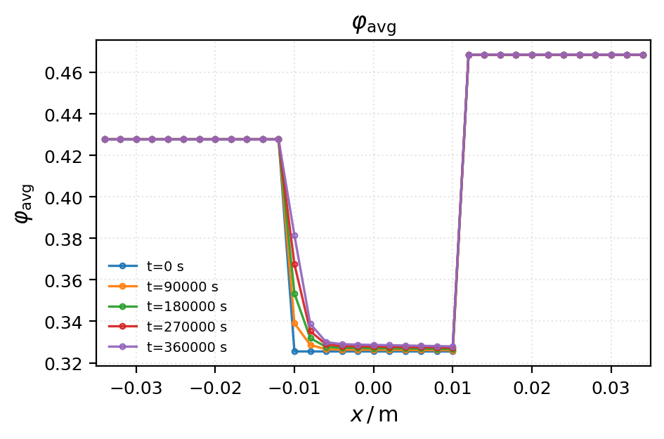

Media: Initial Porosity $,\phi_0,$ & Permeability $,k_0$
Layer $\phi_0$ [–] $k_0$ [m$^2$]
Upstream quartz $0.4277$ $2.95\times10^{-12}$
Reactive interlayer $0.3255$ $1.52\times10^{-12}$
Downstream quartz $0.4685$ $3.21\times10^{-12}$

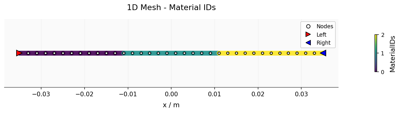

Convert msh to vtu for running OpenGeoSys simulations
def plot_2d_meshes(meshes_2d):(click to toggle)
    figures = []
    if not meshes_2d:
        return figures
    domain_mesh = meshes_2d.get("domain", next(iter(meshes_2d.values())))
    try:
        fig = plt.figure(figsize=(10, 3.0), dpi=150)
        ax = fig.add_subplot(111)
        ot.plot.contourf(
            domain_mesh, "MaterialIDs", ax=ax, cbar=True, linewidth=0.2, cmap="viridis"
        ax.set_aspect("equal")
        ax.set_xlabel("x / m", fontsize=11)
        ax.set_ylabel("y / m", fontsize=11)
        ax.tick_params(labelsize=10)
        ax.set_title("2D Mesh - Material IDs", fontsize=13, pad=15)
        boundary_colors = {"Left": "red", "Right": "blue"}
        for name, mesh in meshes_2d.items():
            for boundary_key, color in boundary_colors.items():
                if boundary_key.lower() in name.lower():
                    try:
                        points = mesh.points
                        if len(points) > 1:
                            if boundary_key in ["Left", "Right"]:
                                sorted_idx = np.argsort(points[:, 1])
                                sorted_idx = np.argsort(points[:, 0])
                            ax.plot(
                                points[sorted_idx, 0],
                                points[sorted_idx, 1],
                                color=color,
                                linewidth=5,
                                alpha=0.8,
                                label=name,
                    except Exception:
                        continue
        if any(
            any(
                boundary_key.lower() in name.lower() for boundary_key in boundary_colors
            for name in meshes_2d
            ax.legend(fontsize=9, loc="upper right", frameon=True)
        figures.append(fig)
    except Exception as e:

        alpha=0.9,
        zorder=2,
        cmap="viridis",
    if cell_data is not None and len(cell_data) == len(segments):
        lc.set_array(cell_data)
        cbar = plt.colorbar(lc, ax=ax, pad=0.02, shrink=0.8)
        cbar.set_label("MaterialIDs", fontsize=11, labelpad=8)
        cbar.ax.tick_params(labelsize=9)
        if np.issubdtype(cell_data.dtype, np.integer):
            unique_vals = np.unique(cell_data)
            cbar.set_ticks(unique_vals)
            cbar.set_ticklabels([str(int(v)) for v in unique_vals])
    ax.add_collection(lc)
    x_coords = points[:, 0]
    ax.plot(
        x_coords,
        np.zeros_like(x_coords),
        "o",
        markersize=4,
        color="white",
        markeredgecolor="black",
        markeredgewidth=1.2,
        alpha=0.95,
        zorder=3,
        label="Nodes",
    boundary_markers = []
    for name, boundary_mesh in meshes_1d.items():
                try:
                    boundary_points = boundary_mesh.points
                    if len(boundary_points) > 0:
                        if boundary_key == "Left":
                            x_pos = boundary_points[0][0]
                            marker = ">"
                            x_pos = (
                                if len(boundary_points) == 1
                                else boundary_points[-1][0]
                            marker = "<"
                        ax.plot(
                            x_pos,
                            0,
                            marker=marker,
                            markersize=10,
                            color=color,
                            markeredgewidth=1.0,
                            zorder=4,
                        boundary_markers.append(True)
                except Exception:
                    continue
    if len(x_coords) > 0:
        x_min, x_max = x_coords.min(), x_coords.max()
        if x_max == x_min:
            x_min -= 0.5
            x_max += 0.5
            padding = (x_max - x_min) * 0.05
            x_min -= padding
            x_max += padding
        ax.set_xlim(x_min, x_max)
    ax.set_ylim(-0.5, 0.5)
    ax.set_yticks([])
    for spine in ["top", "right", "left"]:
        ax.spines[spine].set_visible(False)
    ax.spines["bottom"].set_visible(True)
    ax.spines["bottom"].set_color("#404040")
    ax.spines["bottom"].set_linewidth(0.8)
    ax.tick_params(axis="x", which="both", bottom=True, labelsize=10)
    ax.set_xlabel("x / m", fontsize=11, labelpad=8)
    ax.set_ylabel("")
    ax.grid(True, axis="x", alpha=0.2, linestyle="-", linewidth=0.5)
    ax.set_title("1D Mesh - Material IDs", fontsize=13, pad=15, weight="normal")
    legend_handles = []
    legend_handles.append(
        Line2D(
            [0],
            [0],
            marker="o",
            color="white",
            markersize=6,
            linestyle="None",
            label="Nodes",
    if boundary_markers:
            Line2D(
                [0],
                [0],
                marker=">",
                color="red",
                markersize=8,
                linestyle="None",
                label="Left",
            Line2D(
                [0],
                [0],
                marker="<",
                color="blue",
                markersize=8,
                linestyle="None",
                label="Right",
    if legend_handles:
        ax.legend(
            handles=legend_handles,
            loc="upper right",
            frameon=True,
            framealpha=0.9,
            edgecolor="#CCCCCC",
            fontsize=9,
            handletextpad=0.5,
    ax.set_facecolor("#FAFAFA")
    fig.patch.set_facecolor("white")
    fig.set_constrained_layout(True)
    figures.append(fig)
    return figures

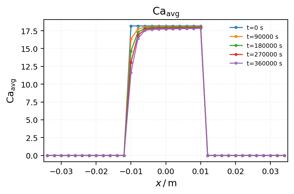

plot_centerline_profiles((click to toggle)
    pvd_path=PVD_PATH,
    vars_to_plot=VARS,
    out_dir=Path(PROJECT["out_dir"]),
[saved] centerline profiles -> /var/lib/gitlab-runner/builds/sy3_rc3xP/0/ogs/build/release-petsc/Tests/Data/Parabolic/ComponentTransport/ReactiveTransport/Acidification/PorosityIncrease/hc_porosity_change_1d_centerline.npz

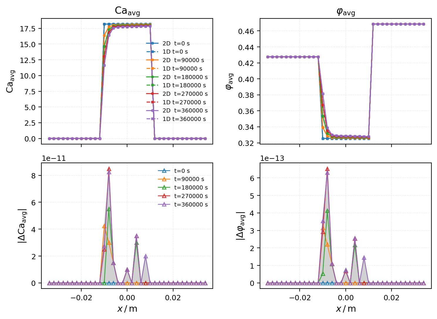

Comparison between 1D and 2D simulations
def _swap_dim_suffix(stem: str) -> tuple[str, str, str]:(click to toggle)
    s = stem.lower()
    if s.endswith("1d"):
        curr = "1d"
        other = "2d"
        other_stem = stem[:-2] + "2d"
    elif s.endswith("2d"):
        curr = "2d"
        other = "1d"
        other_stem = stem[:-2] + "1d"
        msg = (
            f"Cannot infer dimension from stem '{stem}'. "
            "Expected it to end with '1d' or '2d'."
        raise ValueError(msg)
    return curr, other, other_stem
def _align_other_to_base(
    base_x: np.ndarray, other_x: np.ndarray, other_vals: np.ndarray
) -> np.ndarray:
    if np.allclose(base_x, other_x, rtol=1e-10, atol=1e-12):
        return other_vals
    aligned = np.empty((other_vals.shape[0], base_x.shape[0]))
    for it in range(other_vals.shape[0]):
        aligned[it, :] = np.interp(base_x, other_x, other_vals[it, :])
    return aligned
def _var_tex(var: str) -> str:
    v = var.lower()
    if "porosity" in v:
        return r"\varphi_\mathrm{avg}"
    if "calcite" in v:
        return r"\mathrm{Ca}_\mathrm{avg}"
    return var
def compare_centerline_npz(
    base_npz: Path,
    other_npz: Path,
    vars_to_plot,
    use_relative: bool = False,
    base_label: str = "BASE",
    other_label: str = "OTHER",
    plt.rcParams.update(
            "font.size": 9,
            "axes.labelsize": 11,
            "axes.titlesize": 12,
            "legend.fontsize": 8,
            "xtick.labelsize": 9,
            "ytick.labelsize": 9,
    base_data = np.load(base_npz)
    other_data = np.load(other_npz)
    base_x = base_data["coord"]
    other_x = other_data["coord"]
    base_t = base_data["times"]
    other_t = other_data["times"]
    if base_t.shape != other_t.shape or not np.allclose(base_t, other_t):
        print("[warn] Times differ between base and other.")
    times = base_t
    print(f"[compare_centerline_npz] {base_label} file : {base_npz}")
    print(f"[compare_centerline_npz] {other_label} file: {other_npz}")
    print(
        "[compare_centerline_npz] x-base:  "
        f"{base_x[0]:.6g} .. {base_x[-1]:.6g} ({len(base_x)} pts)"
    print(
        "[compare_centerline_npz] x-other: "
        f"{other_x[0]:.6g} .. {other_x[-1]:.6g} ({len(other_x)} pts)"
    nt = len(times)
    cmap = plt.get_cmap("tab10")
    colors = [cmap(i % 10) for i in range(nt)]
    markevery = max(1, len(base_x) // 25)
    nvars = len(vars_to_plot)
    if nvars == 0:
        print("[compare_centerline_npz] No variables to plot.")
        return
    ncols = nvars
    nrows = 3 if use_relative else 2
    fig, axes = plt.subplots(
        nrows,
        ncols,
        figsize=(3.7 * ncols, 2.3 * nrows * 1.2),
        dpi=200,
        sharex="col",
    if nvars == 1:
        axes = np.atleast_2d(axes)
    for j, var in enumerate(vars_to_plot):
        if var not in base_data or var not in other_data:
            print(f"[skip] '{var}' not in both files.")
            continue
        base_vals = np.asarray(base_data[var])
        other_vals = np.asarray(other_data[var])
        other_vals_aligned = _align_other_to_base(base_x, other_x, other_vals)
        abs_err = np.abs(base_vals - other_vals_aligned)
        if use_relative:
            eps = 1e-14
            denom = np.maximum(np.abs(base_vals), eps)
            rel_err = abs_err / denom
            rel_err = None
        var_tex = _var_tex(var)
        ax_prof = axes[0, j]
        ax_abs = axes[1, j]
        ax_rel = axes[2, j] if use_relative else None
        for it, t in enumerate(times):
            c = colors[it]
            ax_prof.plot(
                base_x,
                base_vals[it, :],
                marker="o",
                markevery=markevery,
                markersize=2.5,
                lw=1.2,
                alpha=0.95,
                color=c,
                markerfacecolor="none",
                label=f"{base_label}  t={t:g} s",
            ax_prof.plot(
                base_x,
                other_vals_aligned[it, :],
                marker="s",
                markersize=2.5,
                lw=1.2,
                alpha=0.95,
                color=c,
                label=f"{other_label} t={t:g} s",
        ax_prof.set_ylabel(rf"${var_tex}$")
        ax_prof.grid(True, which="both", alpha=0.3, linestyle=":")
        if j == 0:
            ax_prof.legend(loc="best", frameon=False, fontsize=7)
        ax_prof.set_title(rf"${var_tex}$")
        # absolute error
        max_abs_err = np.max(abs_err, axis=0)
            c = colors[it]
            ax_abs.plot(
                base_x,
                abs_err[it, :],
                marker="^",
                markersize=4,
                lw=1.0,
                alpha=0.9,
                color=c,
                label=f"t={t:g} s",
        ax_abs.fill_between(
            base_x,
            0.0,
            max_abs_err,
            color="black",
            alpha=0.18,
        ax_abs.set_ylabel(rf"$|\Delta {var_tex}|$")
        ax_abs.grid(True, which="both", alpha=0.3, linestyle=":")
        if j == 0:
            ax_abs.legend(loc="best", frameon=False, fontsize=7)
        # relative error
        if ax_rel is not None and rel_err is not None:
            max_rel_err = np.max(rel_err, axis=0)
                c = colors[it]
                ax_rel.plot(
                    base_x,
                    rel_err[it, :],
                    marker="v",
                    lw=1.0,
                    alpha=0.9,
                    color=c,
                    label=f"t={t:g} s",
            ax_rel.fill_between(
                base_x,
                0.0,
                max_rel_err,
                color="black",
                alpha=0.18,
            ax_rel.set_ylabel(rf"$|\Delta {var_tex}| / |{var_tex}|$")
            ax_rel.grid(True, which="both", alpha=0.3, linestyle=":")
            if j == 0:
                ax_rel.legend(loc="best", frameon=False, fontsize=7)
    for j in range(ncols):
        axes[-1, j].set_xlabel(r"$x\,/\,\mathrm{m}$")
def compare_with_other_dim(vars_to_plot, use_relative: bool = True):
    stem = PVD_PATH.stem
    curr_suffix, other_suffix, other_stem = _swap_dim_suffix(stem)
    out_dir = Path(PROJECT["out_dir"])
    exp_dir = Path("expected")
    current_npz = out_dir / f"{stem}_centerline.npz"
    other_npz = exp_dir / f"{other_stem}_centerline.npz"
    if not current_npz.is_file():
        msg = (
            f"Current dim NPZ not found: {current_npz}.\n"
            "Run plot_centerline_profiles first for the current dimension."
        raise FileNotFoundError(msg)
    if not other_npz.is_file():
        msg = (
            f"Expected other-dim NPZ not found: {other_npz}.\n"
            "Check 'expected' folder and the naming convention."
    base_label = other_suffix.upper()
    other_label = curr_suffix.upper()
        base_npz=other_npz,
        other_npz=current_npz,
        vars_to_plot=vars_to_plot,
        use_relative=use_relative,
        base_label=base_label,
        other_label=other_label,
compare_with_other_dim((click to toggle)
    vars_to_plot=VARS,
    use_relative=False,
[compare_centerline_npz] 2D file : expected/hc_porosity_change_2d_centerline.npz
[compare_centerline_npz] 1D file: /var/lib/gitlab-runner/builds/sy3_rc3xP/0/ogs/build/release-petsc/Tests/Data/Parabolic/ComponentTransport/ReactiveTransport/Acidification/PorosityIncrease/hc_porosity_change_1d_centerline.npz
[compare_centerline_npz] x-base:  -0.034 .. 0.034 (35 pts)
[compare_centerline_npz] x-other: -0.034 .. 0.034 (35 pts)
