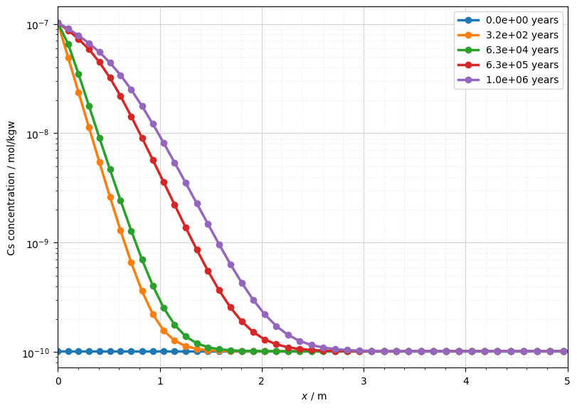

Cs-135 migration
A Cs concentration at the left boundary of 1.019e-7 mol/kgw is set constant throughout the simulation. The sorption model is taken from Águila et al., 2021. Cs-135 migration is simulated by using OGS#iPHREEQC via the <surface> keyword with the following parameters:
| Site name | Description | Capacity (mol/kgw) |
| Su_ | Double layer planar sites | 1.425 |
| Su_ii | Type II sites of intermediate strength | 1.38e-1 |
| Su_fes | Frayed edge sites | 1.8e-3 |
The corresponding reactions of the sorption model are added to the latest version (2020) of the PSI/Nagra thermodynamic database (PSINagra2020v1-1_davies.dat).

cs_var = ot.variables.Scalar("Cs", output_name="Cs concentration / mol/kgw")
cs_fig = plot_results(cs_var, x_max=5)
The results show that Cs-135 does not migrate for more than 3 m even after 1 million years.

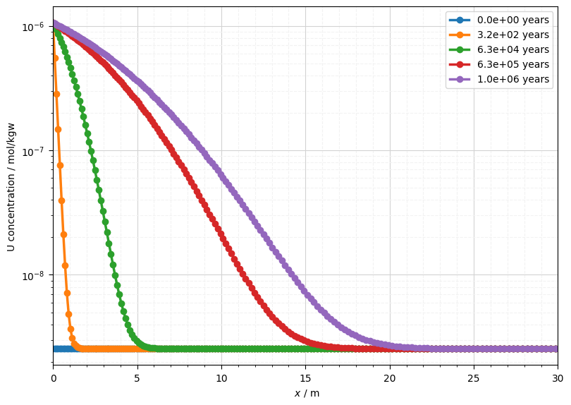

U-238 migration
Similarly, a U concentration at the left boundary of 1.060e-6 mol/kgw is applied to the domain. In this case, the sorption model is taken from Hennig et al., 2020. U-238 migration is simulated by using OGS#iPHREEQC via the <surface> keyword definition with the following parameters:
| Ill_wOH | Illite weak site | 6.254e-1 |
| Ill_sOH | Illite strong site | 1.384e-2 |
| Kln_aOH | Kaolinite Aluminol site | 7.351e-2 |
| Kln_siOH | Kaolinite Silanol site | 7.351e-2 |
| Mll_wOH | Montmorillonite weak site | 1.137e-1 |
| Mll_sOH | Montmorillonite strong site | 2.516e-3 |
| ChlOH | Chlorite | 9.414e-3 |
The Opalinus clay parameters remain the same as in the Cs case, as well as the space-time discretization. In the same way, the reactions of the sorption model are added to the themodynamic database PSINagra2020v1-1_davies.dat.

Again, the full simulation results are provided in /U_full_simulation. They are plotted to show the migration of U after 1 million years.
U_var = ot.variables.Scalar("U", output_name="U concentration / mol/kgw")
U_fig = plot_results(U_var, x_max=30)
In this case, it is clear that the migration of U-238 is much more pronounced than Cs-135. After 1 million years, U-238 shows a breakthrough to around 20 m.
