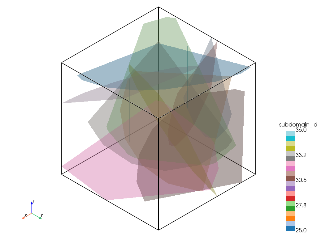

Export the mesh to VTU format
Creates a VTK file of the 2D mixed-dimensional grid (mdg2d) using Exporter (see link ). The output is compatible with visualization tools like ParaView, and serves as input for OpenGeoSys.
exporter = pp.Exporter(mdg2d, "mixed_dimensional_grid", folder_name=out_dir).write_vtu()
os.chdir(orig_dir)(click to toggle)
os.chdir(orig_dir)
import pyvista as pv  # noqa: E402
plot_mesh = pv.read(out_dir / "mixed_dimensional_grid_2.vtu")
scalar_name = "MaterialIDs" if "MaterialIDs" in plot_mesh.cell_data else "subdomain_id"
plotter.add_mesh(
    plot_mesh,
    scalars=scalar_name,
    cmap="tab20",
    opacity=0.4,
    scalar_bar_args={"title": scalar_name, "vertical": True},
plotter.add_mesh(plot_mesh.outline(), color="black", line_width=2)
plotter.show_axes()
plotter.enable_parallel_projection()
plotter.view_isometric()
if not pv.global_theme.trame.server_proxy_enabled:
    output_path = out_dir / "mesh_overview.png"
    plotter.screenshot(str(output_path))
plotter.show()
plotter.close()

print(
    f"Fracture validation passed ({len(detail_rows)}/{len(fracture_params_from_json)}). "
    f"Max errors: strike={max_strike_err:.3e} deg, dip={max_dip_err:.3e} deg, "
    f"axis={max_axis_err:.3e} m, normal={max_normal_err:.3e} deg, "
    f"plane={max_plane_dist:.3e} m, centre={max_center_dist:.3e} m."
Fracture validation passed (10/10). Max errors: strike=1.588e-06 deg, dip=1.604e-06 deg, axis=1.421e-14 m, normal=1.708e-06 deg, plane=9.826e-12 m, centre=1.743e-06 m.
