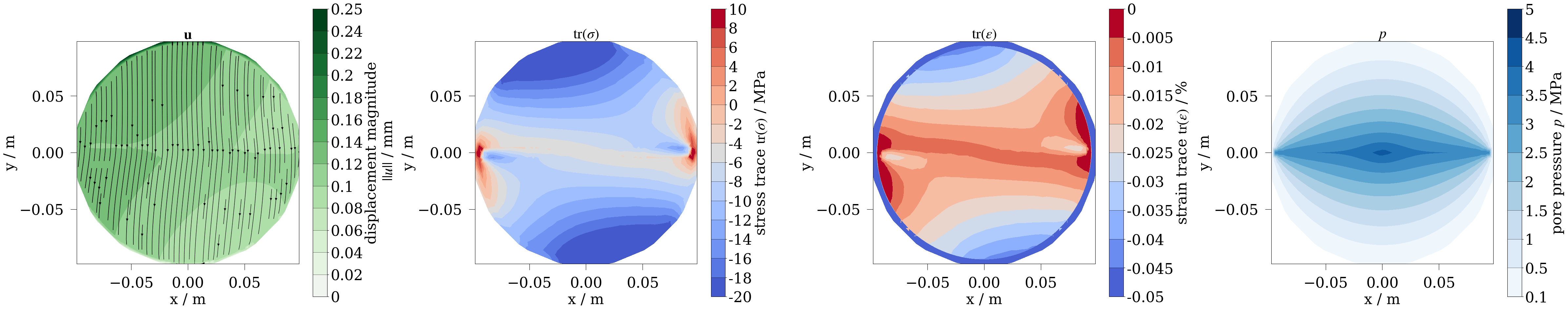

The GREAT cell is a poly-axial rock-testing device that reproduces subsurface conditions down to 3.5 km depth on 200 mm-diameter samples. It imposes a rotating stress field, injects fluid through a central borehole, and records both fiber-optic strain and pore-pressure data—providing a rich dataset for validating coupled hydro-mechanical models. For full details, see the GREAT cell benchmark docs: www.opengeosys.org/docs/benchmarks/small-deformations/greatcellm/
Here, in our 2D, small-deformation benchmark suite, we employ the LIE (lower-dimensional interface element) hydro-mechanical process to model fractures as interfaces. The cases are:
  • $\texttt{HM}_1$: Intact rock sample with fluid injection.
  • $\texttt{HM}_{2a}$: Fully fractured sample with inflow-outflow.
  • $\texttt{HM}_{2b}$: Half-fractured sample with inflow-outflow.
Material Properties

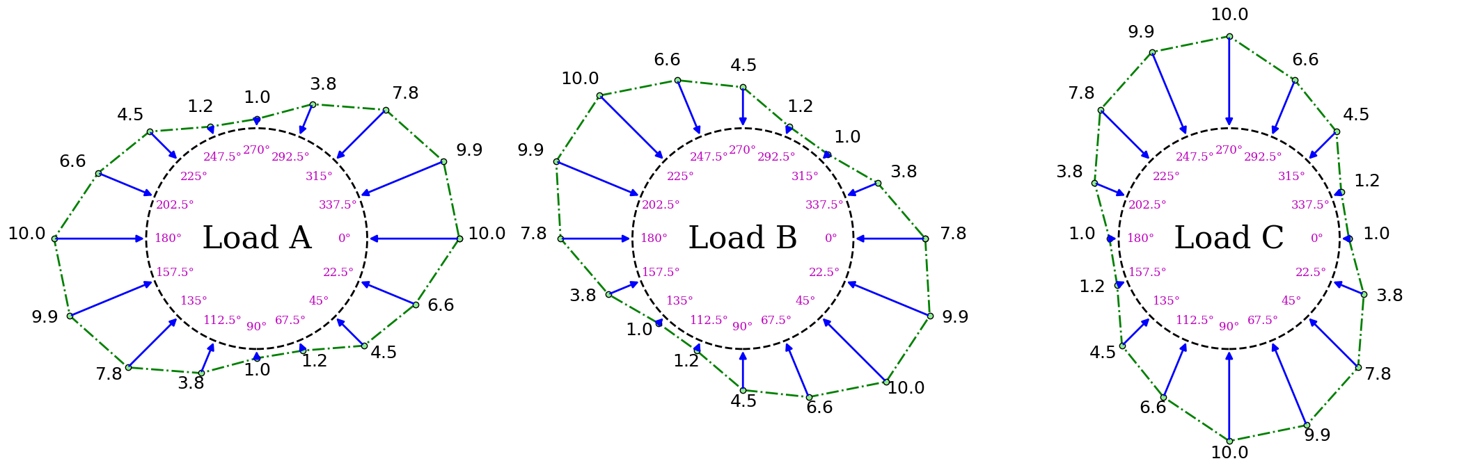

Loads
Table: Load Conditions
A 10.0 6.64 4.46 1.17 1.0 3.82 7.80 9.95
E 22.5° 9.95 10.0 6.64 4.46 1.17 1.0 3.82 7.80
B 45.0° 7.80 9.95 10.0 6.64 4.46 1.17 1.0 3.82
C 90° 1.0 3.82 7.80 9.95 10.0 6.64 4.46 1.17
Schematic loading conditions

  • Dirichlet conditions (displacement control): \begin{equation*} \begin{cases} u_x(0, y) = 0, \quad u_y(0, y) = 0 & \quad \text{for } y = -0.09894 \text{ m}, \ u_y(x, 0) = 0, & \quad \text{for} x = -0.09894 \text{ m}. \end{cases} \end{equation*}
  • Neumann conditions:
    Normal stress $\sigma_{rr}$ is applied on PEEs and DSSs. The DSS stress is calculated as:
    $$\begin{equation*}\sigma_\text{DSS}^i = \frac{\sigma_\text{PEE}^i + \sigma_\text{PEE}^{i+1}}{2}\end{equation*} $$

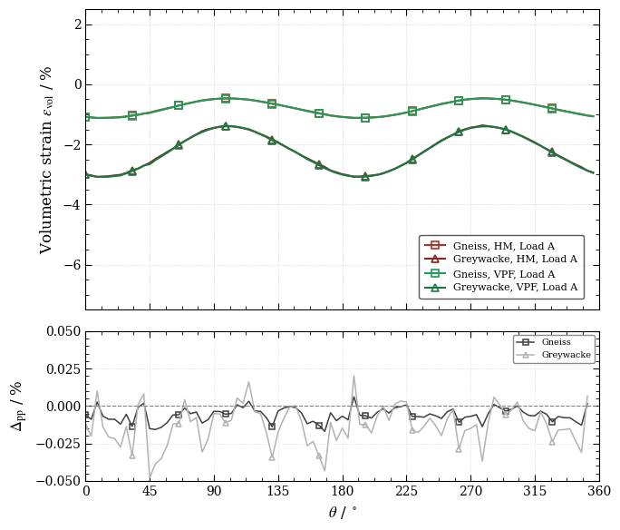

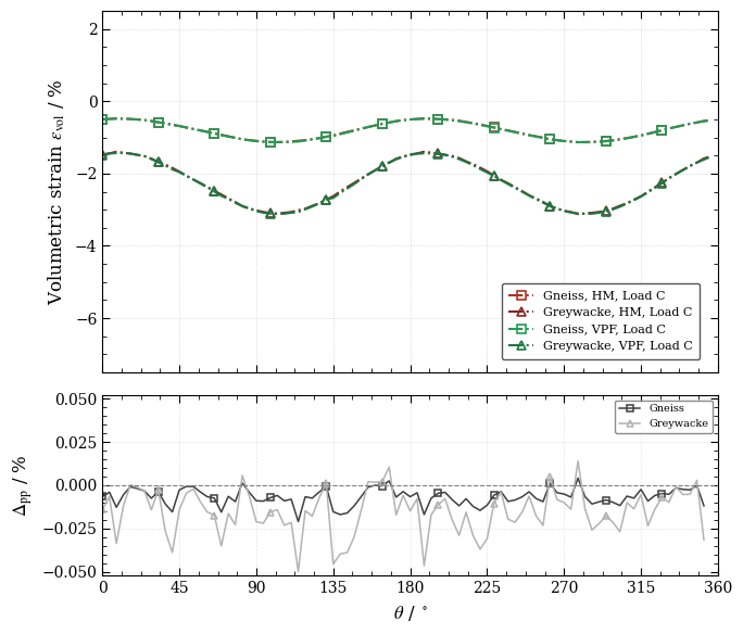

Post-processing

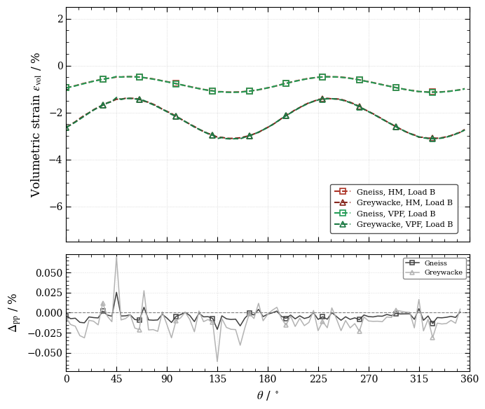

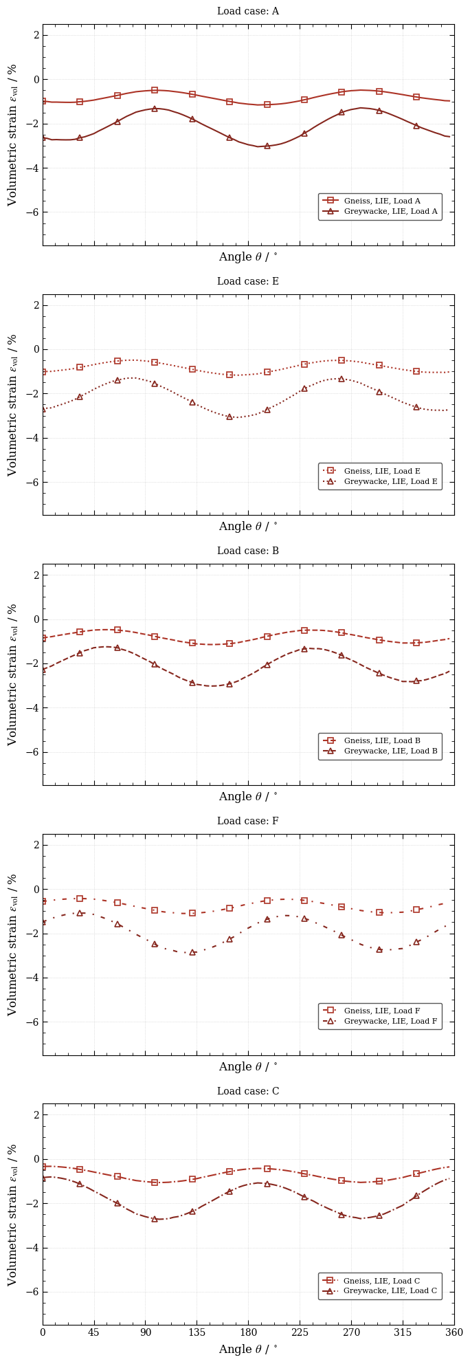

Volumetric strain vs angle at probe circle
plotter = Plotter((click to toggle)
plotter = Plotter(
    output_dir=out_dir,
    save_extracted_data=True,
data_dir = Path("external_data")
external_data = Plotter.load_external_data(data_dir, benchmark_tag="HM1")
plotter.plot_volumetric_strain_vs_angle(
    vtu_files_dict,
    model_type="HM1",
    ylim_range=[-7.5, 2.5],
    layout="subplots",
    external_data=external_data["strain"],
    show_error=True,

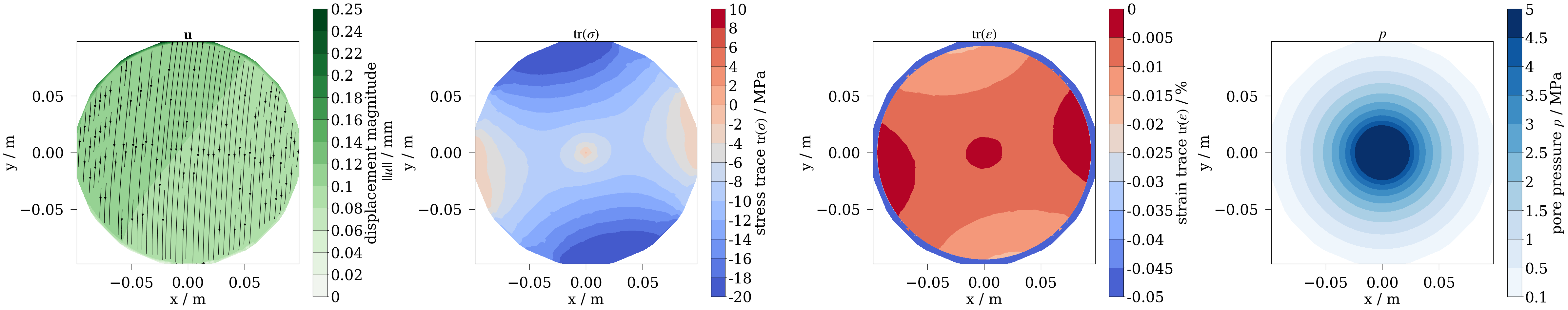

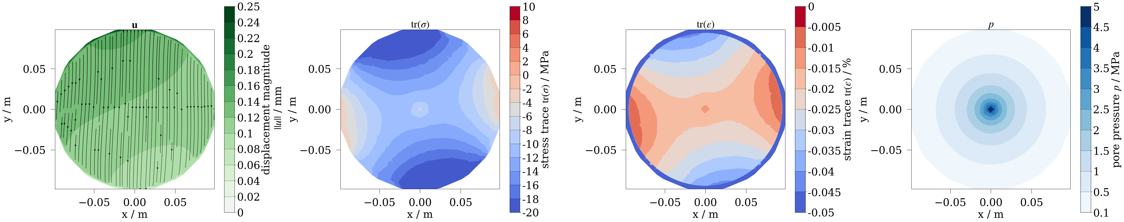

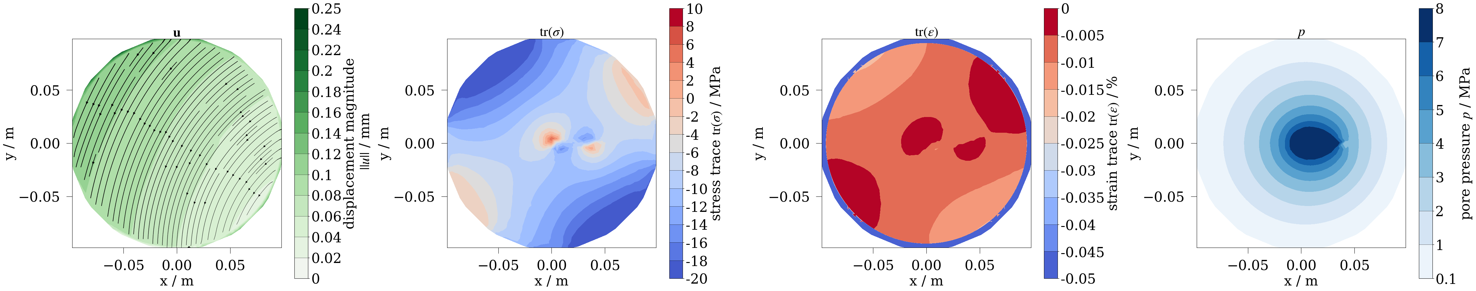

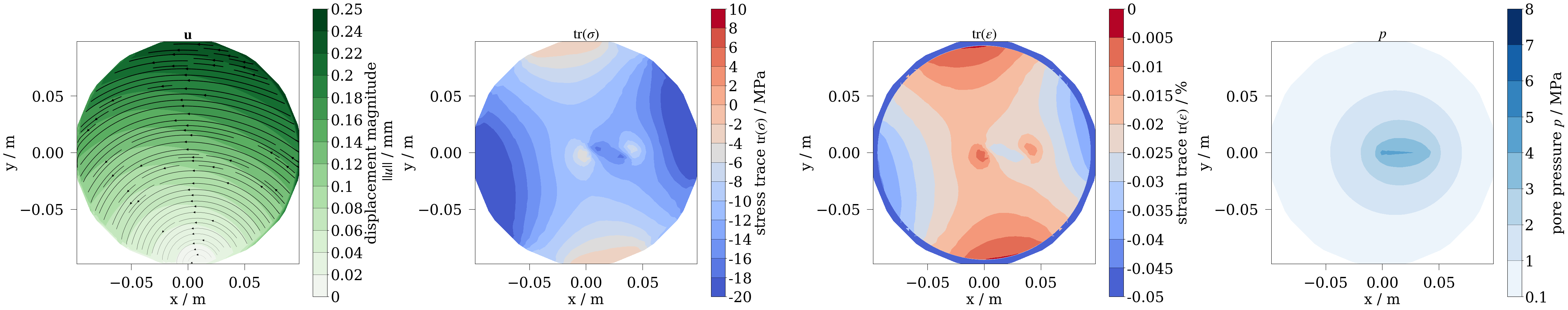

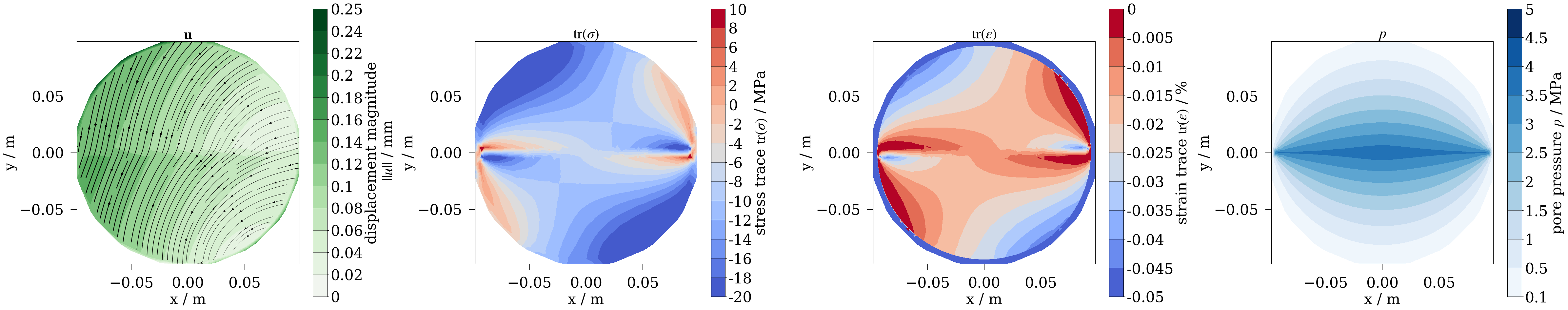

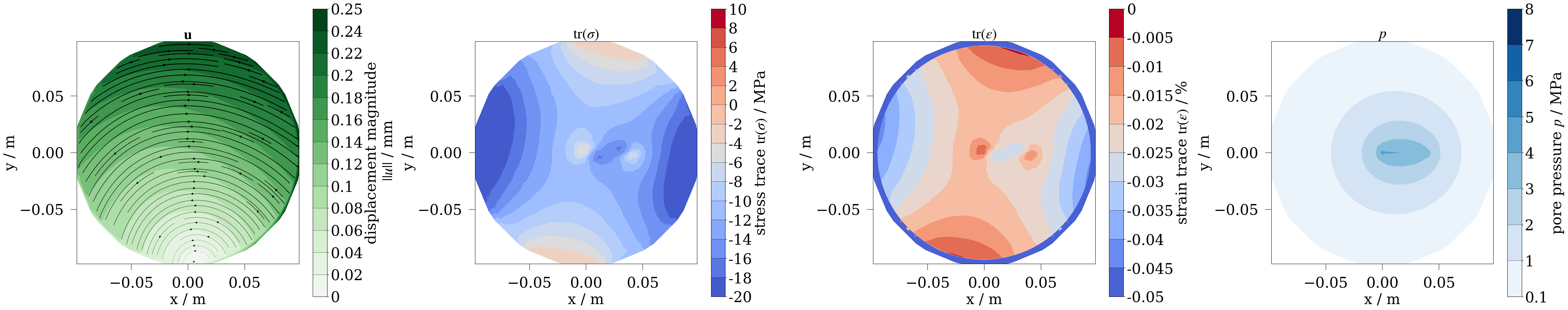

Profiles

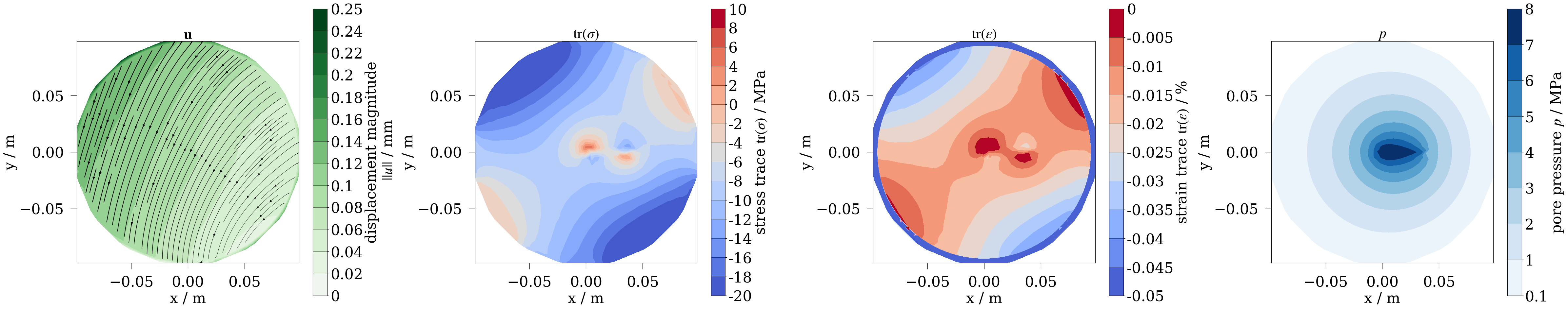

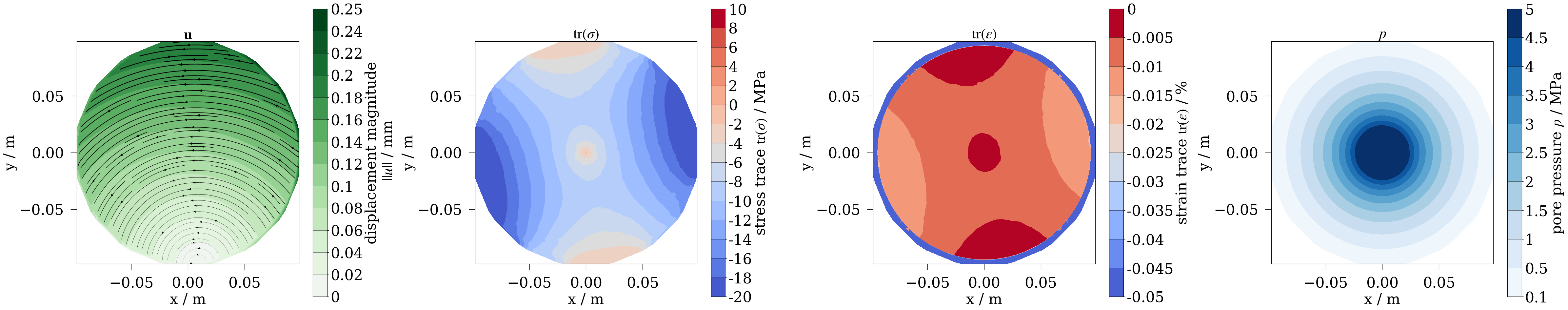

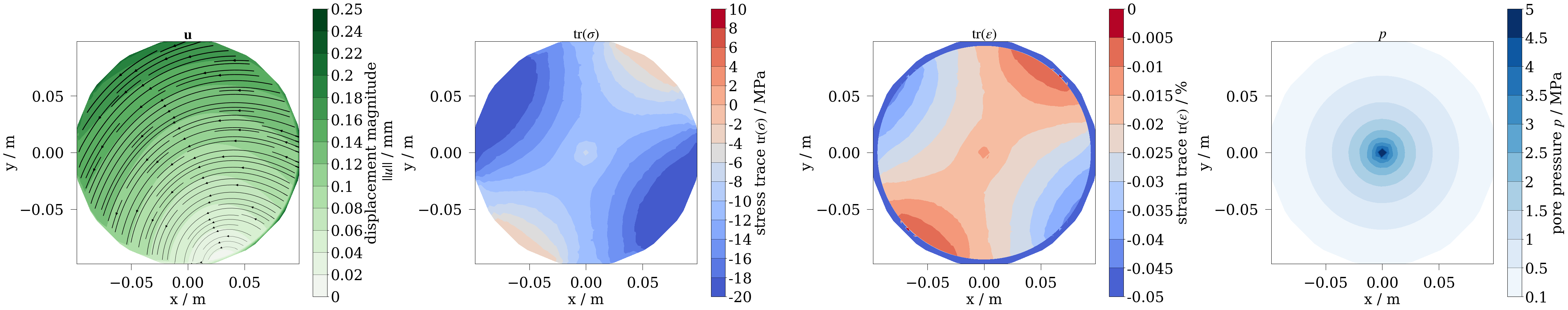

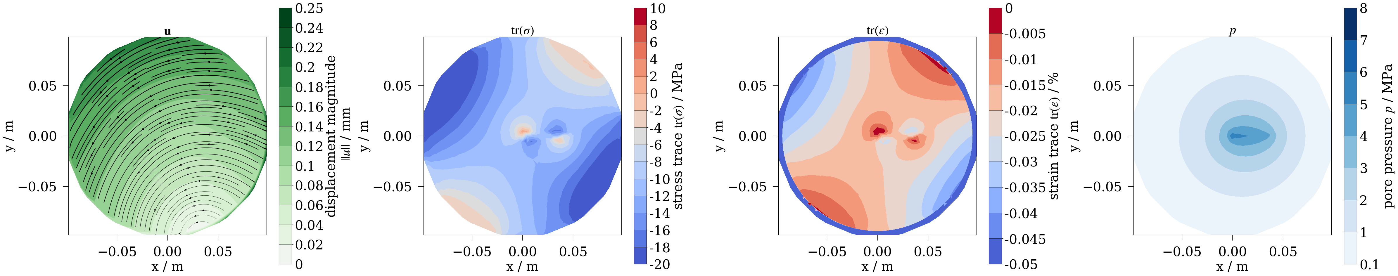

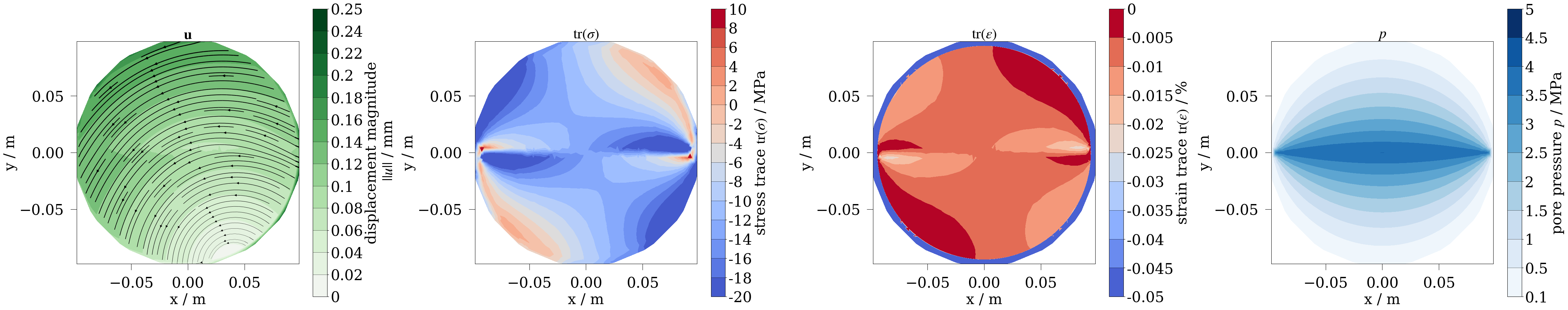

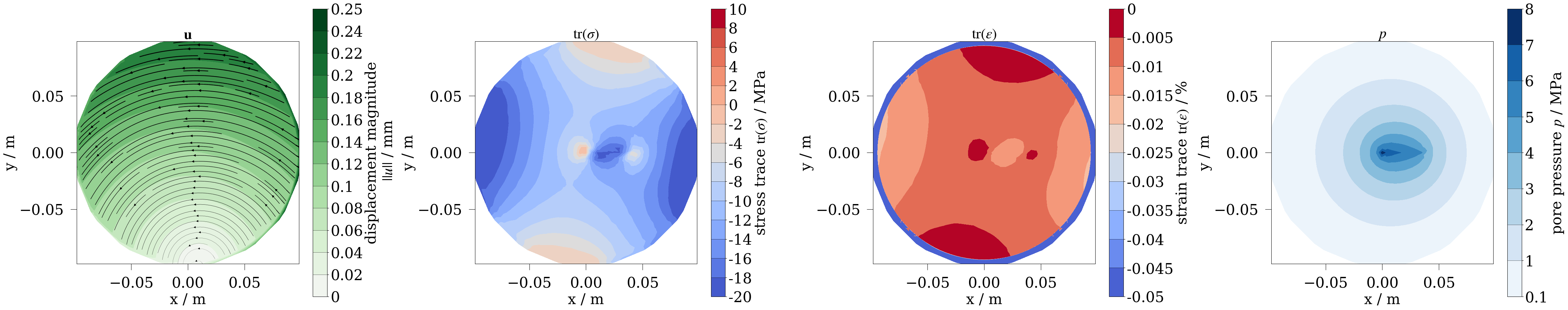

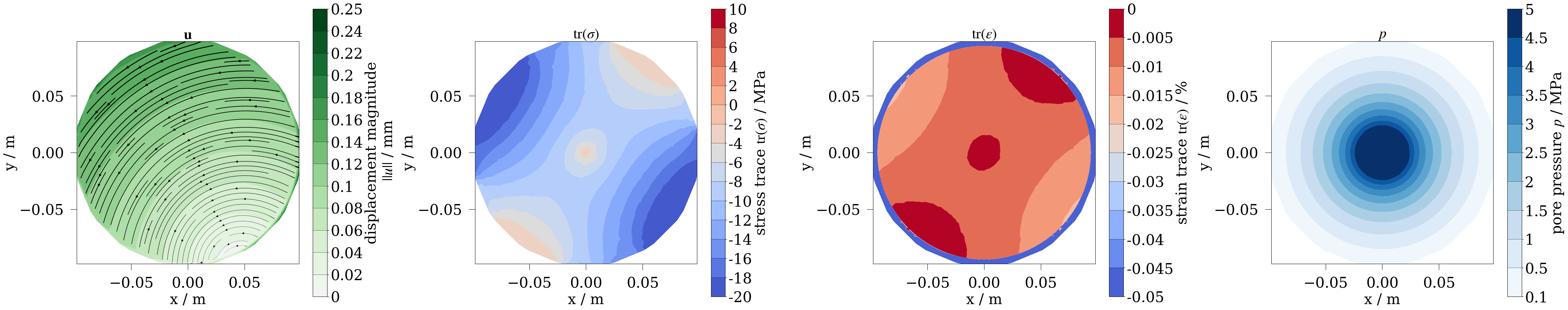

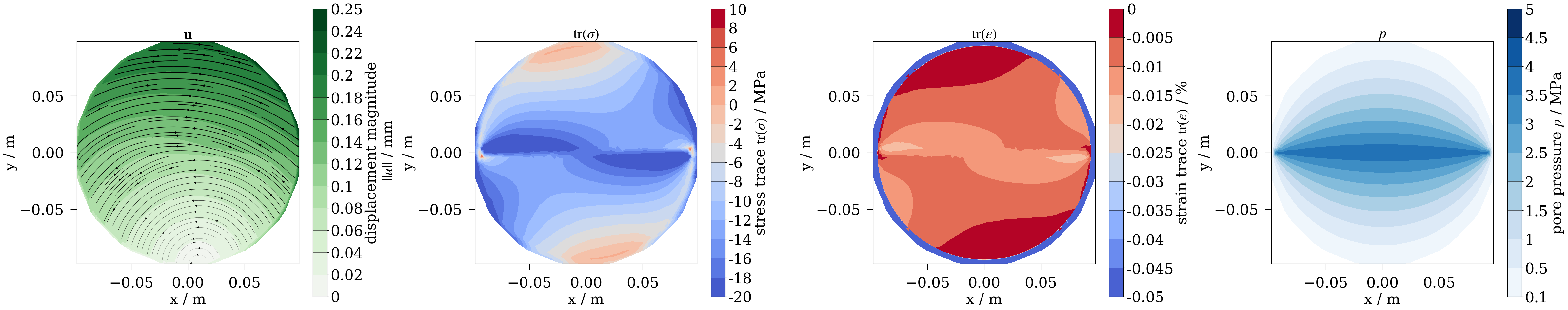

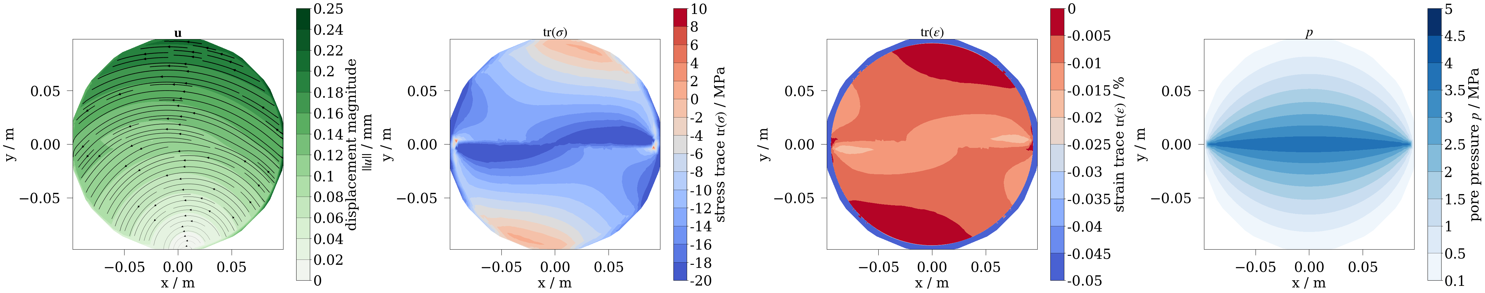

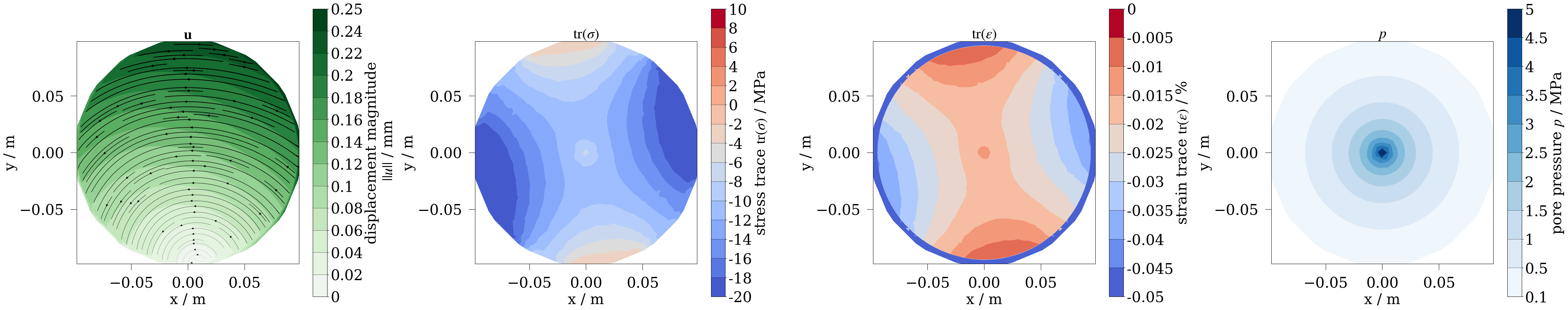

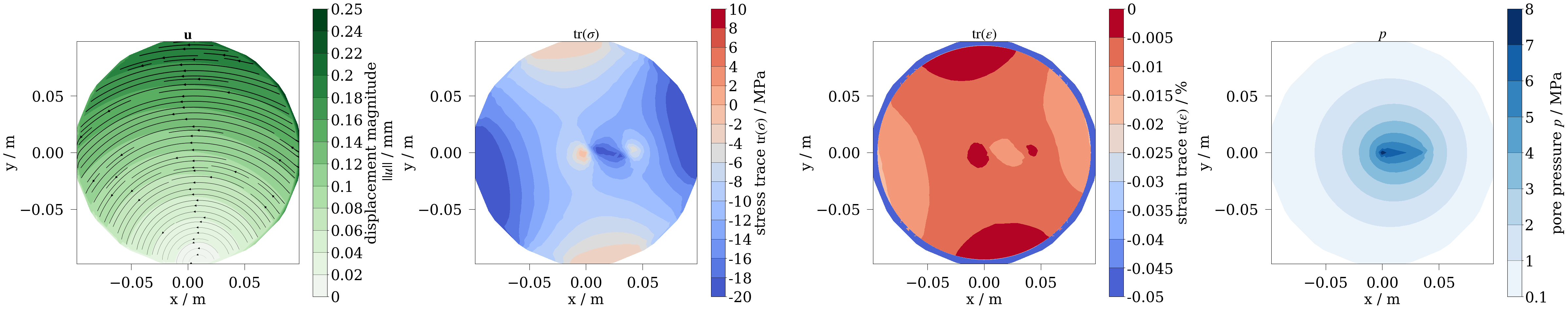

Figure below shows the results of this benchmark:
  • The trace of effective stress, defined as $\sum_{i=x,y,z} \sigma'_{ii}$,
  • and the corresponding volumetric strain plotted versus loading angle for both Greywacke and Gneiss,
These results are shown for the intact rock samples under $\texttt{HM}_1$ loading.
plotter.plot_field_variables(vtu_files_dict)
Load: A, File 0, Benchmark: HM1, Material: Gneiss
Load: A, File 1, Benchmark: HM1, Material: Greywacke
Load: B, File 0, Benchmark: HM1, Material: Gneiss
Load: B, File 1, Benchmark: HM1, Material: Greywacke
Load: C, File 0, Benchmark: HM1, Material: Gneiss
Load: C, File 1, Benchmark: HM1, Material: Greywacke

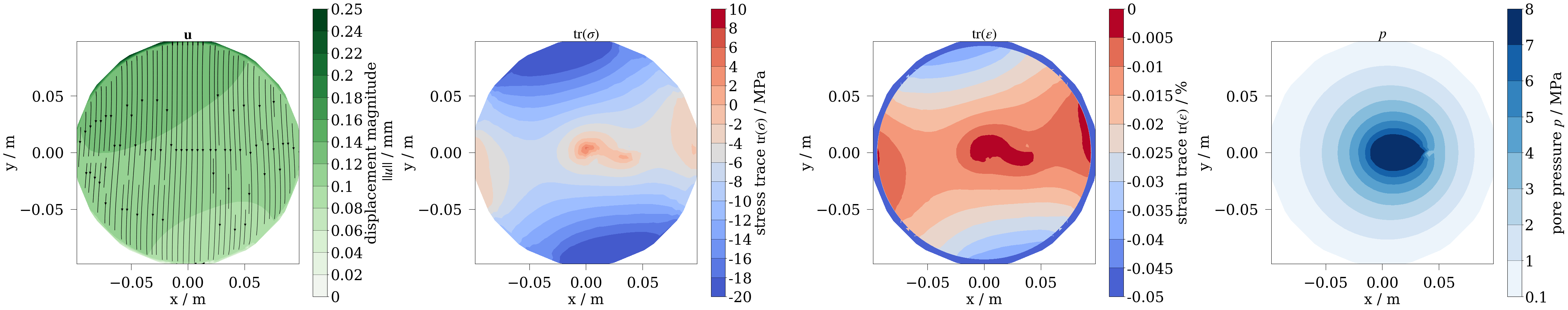

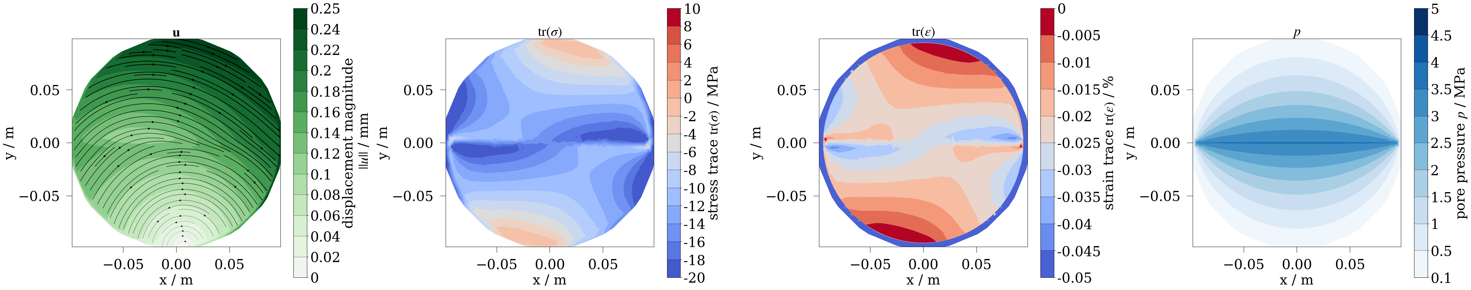

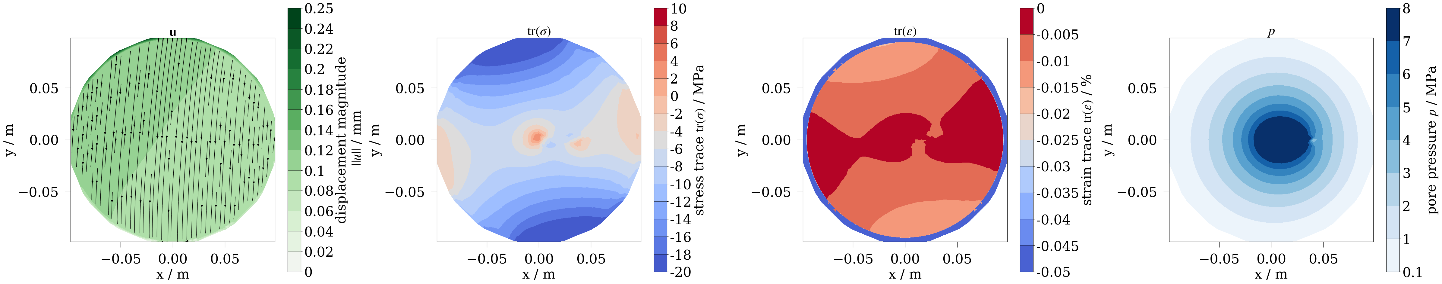

    vtu_files_dict_embedded,
    model_type="HM2b",
    layout="subplots",  # "single" or "subplots"

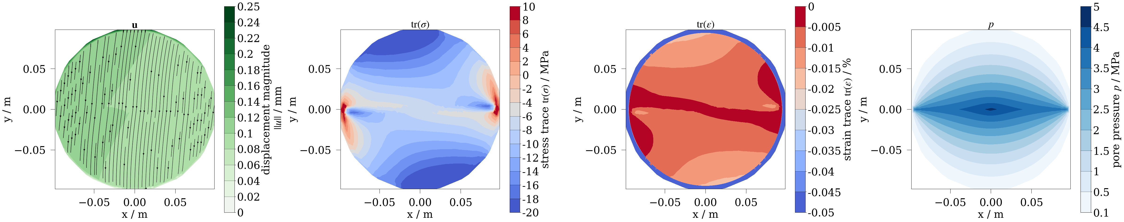

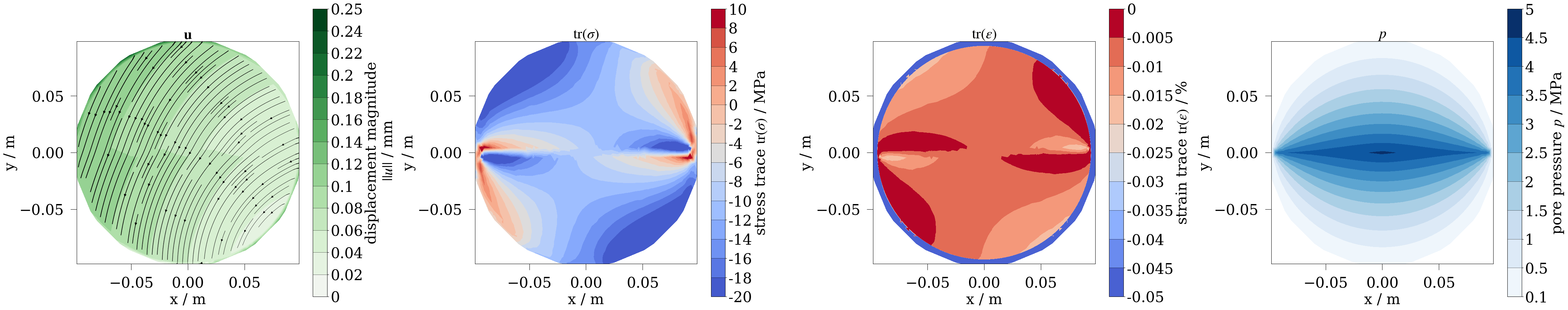

plotter.plot_field_variables(vtu_files_dict_embedded)
Load: A, File 0, Benchmark: HM2b, Material: Gneiss
Load: A, File 1, Benchmark: HM2b, Material: Greywacke
Load: E, File 0, Benchmark: HM2b, Material: Gneiss
Load: E, File 1, Benchmark: HM2b, Material: Greywacke
Load: B, File 0, Benchmark: HM2b, Material: Gneiss
Load: B, File 1, Benchmark: HM2b, Material: Greywacke
Load: F, File 0, Benchmark: HM2b, Material: Gneiss
Load: F, File 1, Benchmark: HM2b, Material: Greywacke
Load: C, File 0, Benchmark: HM2b, Material: Gneiss
Load: C, File 1, Benchmark: HM2b, Material: Greywacke

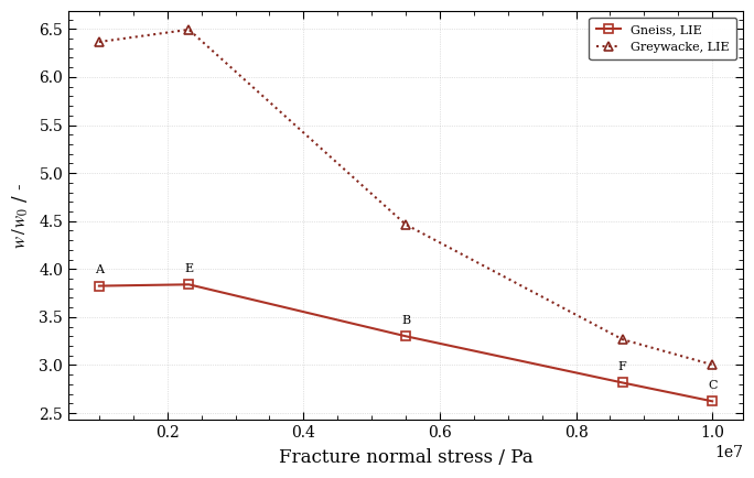

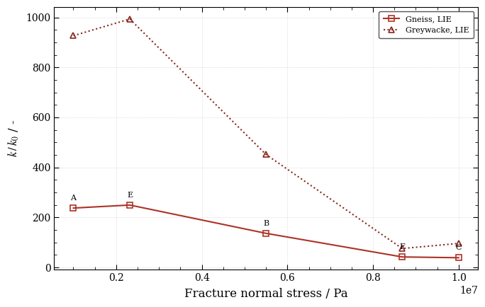

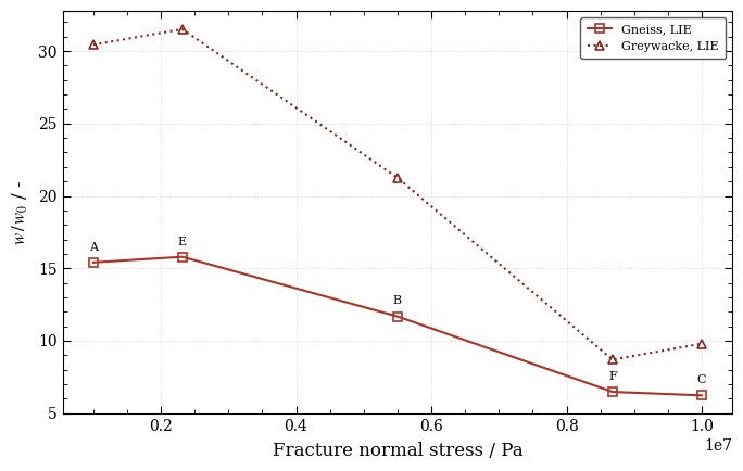

plotter.plot_avg_width_vs_stress(
    benchmark_tag="HM2b",
    metric="width",
    methods_to_include=["LIE"],
    pee_load_values=PEE_load_values,
    external_data=external_data["average"],
    w0=next(iter(materials.values()))["w_init"],
    metric="permeability",
array([ 1000000.        ,  2318019.48466054,  5500000.        ,
        8681980.51533946, 10000000.        ])

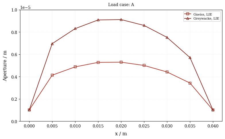

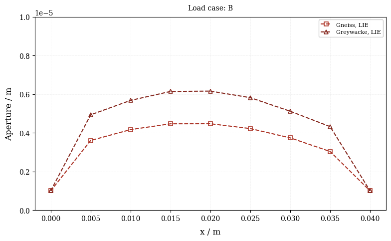

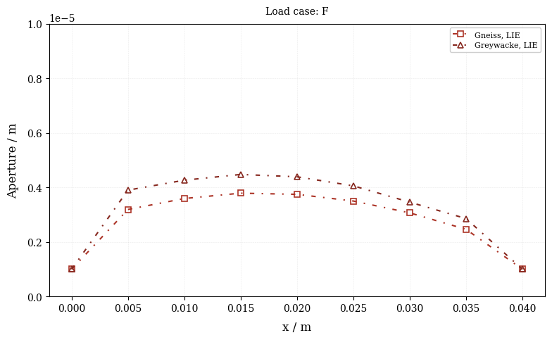

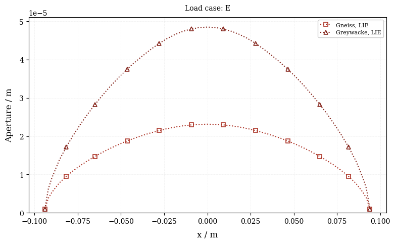

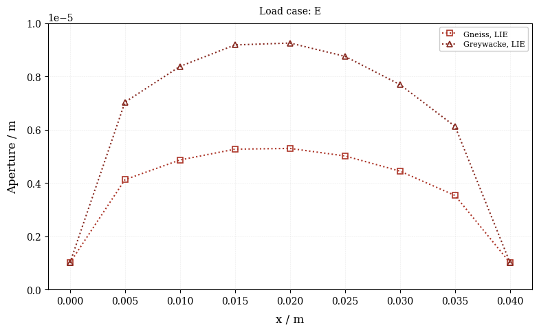

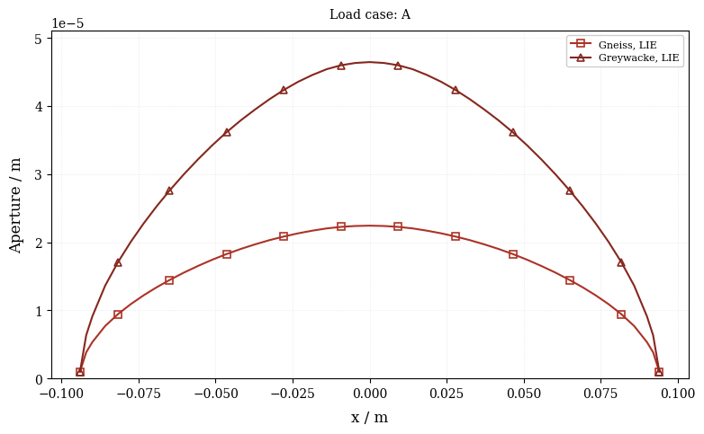

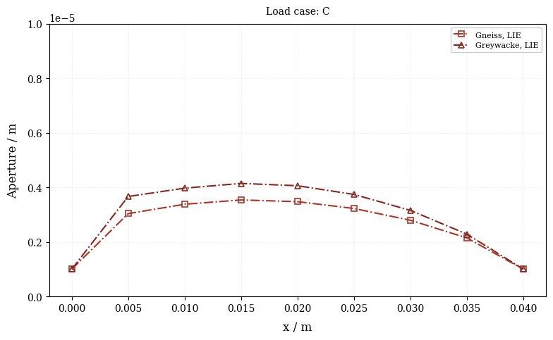

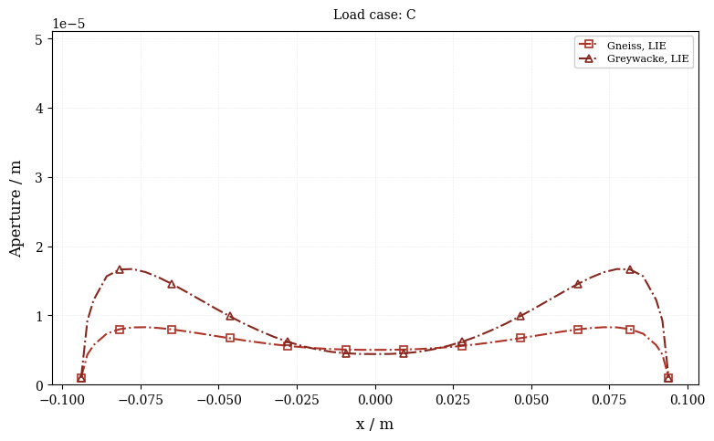

lie_profiles = {}(click to toggle)
lie_profiles = {}
for load_case, file_list in plotter.vtu_file_names["LIE"].items():
    lie_profiles[load_case] = plotter.extract_lie_aperture_from_list(
        file_list,
        plotter.material_names,
plotter.plot_fracture_aperture_profiles(
    widthProfile=lie_profiles,
    downsample=1,
    ylim=(0, 10e-6),
    method_label="LIE",
    external_data=external_data["widthProfile"],

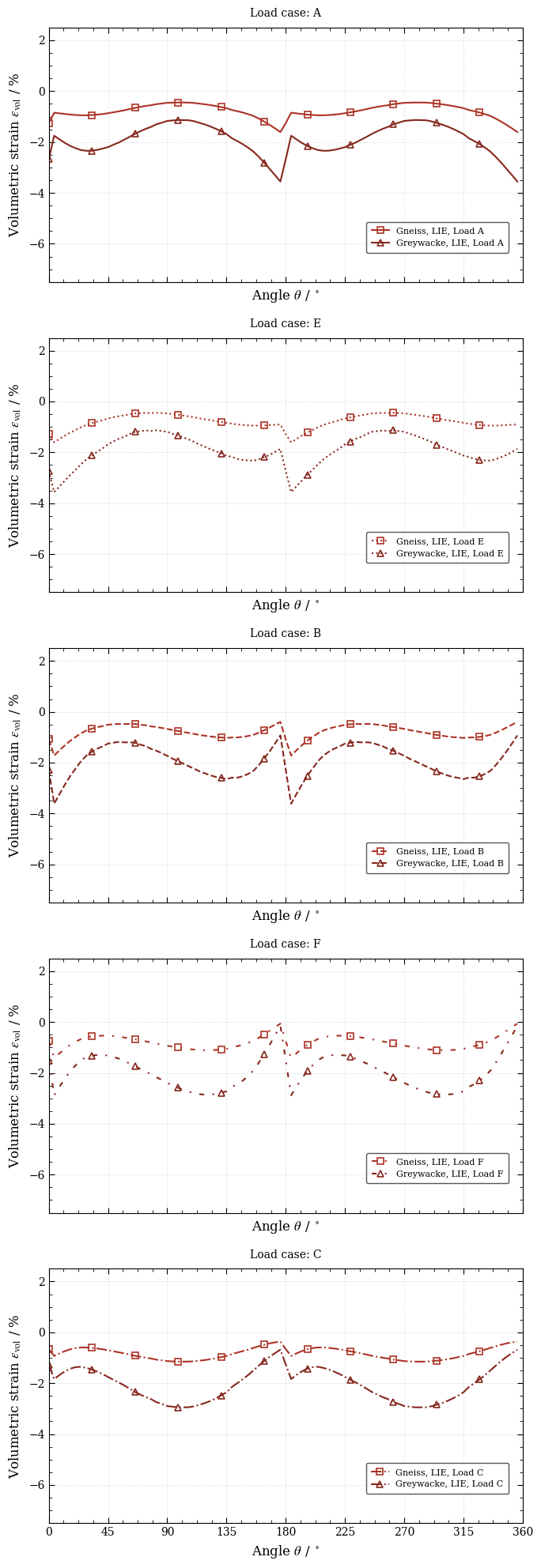

    vtu_files_dict_full,
    model_type="HM2a",
    layout="subplots",
plotter.plot_field_variables(vtu_files_dict_full)
Load: A, File 0, Benchmark: HM2a, Material: Gneiss
Load: A, File 1, Benchmark: HM2a, Material: Greywacke
Load: E, File 0, Benchmark: HM2a, Material: Gneiss
Load: E, File 1, Benchmark: HM2a, Material: Greywacke
Load: B, File 0, Benchmark: HM2a, Material: Gneiss
Load: B, File 1, Benchmark: HM2a, Material: Greywacke
Load: F, File 0, Benchmark: HM2a, Material: Gneiss
Load: F, File 1, Benchmark: HM2a, Material: Greywacke
Load: C, File 0, Benchmark: HM2a, Material: Gneiss
Load: C, File 1, Benchmark: HM2a, Material: Greywacke
plotter.material_names = ["Gneiss", "Greywacke"](click to toggle)
plotter.vtu_file_names = {"LIE": vtu_files_dict_full}

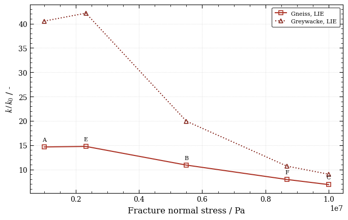

    benchmark_tag="HM2a",
    metric="width",

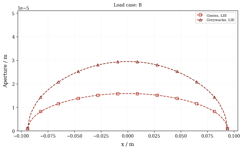

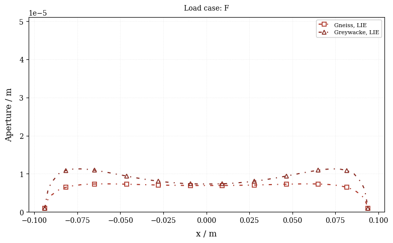

lie_profiles = {}
        file_list,
    downsample=1,
    # ylim=(0, 1e-5),
    method_label="LIE",
